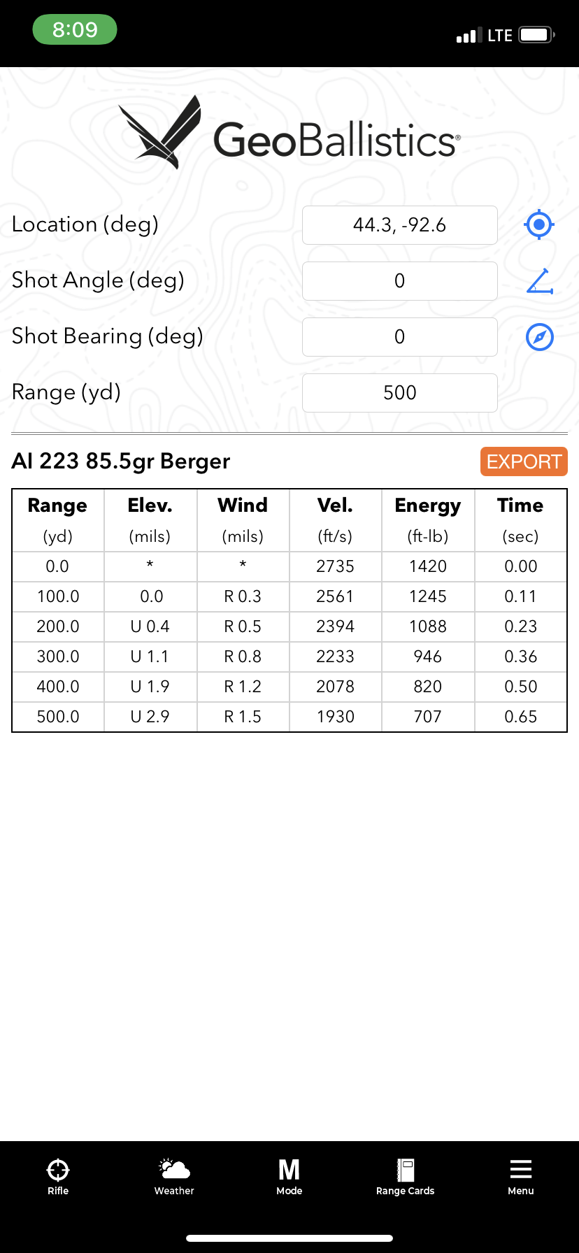

Haven't kept up in this conversation, but are we talking wind drift, drop, or a combination of both? Here are 2 pictures of drop and wind at 15mph 90*
while a little extreme, this does show the drop versus wind ratio as weight goes down and speed goes up
less elevation and more wind

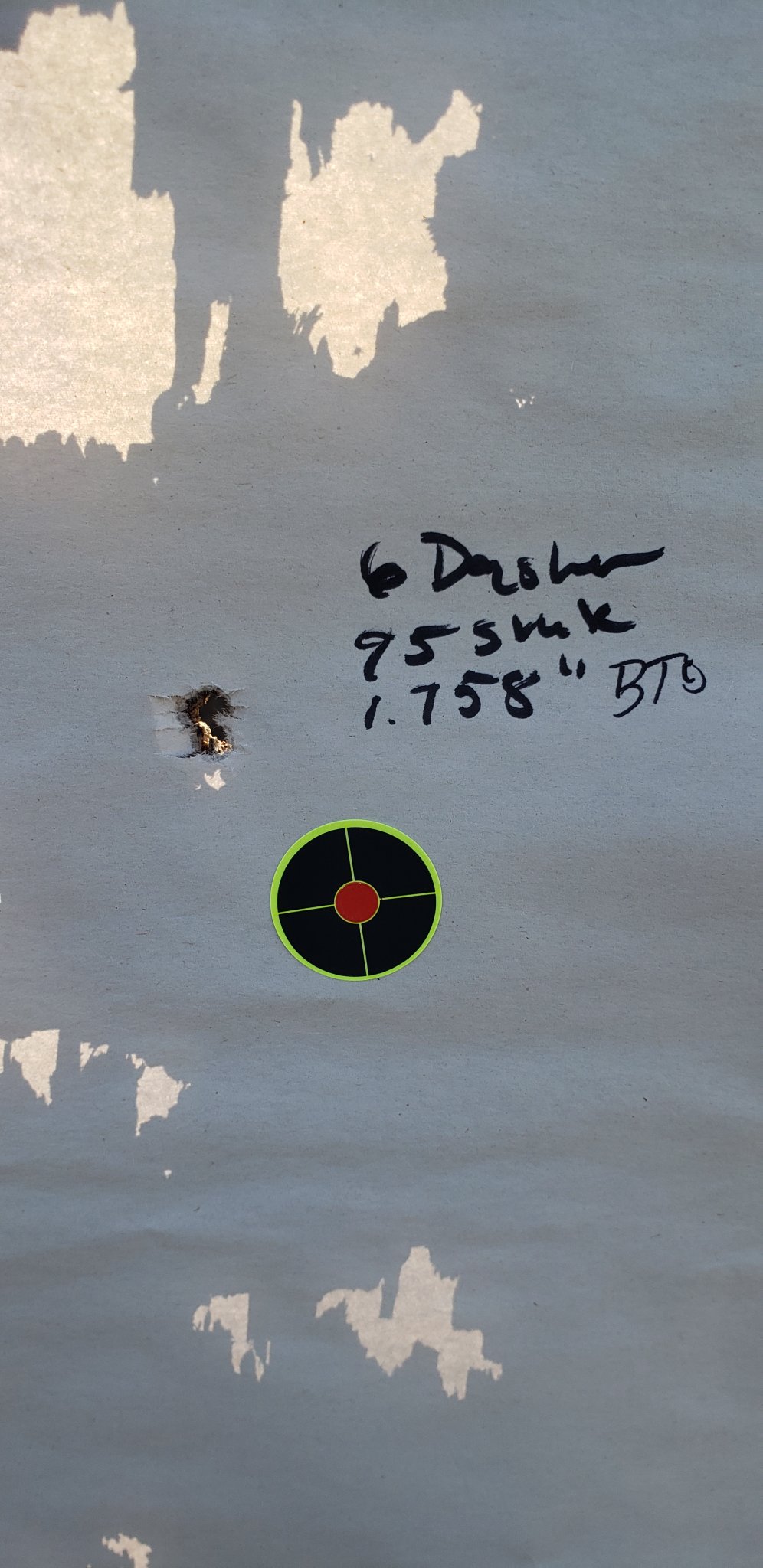

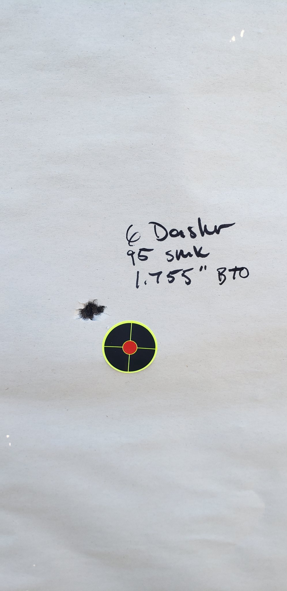

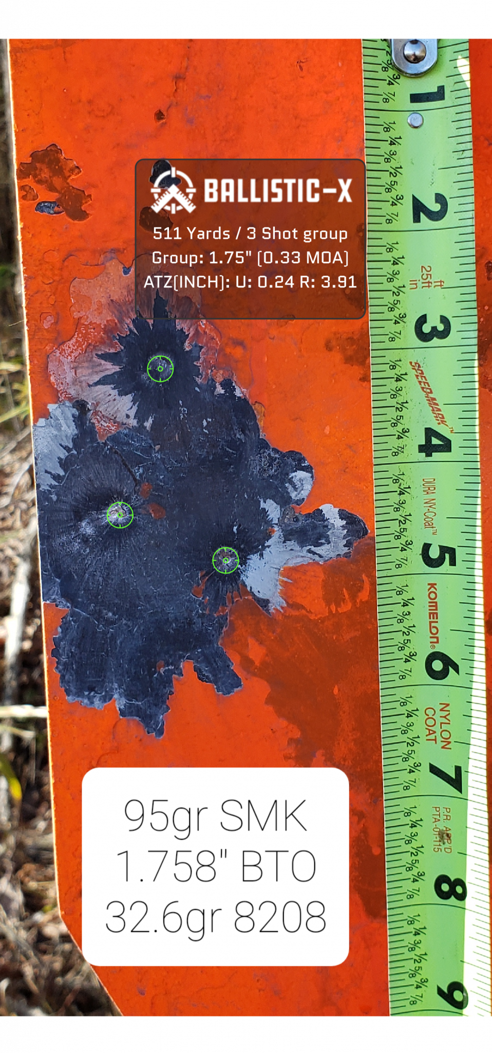

IDK how much this applies to this topic specifically but here is my .02 worth of experience.
Me and 2 of my shooting partners have developed absolute killer dasher loads with the 95gr SMK 6mm's. 600 and in, wind isn't too big of an issue (considering we live in the SE and have little wind to speak of anyway), but when you get much past that, these 95's get blown around pretty easily. We have them going anywhere from 3120-3180 fps with ease and without a velocity limit, we could go past 3200 without pressure. Our 100 yard groups can be pretty consistently in the .2 MOA range and shoot 1.5-1.75" groups at 500. It feels like shooting a red rider BB gun too. With all that being said, the 105's have proven to be more resistant to wind changes and more consistent at/around the 1000 yard range. Now, is 105gr considered to be a light, average, or heavy for caliber weight for the dasher? It is definitely the most "common" weight bullet used for the dasher but where does it fall on the scale as far as this particular topic goes? I loved shooting 95s until the wind picked up. Slight changes in mph or direction had greater affects on the 95's than it did on the 105's.

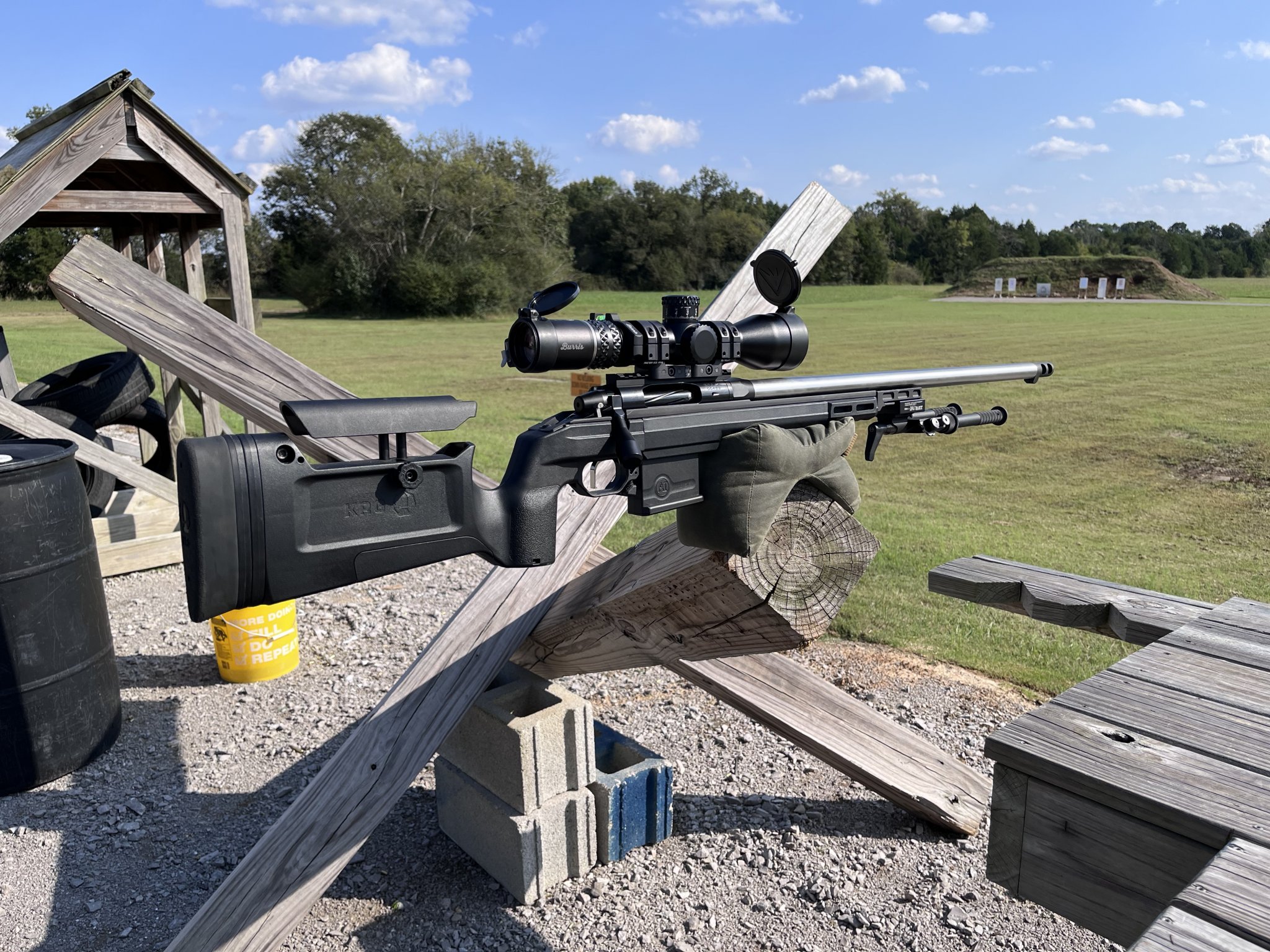

Hmmm...who builds a custom .224Valkyrie? Yeah, me. Origin action, Bartlein left hand gain twist barrel.
That gun makes me giggle every time I yank a prairie dog out of it's hole or blow it off a mound. Nothing special, just 77TMK's sitting over some CFE223, but man does that rifle/cartridge shoot. Had two line up 270'ish yds. LOL! When we went and looked at the "quigley" shot, you could see the silhouette of the second one, in blood on the ground, as the first one exploded, before blowing the second one another 6 yds or so. Damnedest thing I ever saw...

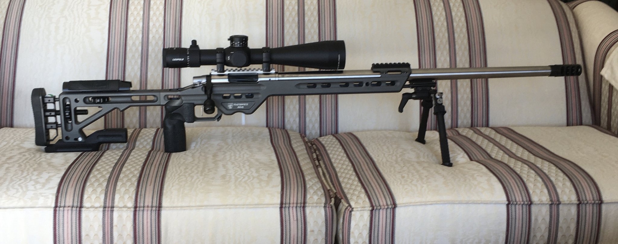

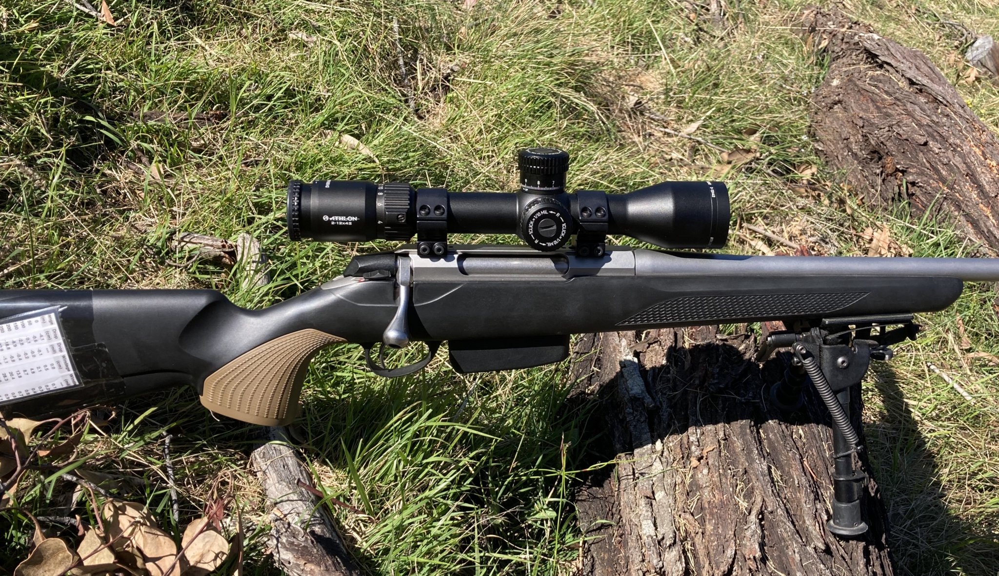

Tikka makes them both heavy and light
I have shot a half Moa group at 700 meters with this
Plenty of magazine length to play with
