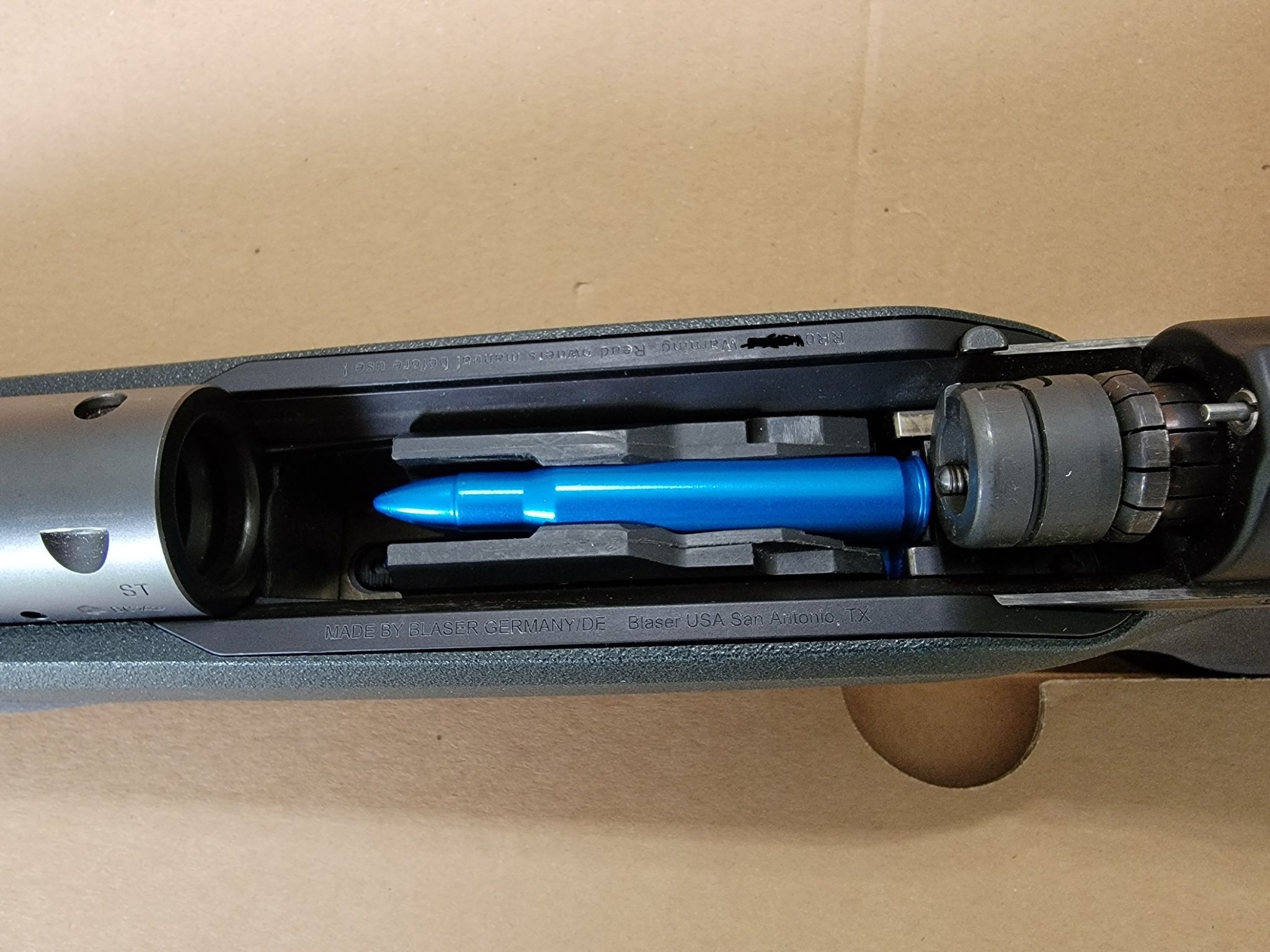

Do you need a 10 round magazine on your rifle?
If not, get a Blaser R8.
A Blaser R8 in 308 is app 3" shorter than a 700sa (and almost 4" shorter than a 700la) when both rifles have the same barrel length.
The R8 with 24" barrels in 22lr, 223rem and 338 Lapua mag has the same total rifle length.
Choice of caliber, given same barrel length, do not affect rifle overall length.
Any barrelsmith can now make barrels for the R8.

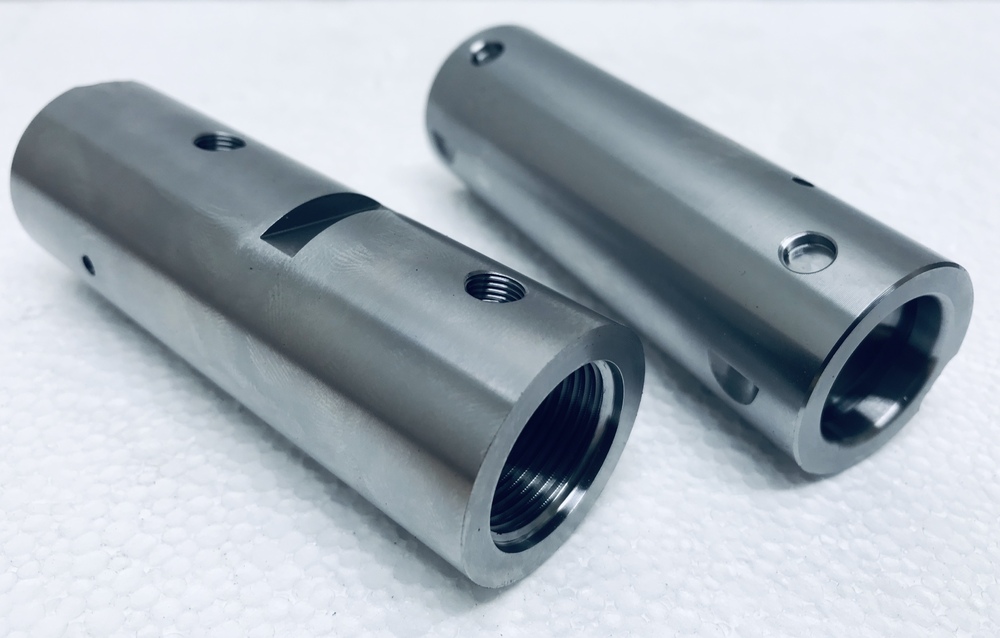

Blaser barrel extention for custom barrels:

Blaser is not very good for what we are doing, I am sure we can spin up quick with them, but nobody really uses them here so we don't have anyone I know of who works on them to fit out needs
With those extensions you might see someone try it, But the configuration of the rifle is not very US friendly at all, stock, mounts, etc, nothing works like we do here.
There is no R8 "action" to speak of ... so it would never get accepted as it currently stands, it's more lever gun style vs bolt action like we are used too

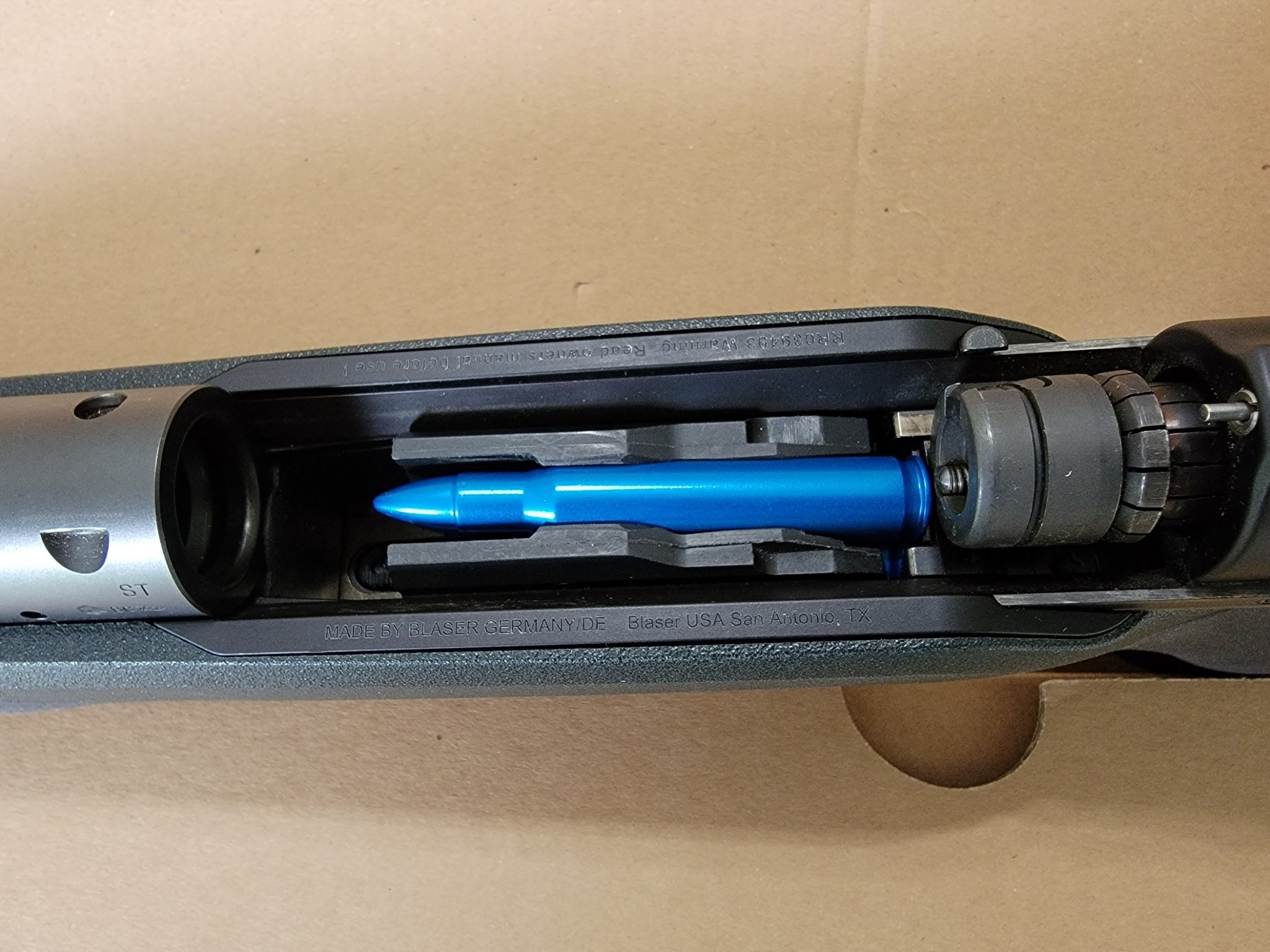

A Blaser R8 in 308 is app 3" shorter than a 700sa when both rifles have the same barrel length.

an AI AX MC/SR does the same thing regarding rifle OAL with same barrel lengths
and is way more available and usable than an R8
We were not used to the Blaser either 20 years ago.
Now the R8 is sweeping the floor with all other hi end rifles in Europe.
Here's GRS riflestock's 338LM. If the barrel was 223 it would have looked identical.
(The AI AX MC/SR is 4" longer given same barrel length and has double weight)

No where. But the topic was an R8 being shorter than a similar AI with same barrel length. So if thats the comparison then throw a DT in there and you get a really short platform for equal barrel length
The one other thing nice about the R8 is that you pretty much never have to worry about the rounds being too long, no matter how long they are.
30-06 round and there is almost an inch of clearance left in the magazine for longer rounds.
