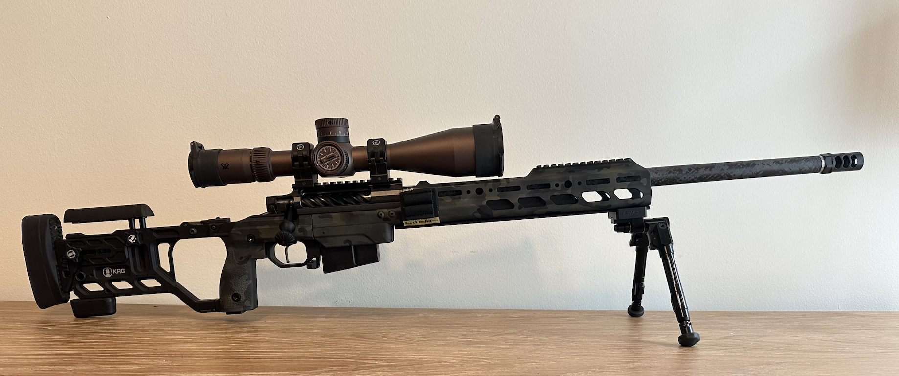

Ordered an MPA Ultra Lite folder chassis last night for my CDG. I have all the pieces ordered, but only the trigger in hand. The waiting suuuuuuuuuucks.
If you think waiting on your CDG is long, wait till you see how long it takes to get that chassis. I get it says 10-12 weeks on the website, but it could be double that (speaking from past experience).

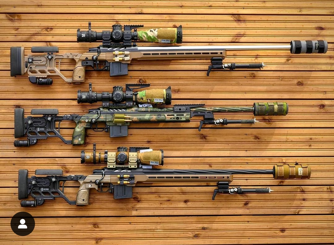

Saw this post on KRGs instagram. It's a W3 with a 'Next Shot Precision' forend. If I don't go this way it'll be a KMW zealot.
Happy to be corrected but the CDG is a R700 footprint/ inlet.
Those three KRG W3s look like Tikka T3s,( two with TRG triggers 👍) =different inlet/ footprints, so the Next Shot Precision forends are T3 not R700. So… do NSP also make the forend for a R700?

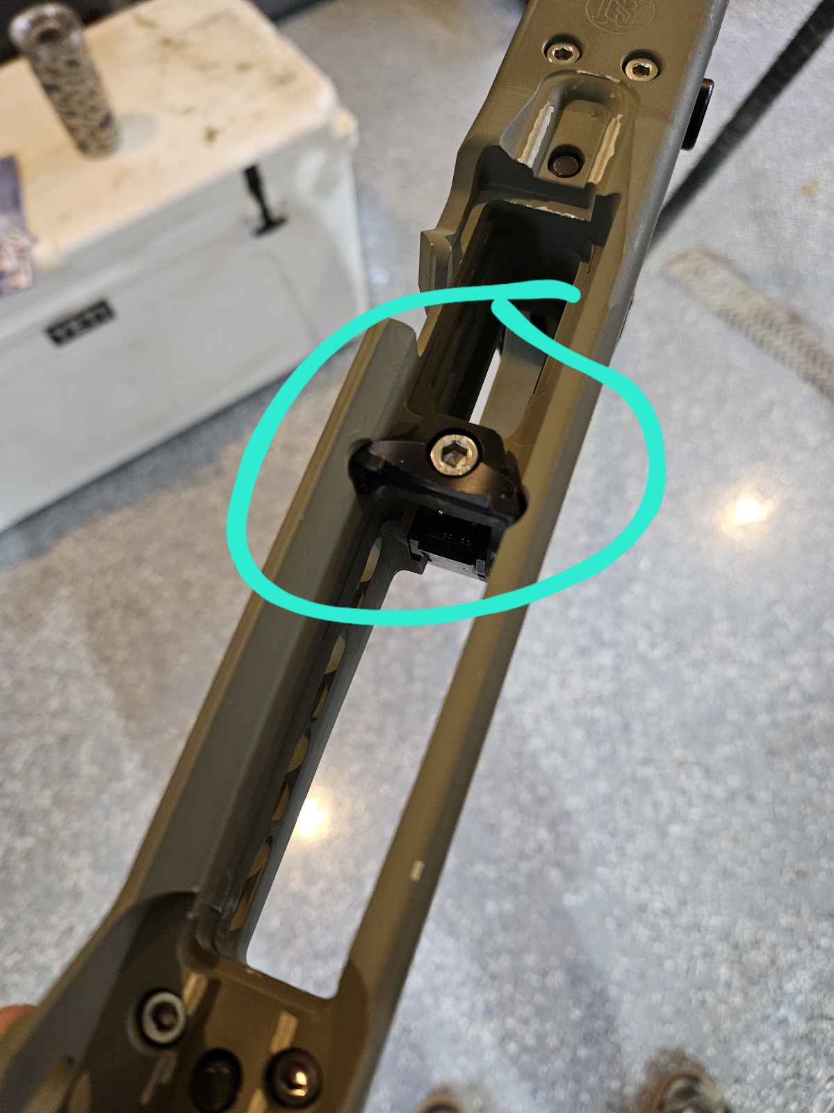

So according to Spuhr, the only necessary modification to the SICS chassis might be having to remove some material from the trigger guard pocket to avoid interference with the trigger hanger. Who is brave enough to try first? 😃
@st1650 I know an impact action will drop into an atx aics Chassis, but I don't know if the CDG hanger has a larger footprint. There is a magazine stop that's bolted in place inside the rear of the atx mag well to limit upward position of an aics mag. If you remove this it allows aw mags to sit up higher to the action. Some guys have used the GA tempest 3 lugs with aw mags in the atx chassis and removing the mag block helped. I will have my CDG barreled actions in 2 weeks, will be installing in my extra atx chassis at that time. Other than this information, I don't believe anyone has put a CDG into an atx chassis.
Update Jul 17: Atx chassis works great with the CDG action, allows use of AW and AX mags. You just have to remove the aics mag block, which is circled in second Pic.

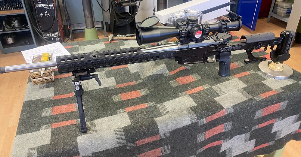

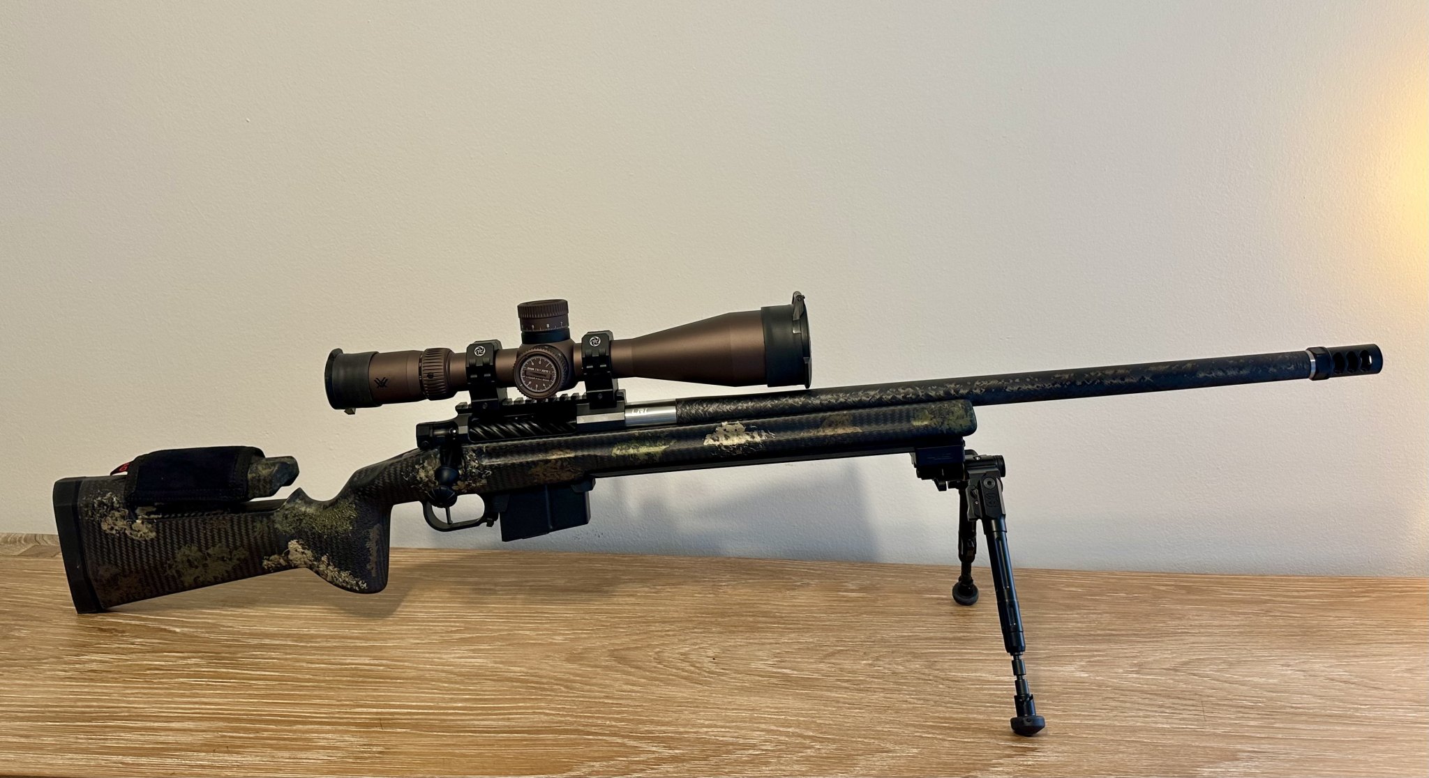

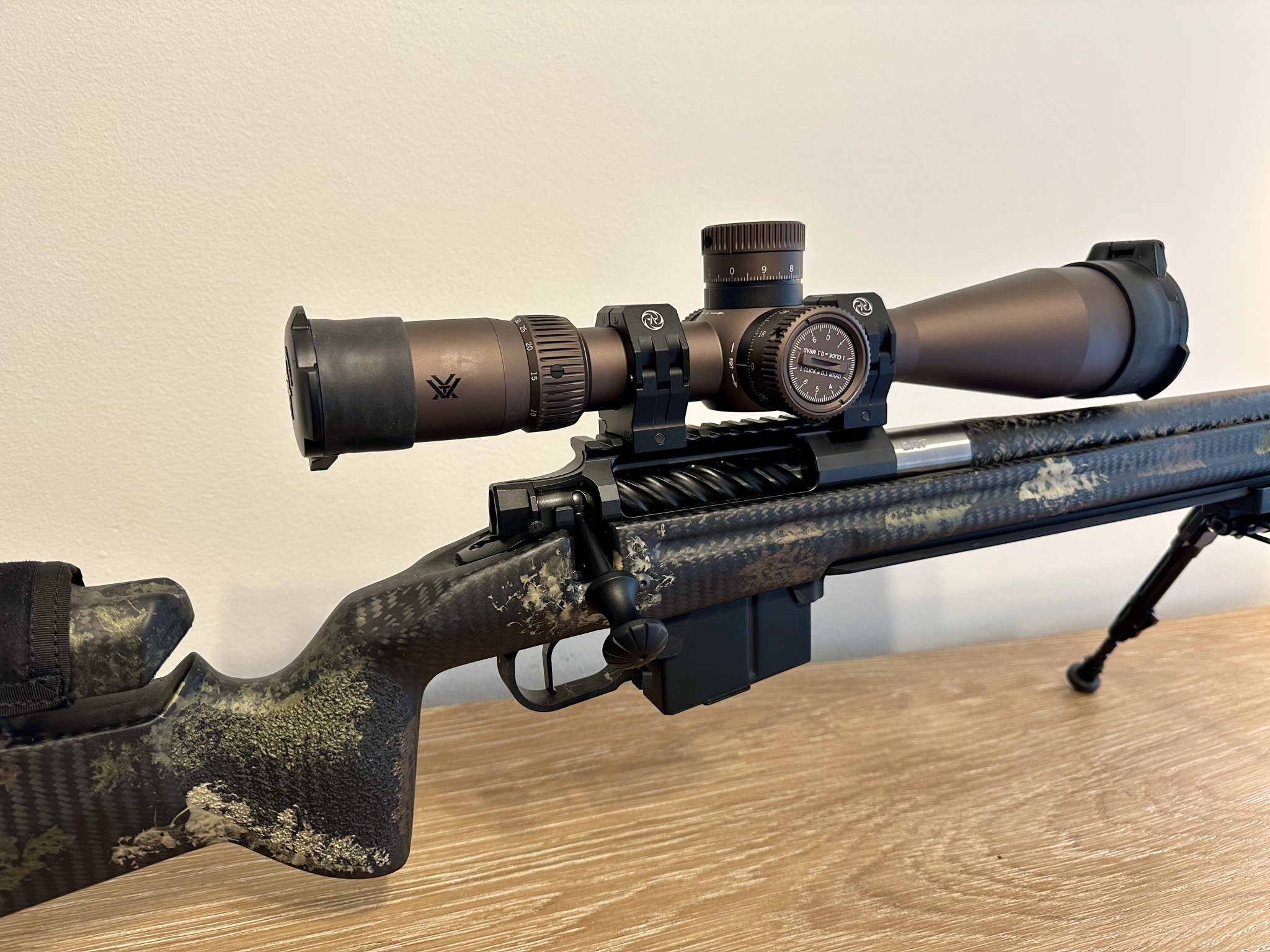

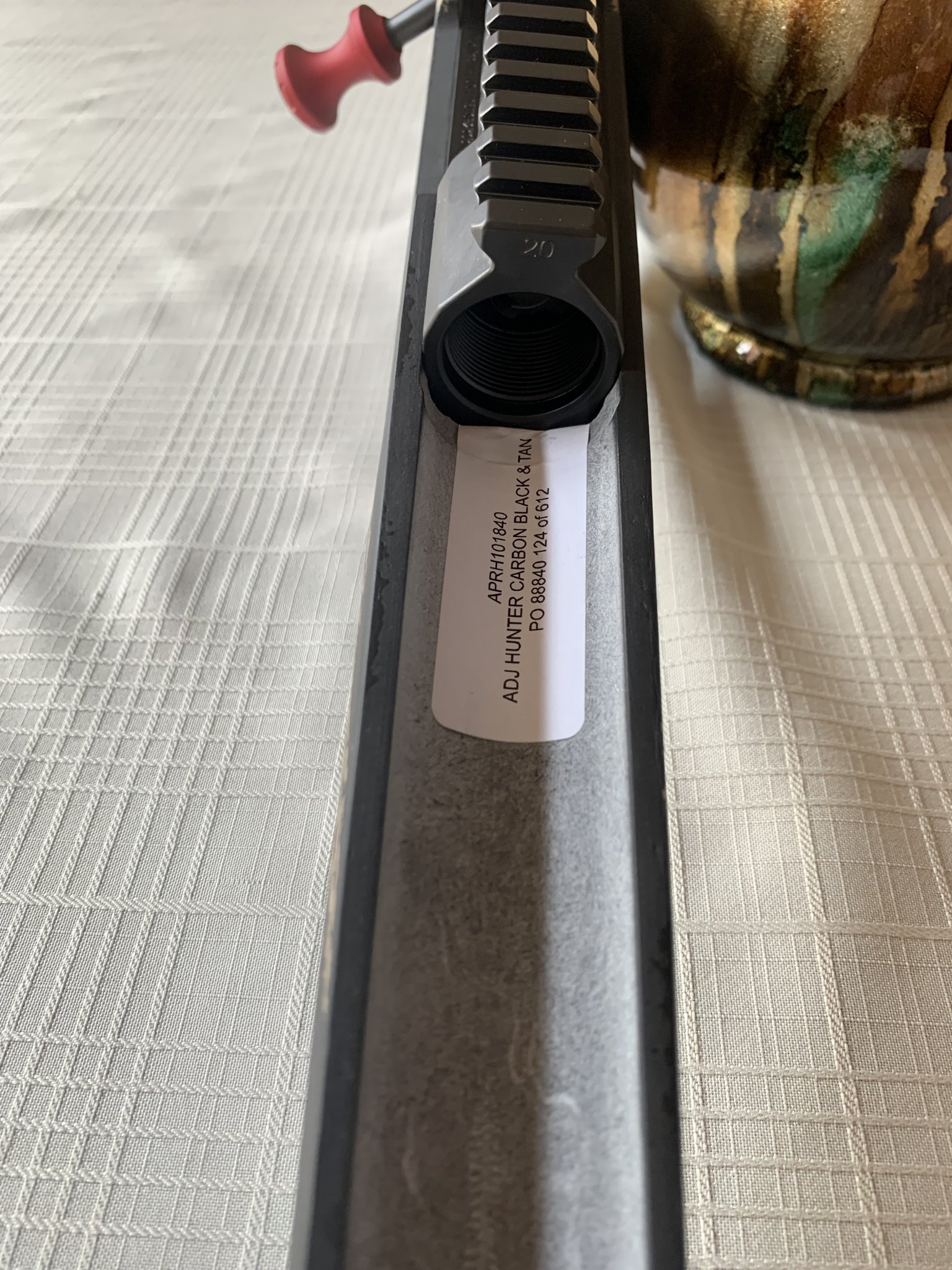

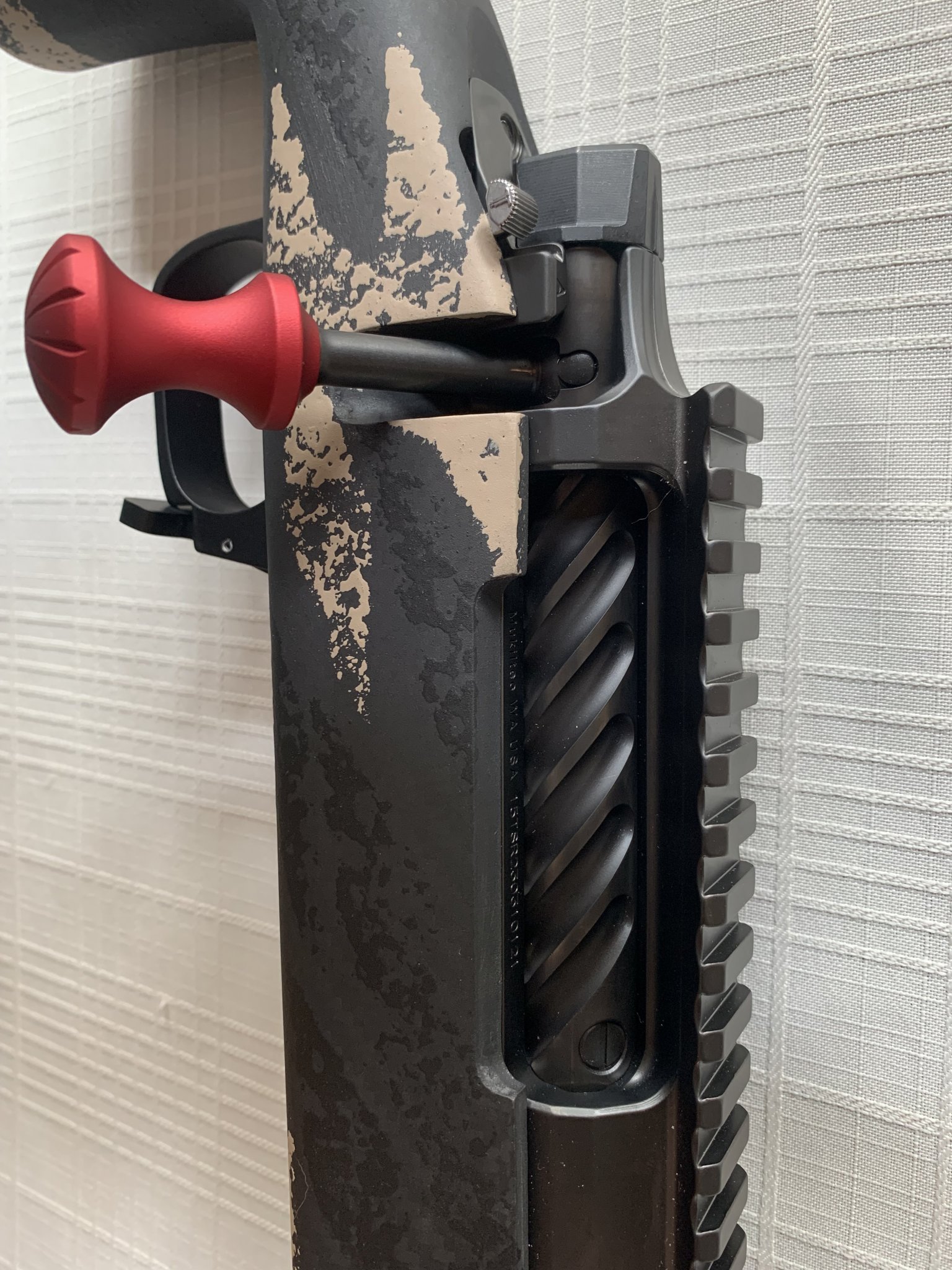

I’m trying an Alpine Hunter adjustable by AG Composite. On sale around $600 with bottoms metal. Had in a week. They only have the short action. Seems to fit nice. AW runs perfect. They stated near Proof Sendero profile.
I just need to pick a barrel now in 6 Creedmore that fits.
any thoughts?

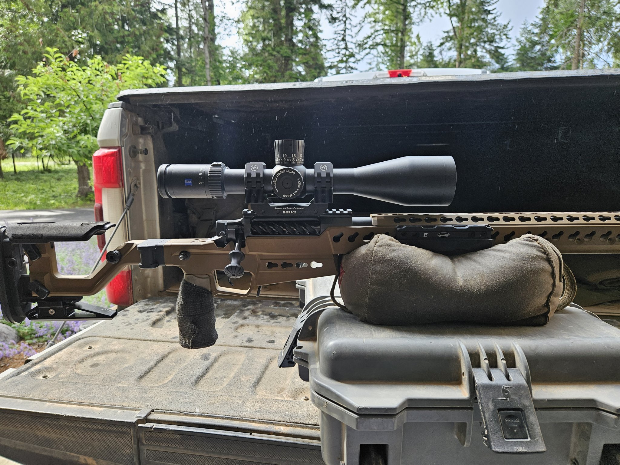

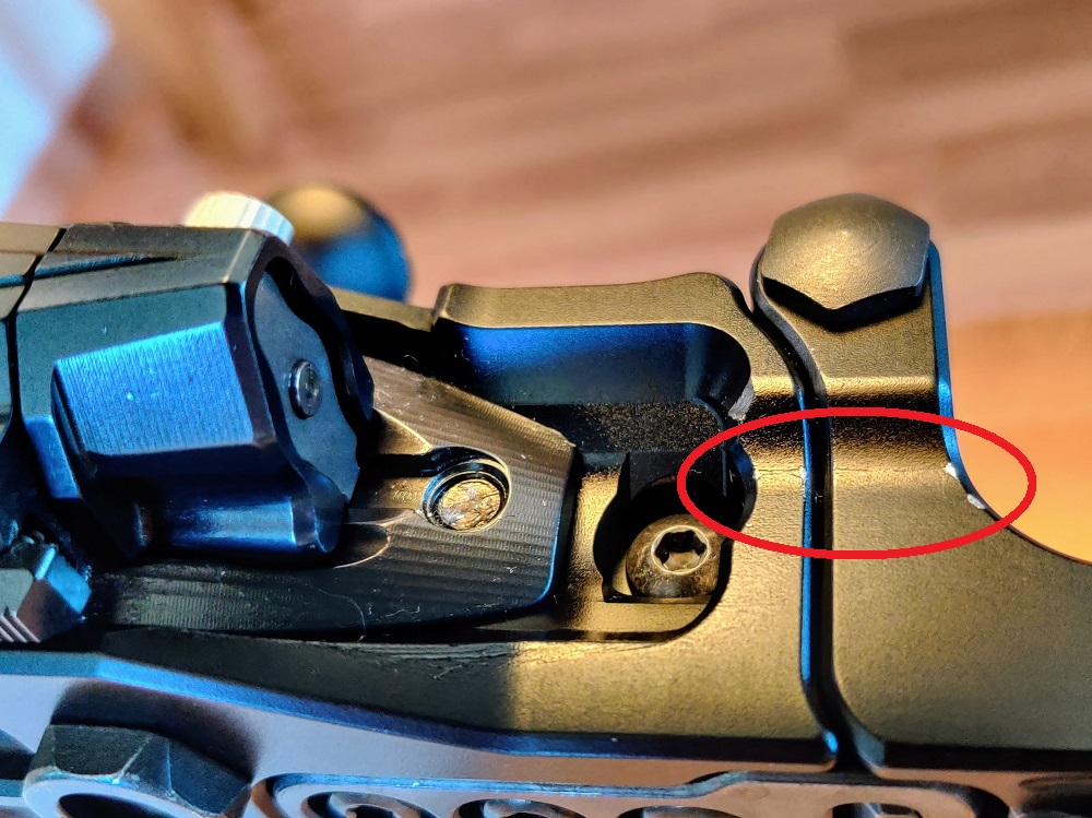

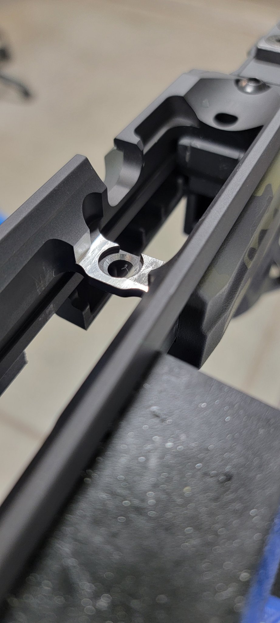

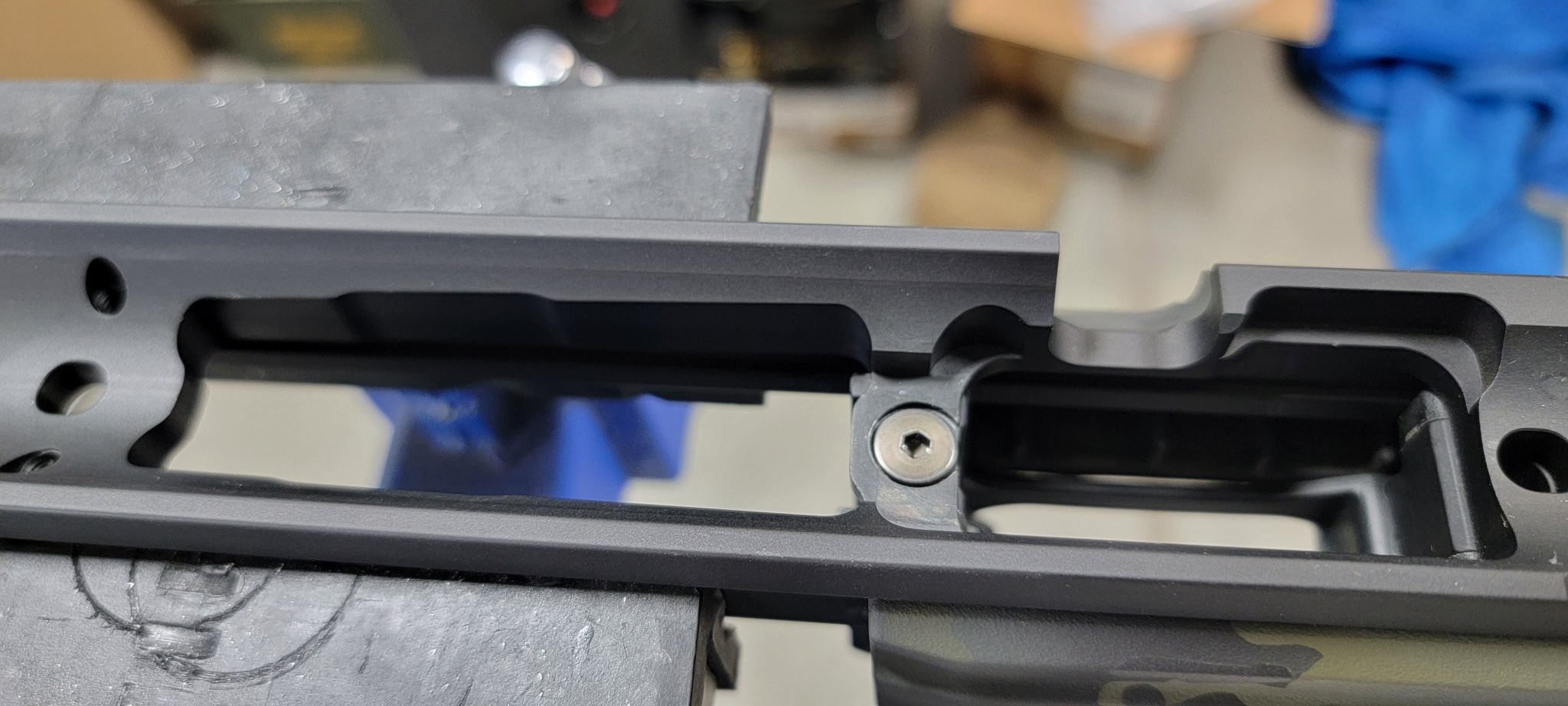

I added some pictures of the milled area on the KRG W3 (would be the same for the Bravo, same bones). Rifle is the ARC CDG with AW mag, Trigger Tech Special 2 stage and ARC Medium height rings in a Manners LRH as well a KRG W3. Barrel is a 24 inch carbon Proof Sendero prefit by LRI.
If you are looking for more good info and or inspiration, check this thread out as well. Page 1 and 2 both show the KRG material removal done by hand/dremel by another gentleman. I personally would try to avoid doing it this way and considering potential resale value motivated me to have mine milled by a professional.
Hope this helps

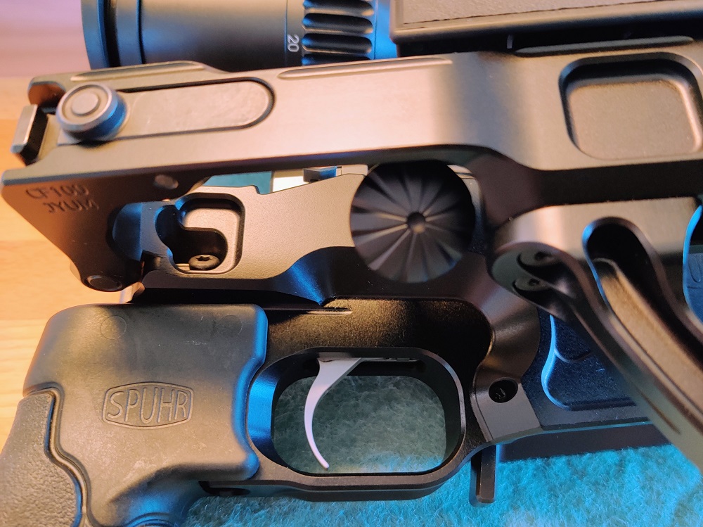

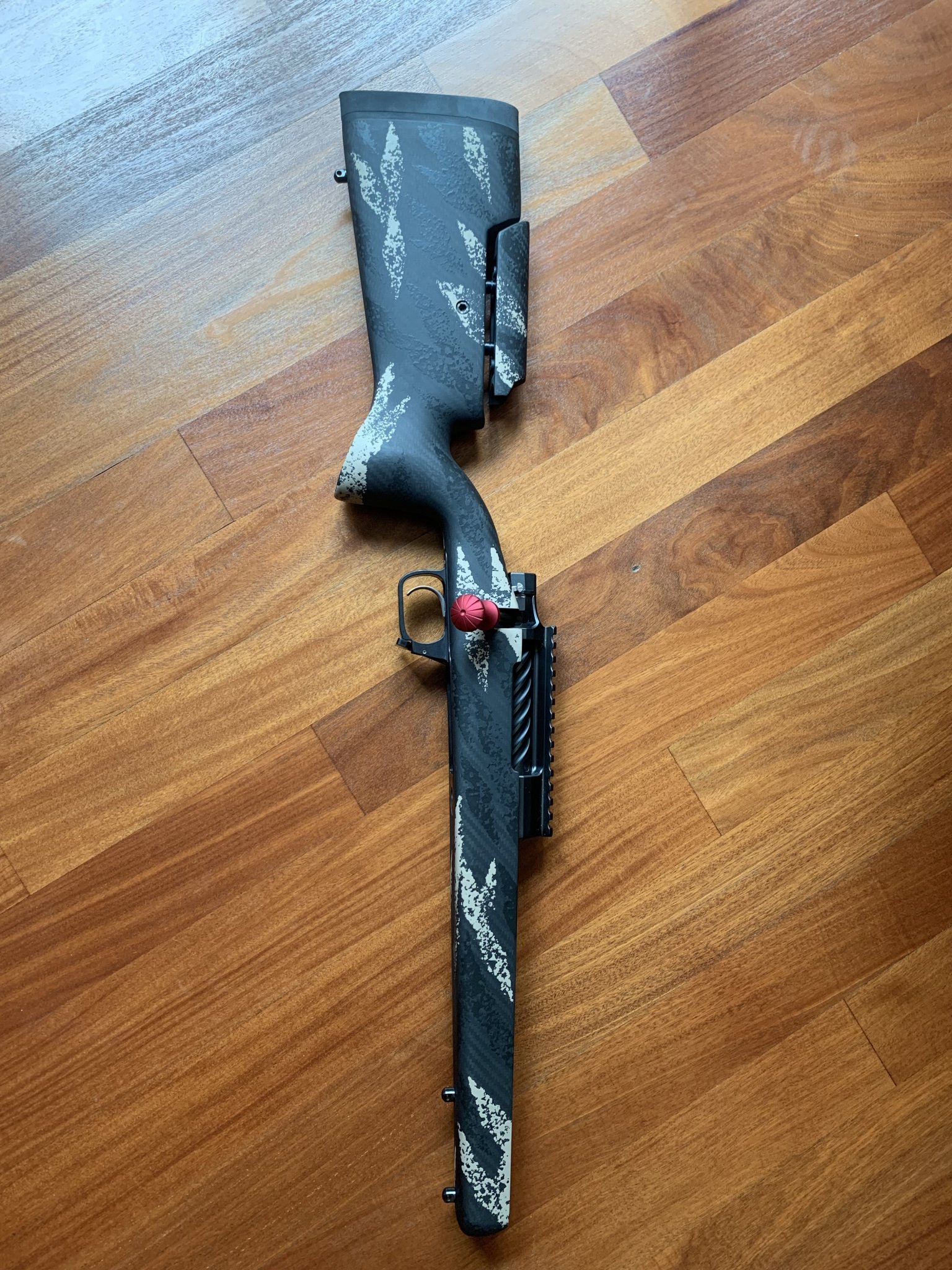

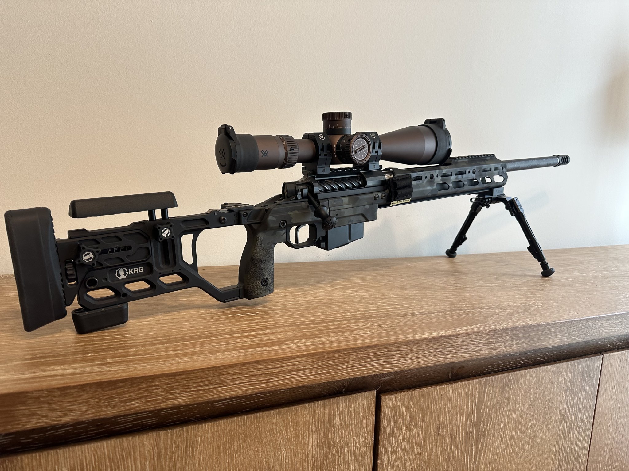

Nice that is a good looking setup. With the stock In the folded position, is there clearance for the bolt handle?
Unfortunately, it doesn't quite work. It just barely doesn't clear the bolt knob. Maybe with another shape knob it might work, this is the hour glass shape.
Another minor point: the bottom of the bolt ever so slightly drags across the top of the chassis and takes off some of the finish.
Unfortunately, it doesn't quite work. It just barely doesn't clear the bolt knob. Maybe with another shape knob it might work, this is the hour glass shape.View attachment 8662386
Thank you for taking these photos and pointing that out
