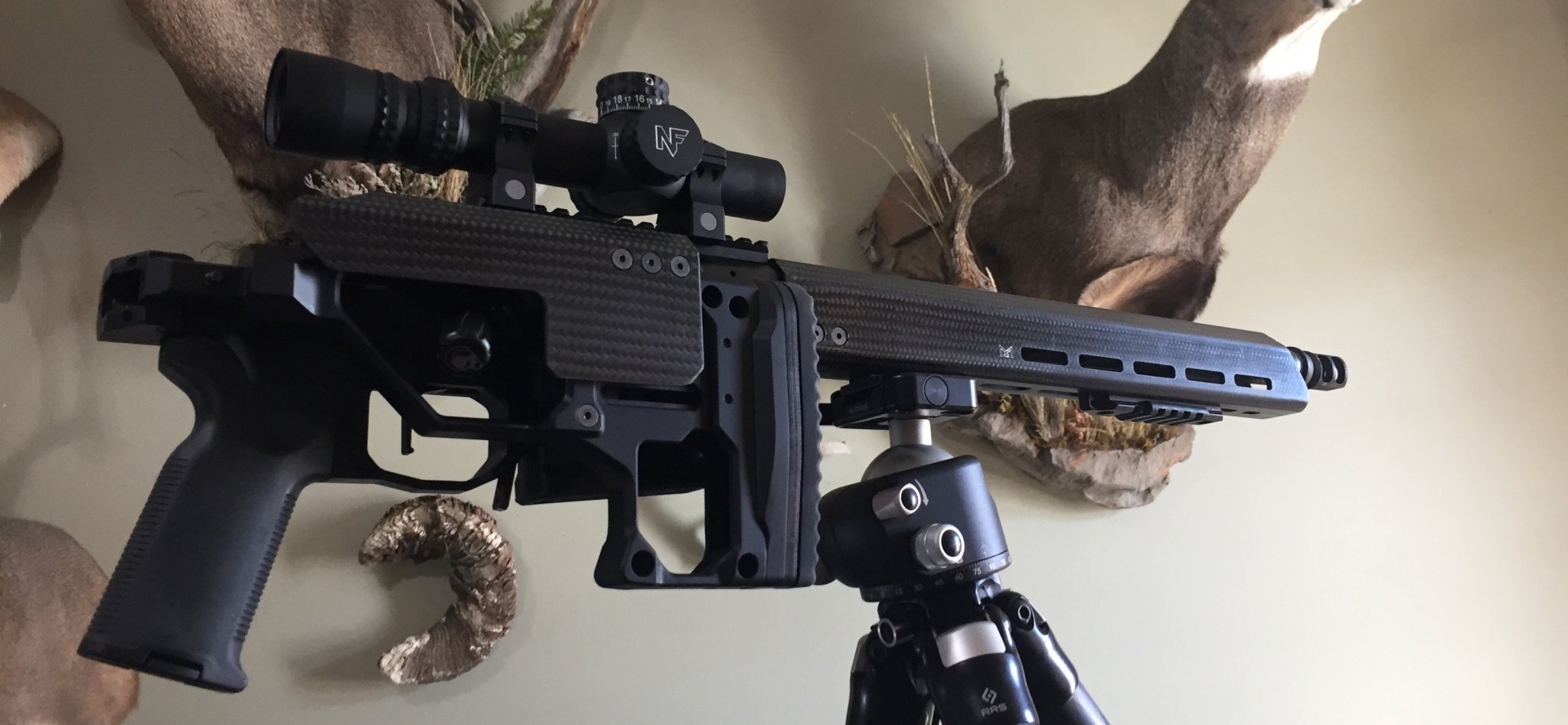

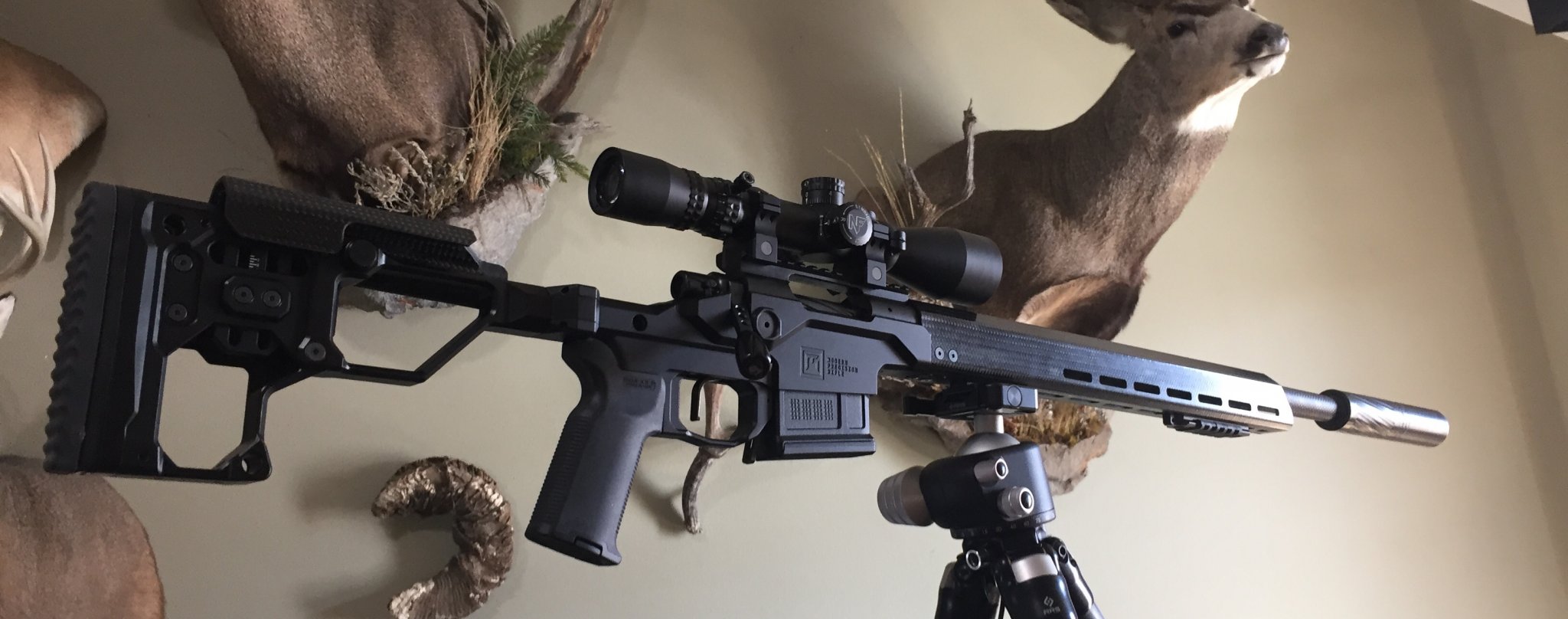

I had a total knee slapped in a month ago, so I put together 2 projects I had been thinking about for a while during my rehab.
I came in under $7k for both setups for everything. K2 grips, RRS ARCA Plates, TBAC Brakes, M-Lok QD swivel attachments, NF UL mounts. 1-8 Mil NXS on the 16” .308 and 2.5-10x42 Mil-r on the 22” 6.5CM
Now I need to get out and shoot’em!

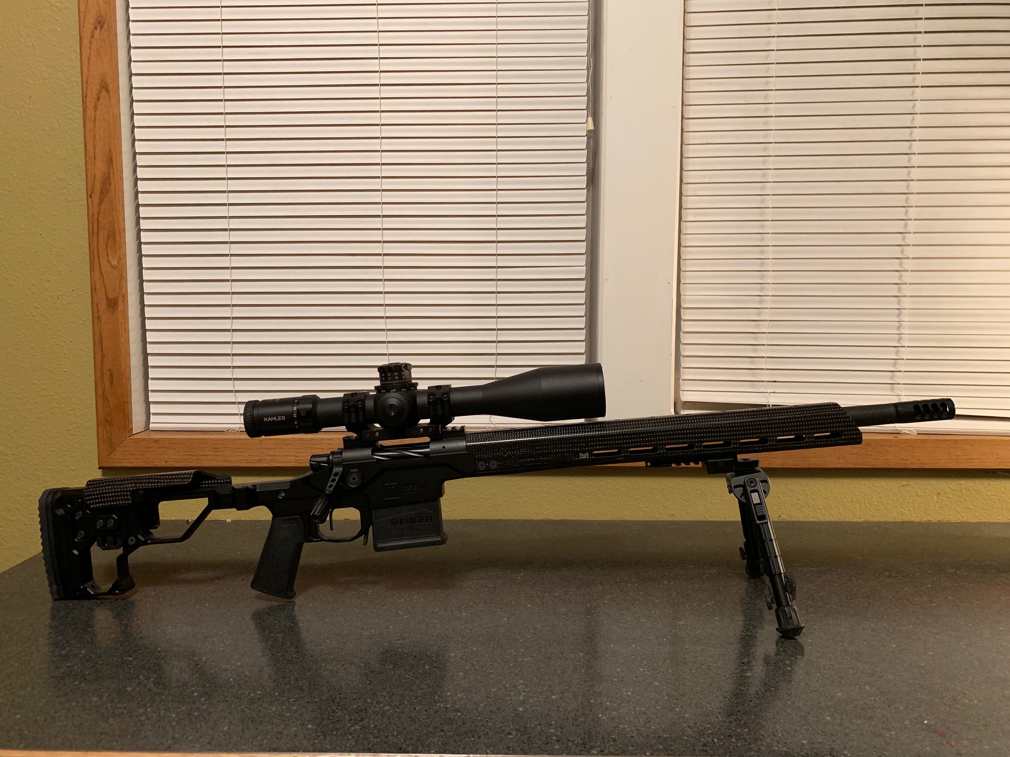

I have a never fired 20" MPR .308... really wish I had a 16". Anyone interested in trading?
