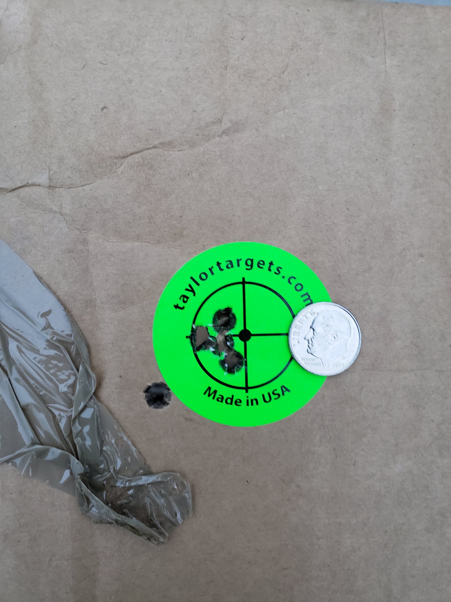

The 143 Precision Hunters shot 1/2 MOA in my PRC MPR. The picture is five shots. The first was lower left and the next four were shot after adjustment.

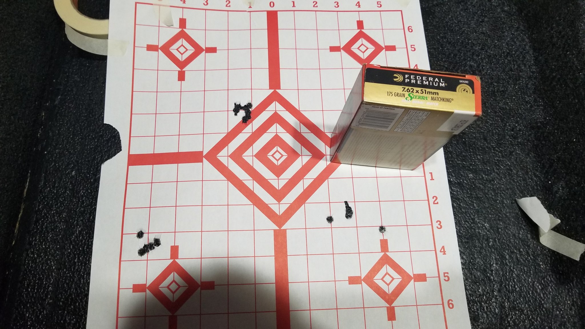

Maybe it's just luck but here's my CA10 barreled AR10 home build. Is it just me is it laying down 3 five shot 1/2 MOA groups with factory ammo with the exception of the shot I pulled? Perhaps I just "got a good one" lol.

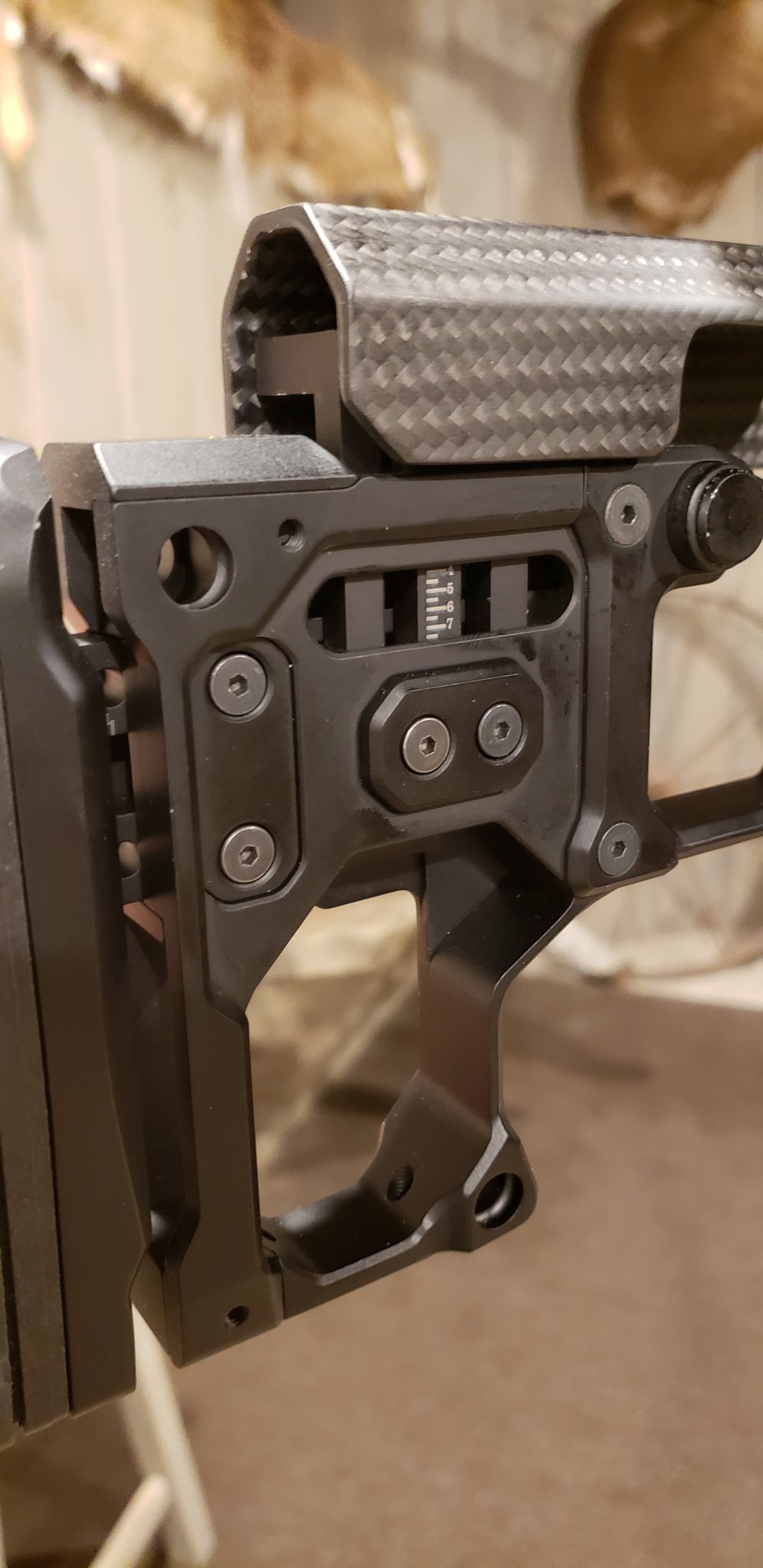

I can say I am not a fan of the stock grip . Have not decided on what one to get . I have been reading this thread and others and i see a few different ones that are being used .. Might be better to start a new thread on that ?? Do not want to hyjack the thread

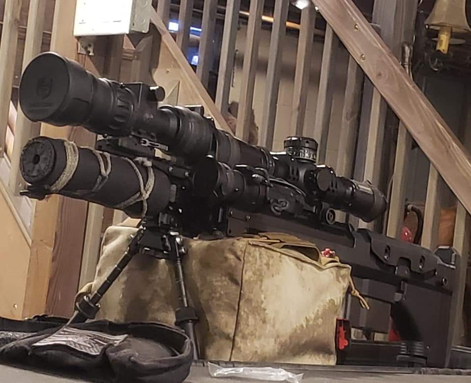

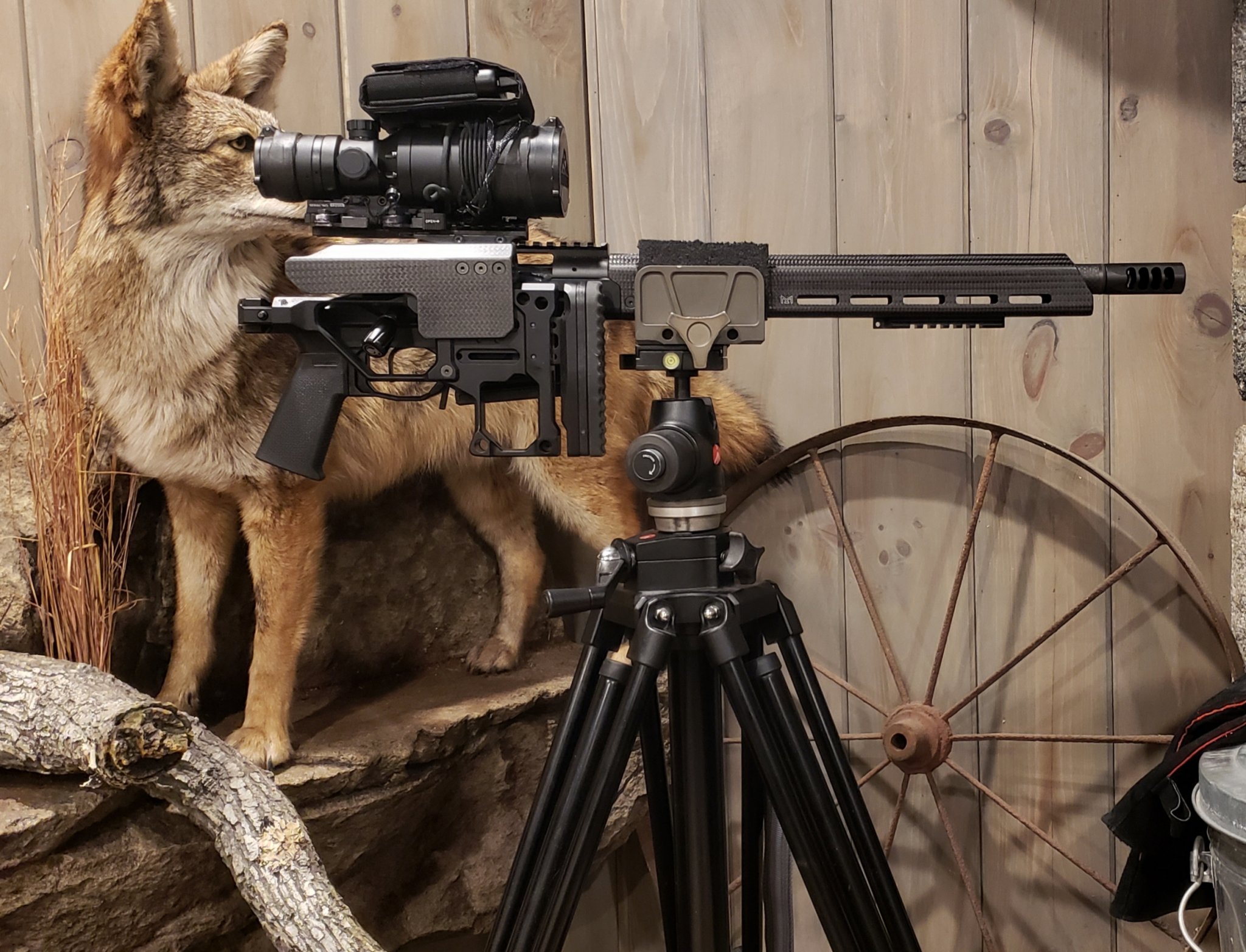

I needed a lightweight, preferably collapsible solid bolt-action sniper system for a dedicated night time thermal rig. This gun fit the bill. I opted for my favorite .308 caliber in a 16in barrel as this kept the overall length and weights minimal. After receiving the gun and holding it for the first time I can comfortably say, it feels like an empty water soaker. It was light and it handled like a toy. When compared to my 20 pound desert tech SRS, I couldn't imagine how this hollow gun can possibly shoot and I figured the recoil would be counterproductive to accuracy I was seeking. I almost sent it back immediately but figured I might as well sit with it over the weekend to make sure I didn't have a change of heart.
I mounted my thermal on the gun, adjusted the stock, put on my "rifles only" sling and started to hold over targets to see how it felt from a standing and unsupported position which was the objective of this project to begin with.
It was at that exact moment I realized this gun was magical. I was able to hold the gun on target for minutes without any effort. It feels like someone was holding the front of my barrel steady for me. . My desire to try this gun outweighed any chance of returning it.

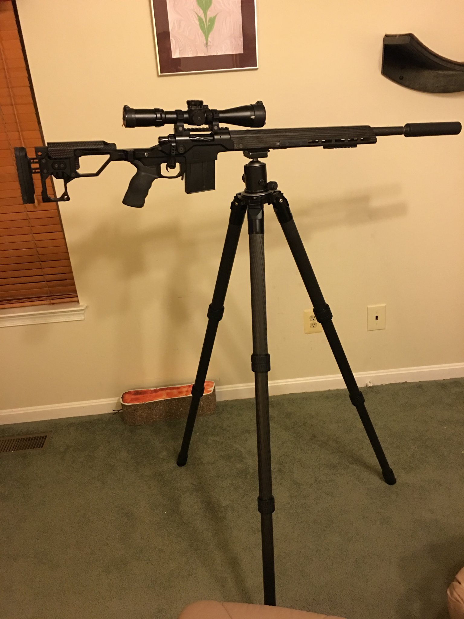

I had the same problem with the MPR and the hog saddle, you have to put a foam shim in there because the hog saddle doesn't fit some of the slimmer modern handguards on AR's and the MPR.
But I really like the MPR.
It's a small world. lol. I used dense rubber ( 3/8") from tractor supply. It really grabs both the gun and the saddle nicely.

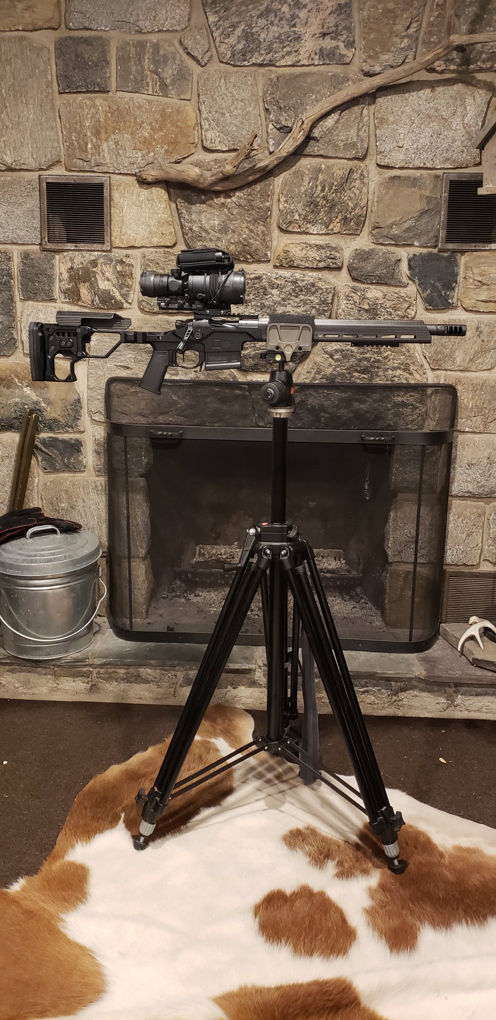

Im using the RRS adapter. However that is for an Arca Swiss head. Not sure if anyone makes one for an RC4.
http://www.reallyrightstuff.com/M-LOK-Adapter-Plate
I looked everywhere, RC4 is a wider style connection so none really uses RC4 for applications like this.
Than I read (on magpul site) that these tripod devices should only be used on metal handguards. Being the MPR has a carbon fiber handguard I talked myself out of swapping systems.
I can tell you, my prs rifle will have the connector as you have pointed out.
I was a little hesitant using it on the carbon handguard. I did notice it is much thicker on the MPR than other carbon handguards like lancer systems. The MPR is relatively light and the mount is on a balance point so that should help. I used it hunting this season without issue, and I don't mind being the guinea pig.
Right, I agree if your balanced your probably good to go!
