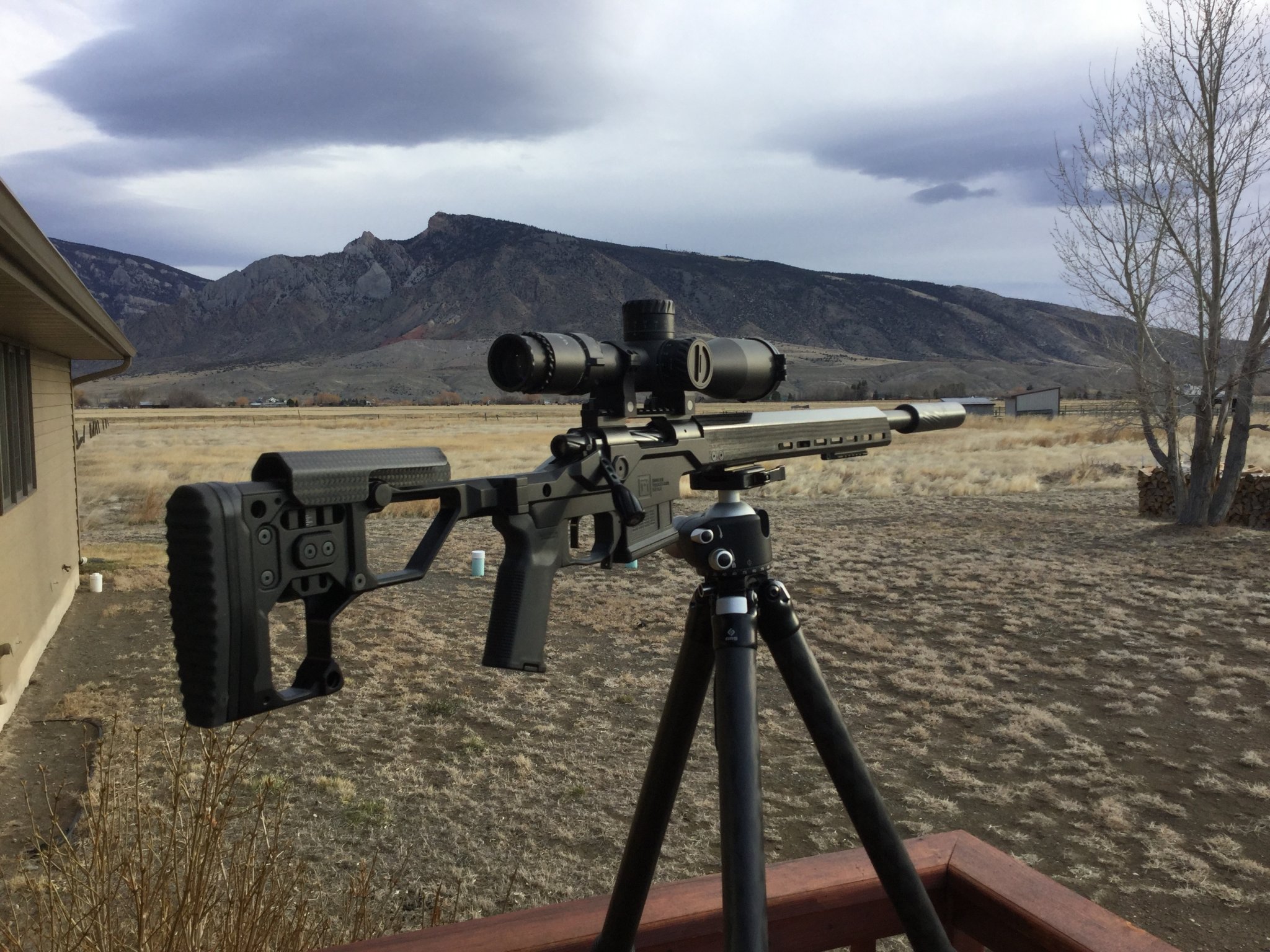

Finally got mine all together, 16" 308 with Leupold Mark 5HD 3.6-18X44, Spuhr mount and SiCO Omega can, easily shooting MOA or under with my handloads. Loves 155gr A-max's. Happy customer so far.......
What rail do you have on your gun? Is it the stock one or an aftermarket. I've never seen a stock one with the arch in the loading port like yours.

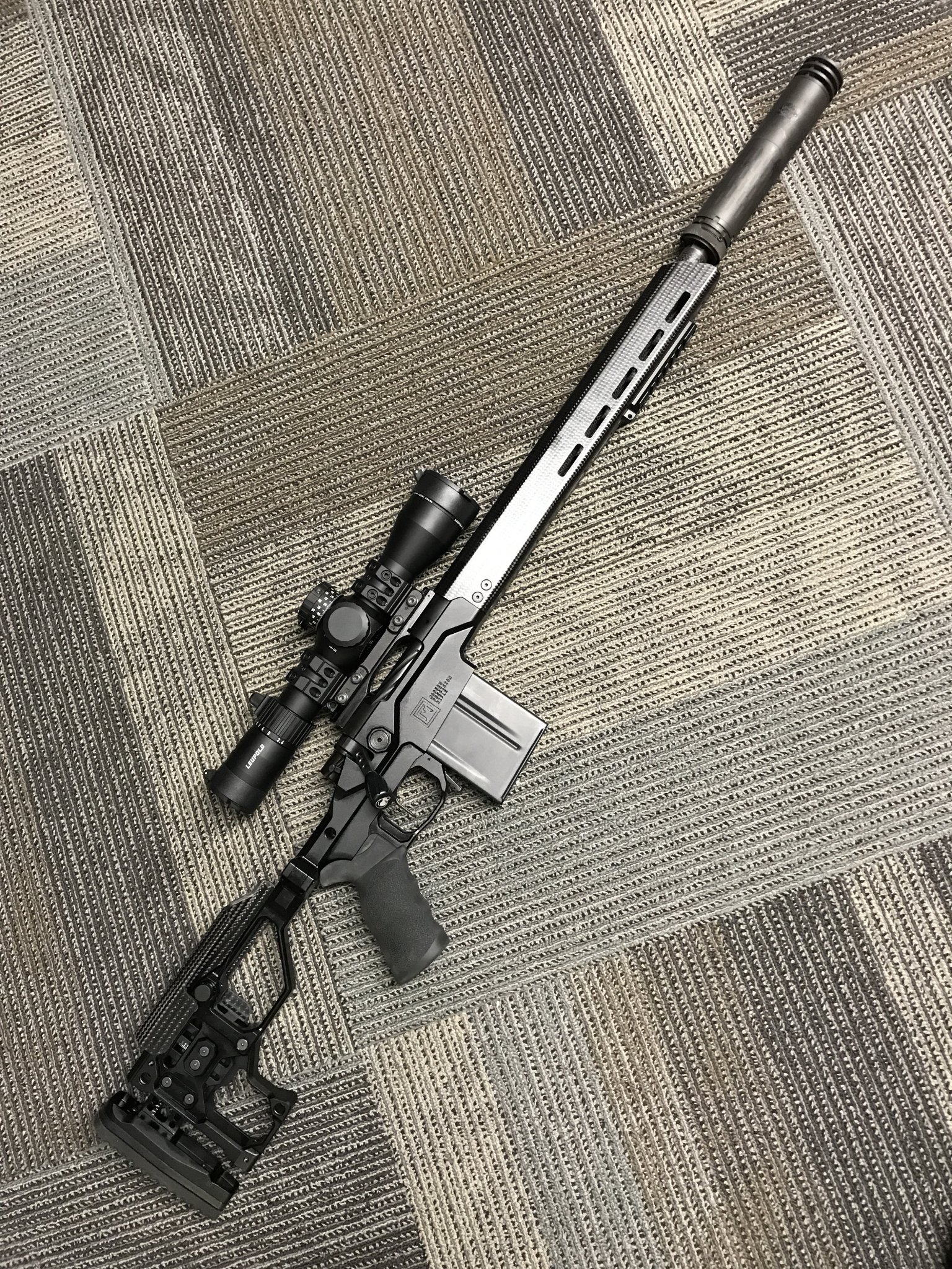

Man, we think alike! Mine also has the Ultra 7, waiting on the TBAC bipod.
They are nice rigs
Yes they are very nice. I saw it at Sportsman's Warehouse and had to buy it. It definitely feels like a complete "system"
rather than just a bunch of parts thrown together to make a gun. The action is a little rough, but it shoots great and feels even better. I'm VERY impressed with it.

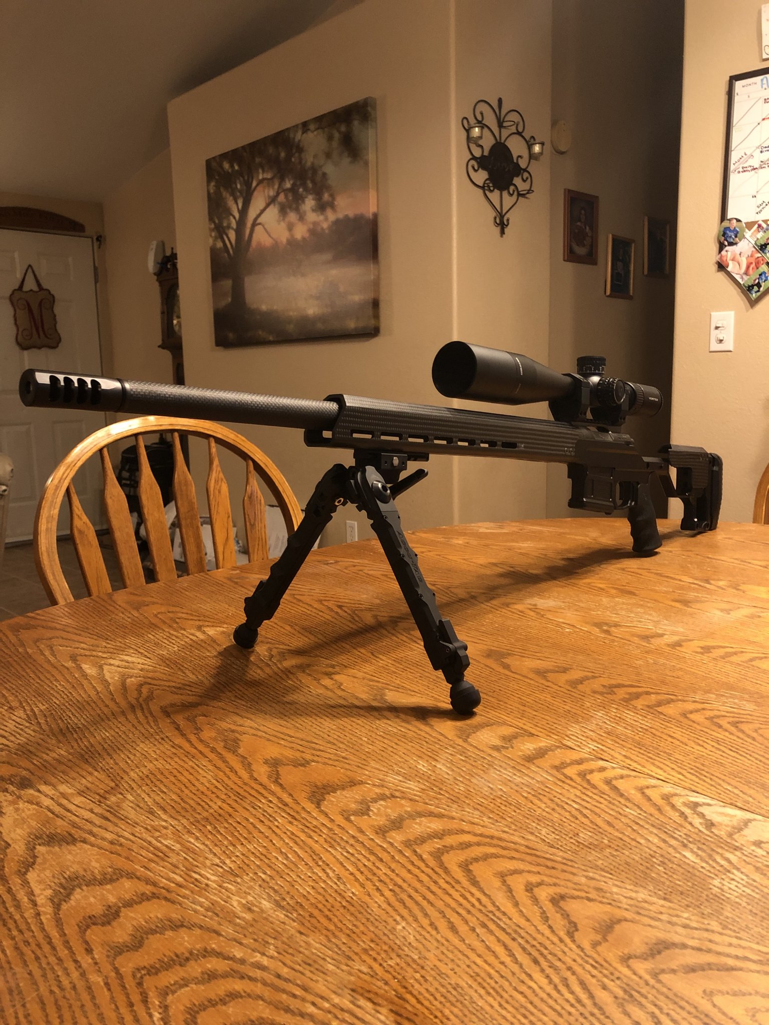

Picked it up and got it together today. 6.5 CM with vortex viper pst gen 2 5-25x, accu-tac bipod and a hogue grip. Taking it out on Sunday.
7068283
The handguard looks close to barrel ? Do they ever touch when in field shooting?
The accu-tac is great. Extremely stout. The cant lever and larger feet are huge compared to the gen 1’s thumb screw and tiny rubber feet.
Yeah; I have the Gen 1 and do not like the can’t lever.

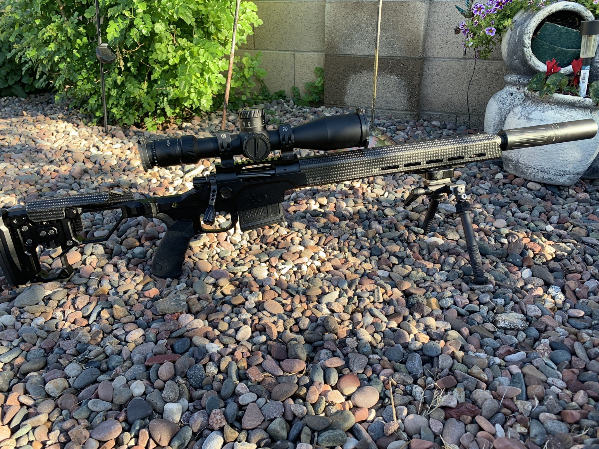

Finally received my mpr in 300NM, pretty impressive set up in my opinion.
