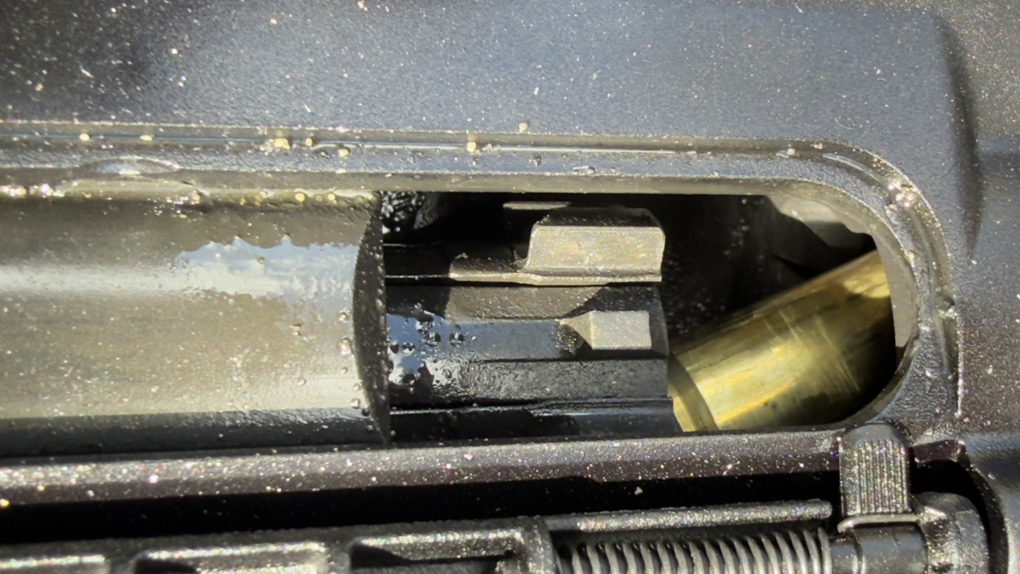

I have always wanted a 9 mm upper or 9 mm subgun for range plinking. I was never the biggest fan of straight blowback uppers for multiple reasons, most namely they are loud, and they tend to have a higher recoil impulse than locked breech systems. I also didn't want to deal with a mag well adapter or dedicated lower.
Anyways Midway had a sale on CMMG radial delayed uppers several months ago, and I picked up a 5" complete Banshee upper. I finally got around to shooting it.

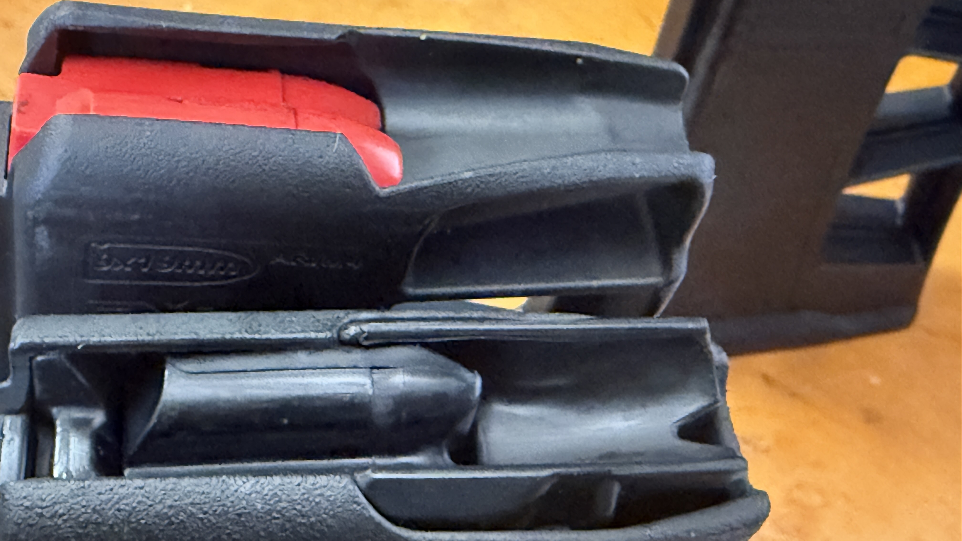

In short, it runs great. Digested 115 and 147 hr loads without issue. The CMMG magazine that goes in a standard AR magwell worked without a hitch, and the BHO worked too. It suppressed reasonably well with a Primal 46.
I used it on a standard AR lower with a Geiselle SD3G trigger and standard carbine buffer. There were no trigger issues either.
I didn't shoot it enough to conclusively establish it's reliability but so far it has been off to a solid start.

To be honest I don't know what kind of ejector it is. The ejection pattern is 4 o'clock and very brisk, and there did not appear to be any issues with weak or inconsistent ejection between different ammo either.
I am not bothering to do anything with the buffer, spring, or buffer tube. This pistol lower is shared with a 12.5" 5.56 upper as well and I don't want to induce any reliability issues with that. I don't shoot subgun or pistol enough to bother with optimizing the setup if it runs fine.
Reactions: Redlion
Keep track of round count. The spring ejector AR bolt style have a life span of about 300-500 rounds before ejection goes down the toilet. The spring tunnel for the ejector will be full of gunk and the spring will be too short to eject the shell. They will send an extra strong spring and it will do the same after the same round count.
