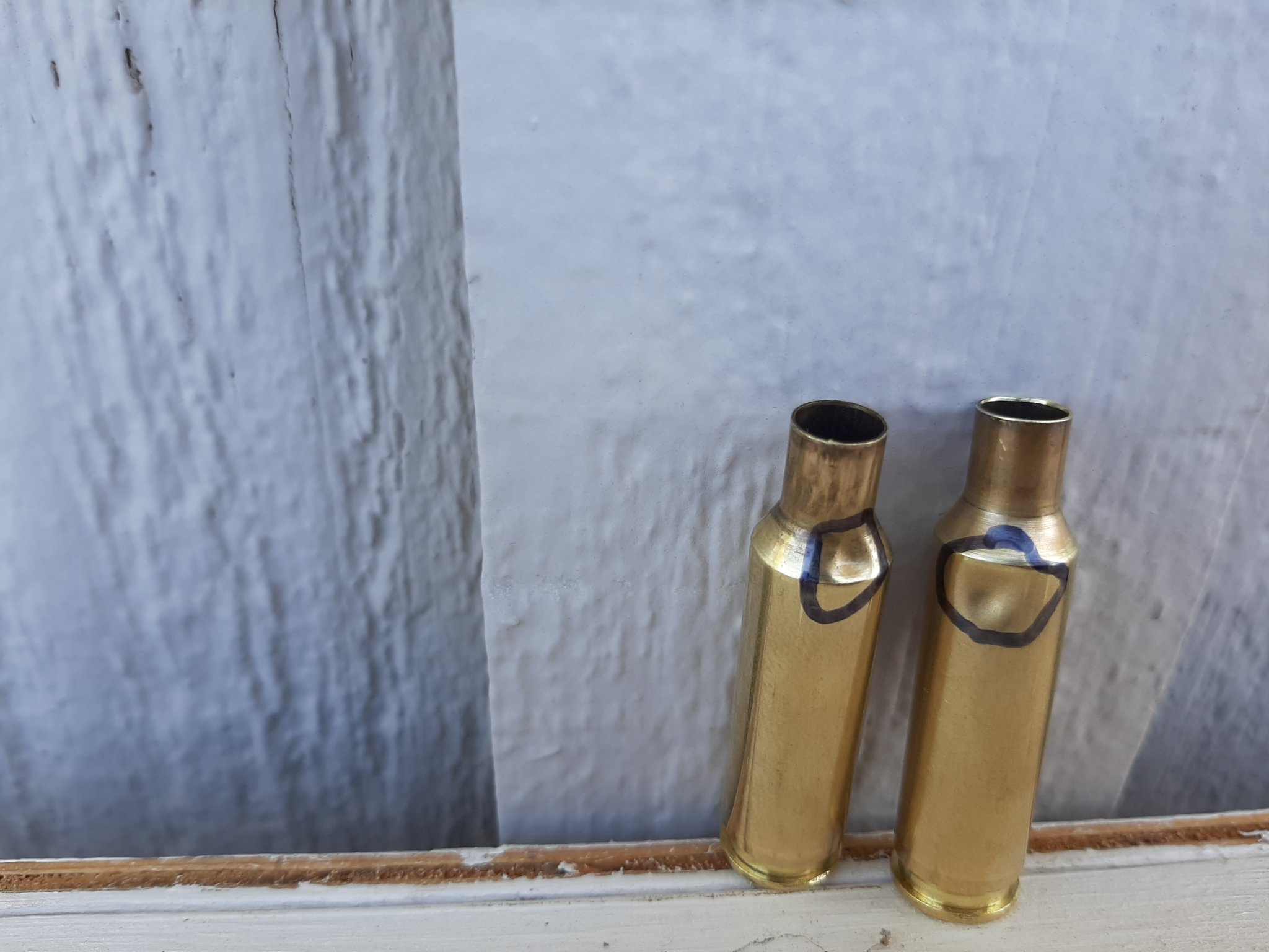

Could you look at these bolt rifle cases for me, trying to figure out why the dents?
want2learn
Sep 7, 2013
1,249
495
Hi, this is from a bolt action rifle chambered in 6.5x47 Lapua....new barrel. This is the 3rd time i've reloaded these cases. They're Lapua brass. I never exceed the book values for appropriate charge weights and case dimensions.
I'm trying to be very careful and so i took the time to look at all the cases prior to priming them and saw these dents. I circled them so that they'd be easier to see.
The dies are custom honed Forster dies which are pretty new and always cleaned after each session.
I always run a dry patch before a shooting session so it's not residual oil or grease.
Not sure what's causing this. Appreciate your help. thanks
I agree, lube dents. They won't hurt anything and will go way when fired. I usually keep a rag near the press when I'm sizing brass and wipe off the shoulder and neck area before sizing.
