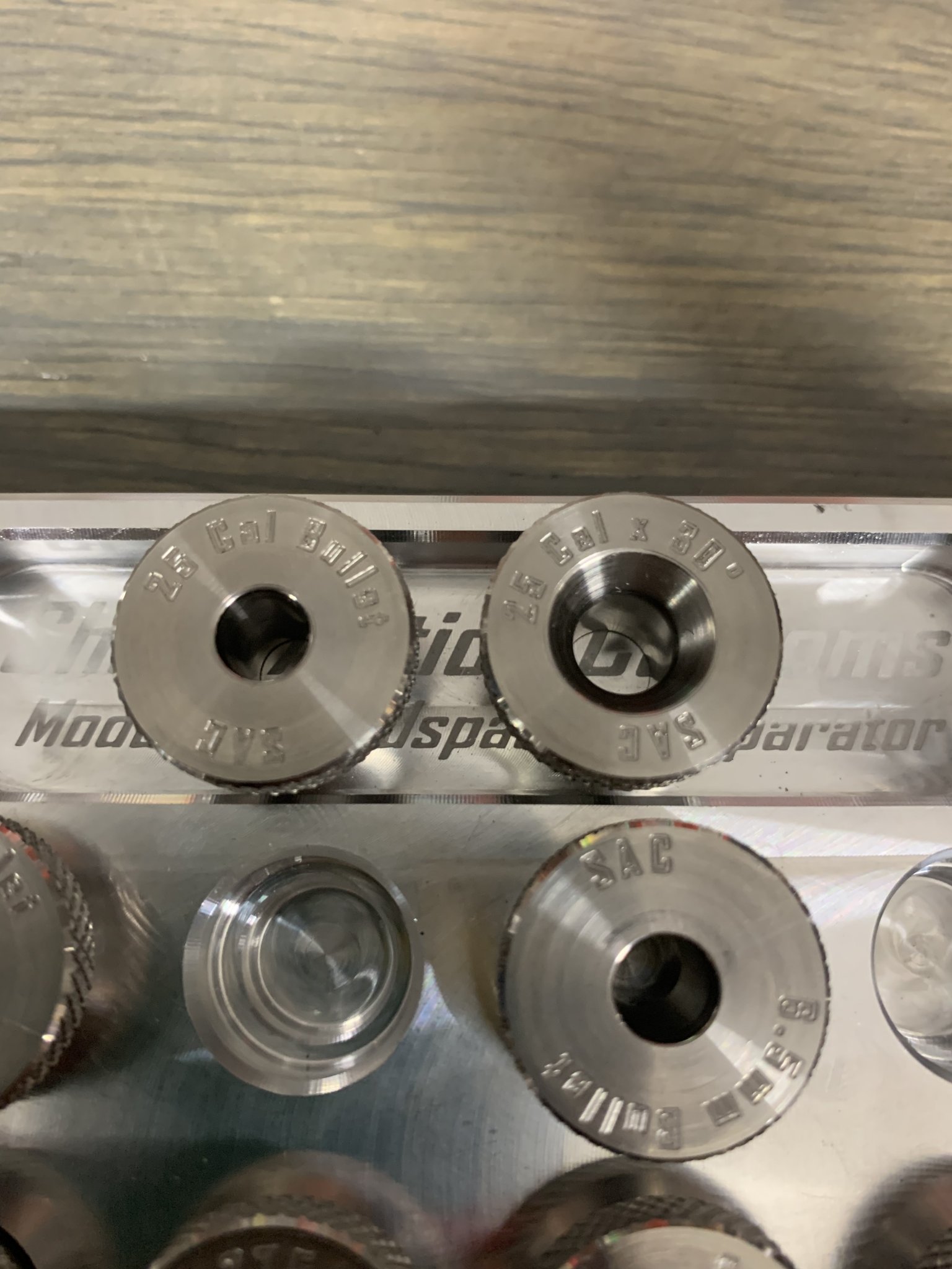

While it's a tiny fraction of the user base, I would love to see .25 cal mandrels to accompany the .25 cal Creed neck/shoulder bushings.
It also strikes me that... couldn't turning a BRA die into a BR die just be a matter of a different bushing? Really, seems like you could maybe make a single die and service all the BR based cases just by swapping bushings. I'm probably missing some detail that prevents that, but...
I haven't looked recently but I believe they were selling those mandrels. I currently use their mandrel with my 6GT die and can't use anything else anymore without complaining... 😆
