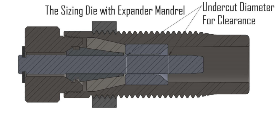

They are machine tool collets & meant to be tightened with a wrench.
I'd be surprised if you could get it tight enough by hand not to slip.
I did.
Just kidding. I'm gonna use a wrench next time. ;)
Reactions: RS14 and cg1shark
There is also supposed to be an O ring in there correct? If so, either I lost it or it didn’t ship with it.
In the video there is two fibre washers and a o’ring. But it looks like the purpose of those is to stop the collet being tightened right down and the tapered fit binding together. They say they are not needed for it to work. If your decapping pin is moving, not being able to tighten the collet up as much won’t fit that.
Maybe check the die for the tapered sleeve the collet pushes into.
I’ll try a wrench and see what happens.
Might just be my lack of manhood.
Reactions: orkan

Anyone else have an issue with the depriming pin getting pushed up?
I think I’m missing a piece inside the die or something.
We added the wrench flats on the "Knurled Top ER Cap" at a later date to allow the user to apply more torque. If your die doesn't have wrench flats, we can swap it out no problem.
If you have wrench flats and you feel like it is tight, but the pin is still slipping, there is a chance that we shipped a 1/4" ER11 collet with the die instead of the 6mm ER11 collet which could cause that. We have lots of ER11 collets in the shop for all the expanders and different caliber decapping pins. So shoot us an E-mail at [email protected] and we will ensure you're taken care of.
Mark.
Mark.

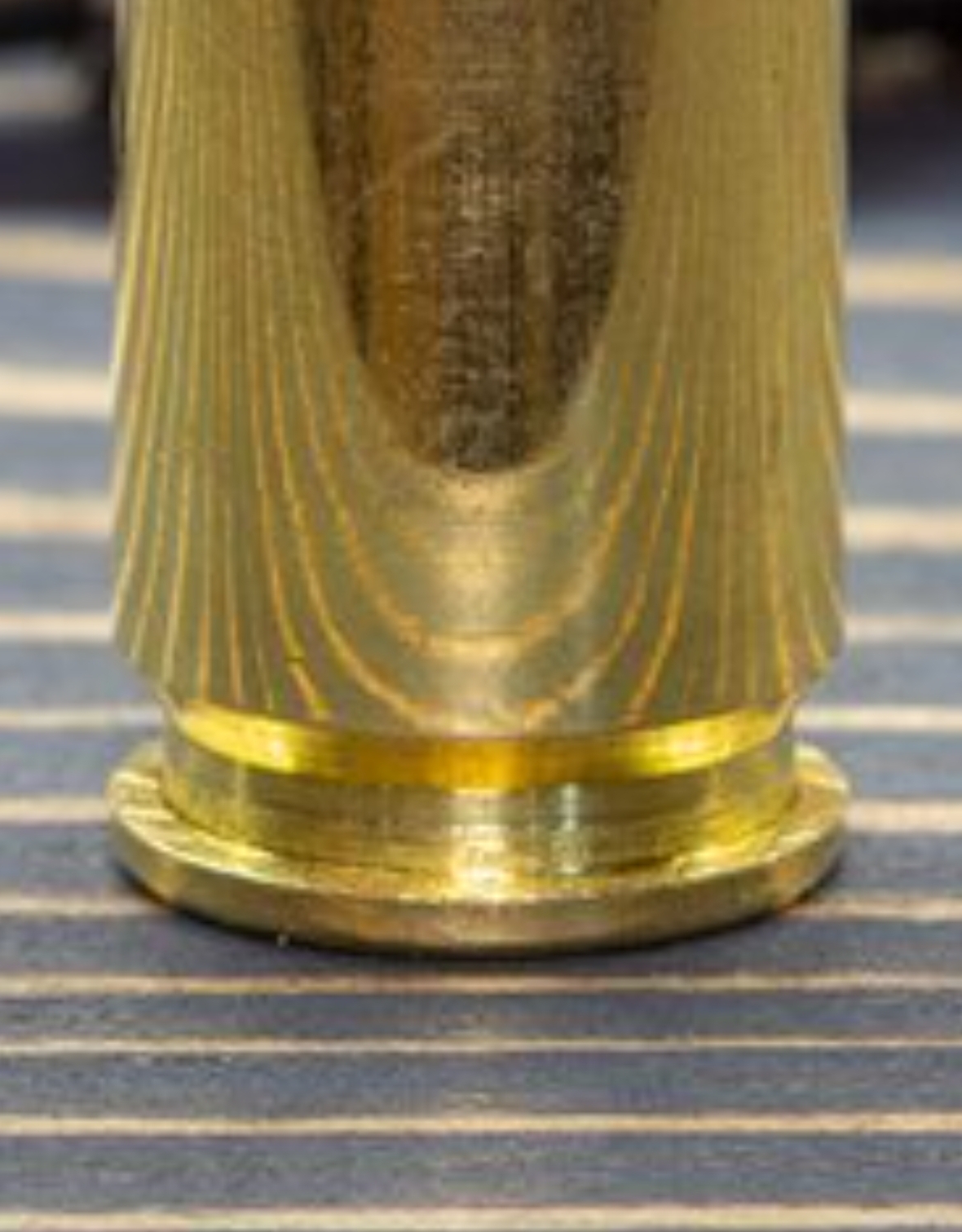

Question for you:
Your test case looks to have a highly modified extractor groove.
What's the reason for it?
