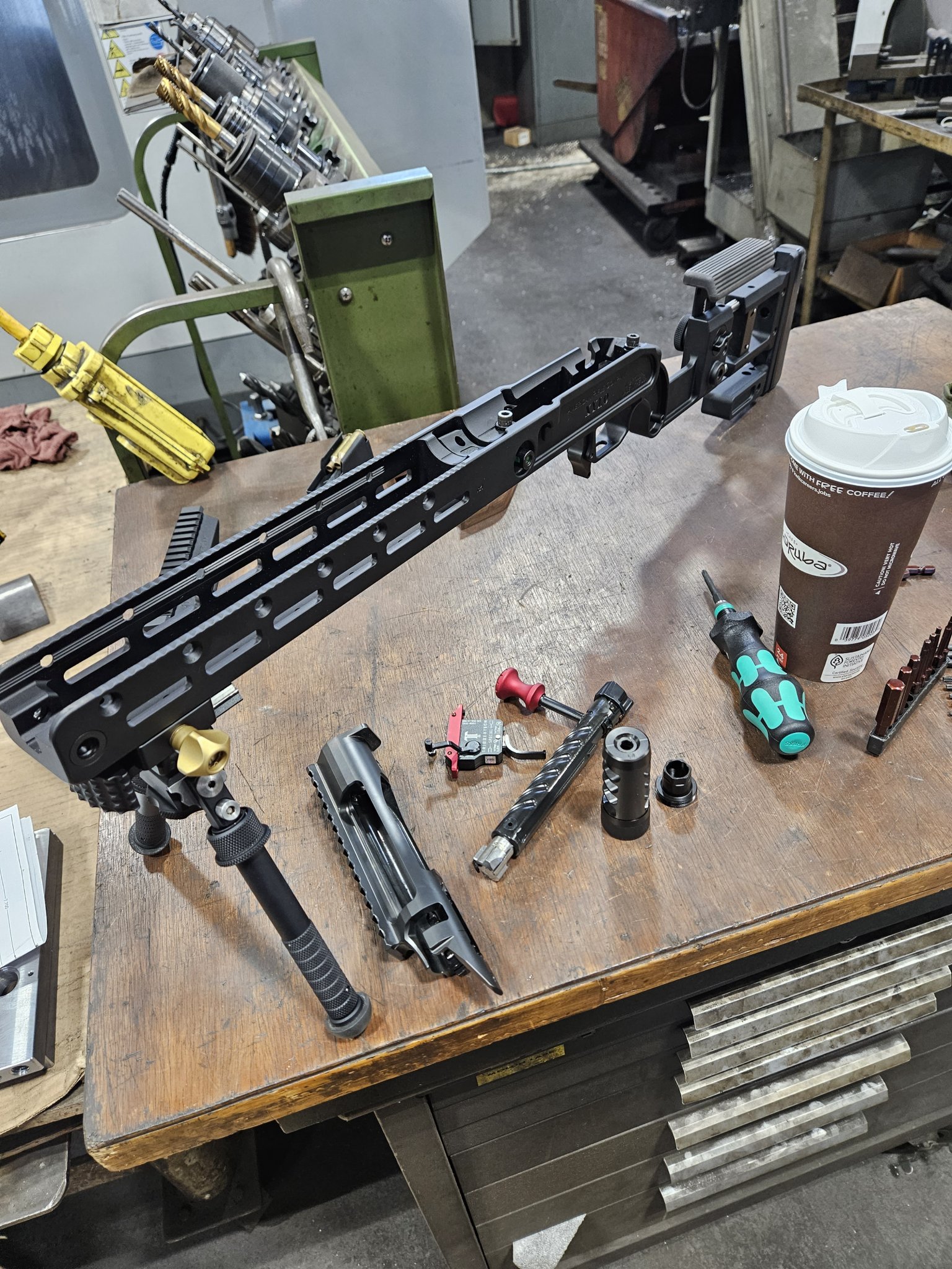

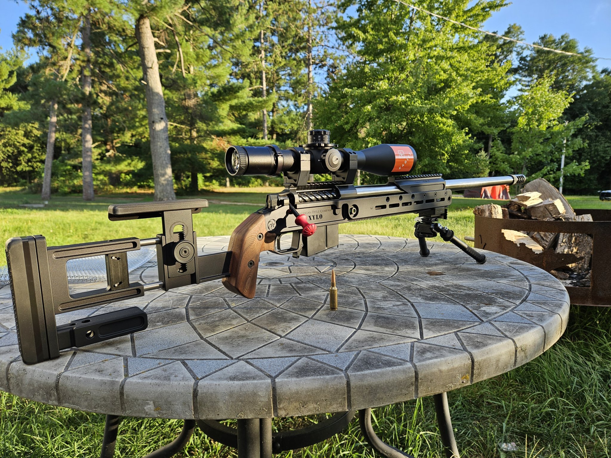

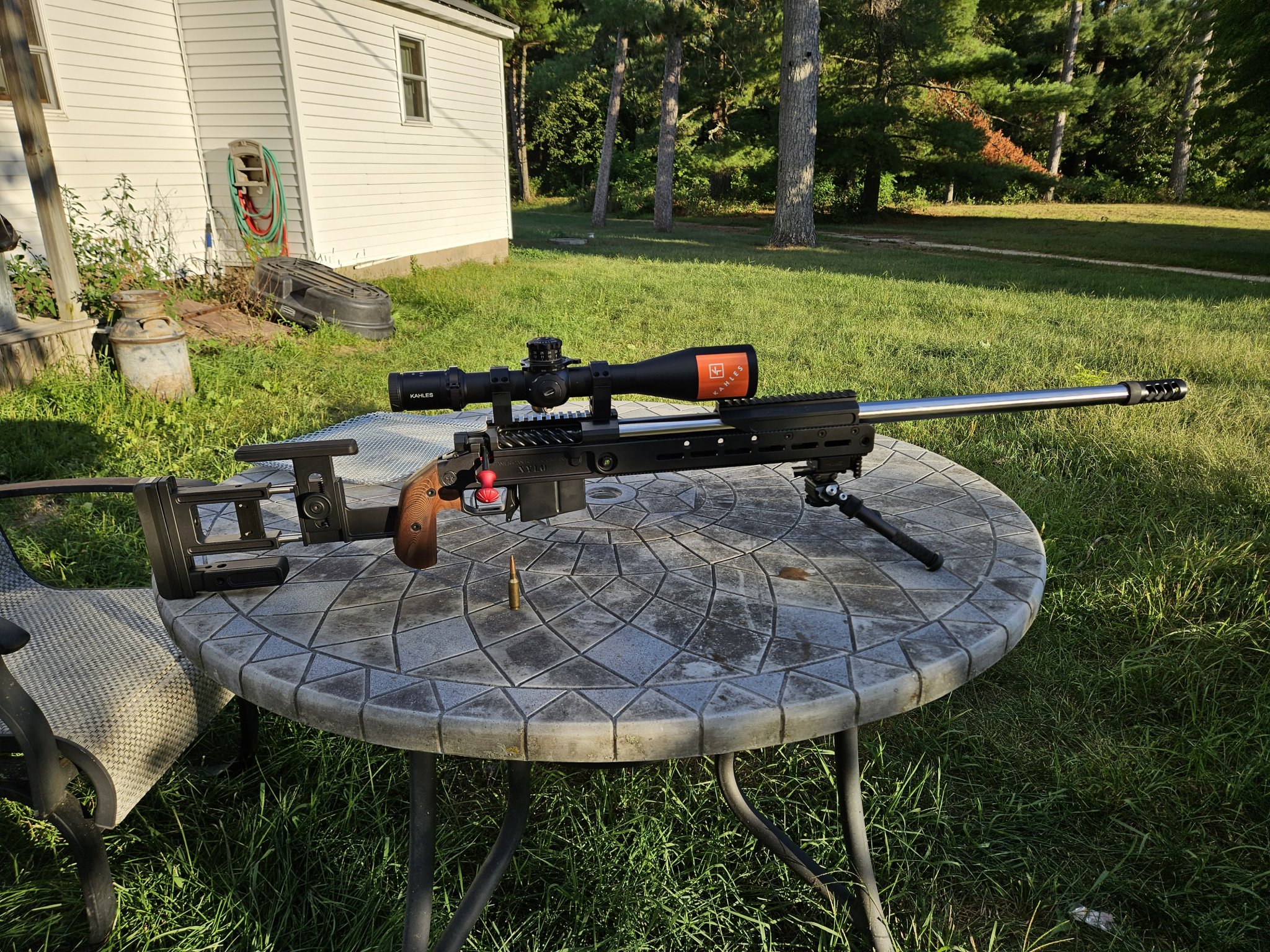

This is my first rifle "build" (more like assembly). CDG, PVA 6.5CM Marksman profile, XLR Element 4 MG, TT Special. Installed trigger as per Ted's video. Went just as he described. Adjusted it to butter smooth. Torqued barrel to 125. Verified with go/no go gauges. Adjusted mag catch for the AW mags. Ran a mag full of dummy rounds through action, fed perfectly. Could my first ever build really have gone this easily?? We'll see...
Now I just need to find some range time, but so far, great experience. Love this action at this point. Hopefully it won't disappoint going forward.

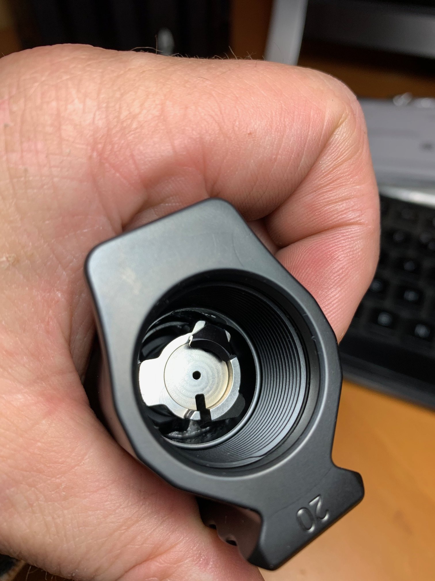

Just curious, can a CDG barrel be used on a Nucleus or Archimedes? I know people have used Nuke barrels on CDGs.
Not if it's coned, the coned tenon is longer and will likely hit the bolt or bottom out in the action before the shoulder on the barrel contacts the action.

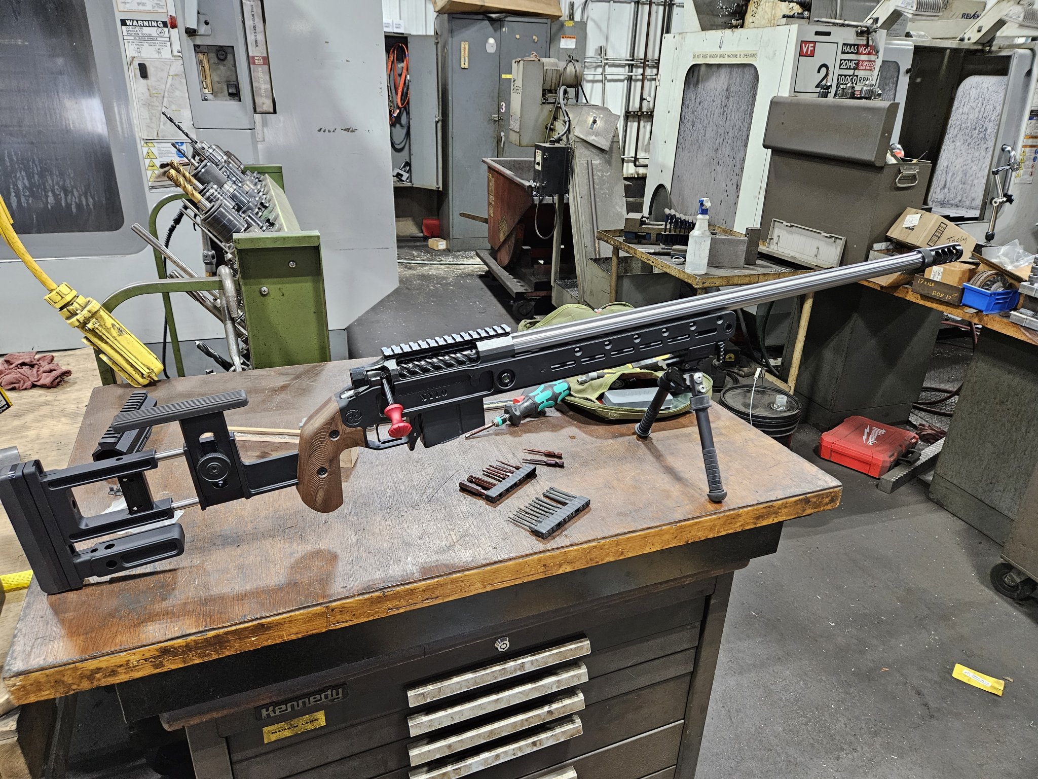

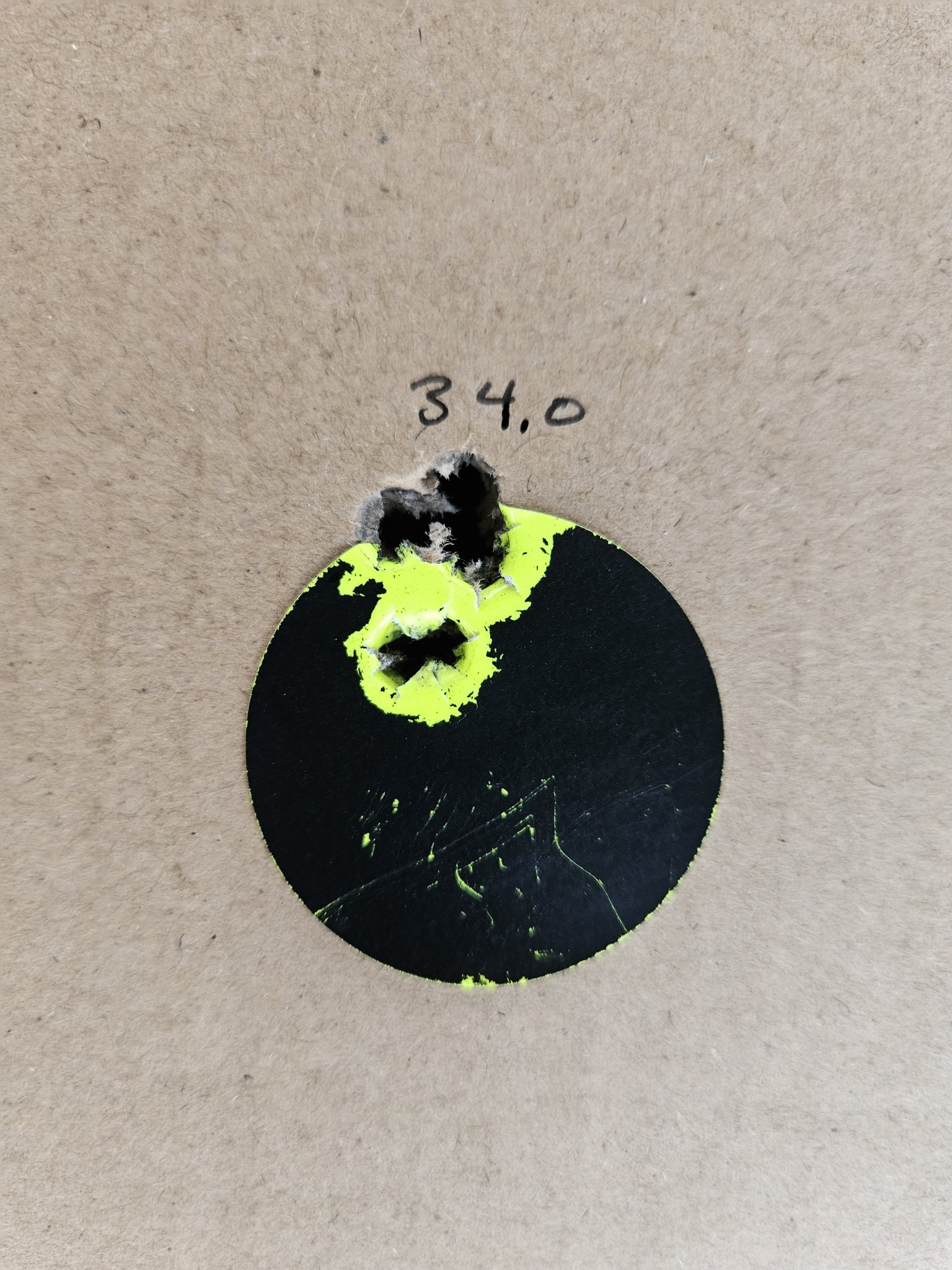

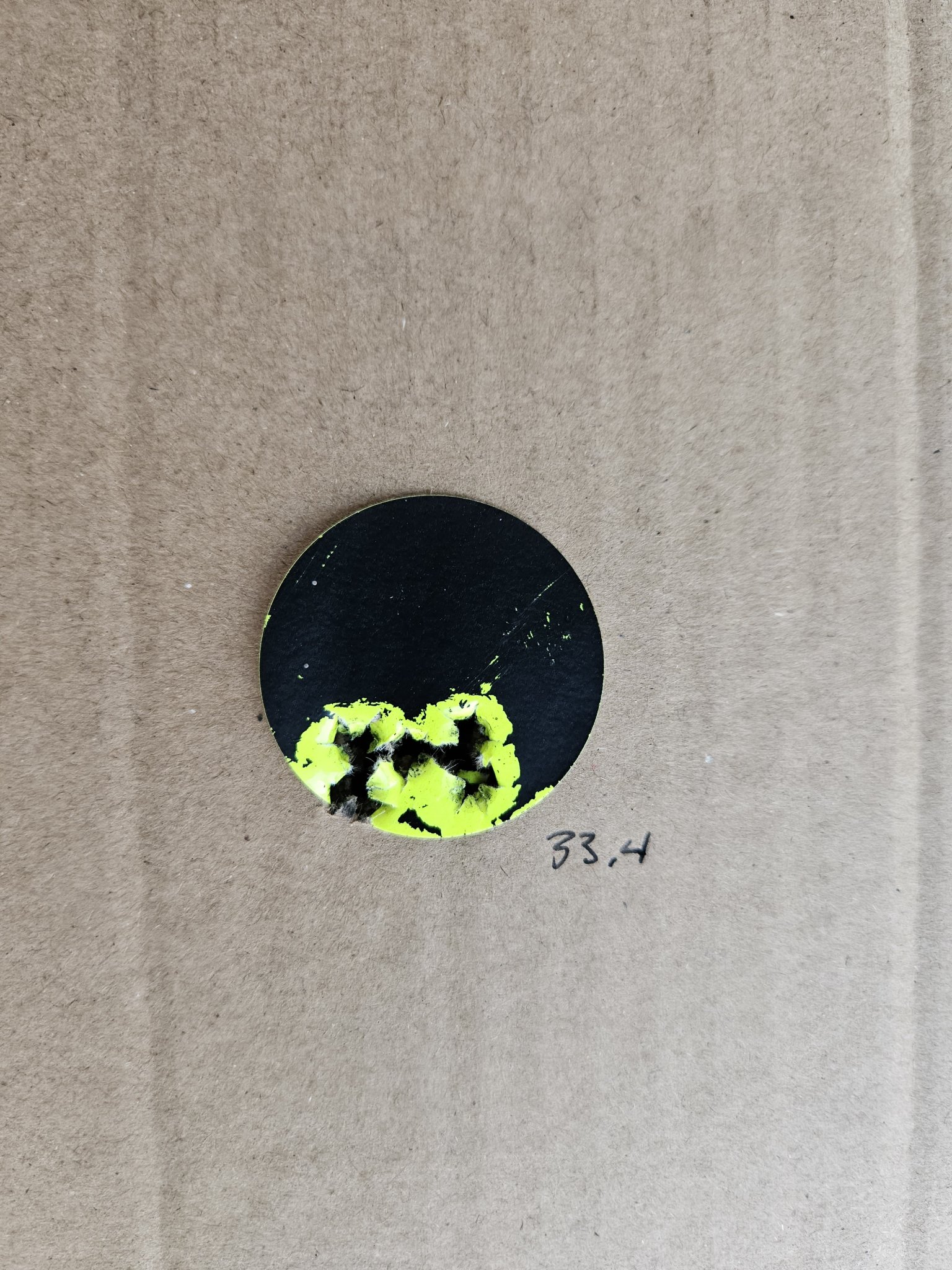

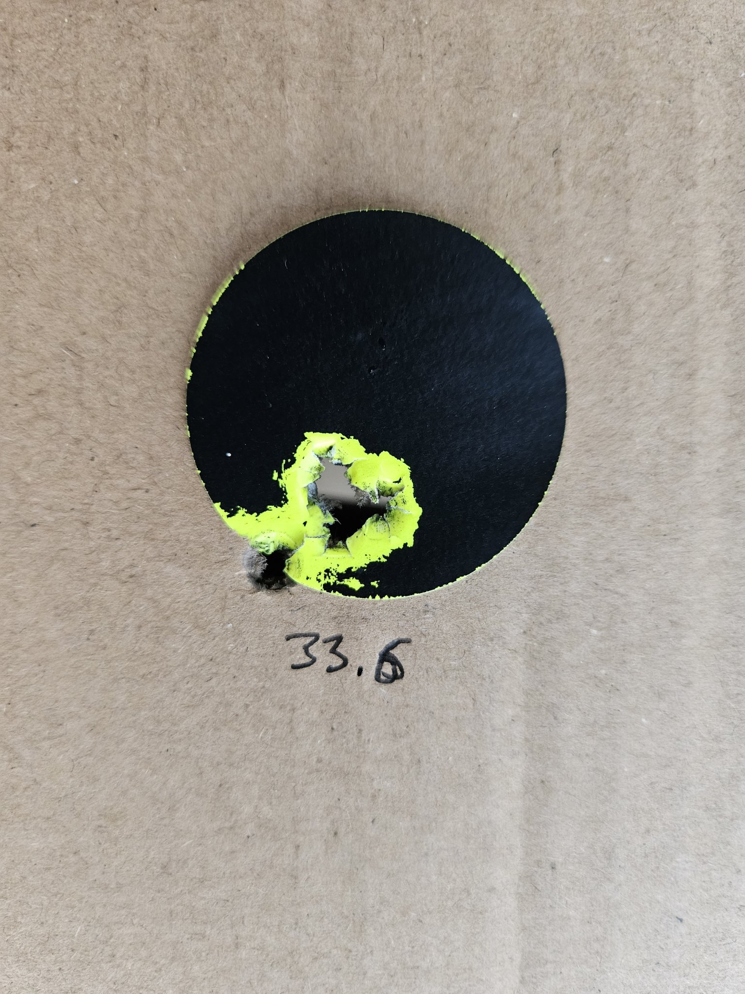

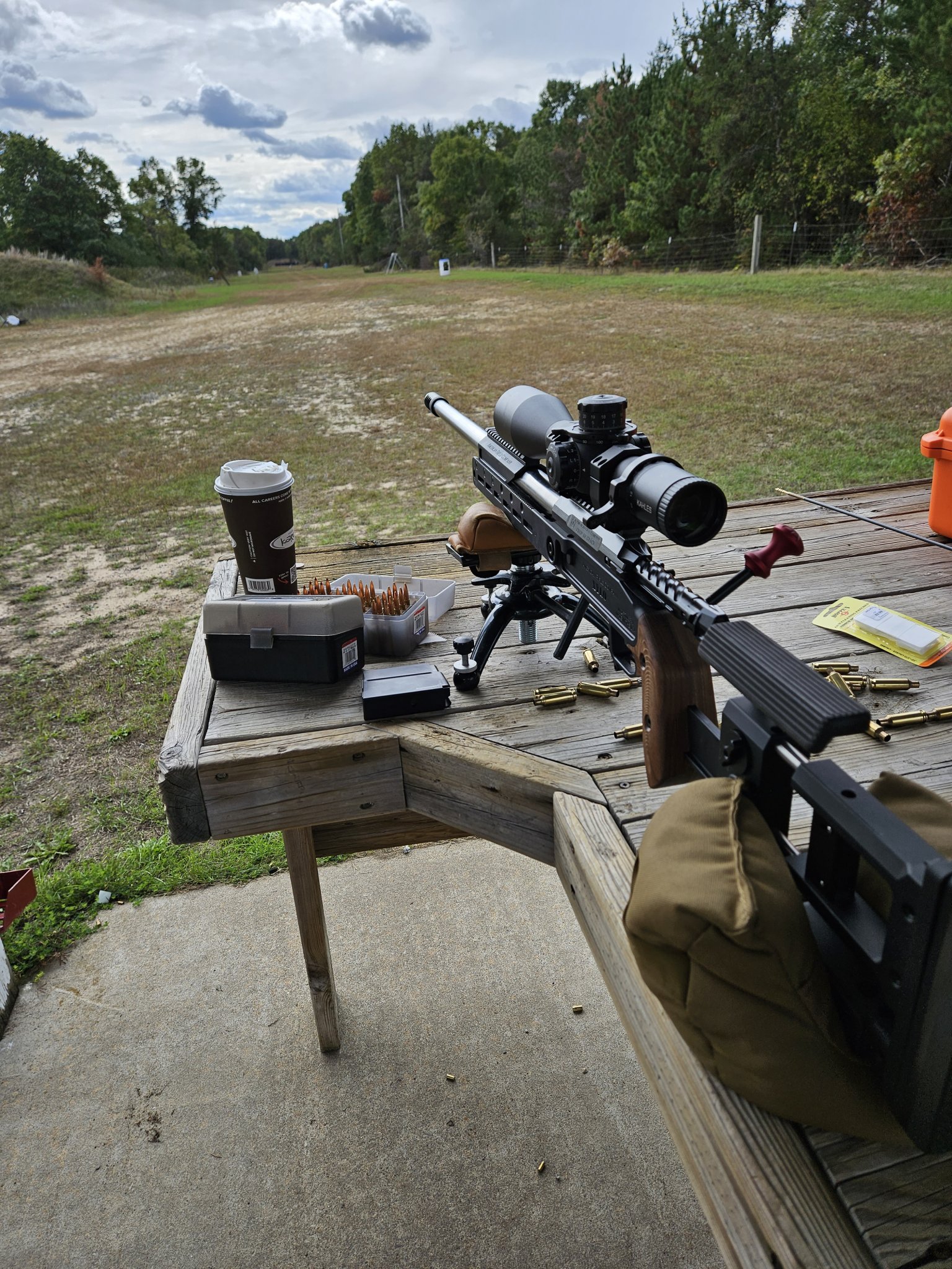

Long project for me. I shot a PRS match with my TRG-22 in 2021 and knew I wanted to do more but with a purose built gun. Got the Bartlein blank in 2021. Then a Manson reamer, brass and dies in 2022. After spending a year trying to decide between an Archimedes or something like a Terminus Zeuss I saw the pre-sale for the Coup de Grace and ordered along with the Xylo this February. Action and chassis came this summer and have been sitting until I could get shop time. I knew I wanted a 6mm and decided on the 6 GT due to the talk about being designed to feed better than Dasher or others.
In the same timeframe I also finally added an Autotrickler V3 as it was becoming apparent that I wouldn't be able to get to the next level of Palma without more accurate charges.

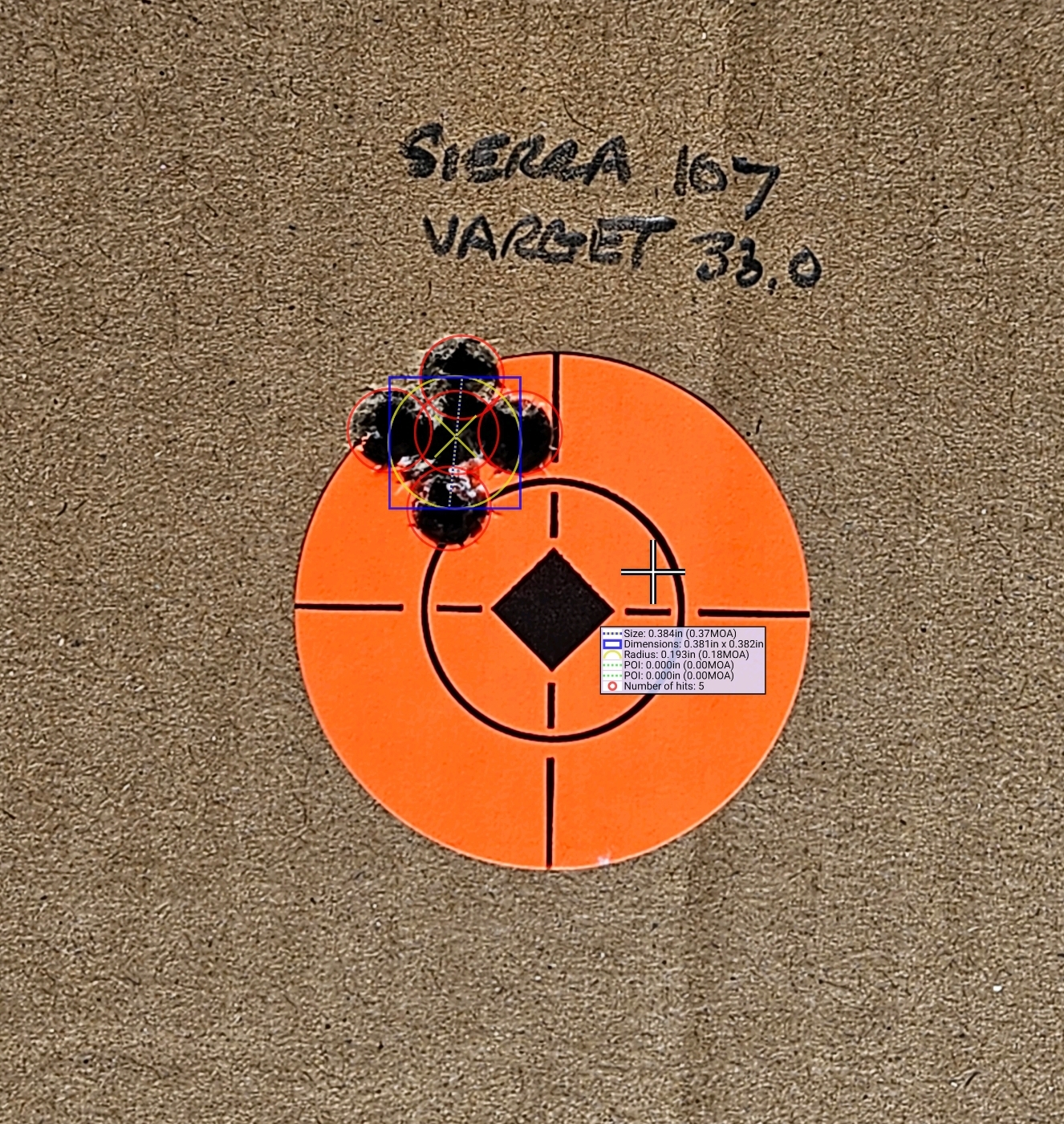

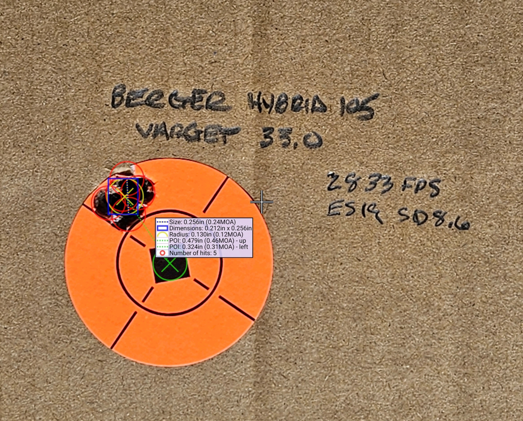

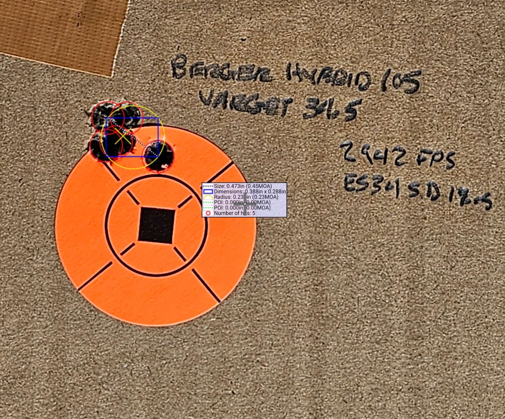

I've built a few rifles. I've had pretty good success, but never like this. After finally getting everything together, with the only bullets I had on hand (ELD-M) I just threw some loads together starting at 33.0 grains of Varget and bore sighted the scope before heading to the range. First round on cardboard was 2.5 mils high and left, so I adjusted, and cleaning every round shot this group with the remaining 4 rounds.
Well that blew my mind. When I say I've had good success, I mean that eventually I'm able to find a load or a couple loads where with the right bullet, seating length and charge, I've gotten .75" or less groups at 100. A couple rifles below .5". Never have I built a rifle/load combo that did 1 hole groups consistently (nearly always had a flyer which I now attribute to the variance in charge weights) but that said, certainly never the first group out of a new barrel, new rifle, new to me caliber, with a random starting load particularly cleaning between each shot. So I got some more bullets and went back to the range with a variety of loads.
20231006_181717.jpg20231006_181720.jpg20231006_181724.jpg20231006_181727.jpgScreenshot_20231008_123012_My Shooting.jpgScreenshot_20231008_123151_My Shooting.jpgScreenshot_20231008_123351_My Shooting.jpg
It's like I can't put a load together that DOESNT shoot <.5" :ROFLMAO:
And feeding? It feeds better and smoother than any other bolt gun I own, custom or OEM. Better than my Borden/Eliseo tube gun in 308. Better than my TRG. I love everything about this gun and have started wondering what the hell I even need my other ones for.
So, thanks Hide, for all the info I got here that helped me put this together. Thanks ARC for designing what seems to be an amazing action. Thanks Bartlein for a fantastic barrel, my first Bartlein but certainly not my last.

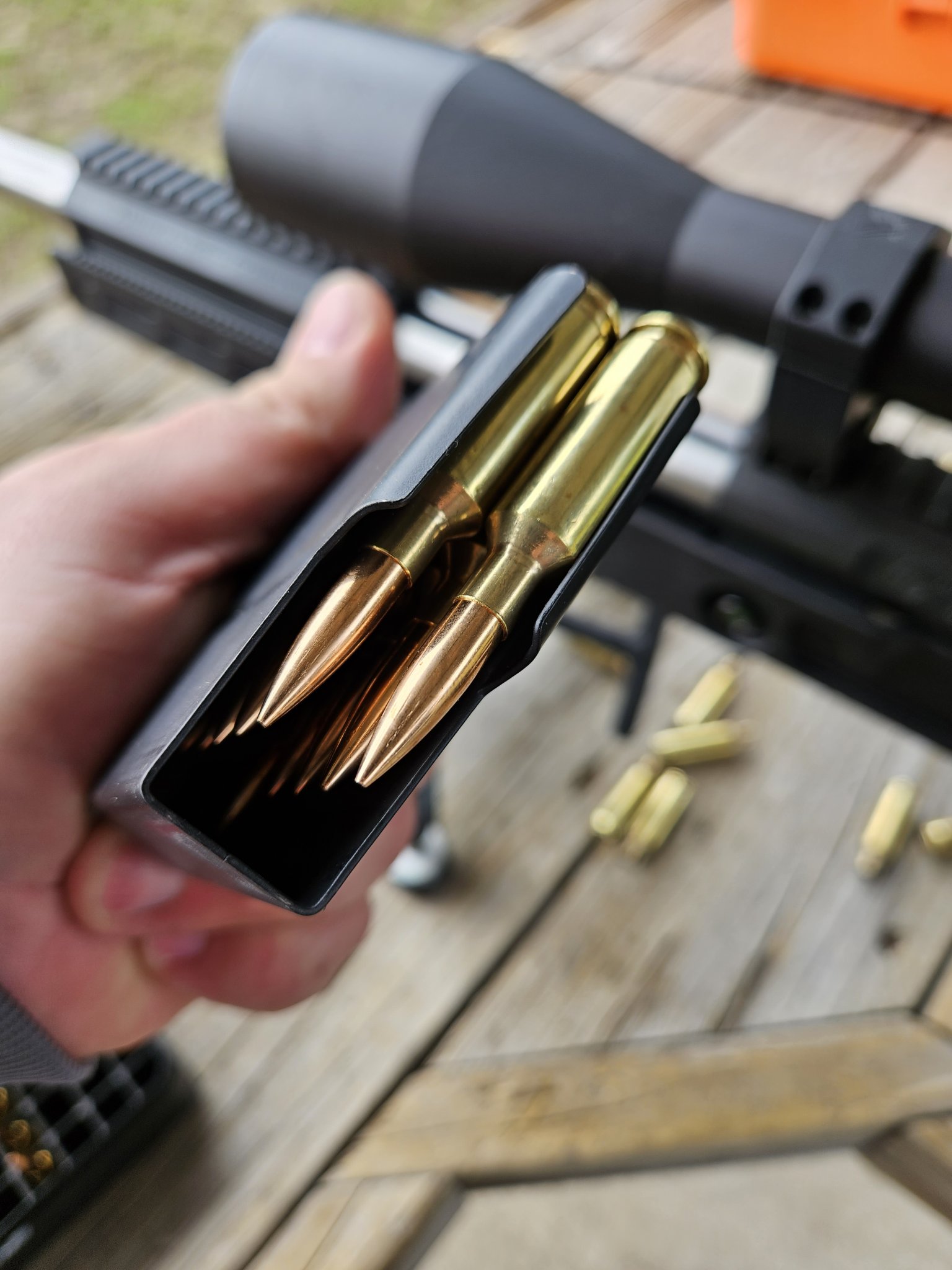

I ran the CDG in the Major Land Match this past weekend. I used the 14 round extended AW for the entire match. It wasn't needed for this match as no stages were over 8 rifle. I just wanted to proof it for reliability. Everything ran flawless aside from the nut pressing the trigger.
@karagias - Any thoughts on adjusting the ejection pattern.
My only gripe is that the damn thing throws brass forward about 2 o'clock unless run really slow (308 Win.). I'd say about 35% of my new Norma brass was lost at this match due to throwing it over the front of platforms etc. This is really the only bugaboo I see with this action, but for comp shooting it's a pretty annoying characteristic.
I purchased a spare extractor from ARC to try modification on ejection pattern. My first attempt was to change the angle of the blade (now hits outer edge of rim first) and shortened it slightly. This made zero difference in the pattern. I'm thinking it may need the spring tension increased on the extractor to allow the case to flip more to the side before letting go. I will try that next.
Cleaning will start with a blow gun this evening.
@357Max where did you get a 14 round AW? Did you modify a 10? Apologies if you already explained earlier in the thread.
I modified it. Not a simple diy. It is outlined in this thread somewhere. I did it while waiting for the action so a ways back in this thread prior to first shippments. A lot of comp guys were asking about it this weekend.

I've done one 14 round AW mag, and it wasn't an easy DIY, unless you already have the equipment. I used an Altus +2 extension.
Step 1- Cut the entire bottom of the mag off, very carefully.
Step 2- Cut new lips for the bottom of the mag (so as to replicate std. AI mags)
For this I used a waterjet and .045 304 stainless sheet
Step 4- Use your TIG welder to add new mag lips to the outside of the AW mag. Let cool before touching w/o gloves
Step 5- reassemble as you would a std. AI mag
Nothing to it. It only took me 5 attempts and 250K in equipment to make one :ROFLMAO:
View attachment 8245748View attachment 8245749View attachment 8245750View attachment 8245751
View attachment 8245758View attachment 8245759View attachment 8245760View attachment 8245762View attachment 8245763View attachment 8245764View attachment 8245765
View attachment 8245766View attachment 8245767
With no tuner either.

Are you using any kind of mag kit with the AW mag or just a stock AW mag?
You know, I was really considering designing one, but I really wanted to try the 419 brake and about the only thing I don't have at my disposal is a 5 axis machine, so rather than making a tuner/brake combo I just tabled it and figured I could add one later. ETA: 5 axis to make a similar brake not tuner, just to clarify.
Just a stock AW mag. If there was more recoil I'd worry about rounds sliding forward, but from the ~100 rounds I've fired so far, they haven't moved enough to affect feeding.

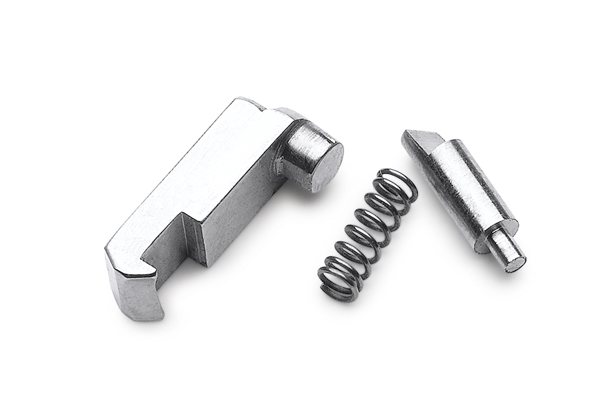

The extractor spring and ball are captured by the cone breach? I could see how the extractor might be but not the spring.

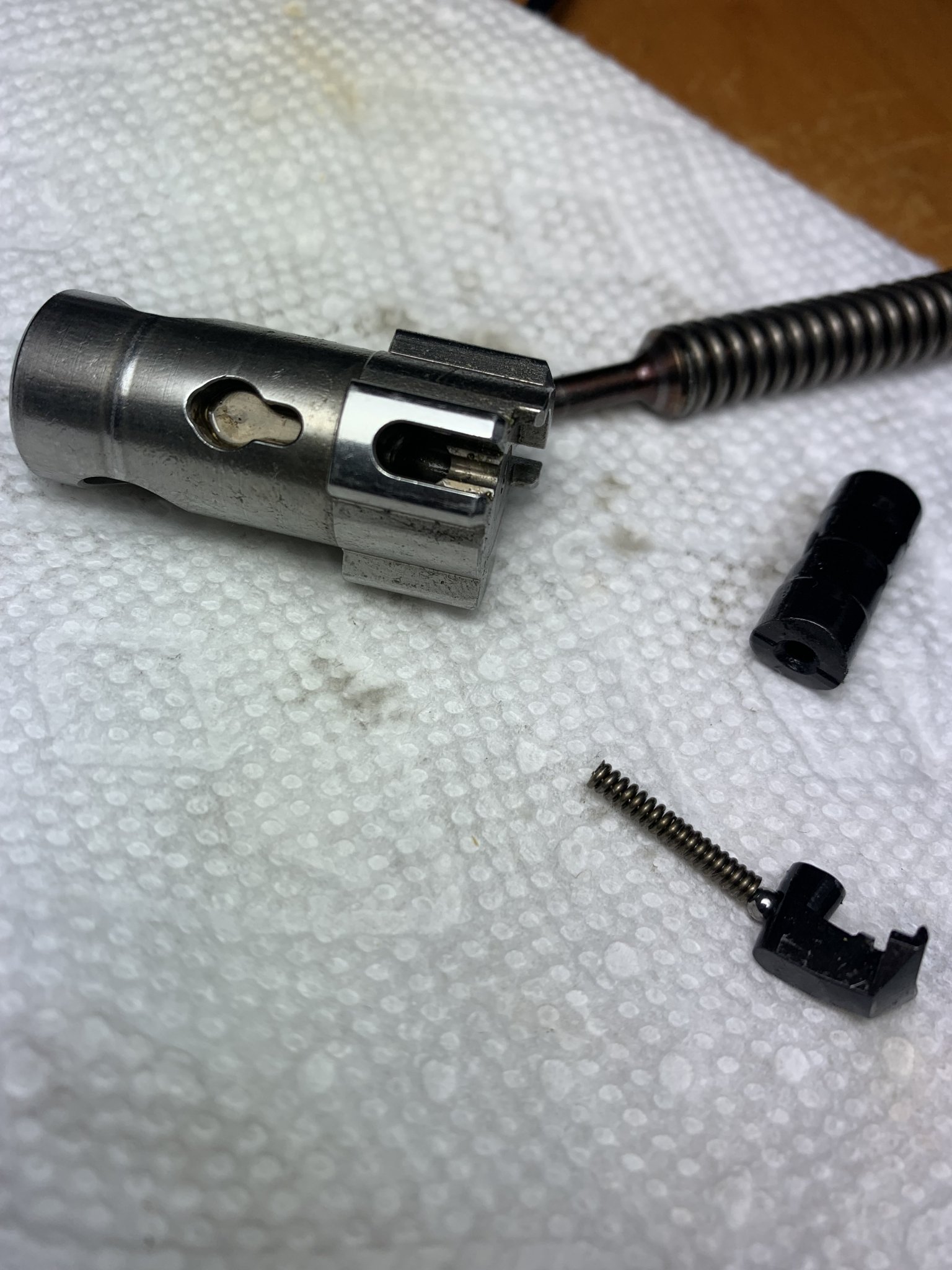

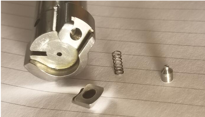

Not sure if you own one of these yet. It makes a lot more sense when you look at it disassembled.
The spring channel i.e. exposed area is closed. See picture below with spring removed. No opening to firing pin bore. Next notice the extractor has a lug on the bottom. That lug is exposed to the firing pin bore, but it blocks/shields the spring/detent ball. The detent ball is a very precise fit to the spring bore & it's small. Looks to me like most pressure from a popped primer that makes it past the extractor lug would simply disperse around the periphery of the extractor (path of least resistance). If any does go down through the spring it has no leverage to dislodge it, compress it maybe, but I don't see how it would come out.
The extractor itself is prevented from pivoting open by the cone breach. The side of the extractor is within the lug and constraint from coming out the side by the action. This whole system is very thoroughly thought through & very cleverly designed. This is why I Love ARC's actions. It's engineering as an art form. Clean yet simple.

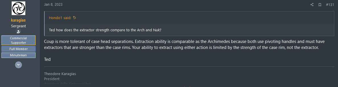

Here is what Ted had to say.
No, I don't currently own one of these yet and have been going off videos and pictures. Your picture actually gives me a closer look than I've had before. My concerns stem from my Defiance Deviant with a sako style extractor with a very similar design except it uses a spring and plunger that is enclosed. The extractor and cut has A LOT of similarities and when I experienced pierced primers both the plunger and spring were damaged enough to cause issues. That does not mean to me that the CDG would definitely have the same or similar issues, but I could see where it might. I'm guessing someone out there will eventually pop a few and find out.

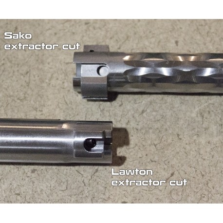

View attachment 8246764View attachment 8246777
That's not their Sako extractor. I'll take a picture after I get off work. That looks similar to a Savage/Bighorn TL2 extractor.
I think the key difference with the sako is that plunger. They would mushroom from being hammered by the extractor, and stick in its bore. I dont believe the ball bearing on the cdg will act the same way.

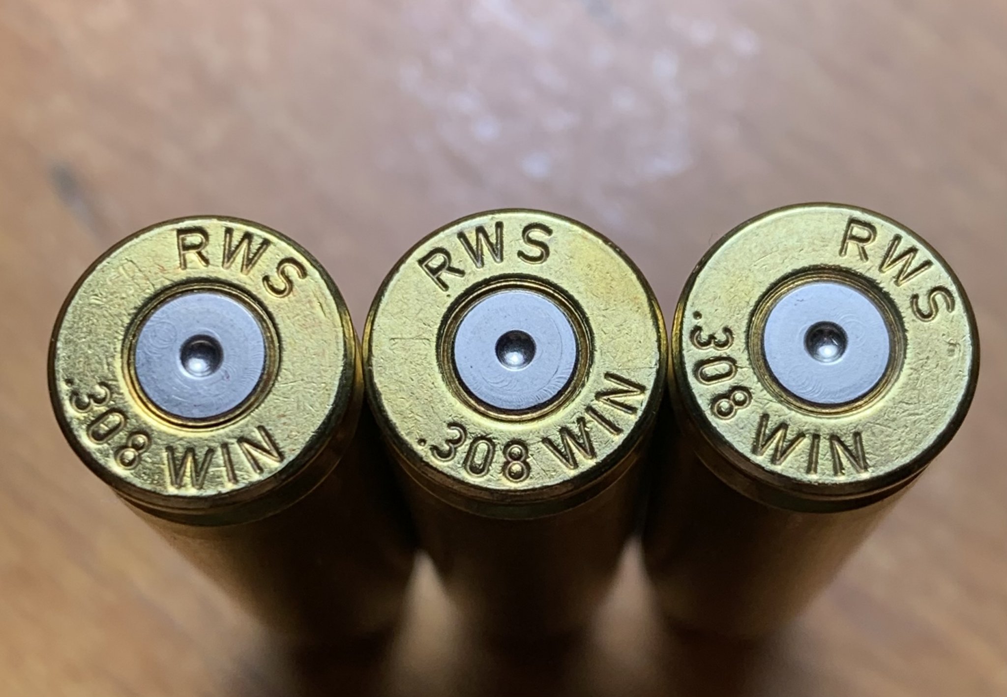

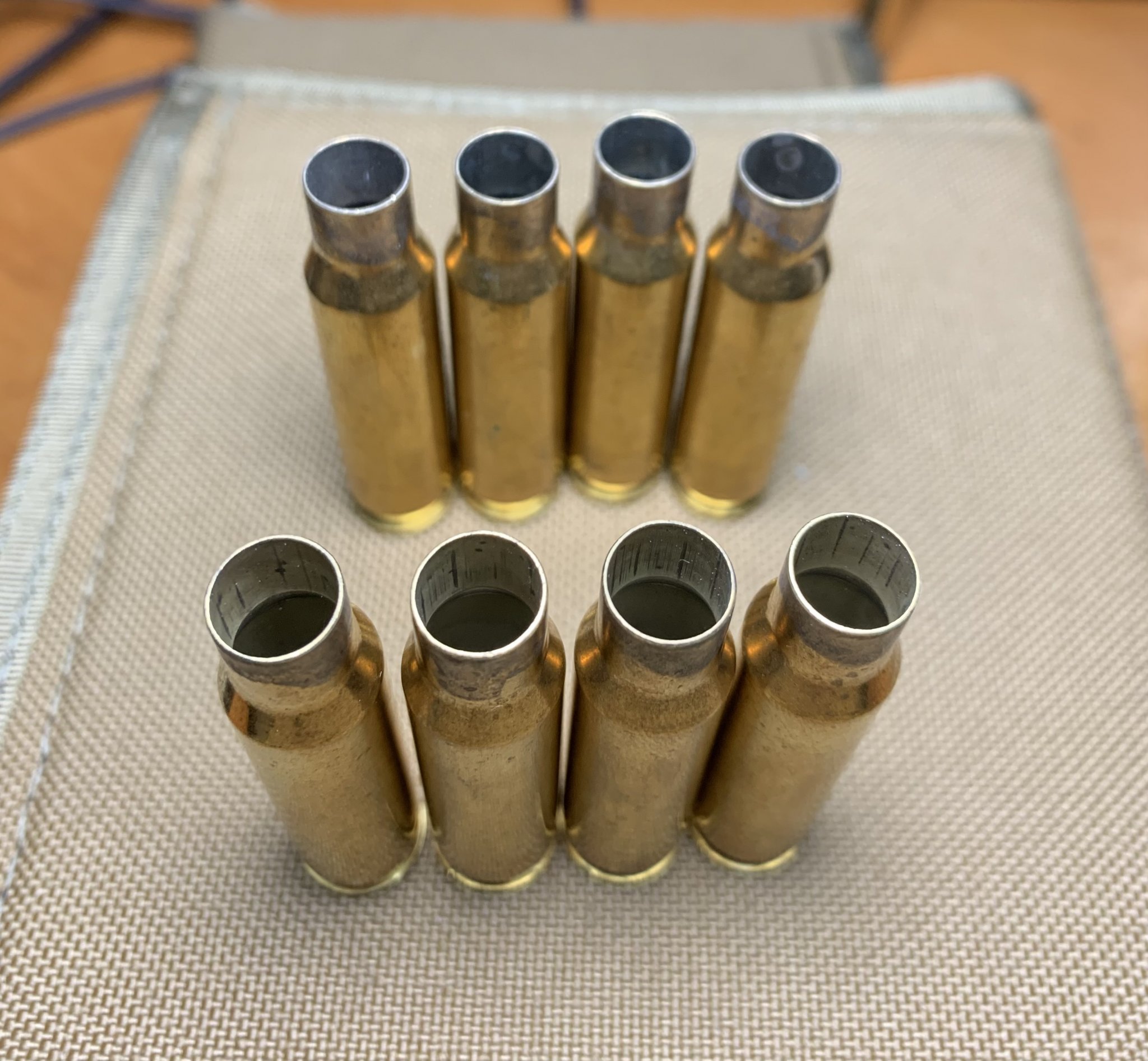

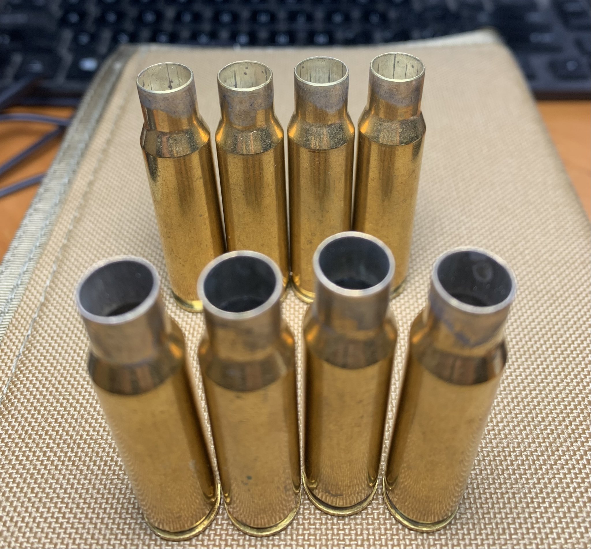

So word of caution to CDG owners. Especially if this is your first custom action. ARC actions hide pressure compared to factory actions & even many other customs. They have thin blade ejectors & tight fitting small diameter firing pins. I have taken my 6.5 Creedmoor loads that exhibited zero pressure signs in my Nuke. Put them in a another custom action & hit waterline at distance using my dope (same speed), but brass came out with an obvious ejector stamp. Add a PVA barrel, they also don't pressure up easily from my experience.
Ran 4 rounds & checked first, nothing looked like excessive pressure. 2 of the next 3 primers fell out. Had the magneto on and knew it had to be over max based on speed. I was admittedly pushing it hard looking for max safe speed possible with solids. The best method I've found with all ARC actions is to use non mil/mag primers for load development. They flatten a little easier & that has been my best indicator. In this case though I used pre-primed Norma brass. My guess in hindsight, they're likely mil spec primers.
Pic of the popped primer. That's the most cratering I've seen with the CDG & it still isn't much.
Brass from popped primer load below. I'd say it burned it all efficiently & probably won't be causing a carbon ring any time soon.
SD/ES also climbed starting .7gr below this. That IMO can be sign your headed past safe pressure limits.
Primers came out nice and tight with .5gr below this. Going to back off a full grain.
There isn't much info in the wild for RL15.5 & Lever loads. Both work very well.
Guess which brass below matches the above powders.
Just for comparison a pic of what I called max load on a pressure ladder using FGM 210's. They get flat but as you can see there is really no cratering with the CDG.
Quite the contrast to the AI's I've seen piercing every other primer with factory SRP 6.5 Creed loads.

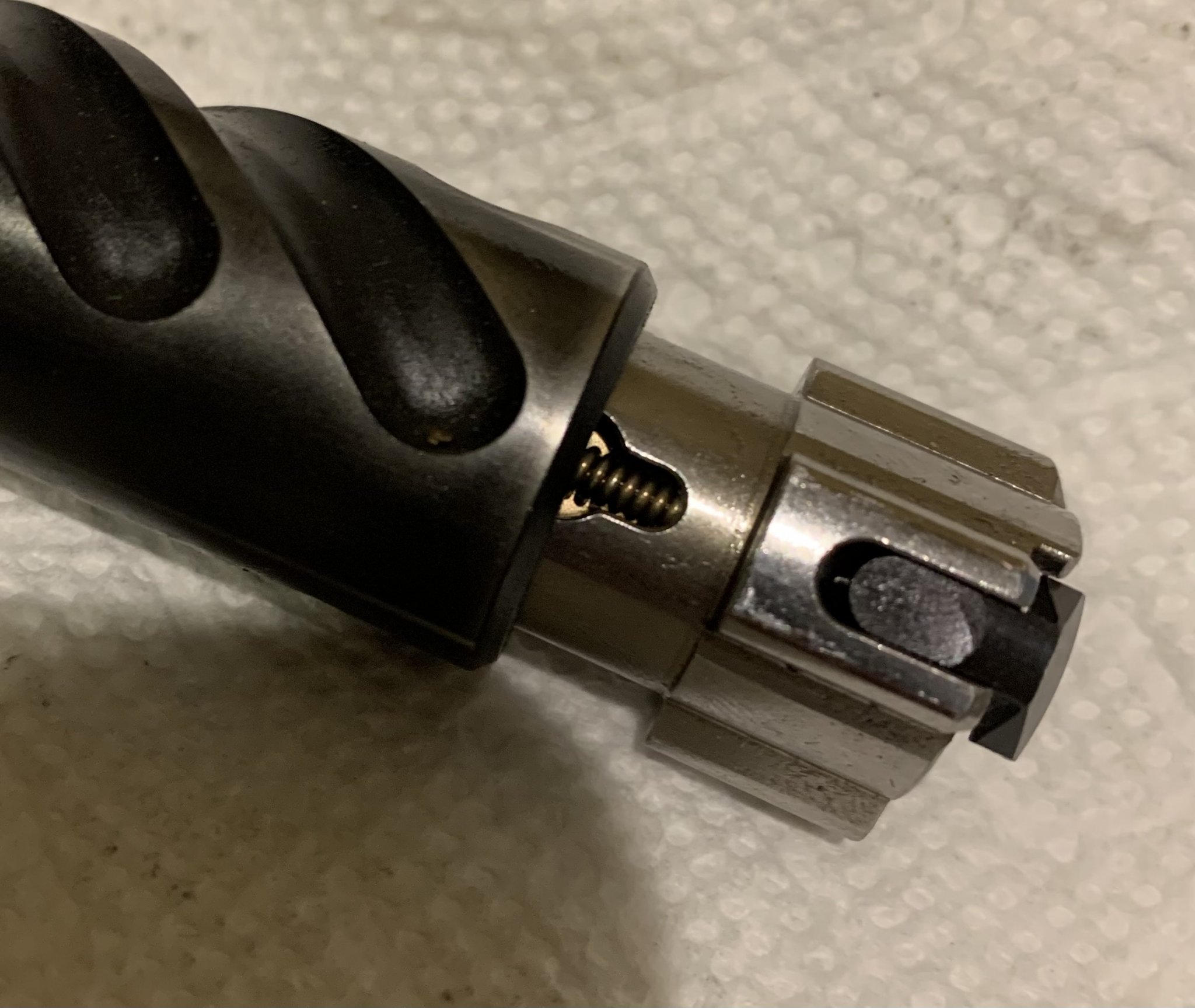

My main concern with the CDG is whether or not how the spring is "retained" will cause an issue because it's not enclosed. It may not but this is the only action I can think of that has an exposed extractor spring.
When the bolt is closed, the spring is not exposed. In fact the only way that spring comes out with the bolt closed would be for the action to explode.
The lower part of exposed spring is covered by the bolt body once assembled. The remaining exposed portion is covered by the lug abutment in the action when closed. It literaly cant come out unless the action blows apart.
The Sako example picture you posted is not in the lug, it is between lugs. That may or may not be the case with the deviant, but it is a huge difference.
When it comes to engineering and machined parts I'm not just being a fan boy. This is a fully developed system. Ted has obviously spun this thing around looking at it from every perspective.

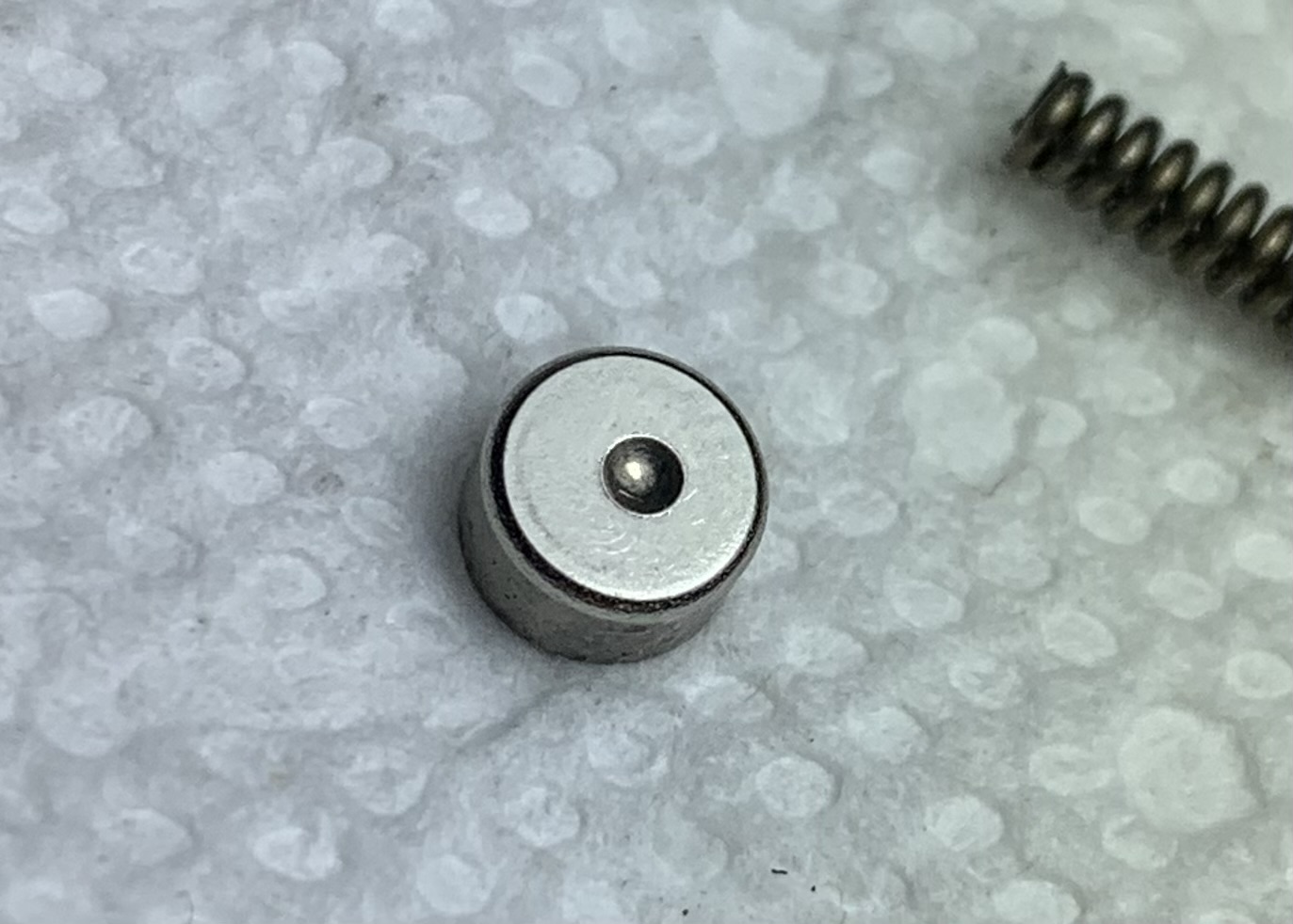

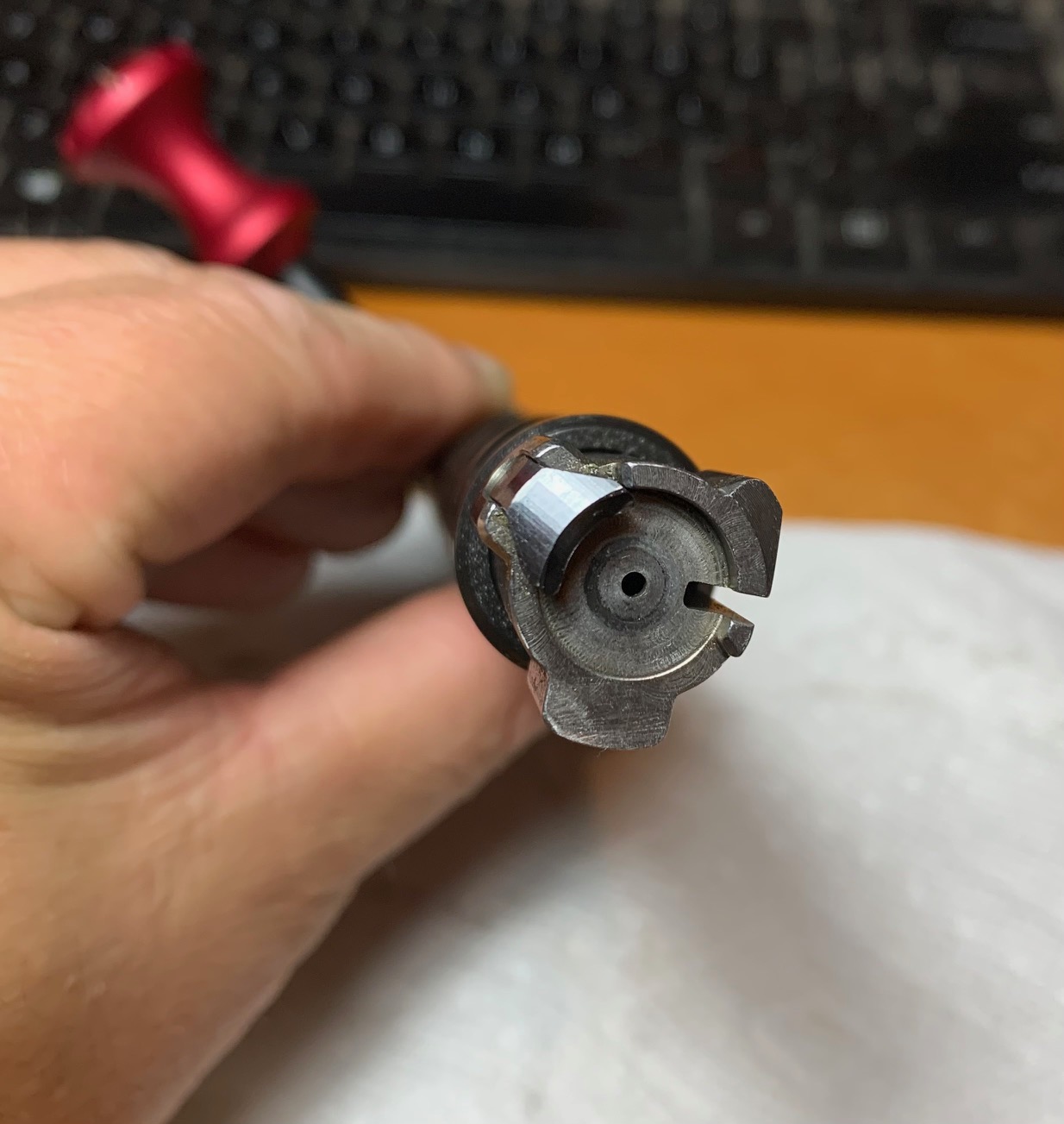

Here is another piece of the extractor design Ted thought of. Haven't seen this mention yet. Notice the hump left in the action opposed to the extractor with the bolt closed.
The cone breach restrains the front. Action restrains the side. It's not coming out unless everything is blown to pieces.
The 12:00 Higbee thread start is tits also.
Those primers are flat as shit. You're way over 65ksi.
Also, if you're activating the pivot, that's an over pressure sign. Or in the case of something like a 7 SAUM, maybe an expanded .200 line.
Either way, you're well into 70-80,000 psi. Probably more.
