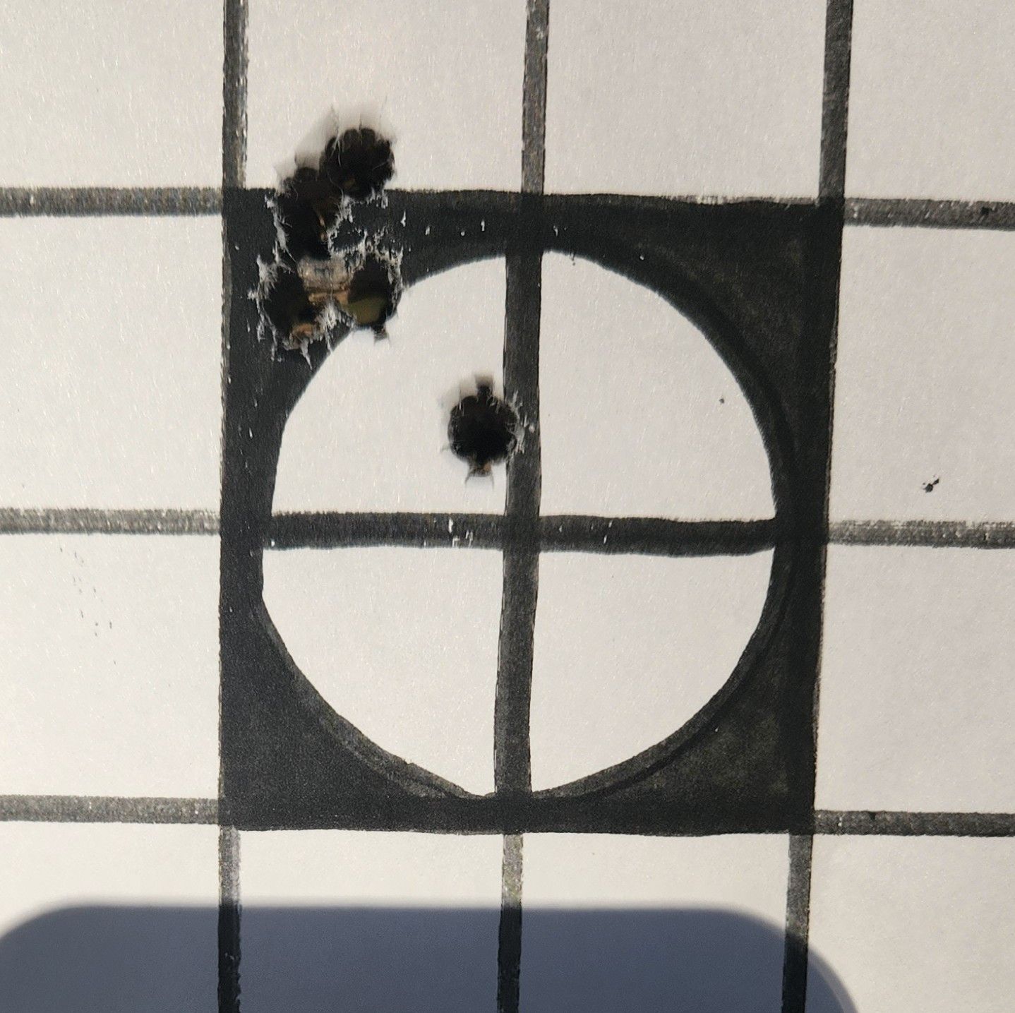

Finally got some time to shoot. Went out today to "break in" the barrel according to PVA's web site. This was my first time putting a rifle together. This was 100 yards with a somewhat Mickey Mouse Caldwell bag and front rest, some crusty old Remington Core-Lokt ammo (yes, I used that stuff because I didn't want to use better ammo for break-in) and a dude behind the trigger that really needs much more time behind the trigger...like a LOT more time compared to many of you guys.
Anyway, didn't measure the group, but those are one inch squares, so make your own guess. The first round (of 5) is the flyer closest to the bullseye, which was on the clean barrel. So I'm just gonna call it my fouler shot, and brush it off as inconsequential. Or maybe it was me. :(
CDG, PVA 22" 6.5CM Marksman profile, XLR Element 4.0MG, Trigger Tech Special, Steiner T6, M-Brace rings.

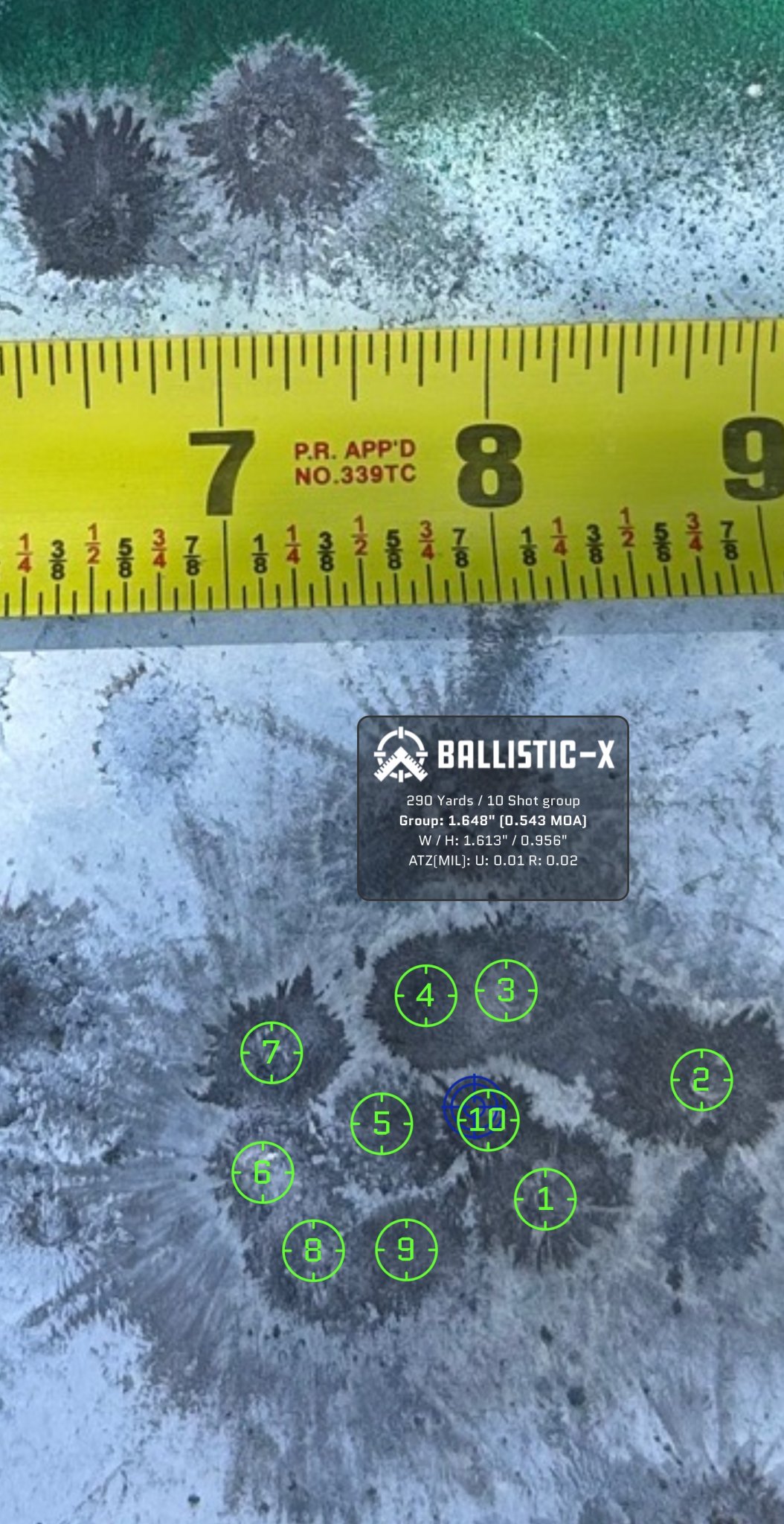

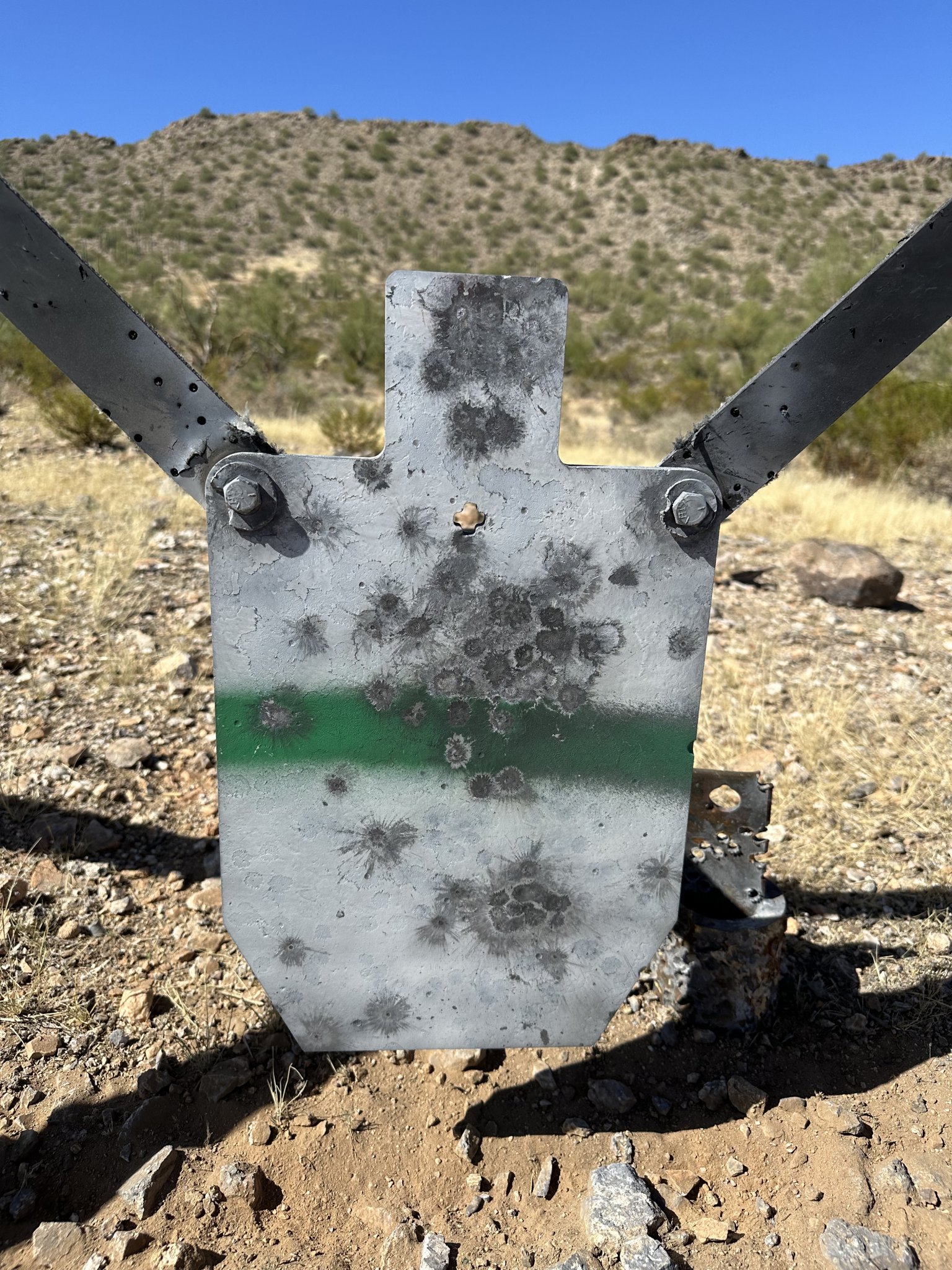

I got to shoot mine chambered in 6 gt with no load work the other day only out to 290 yards
  • Ballistic-X-Export-2023-10-14 12:29:19.355819.jpg

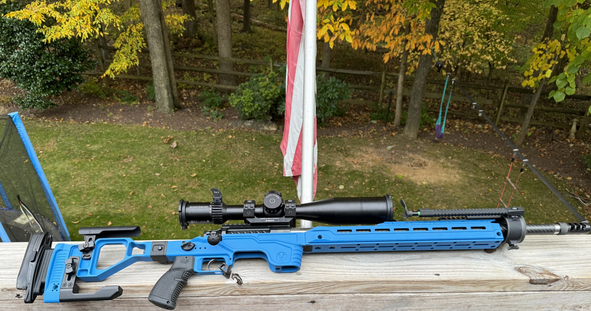

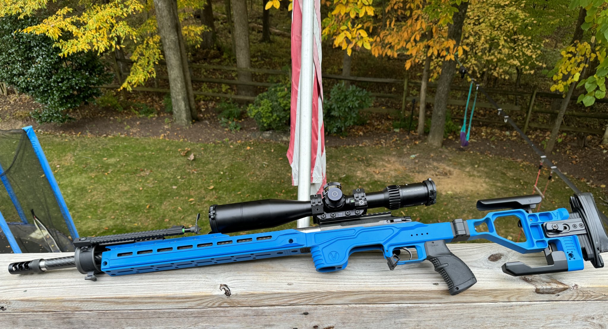

I picked up my short action and barrel from the FFL this afternoon. Ordered from Preferred Barrel Blanks on 31 August, shipped on 12 October. They had a little delay with getting some tooling in but were great about communicating and still shipped pretty quickly.
Man this thing is smooth. Its my first custom action and it makes my other rifles feel like toys.

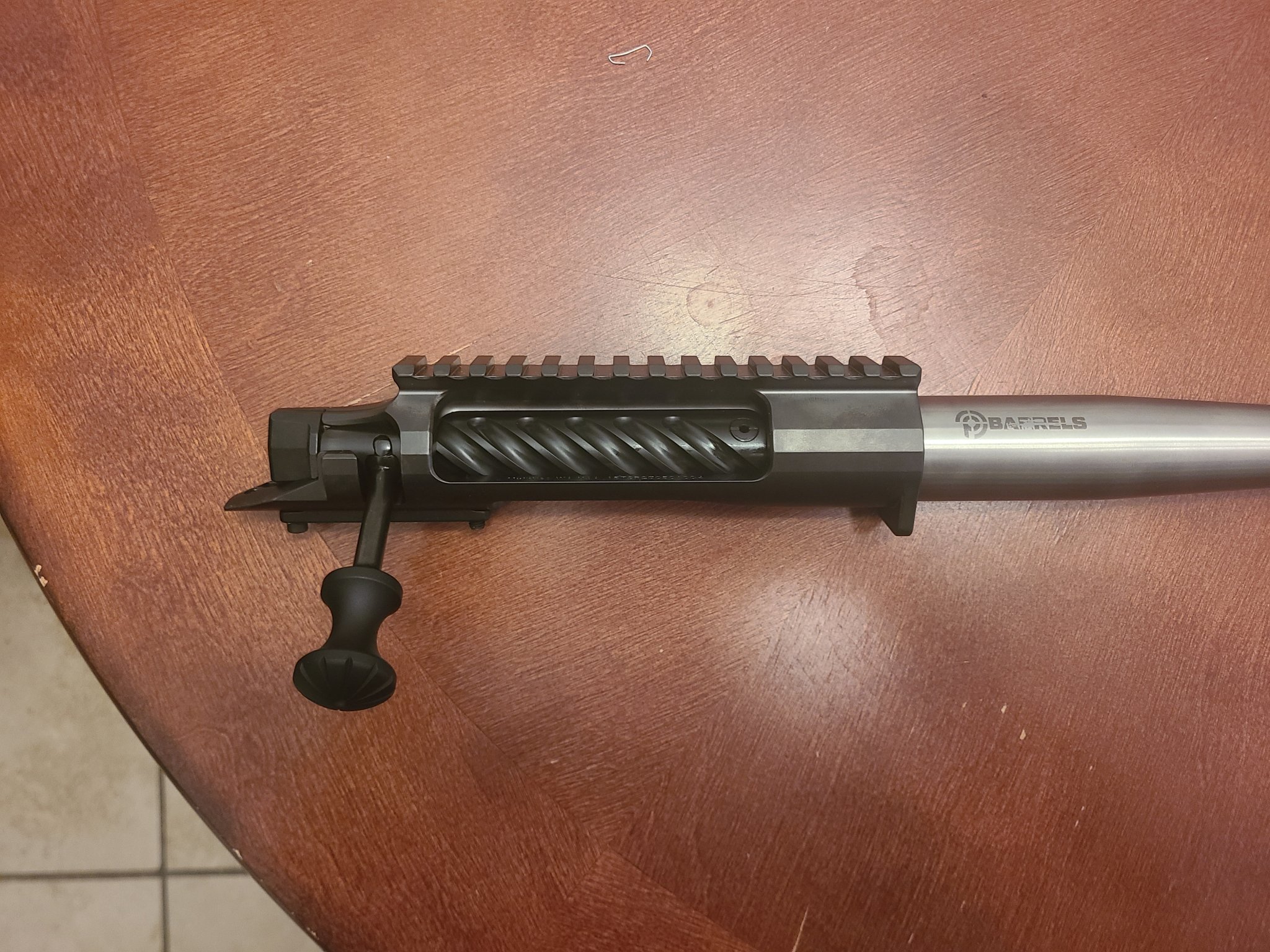

I cannot finish my build until I get the correct bolt head in from ARC. My fault since I changed direction well after I ordered the action. Waiting on the 0.535” bolt head to come in.
Anyway, in the meantime, I hung the 2-stage Huber trigger I’ve had for 8+ years and never used. Easy peasy setup and adjustment. Smooth as silk bolt throw with no drag or catch at the end. I love the way this trigger hanger works.
