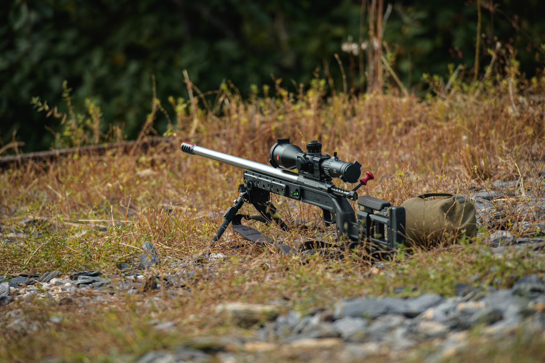

Here you go.
And beauty pics, while the barrel is on order..
