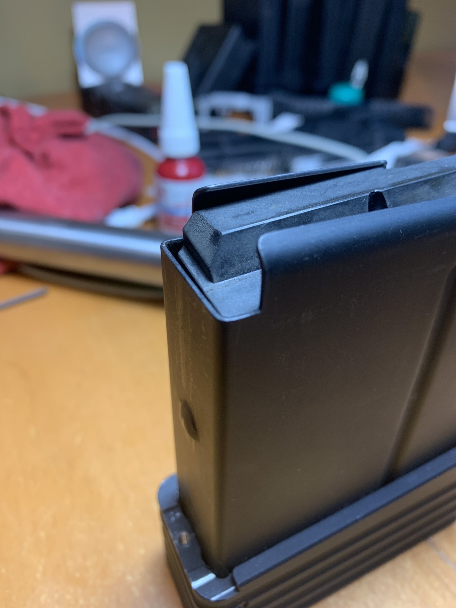

Could you share a pic of the mod on aw follower?
Sure I’ll post it here this evening when I get home.
Somewhere back in this thread I outlined the mods to the AW for addition of 419 extension. Holds 14 @ same length of a MDT 10rnd mag

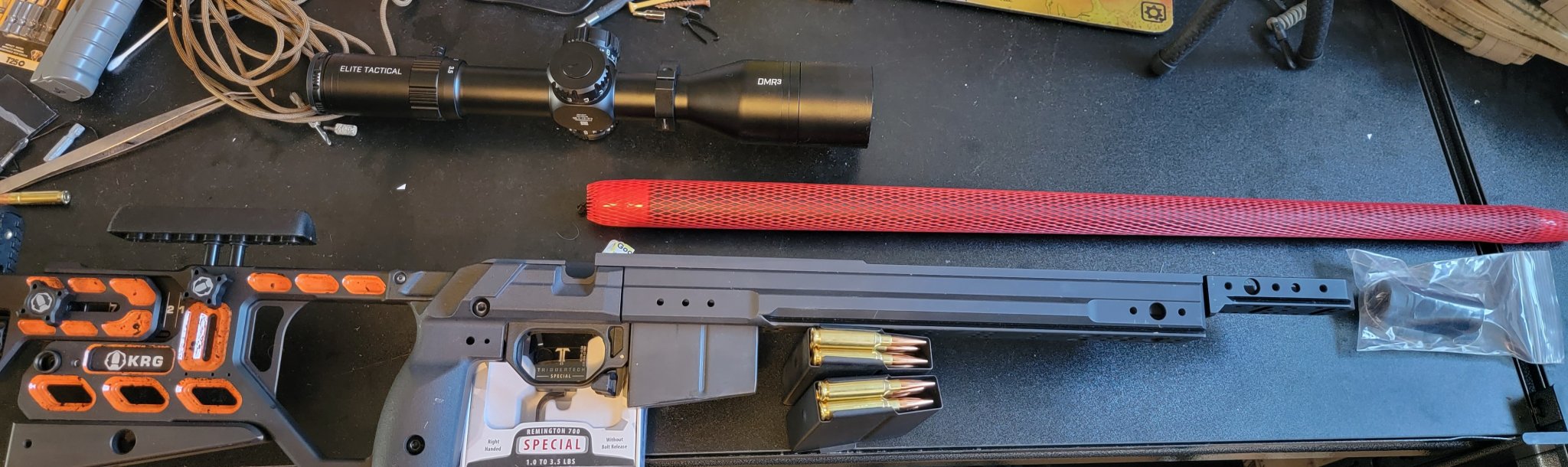

What about rings?
I like how you have the mags loaded up and ready to go
I have some weaver 6 hole tactical rings, just didnt make it into that picture. Been tempted to order some seekins rings though to make the whole thing higher end but i already had the weavers from a previous build and they worked fine so...

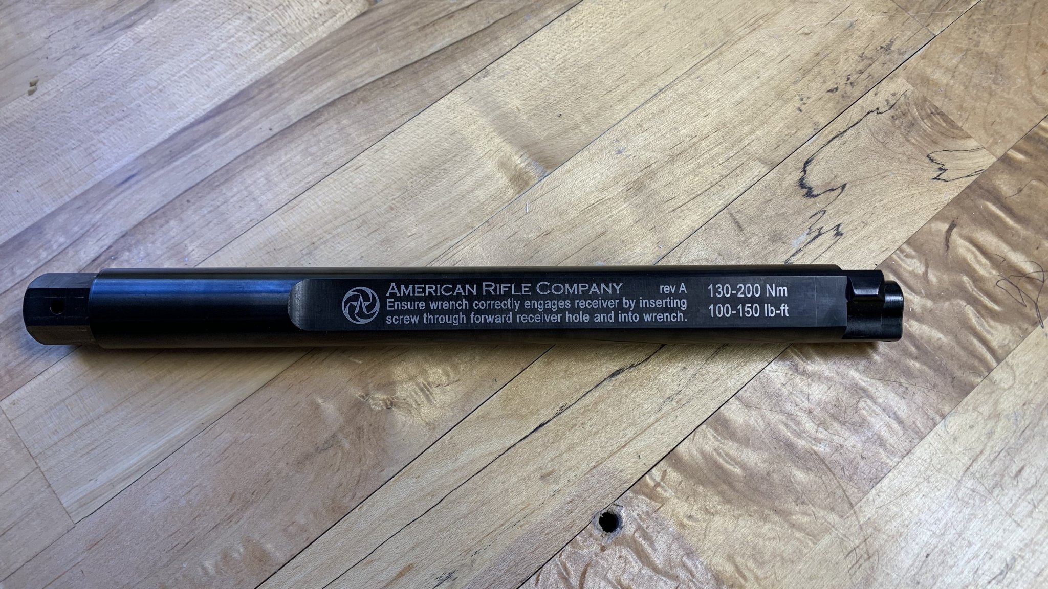

When I was ordering and asked the question they told me 100 foot pounds.
I normally torque my Archimedes barrels (which share the same tenon threads) to 1.3825 x 10^25 femtogram-angstroms and that works very well, but I suppose 100 lb-ft may be close enough for you uncultured savages who don't own a torque wrench with properly fine resolution.
Please don't remind me I should really be using a quectogram-plancklength resolution torque wrench for any critical precision work, those are *really* expensive and out of my price range. (Insert angry poor noises here)
I’ll have to look when I get home but 100-150 is either etched on the wrench itself or was on a document that came with the wrench. I dont think it matters much at all. I split the tolerance at 125 for my barrel.
From Ted in this thread, yeah?
Thought 150 was magnum and 100 was regular.
I normally recommend torques of at least 100 lb-ft, 150 is better, because I don’t what barrels coming loose on large caliber, lighter weight guns, like hunting rifles. Hard-to-diagnose accuracy problems are also possible as a result of low torque. More torque is just cheap insurance.

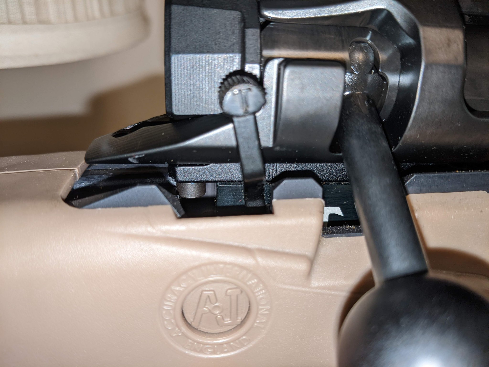

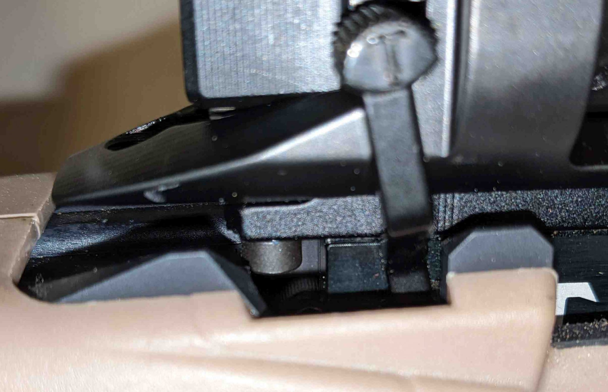

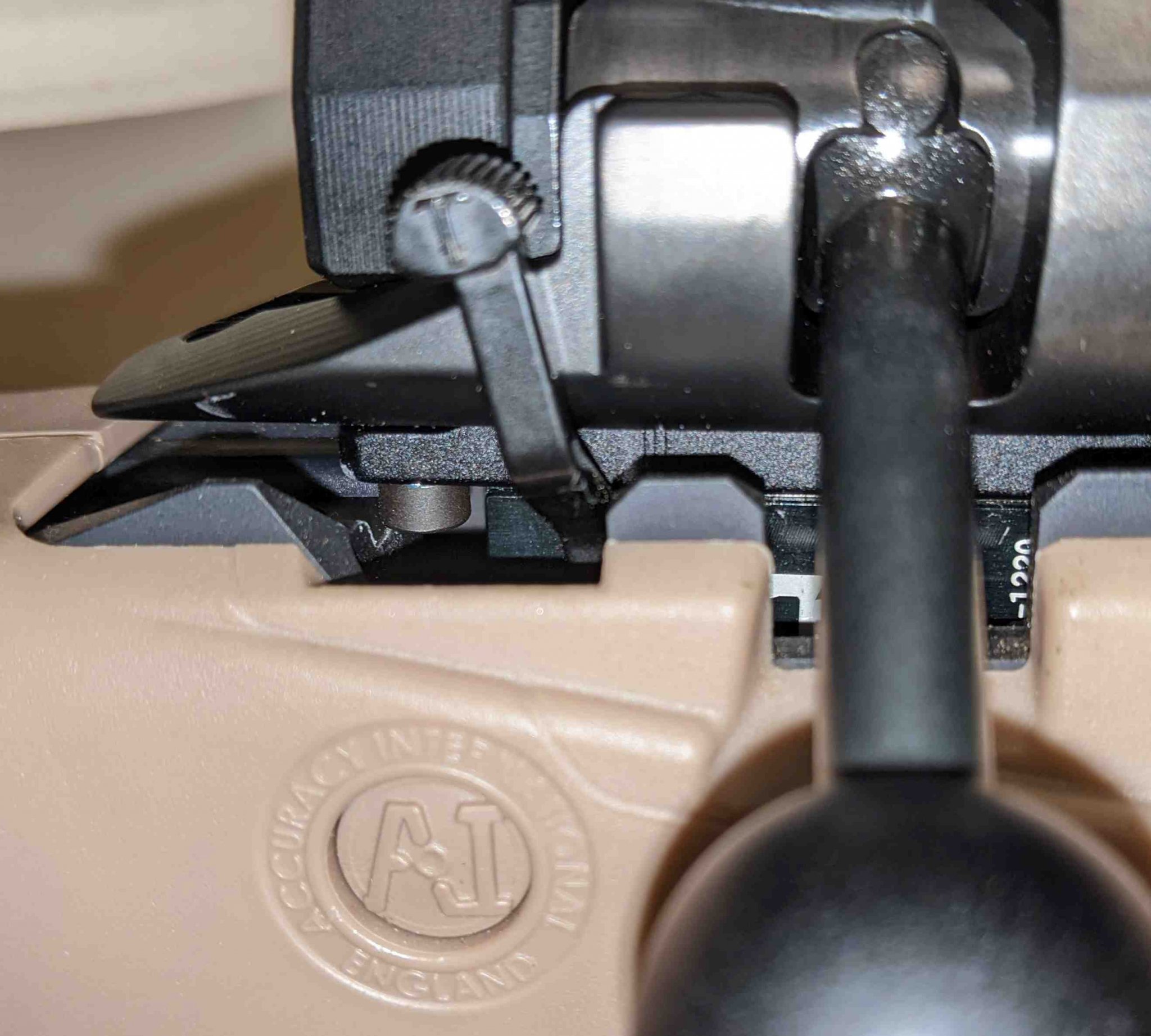

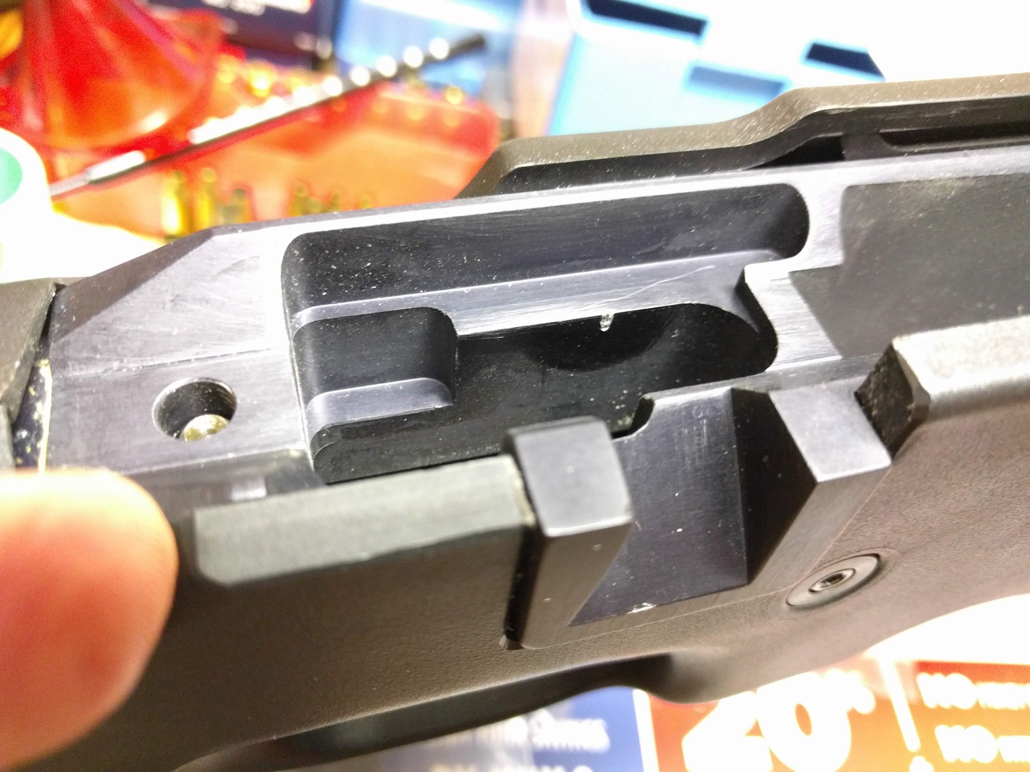

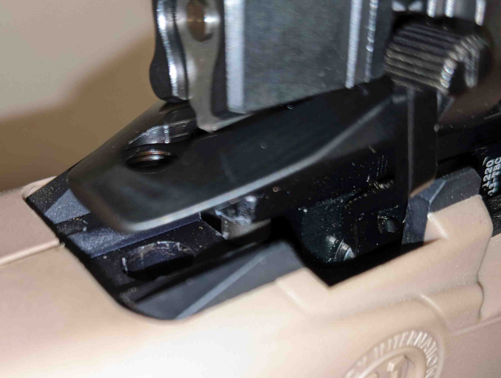

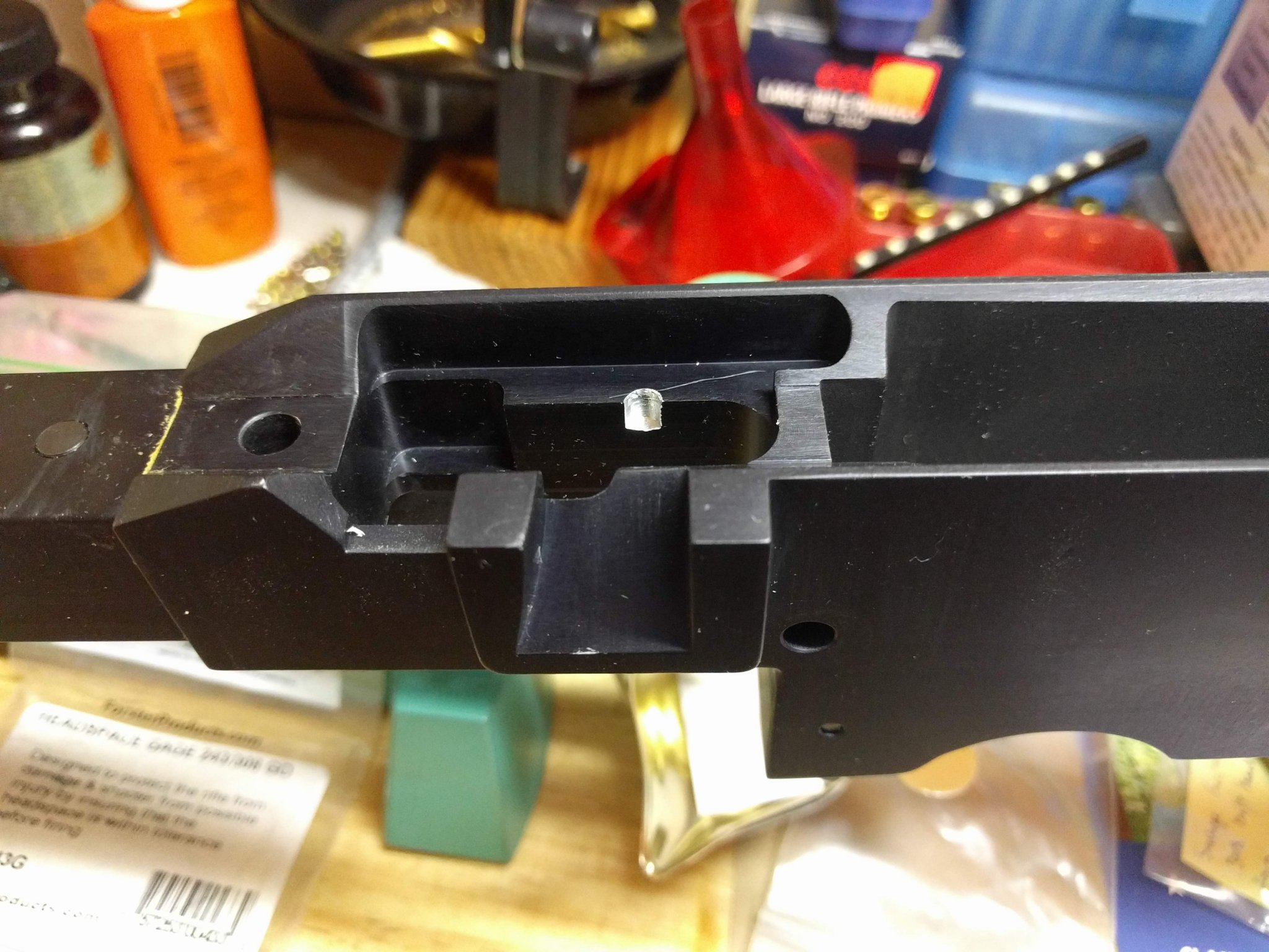

I do not know if this will help anyone, but I figured I'd post it in case. I picked up my CDG on Monday and have been fiddling with it. It, frankly, is a work of art. I have two Mausingfields (an M5 and an M7) and I love them, the CDG is somehow just a little different. It is beautiful to behold. The trigger tuning works really well and is very easy to do, very cool feature.
I don't have a dedicated stock or chassis for this action, I was planning on just swapping it into one of my AICS when I wanted to use it. This morning I gave it a try and unfortunately ran into a snag. There isn't clearance for the trigger hanger in the back or the front. I've got some (crappy) pictures of the rear-hopefully you can tell.
It looks like I could easily remove a little material with a mill and get the clearance needed to make it fit but I am undecided if I will do so at the moment. I might wait until I get a permanent stock for this.
So, just a heads up to anyone who was going to put this in an AICS, it'll need a little bit of fitting.
(do i need to say this is not a criticism of the action or of ARC? it's fucking awesome and i see why it could be considered the last of the bolt actions-i get it. this is just a heads up to anyone who wants to drop into an AICS.)

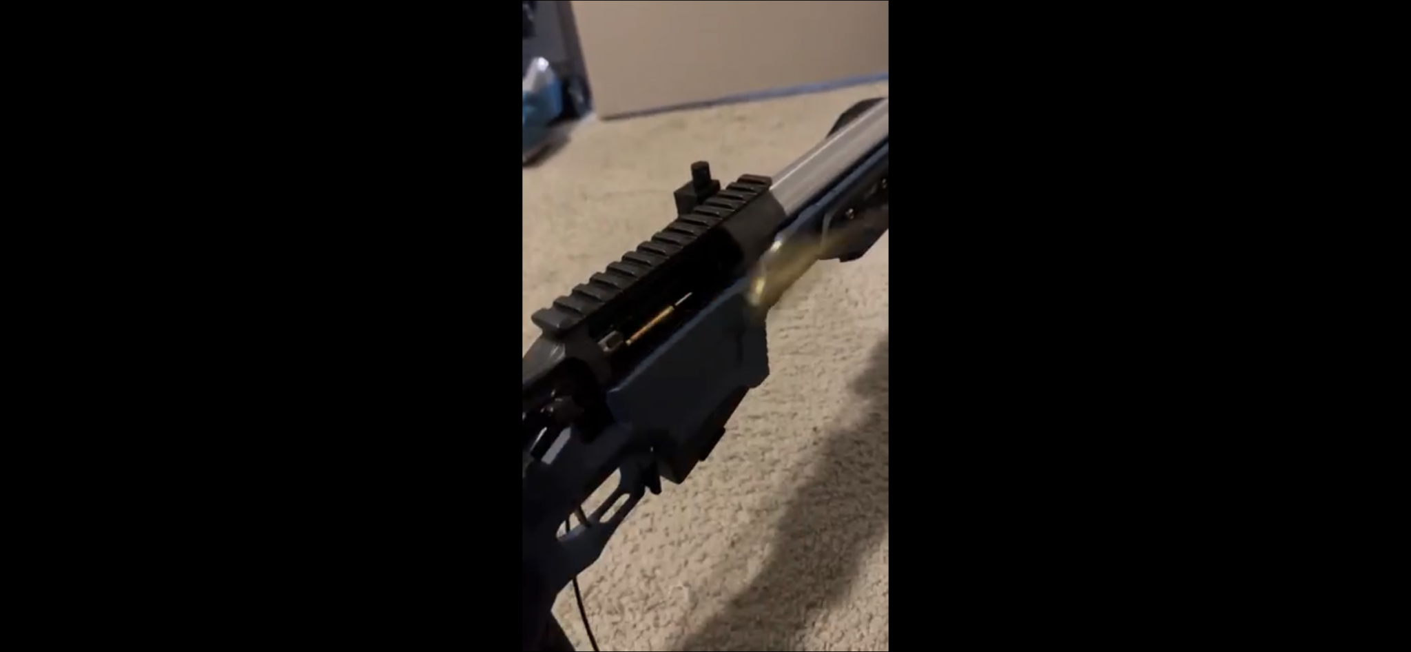

Edit to add:
This happens sometime. I had issues with a Timney in a different AICS as well:
Link to detent
Code:
https://i.imgur.com/91ksiZT.mp4
Not surprising, many stocks and chassis will need relieving to fit any action with a trigger hangar; it's not a CDG only issue. Should be an easy fix on a mill, or even with a grinder and a steady hand.
I've lost count of how many early production pre-AT AICS I had to open up on the mill over the years just to clear aftermarket triggers... AI made the AICS for many years with tiny trigger pockets. By the time the AT and AX AICS came out they finally started making them with ample clearance for aftermarket triggers.
Good thing about the AICS is after you pull the plastics off they have a lot of flat surfaces and are easy to hold in a mill.
Reactions: pingunit
haha, yup, exactly! not a big deal, just wanted to give everyone a heads up.
