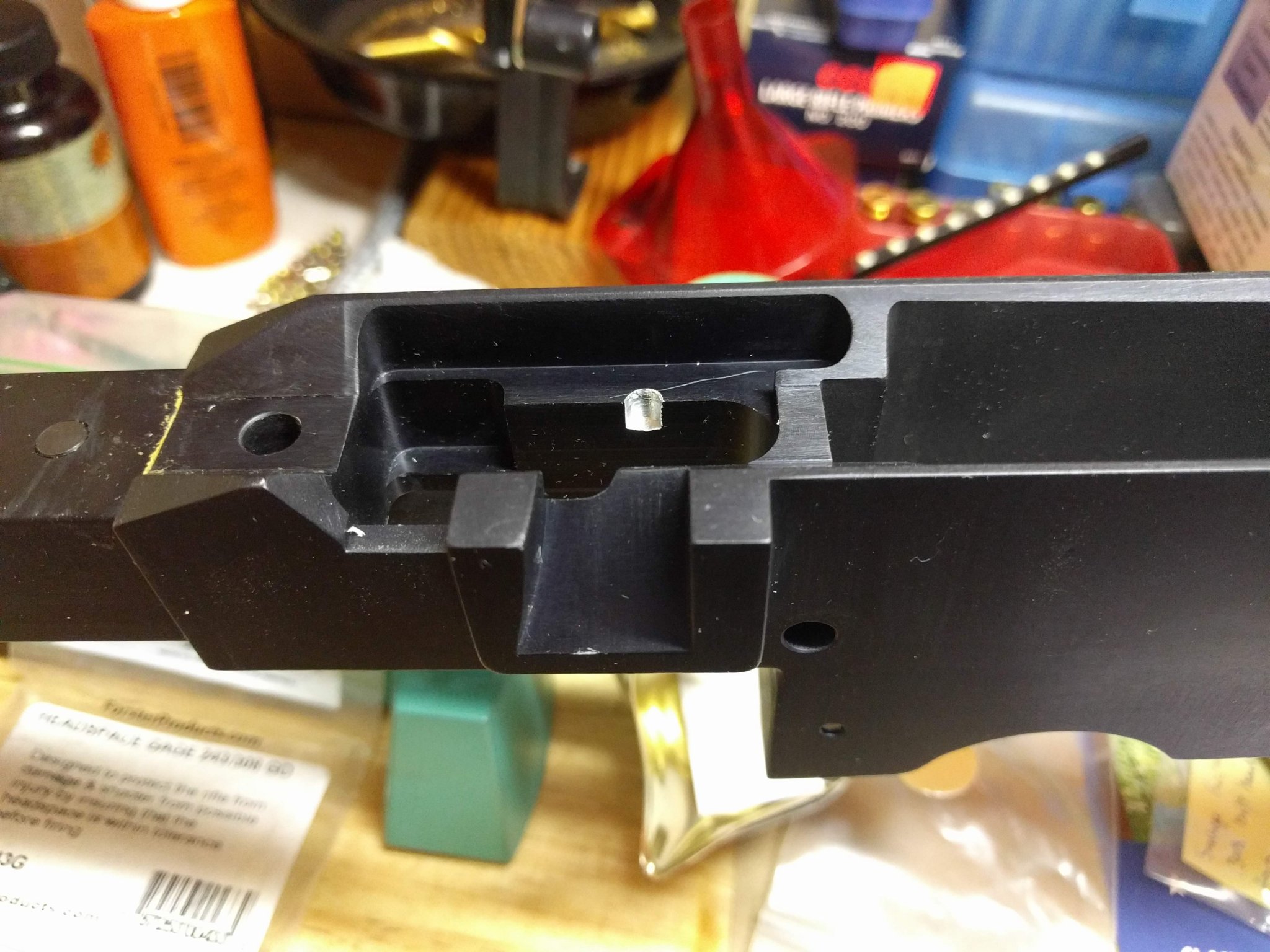

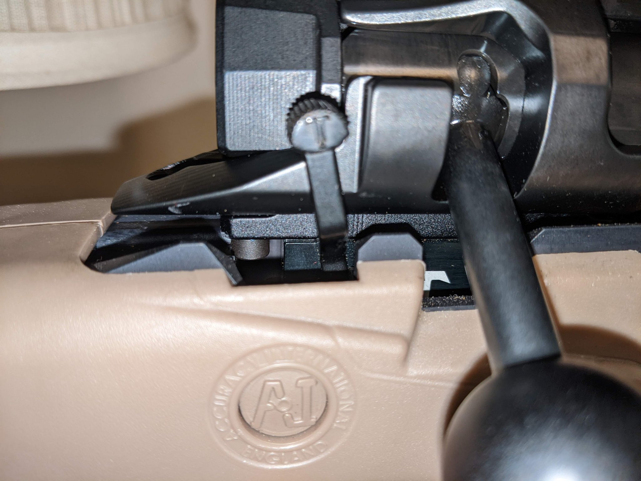

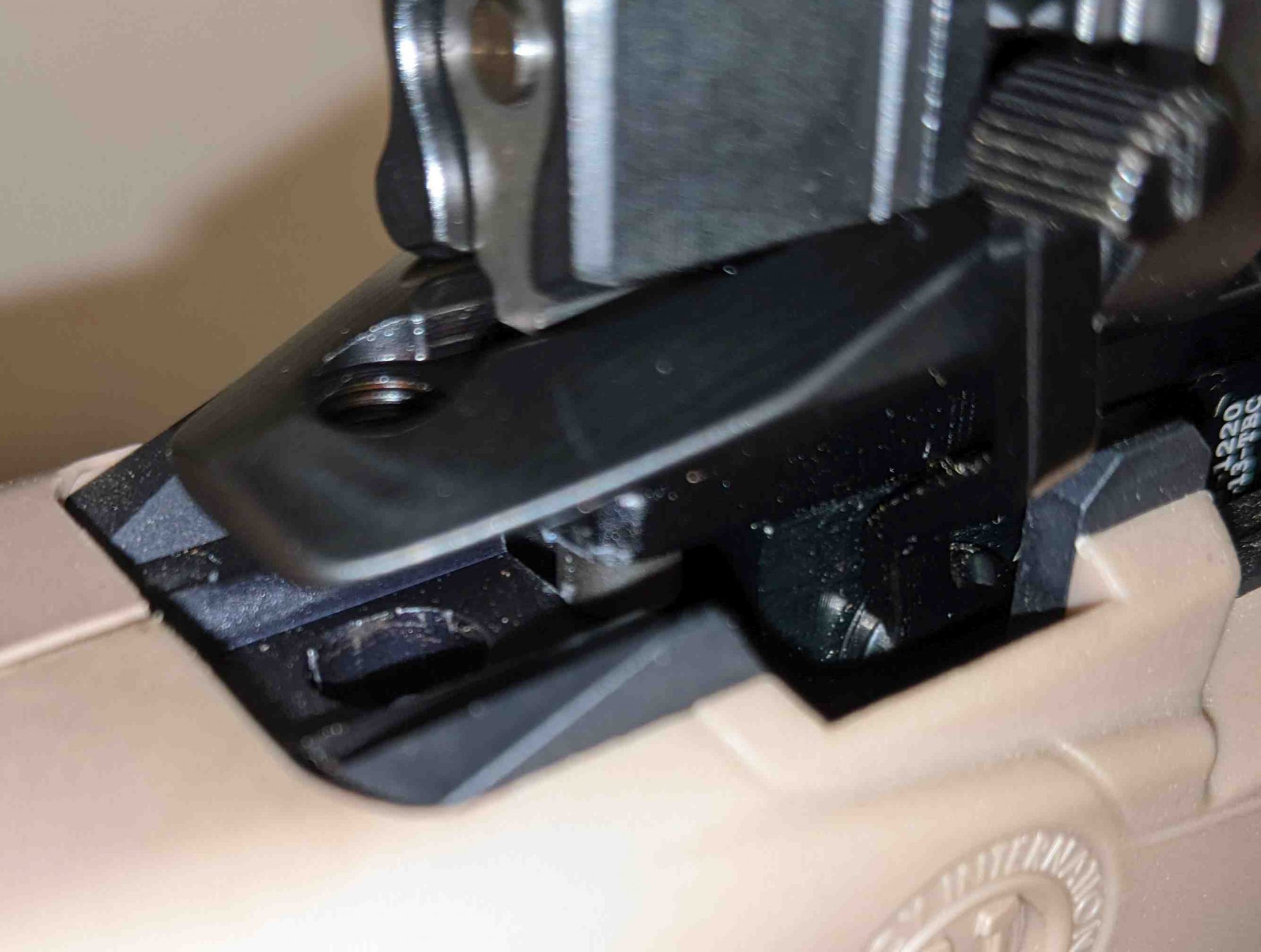

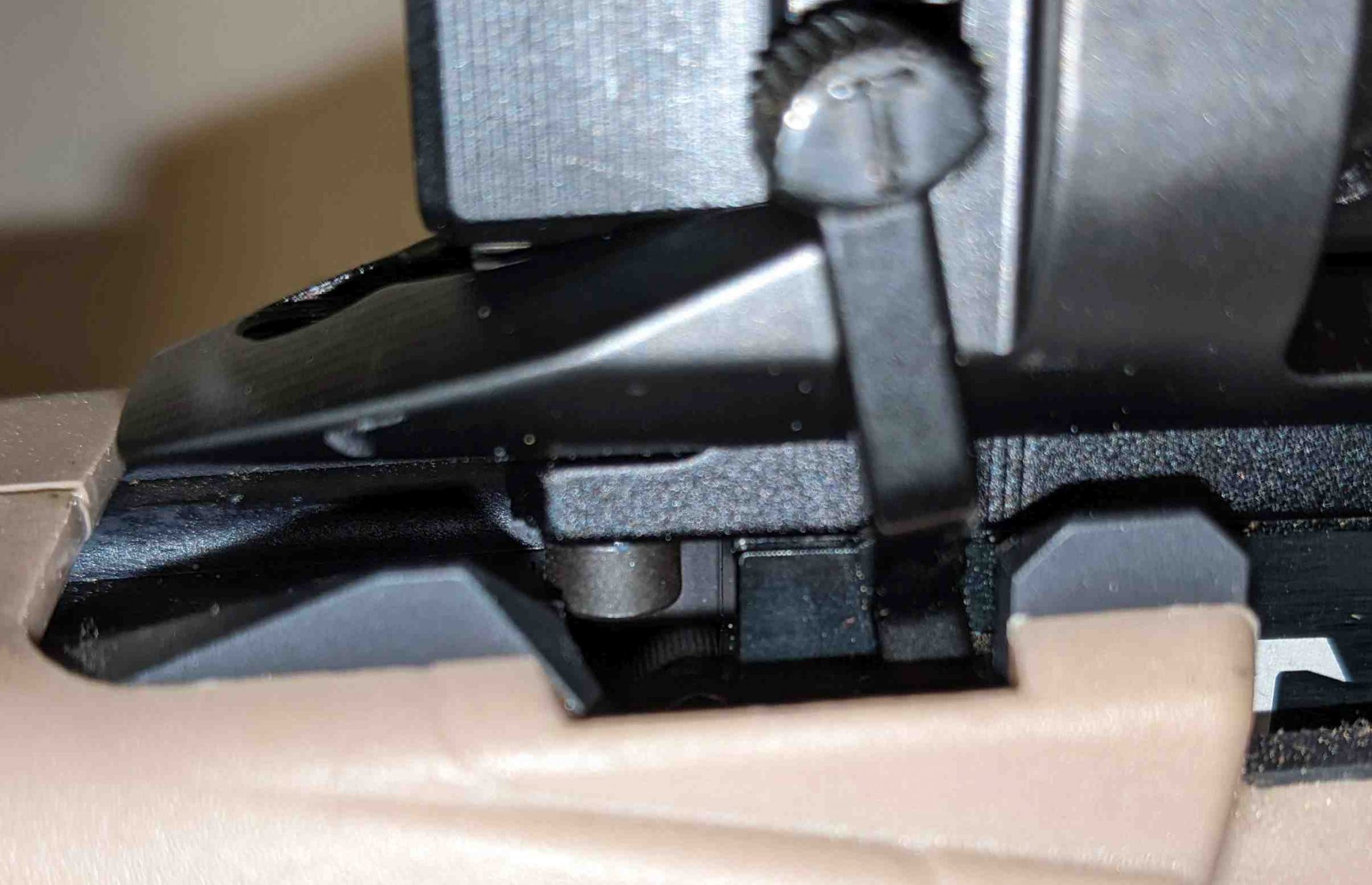

I do not know if this will help anyone, but I figured I'd post it in case. I picked up my CDG on Monday and have been fiddling with it. It, frankly, is a work of art. I have two Mausingfields (an M5 and an M7) and I love them, the CDG is somehow just a little different. It is beautiful to behold. The trigger tuning works really well and is very easy to do, very cool feature.
I don't have a dedicated stock or chassis for this action, I was planning on just swapping it into one of my AICS when I wanted to use it. This morning I gave it a try and unfortunately ran into a snag. There isn't clearance for the trigger hanger in the back or the front. I've got some (crappy) pictures of the rear-hopefully you can tell.
It looks like I could easily remove a little material with a mill and get the clearance needed to make it fit but I am undecided if I will do so at the moment. I might wait until I get a permanent stock for this.
So, just a heads up to anyone who was going to put this in an AICS, it'll need a little bit of fitting.
(do i need to say this is not a criticism of the action or of ARC? it's fucking awesome and i see why it could be considered the last of the bolt actions-i get it. this is just a heads up to anyone who wants to drop into an AICS.)
View attachment 8138401View attachment 8138402View attachment 8138403
Edit to add:
This happens sometime. I had issues with a Timney in a different AICS as well:
Link to detent
Code:
https://i.imgur.com/91ksiZT.mp4

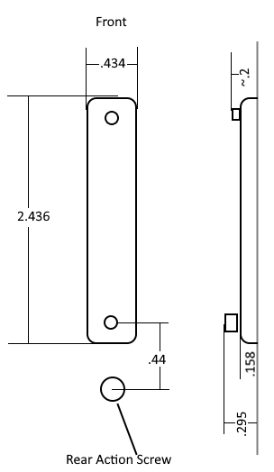

I'm a software developer and have really crummy calipers so take this with a grain of salt.
All dimensions in inches.

Thanks for replying! I figured if I could get the dimensions the vendor is asking for it would help them and others on this site as well. I understand inletting may be needed, but it sure would be great to know beforehand since it'll really "take the wind out of my sail" when I got everything to build only to find that things didn't fit well. I told the chassis vendor that if they didn't get the dimensions they needed before I received my CDGs I'd simply send them off to them for fitment and so they can take all the measurements they wanted.
BTW, I've used Bugholes in the past and they're really great to deal with! Highly recommended all around (especially the large selection of barrels they have)!!
Reactions: CobraCharmer
Hi Evil!
Excellent!! That's exactly what I was looking for!! Thank you very much!!
Two questions, though...
Is the 0.44 inch dimension from the rear action screw the rear-most, front-most, or central location of the hanger?
About how far can the hanger move front-to-rear?
That should give me everything I need!!!

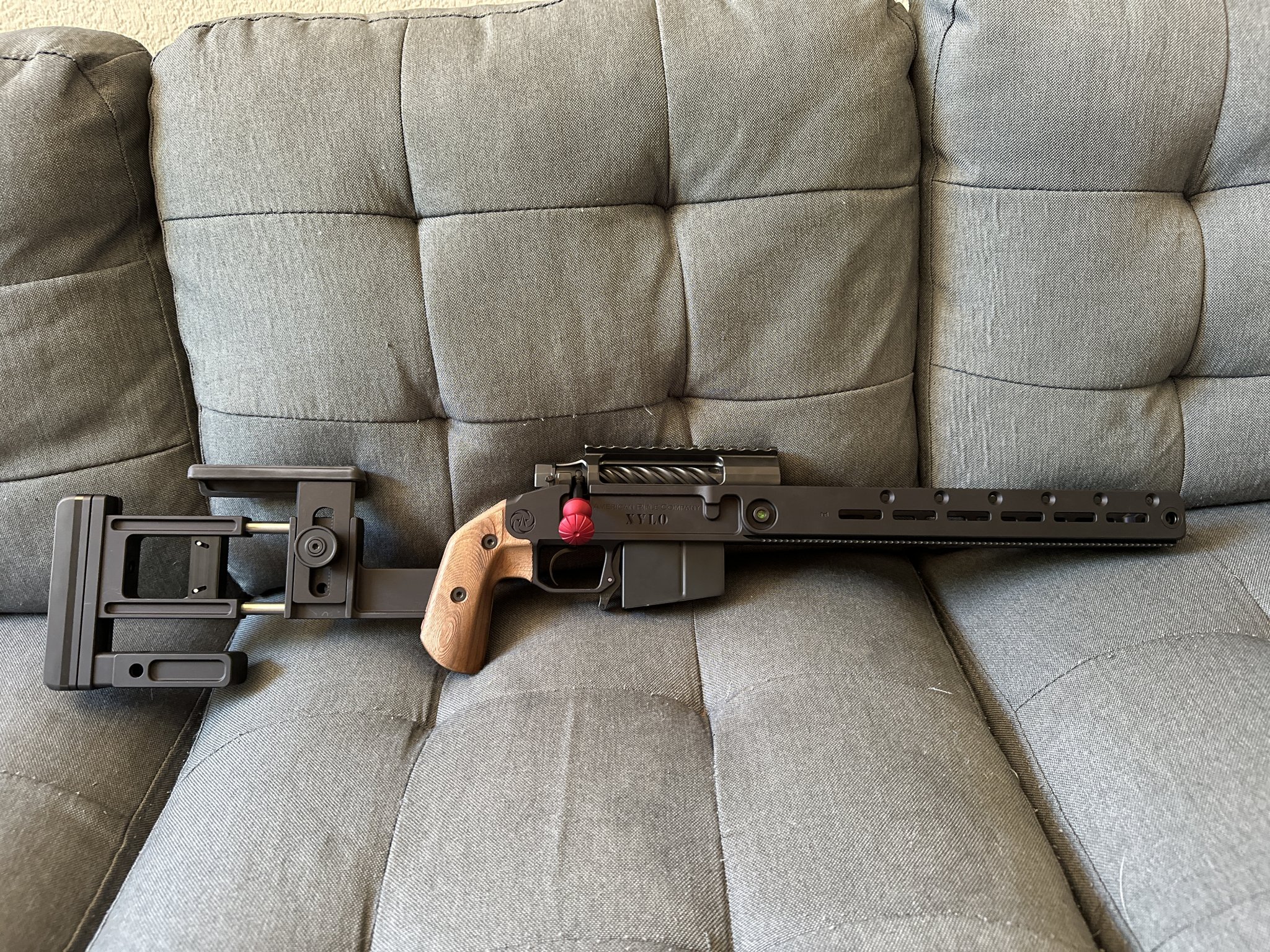

Just got a reply from Manners re: their long range hunter they will inlet for the CDG and in a lefty
Ah... the .44" is center to center and the rear screw does not move... so it's not super helpful now that you bring it up.
Dang... that is a VERY good question. I'm not sure I want to un-time my trigger to get the answer though :-( maybe someone who hasn't gotten their trigger on can chime in?

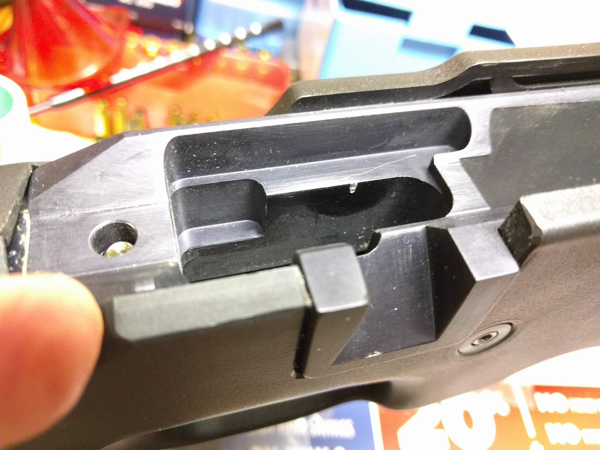

I sent my MDT ACC chassis over to Greg / Russ at Bugholes (Southern Precision Rifles) along with the brake and Trigger Tech Primary trigger. At the end of the day, from my conversation with them, it is best if they get to put this together as additional inletting might be the way to go here.
For anyone curious, my ACC Elite fits the CDG just fine.
Rear action screw needed to be sanded down slightly or the bolt would catch.
