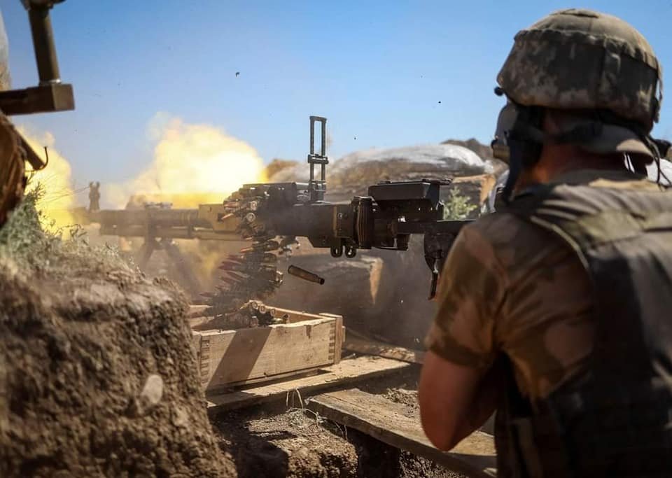

This thing?
Jeez. That decidedly does not look like something I want firing at me.
Yea its the soviet block version of the M2 50cal. Not fun at all, especially when little midgets in PJ's are willing to hump one up a mountain at 10k feet and a bunch of ammo to ruin your party.
Reactions: carbonbased
