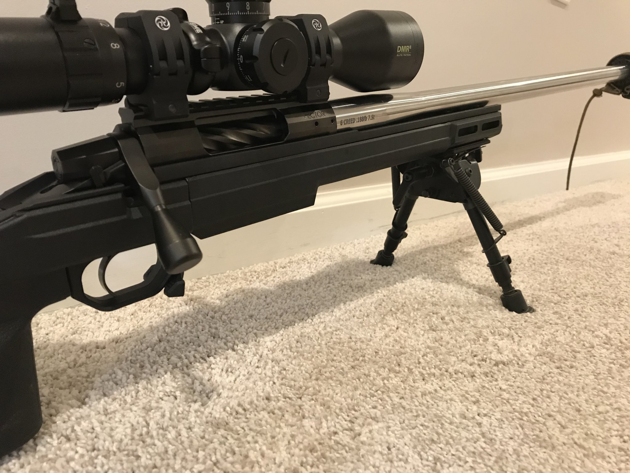

Got my 6 Creed barrel today from Straight Jacket Armory. Just put it all together. Ill zero it and test it at distance this Sunday.
How long was the wait time from straight jacket armory?
Almost 2 months, but take into account I ordered right when they started moving, so factor a few weeks there. Others have said 5-6 weeks when I asked.
If you want quick, go Keystone Accuracy. I’ll be getting a 308 from him here soon.
Got everything zero’d today. Didn’t really try for groups, but it was giving me around 1/2” with Hornady 108 Ammo.
Shoot 58 rounds today. At 20 rounds I chrono’d to get an idea and its @3050 ( with a suppressor). Even if it stays there, thats good enough for me.
Took it out to 1060 without issue. At 950 yards I shot two rounds, loosened the set screws, unscrewed the barrel, hand tightened it back on and torqued. Loaded 3 more rounds and connected at 950 again. Zero hiccups, works as advertised.

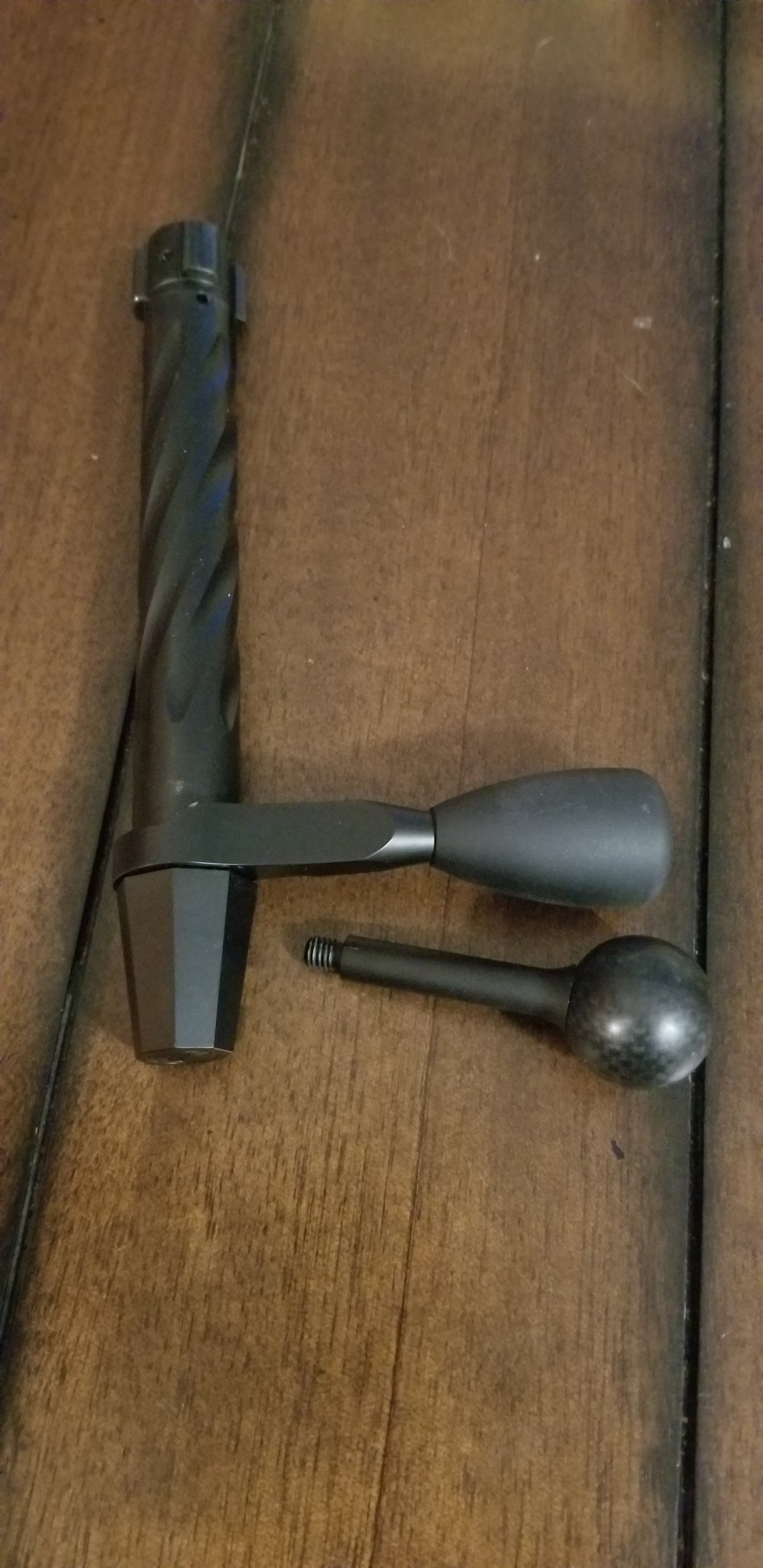

BOLT HANDLE MOD:
Ok so here is what i got. Really wanted to put a trg bolt on this but really do not want to spend $70 on a bolt handle alone. My concern is that the trg handle will either not have enough material toward the camming surface to properly allow me to drill tap for m6x1 at a trg bolt angle. So.... I have a impact round knob and was thinking of sending it into a smith to have them turn the bolt and bolt knob into the same diameter. Then after that is done have them bend the handle as close to ai specs as possible then refinish the bolt in dlc.

BOLT HANDLE MOD:
Proceeding with modifying my vectors bolt handle. I am going to go with the trg bolt handle option. Will be cutting down the original vector bolt handle at an angle like the trg. Then drill and tap the material left over from the handle. Pics will be posted within the next 2 weeks.

VERY interested in this as well...please take detailed notes/photos if you can! Are you also looking to sweep the handle back as well?
Yes, the handle will be swept back like the trg. Should be simple enough with a hacksaw, file, demel, hand drill, and tap

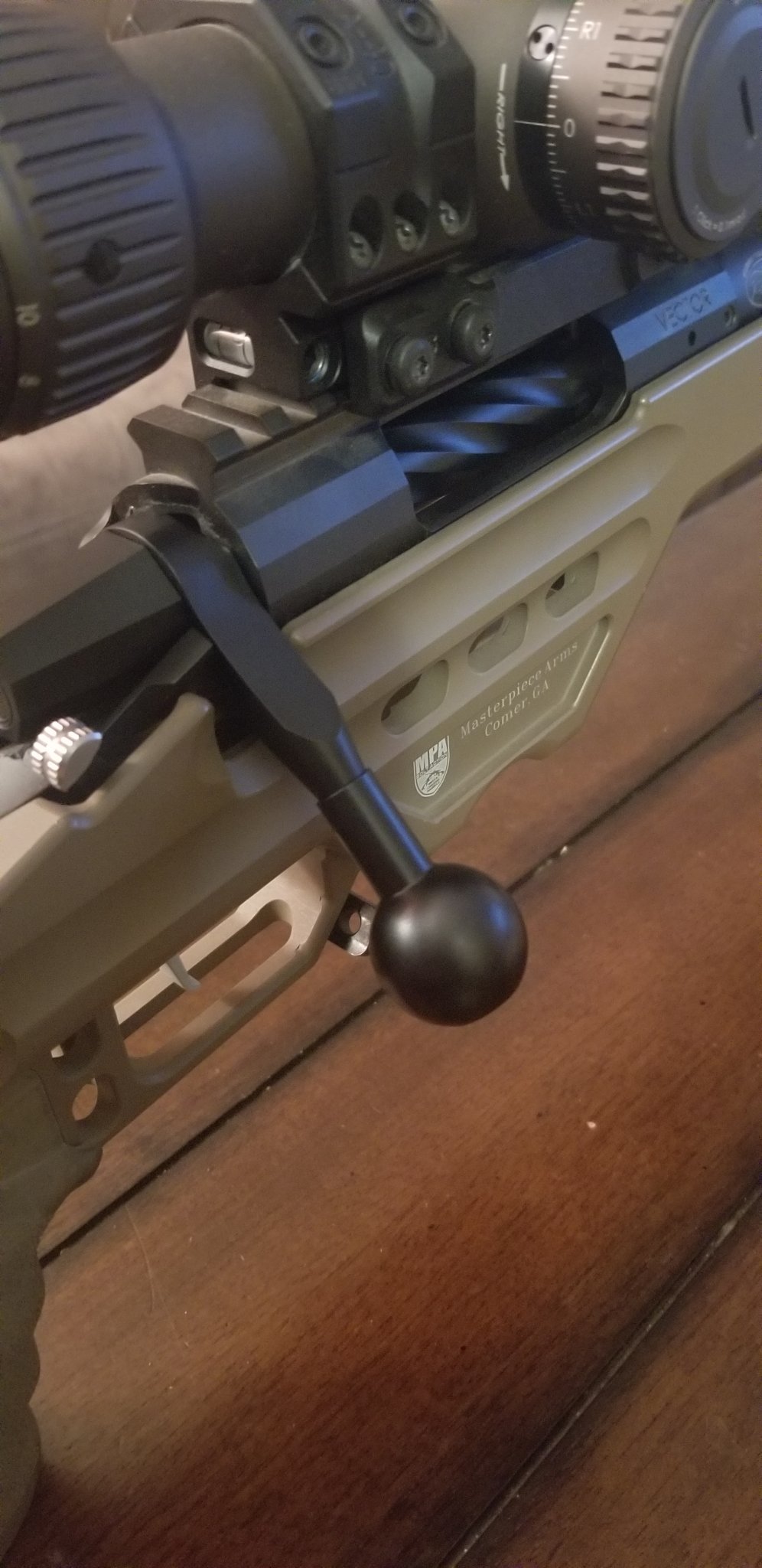

Trg bolt handle came in. Looks like i will have a little project this weekend.
When I first got mine I wanted to try bending the handle back cause I liked my Tikka swept handle as well but I didn’t have the balls to try it and now I guess I have gotten used to it cause I tried to run my Tikka last weekend and now it felt weird. I will also add that I found the best feel with the MPA bolt know and adapter after trying several others. I also thought about trying to bend just the handle adapter that way if I screwed up or didn’t like it I wasn’t out a whole new bolt, but like I said, once I got the MPA knob/adapter on it I didn’t mind it as much.
Thats fair. I just want the bolt closer to my hand for less movement. I thought about bending it as well but like the look of the sako trg bolt. At this point id most likely keep my vector so i wouldnt worry about resale value goin down.
I was more concerned with messing it up/breaking it, or weakening the bolt from heating it than was concerned with resale value, but with what you are doing you don’t really have to worry about that cause you aren’t bending it. Definitely post some pics and your findings once it’s done.
