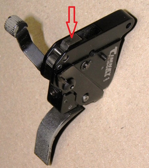

Will someone please explain the statement about Timney triggers and light strikes? What are the mechanics?
At the risk of oversimplifying, it's the trigger top sear. The trigger top sear engages the bolt cocking piece. The cocking piece is attached to the firing pin. When cocked, the trigger top sear holds the cocking piece rearward; i.e., cocked.

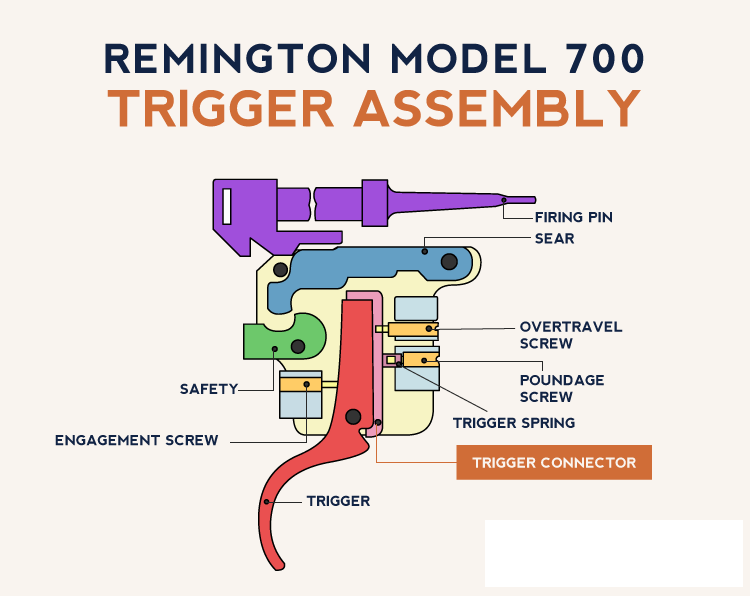

When the trigger is pulled, the top sear drops and releases the cocking piece/firing pin. The issue is how far rearward the trigger top sear holds the cocking piece/firing pin. This distance is the pin fall.
If the top sear does not hold the cocking piece rearward sufficiently, the pin fall will be too short and when the firing pin strikes the primer, it will not have enough energy to cause ignition.
Several action manufacturers have found that Timney triggers (at least certain models) will not hold the cocking piece/firing pin rearward enough for reliable primer ignition. I personally had light primer strikes with a Timney 2 stage trigger on a Badger M2013. Badger advised they do not recommend Timney triggers. After several calls to Timney, and conflicting information, I was able to obtain a replacement top sear which corrected the condition. It did however take additional firing pin travel adjustments to fully resolve.

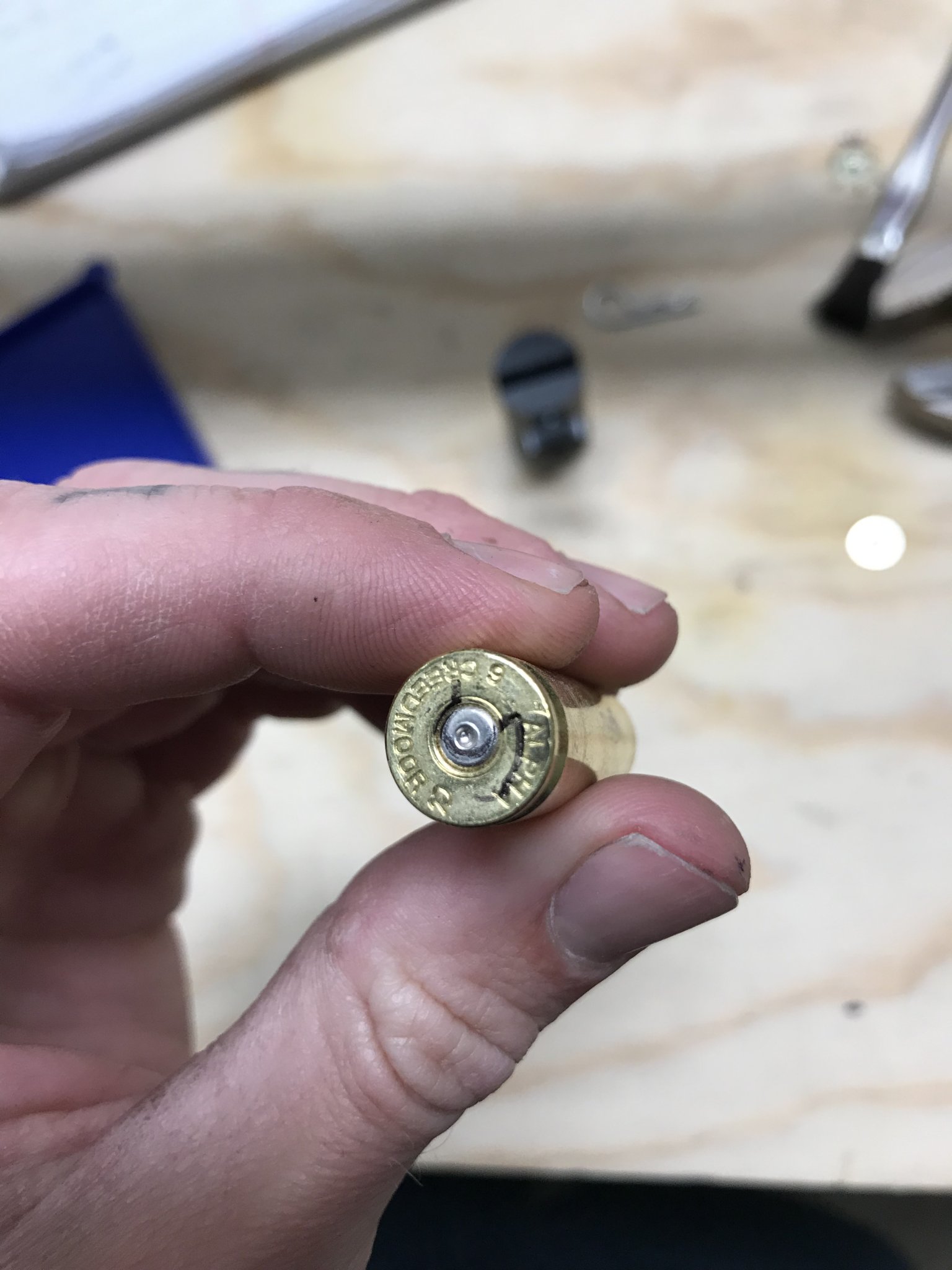

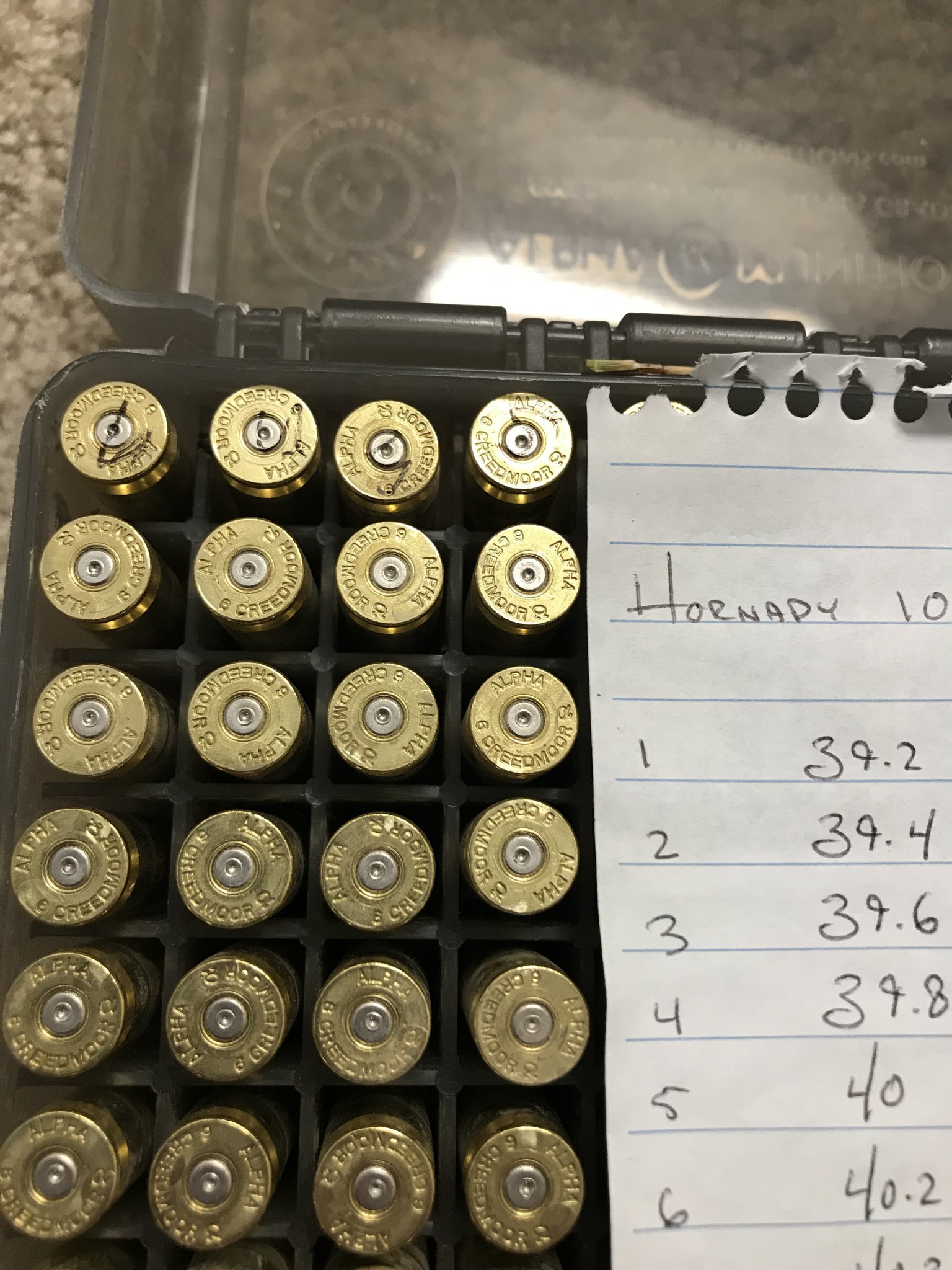

No extraction issues but pressure signs from nowhere with with previously developed loads that showed zero pressure and new loads that are under max. New loading of 6cm with 39.2 grains of H4350 is showing ejector marks whilst cratering CCI 450 primers. A prior load of 41.4 grains of H4350 which barely grew the brass before now gives me a sticky bolt. If it was 100 out I would understand but this was in 68 degree weather. Alpha brass both new and once fired fl sized brass. Need to do some more system checks before I blame the action and / or it’s components but I’m suspicious of the bolt. Checking the fx120i today but that will likely be inconclusive. I’ve been wrong before though....

Just checked the scale to the previously calibrated weight. Received reading was 99.994. Yeah not the scale.
Here’s a photo for reference. A little hard to see without zoomage.
**Edit with better picture of the 39.2 grain loaded brass**
How many rounds on the barrel? Could be a carbon ring has formed and is causing you to hit the pressure edge.
