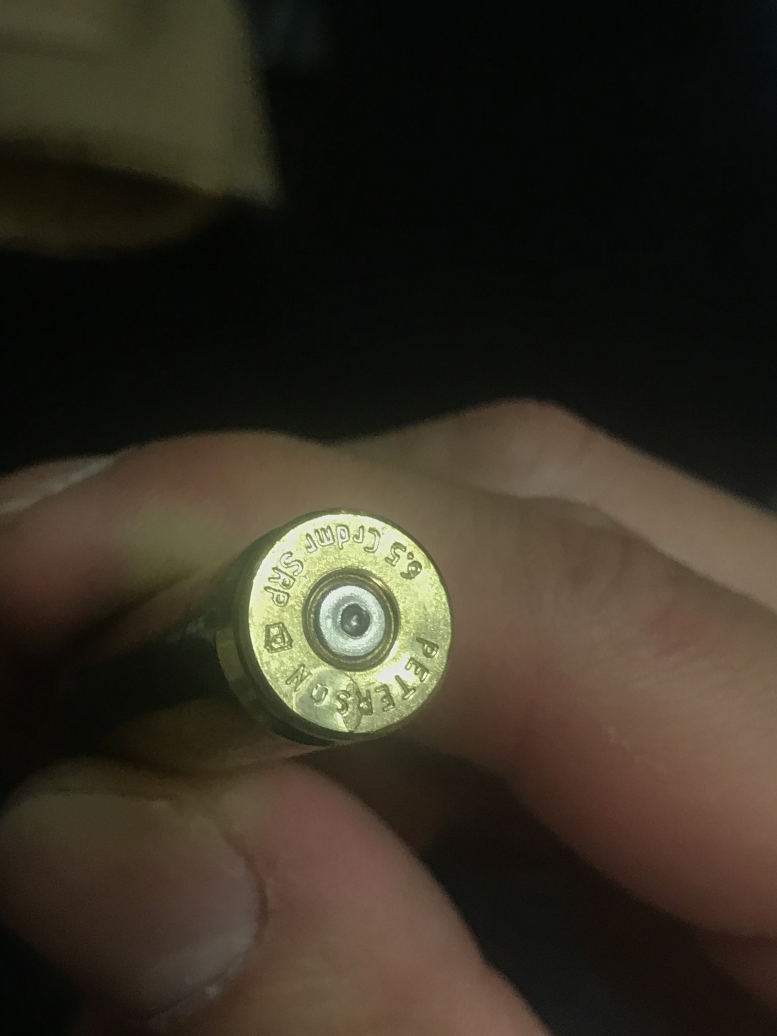

I have not. I’ve been waiting to get back out to the range with some virgin brass that lacks any ejector marks. I went from hand tight to torqued. I had totally forgotten about the different tenon specs between hand tight and torqued. At torqued I was running into pressure issues which makes sense (now anyway).
I went back out with the barrel hand tight and the pressure seems to have come down as extractions with known no issue loads where ejecting without trouble.
I’ll be sure to post my findings with the virgin brass once I finally get a free weekend.

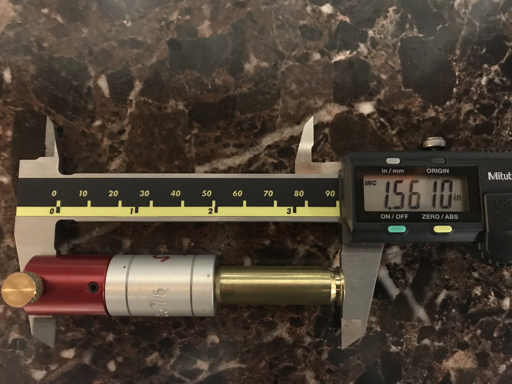

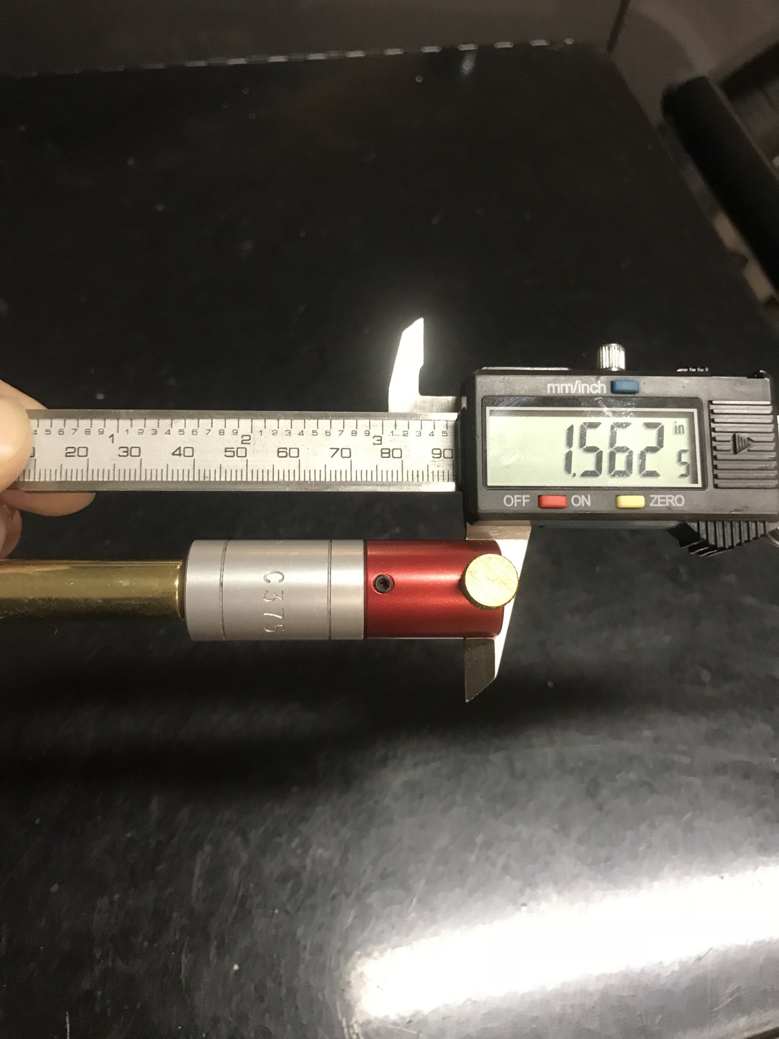

I think i did kind of fix the issue I had, but not 100%
Went back to the range today with my barrel that cut to be hand tight torqued down to 80ft lbs shot some 41gr and 41.5gr charge. Shot ten 41gr h4350 charge at fast rate of fire in less than 1min, Bolt lift and extract like butter on all ten of them, none of them has flatten primer or ejector mark, then immediately load up another 5 rounds and shot them in less than 1min without issues, took a 5min cig break moved on to 41.5gr re16 load(my proven laser load) shot an amazing 1/4 moa group, one has slight flatten primer, and two has slight ejector mark, bolt lift on those two were just slightly heavier, unlike before it was so heavy and has a dreaded click on extraction and the ejector mark were so severe that a chunk of brass on the face of the casehead was scrapped, immediately I loaded 5 with 41g re16 and shot a sub .5 moa group, none of them has flatten primer or ejector marks.
This time my virgin brass measures 1.562 after firing, I think either my head space is still little too much, little too much bolt face to case head clearances or my load is too hot???
I’m going back to the range on Thursday and do more testing with fired formed brass this time, I’m not going to bump the shoulder back at all since the 1.562 brass still chambers without too much resistance. I’ll keep everyone posted, cheers y’all!

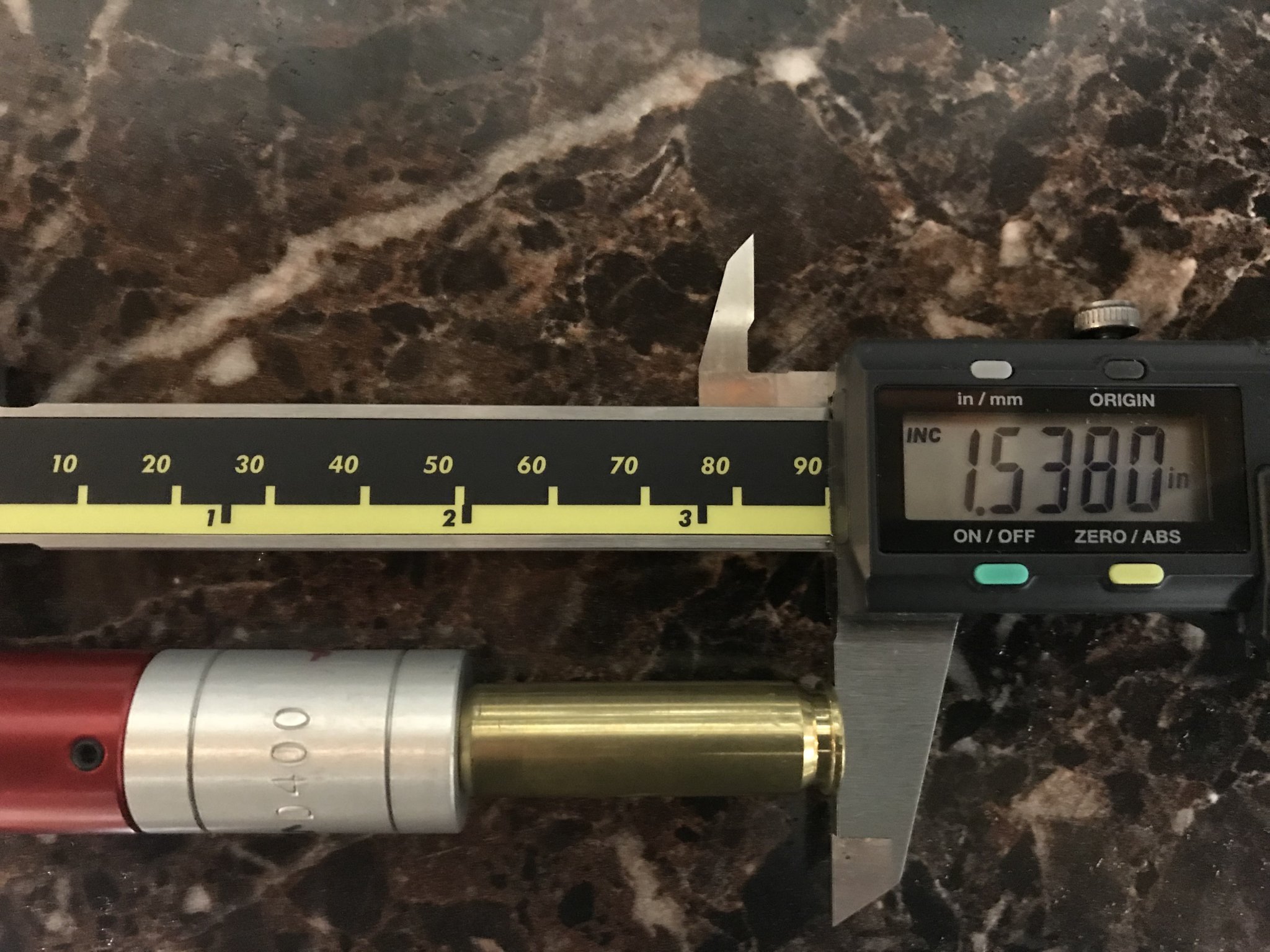

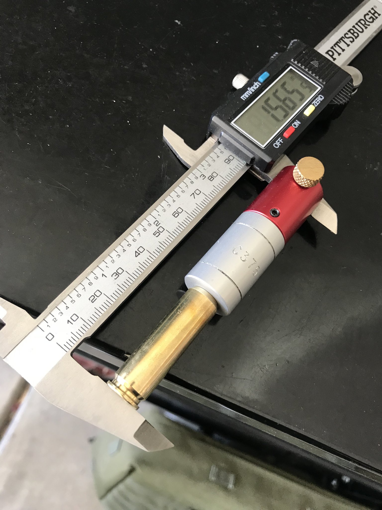

@702shooter Your case to datum length seems long. I just cut a fresh barrel for my 6.5 Creedmoor using a PTG SAAMI reamer and Forster Go/No-Go gauges. My fired Hornady brass measures 1.539" (using .400" comparator bushing).
Damn, didn't see this. Good eye.
My fired 6.5 hornady brass comes out at 1.538" (also using the .400" bushing)

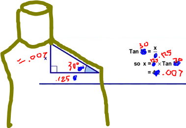

Hope Im not screwing up the trig but: If he were using the .375 bushing it would be a reading .007 longer. .400-.375=.025/2=.0125 of radius per side of brass shoulder .0125*tan(30°)=.0072 so your 1.539+.007=1.546 with a smaller head space bushing.
If we go with the .350 bushing it should read .025*tan(30°)=.014 and 1.539+.014=1.553 so still less than the number he is getting by 9 thousandths.
I think this rules out the headspace bushing selection as the source of error as his are reading over even the smallest hornady bushing.

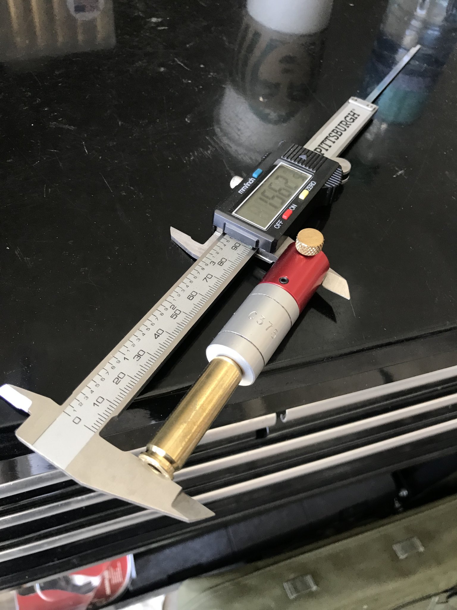

@702shooter Id like to hear exactly what tools you are using to get this measurement and Id also be curious to know if you have checked it out with a go gauge. Chamber the go gauge, see if it closes. Then add a layer of tape onto the back until it doesnt close anymore and compare the two measurements to see how far over go you actually are.

I was using the .375 bushing for my measurements. I’ll use the .400 bushing to measure my virgin and fired casings tonight and see how my measurements compare to yours.
Will do thank you sir! I’ll go home take some pictures of the tools I’m using and measurements of the casings tonight.

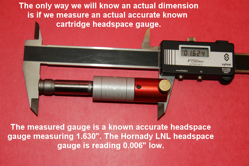

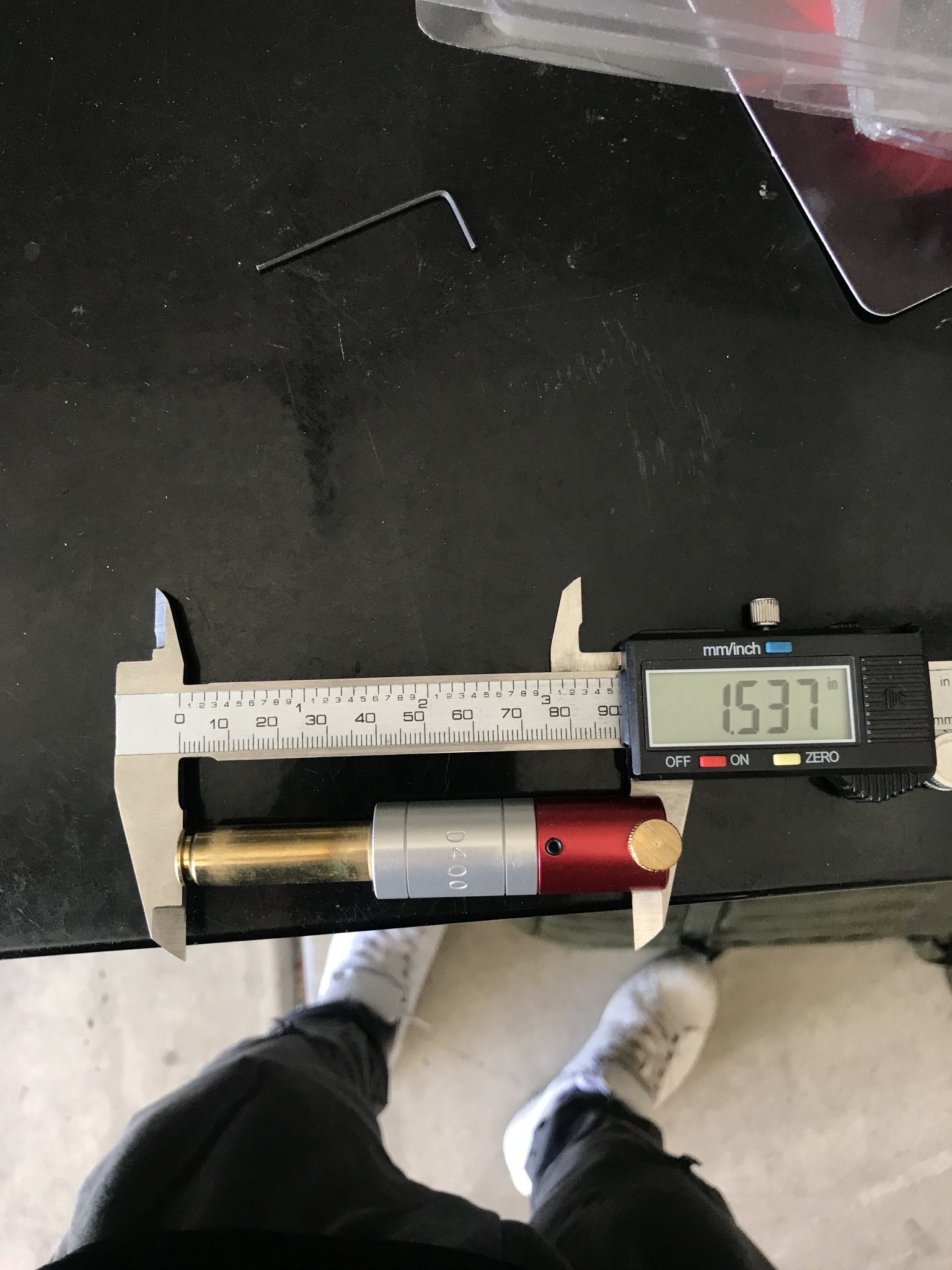

Not sure if you checked this, but I at least wanted to see the difference.
Same hornady case, deprimed. First is the D400, second is the C375 you are using.
I would think about using the D400, at least when giving numbers to smiths or Curtis, as the D375 would put it out of saami spec for chambering.

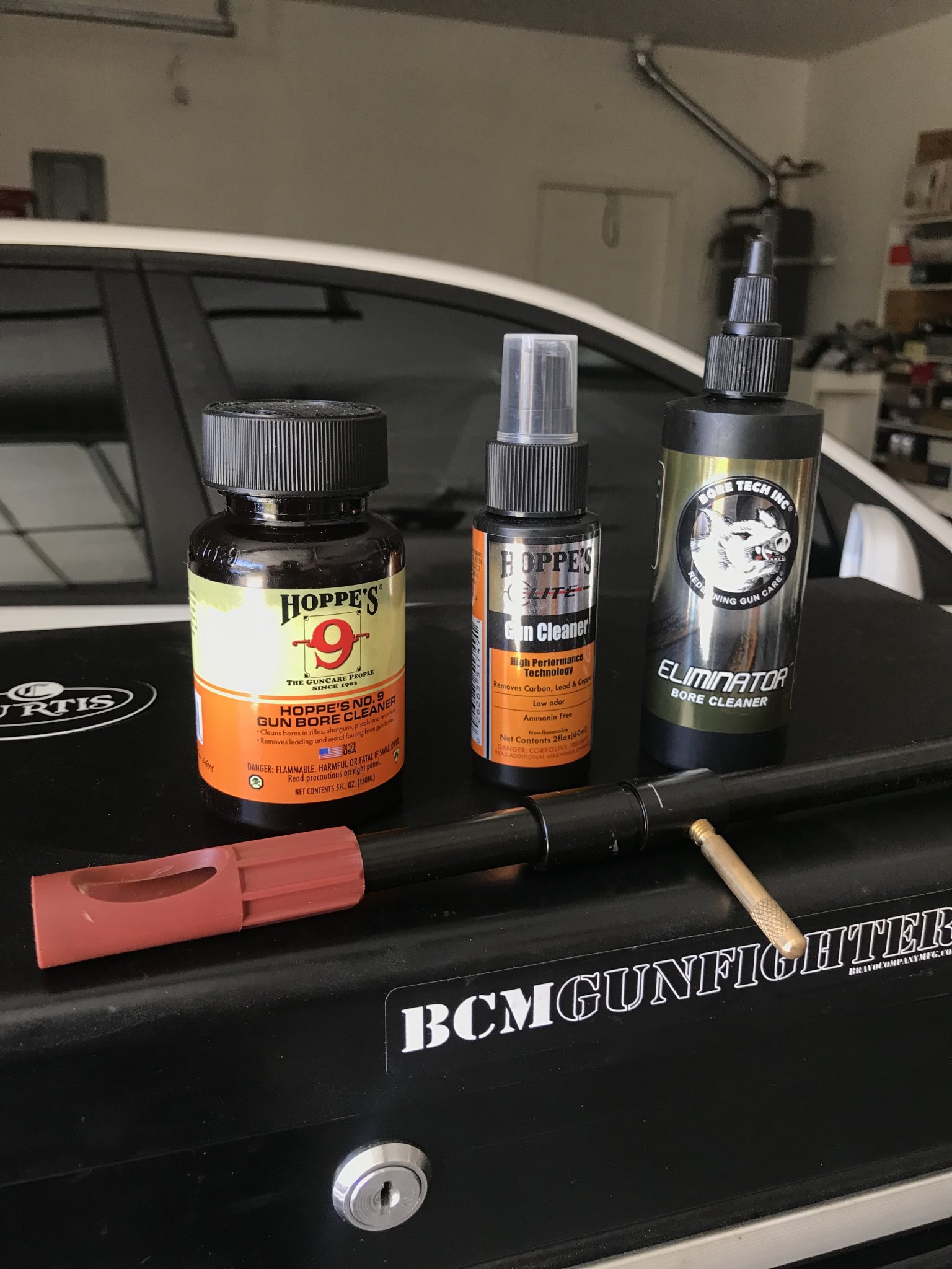

Just tossing ideas here... what solvent are you using when cleaning and how often?
Do you buy any chance own a bore scope? There is a really good one on Amazon that I picked up. I’m impressed with the quality of the image given the price.
Teslong Rifle Bore Scope, 0.2inch... https://www.amazon.com/dp/B07TTQF24F?ref=ppx_pop_mob_ap_share
I guess what I’m getting at is... it’s possible that you have a carbon ring causing your pressure issues. The head space you are seeing doesn’t seem that excessive, at least when you are saying primers are falling out.
Again, just throwing out ideas.

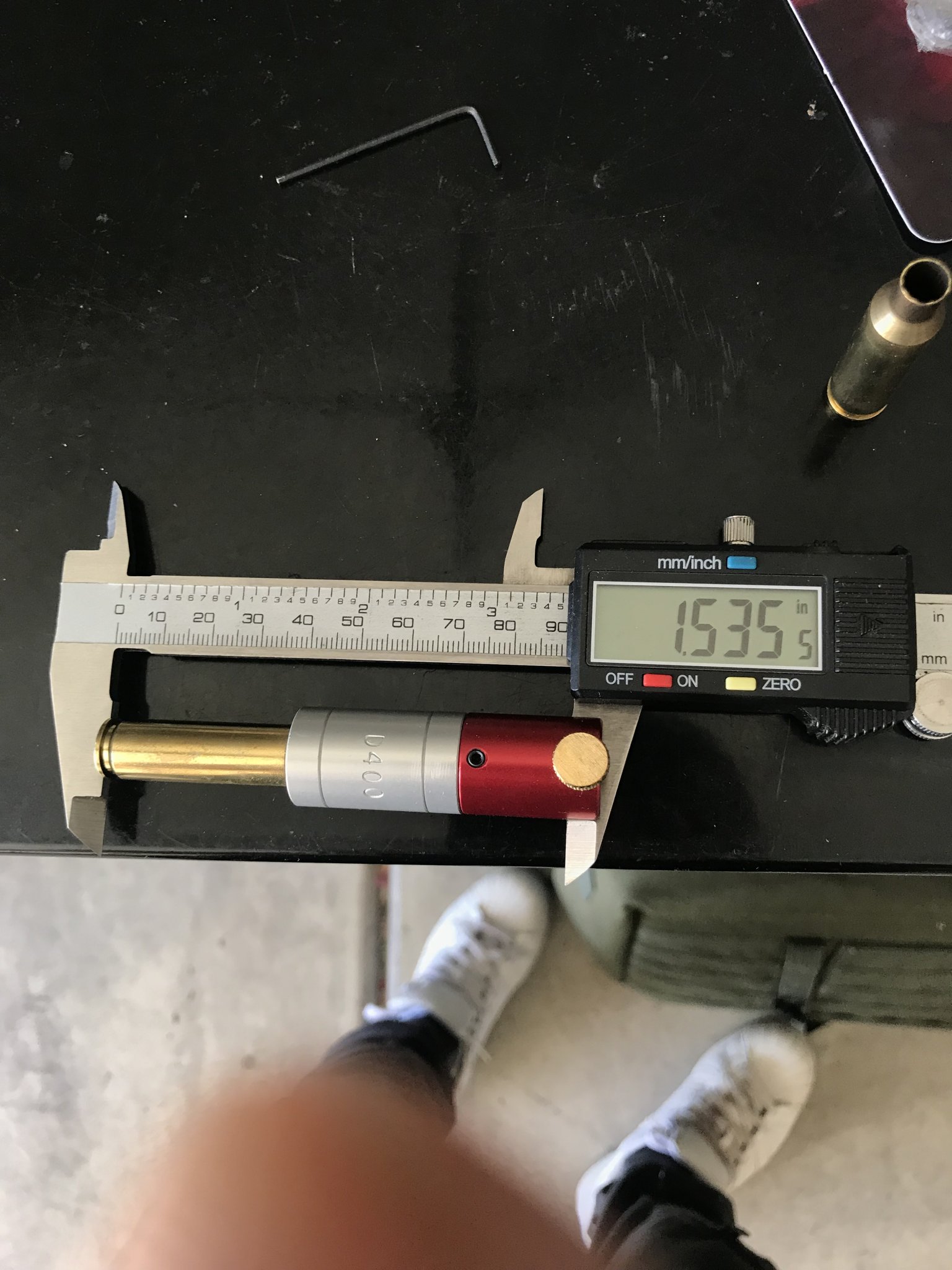

some pictures of measurements with c375 bushing and d400 bushing, fired casing hand tight vs torqued to 80ft lbs.
I clean my barrel every 180-250 rounds after initial break in. For my cleaning procedures, I run 1 wet patch of bore tech then 5-7 dry patch, then 1 semi wet patch of hoppes9 another 5-7 dry patch.
Maybe it’s the carbon ring like you said. I did took off my barrel once to give it a deep clean, I even put a brass brush and nylon brush in the throat give it a good 2-3 min spin with a drill, heavy pressure still comes up after I hand tighten the barrel.
For my other two beater rifle I clean them every 500-800 rounds lol and I only use hoppes9 for them. They never developed a carbon ring heavy enough to cause issues similar to what I’m experiencing with the vector.
Maybe custom barrels require higher maintenance than factory barrels? Like race guns requires extremely high maintenance or they won’t cycle right?

I would wet a patch using boretech and put into the chamber until you just feel resistance ( hitting the lands ) and let it sit for an hour. Then, take a nylon or brass brush and do the same thing... push until you hit resistance then spin the brush for a bit. Now, run some dry patches and see what comes out.
I only use boretech, now. I ran MPro7 for years and thought my barrels were clean, until one patch of boretech ( waiting an hour ) and it came out black.
Based on your cases, I wouldn’t say you have a headspace issue.
Someone else might be able to offer more.
I’m still not 100% sure if that .001-.002 headspace would’ve make a difference. Hopefully I have time to do another range session next week with my 2nd fired casings, and I’ll report back with how tight my primer seats and if the issue still going on.
I forgot to mention, I did do what you have said prior drilling with brushes hehe.
Stupid question, but are you cleaning all the case lube off the cases? I've had all kinds of different actions including both Curtis variants and I've never experienced pressure issues relating to an action. All kinds of other things can cause them though.
Reactions: jzwolen
I size all my casings before I wet tumble with couple drop of dawn and limeshine.
Well guys seems like I’ve fixed the issues! Went to the range couple days ago shot 50 rounds with no problem, only 3-5 rounds had slight heavy bolt lift since I was shooting some fast strings and the barrel was pretty hot. Just seated the primers in my 3x fired casings an hour ago and all primer pockets are tight! Again only showed slight ejector marks on the ones that had slight heavy bolt lift but nothing bothers me.
