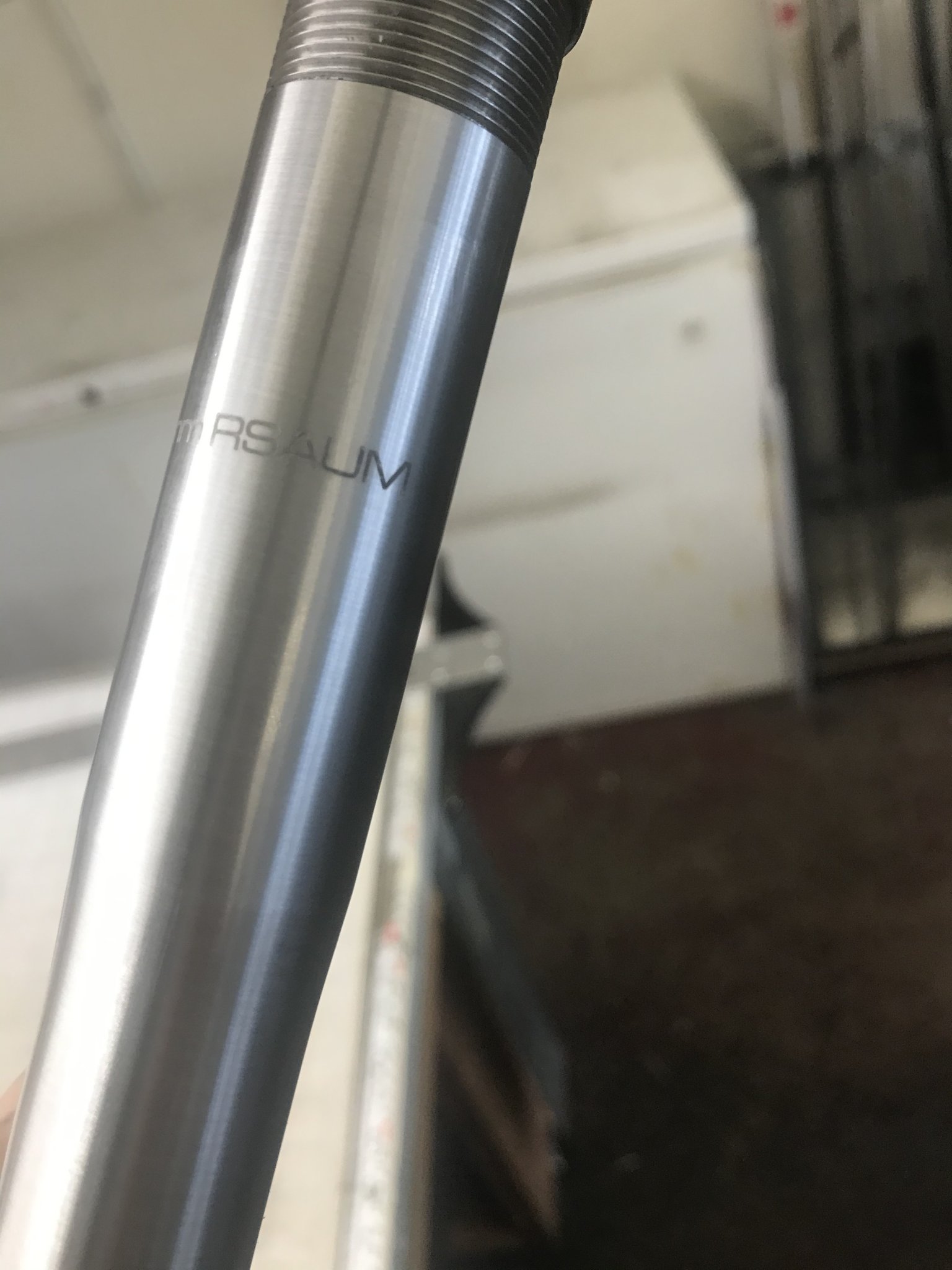

Cut rifled brux heavy Palma for small shank savage from keystone.
I bore scoped it and the throat looks immaculate not that that translates into anything but it shows care in making it.
My previous Shilen prefits were awesome barrels that shot great but this barrel’s machine work is far above them.
Both my Shilens often shot 1/4-3/8 5 shot groups.
Don’t discount the potential of a button rifled barrels.
