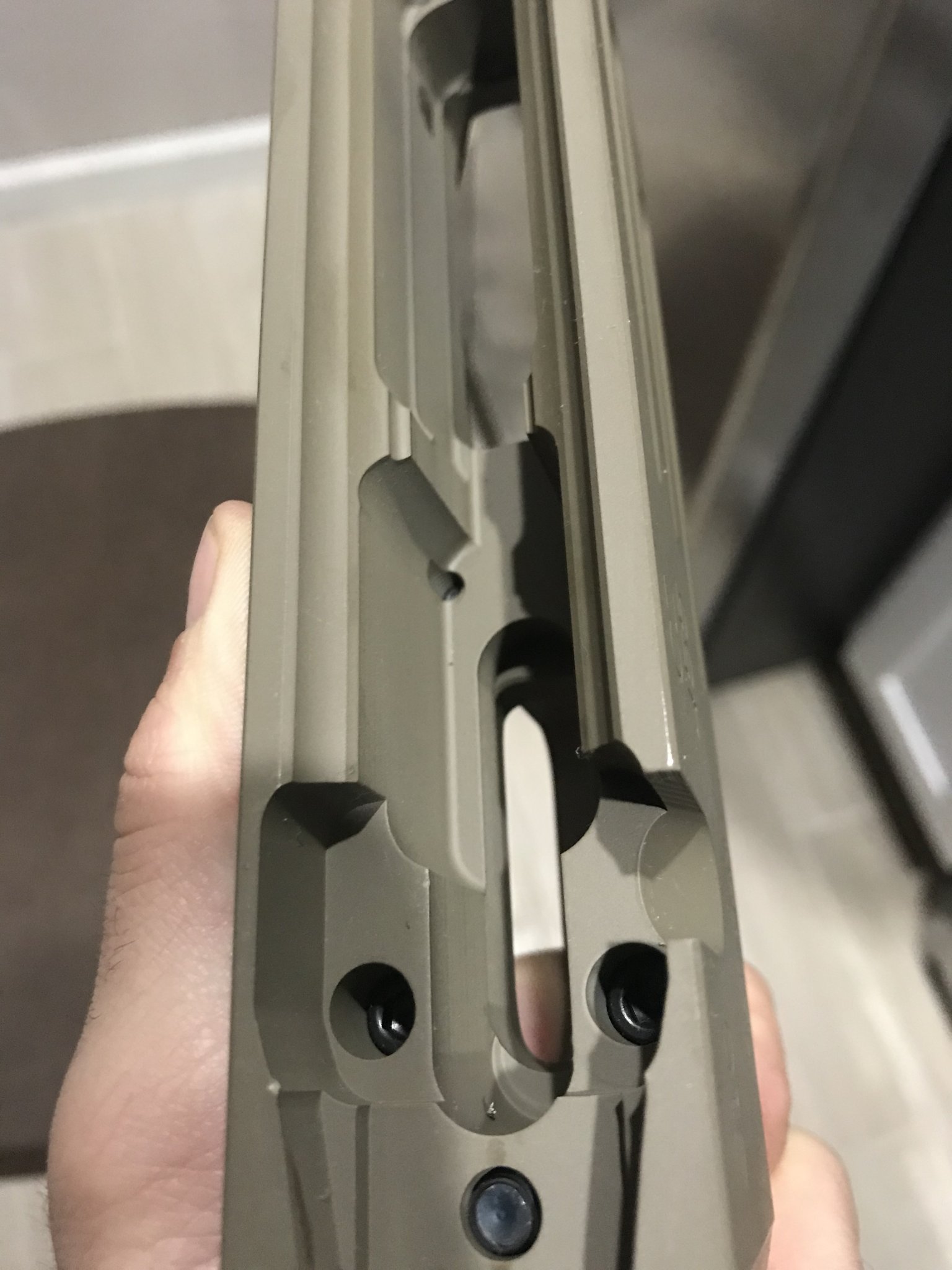

Something is definitely off. I have the same setup with zero movement when tightening the screws. I just took the action out to check it and with the screws out there is maybe a 1/2mm or less of back and forth travel. There is zero barrel movement when the screws are torqued. Looking at mine, I don't see how this could be happening without some inletting or screw length issue. Is it possible for you to post a picture of the chassis's inletting?

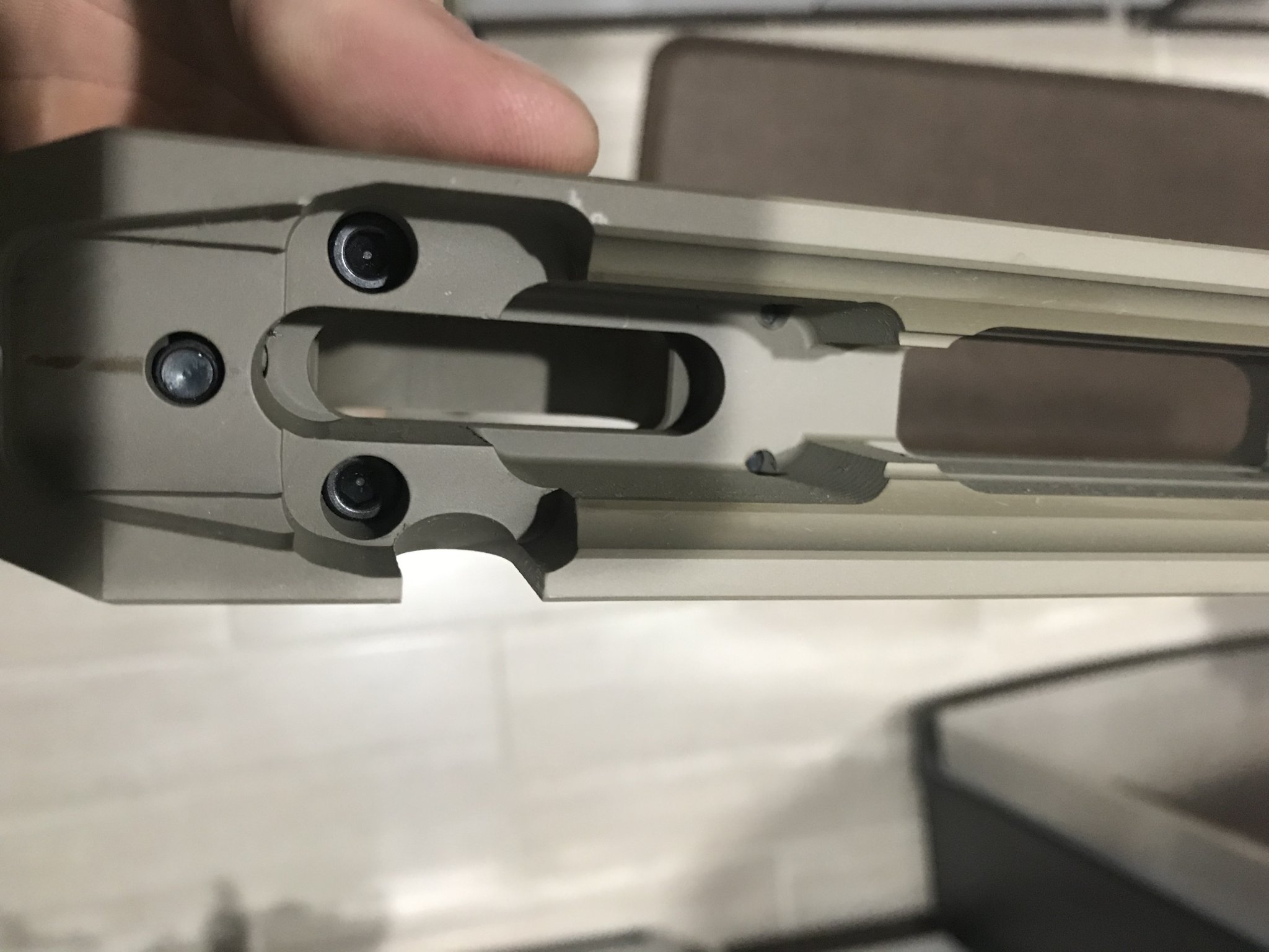

Hm, definitely something weird happening. For your SA I did misspeak. There’s 1/8” of play in the action with the screws removed, not 1/4”. That equates to about 3mm. Looking at the chassis nothing seems strange although this is my first 455 chassis. Let me know if there are any other photos you’d like to see. I measured the front action screw as well, it’s just shy of 1 1/16” or 29mm long.

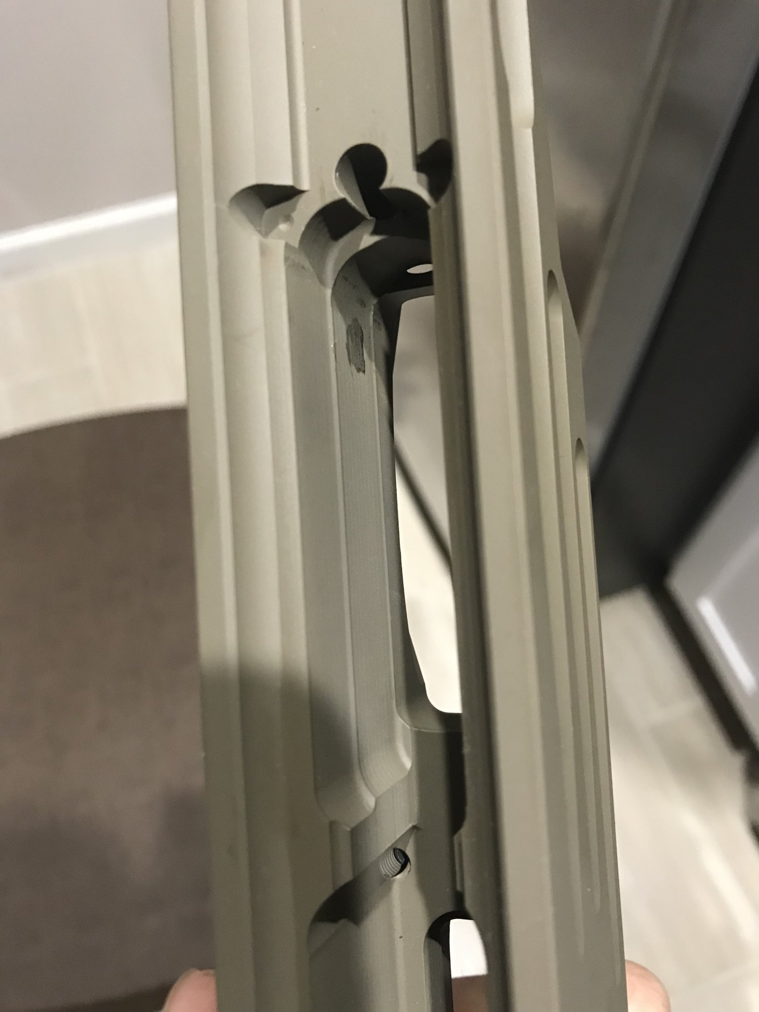

From the looks of this pic there is a little tightness in the tang inlet (seen in the very rear of the inlet as a shiny spot, **on the vertical portion of the inlet). I am not sure if this is a problem but definitely something I would examine close!
ebb998a6-cd99-4f33-8946-1c4e663144af-jpeg.6988048

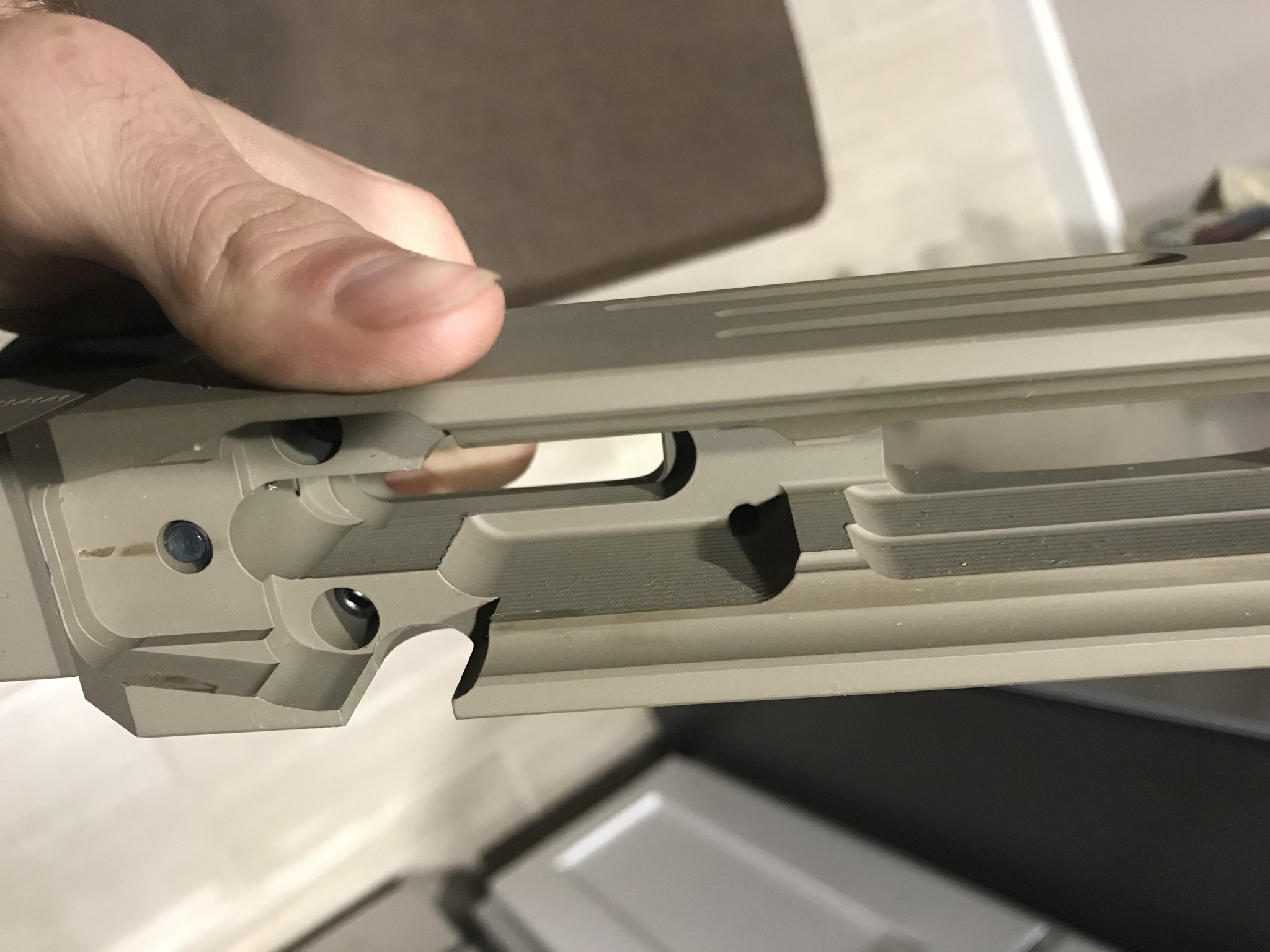

But from this angle it may just be from installing the action, again hard to say from a picture. But in this picture the right side of the tang looks to be binding on the inlet some. Ideally the tang should not be touching on the vertical sides of the inlet. Check that area out close too.

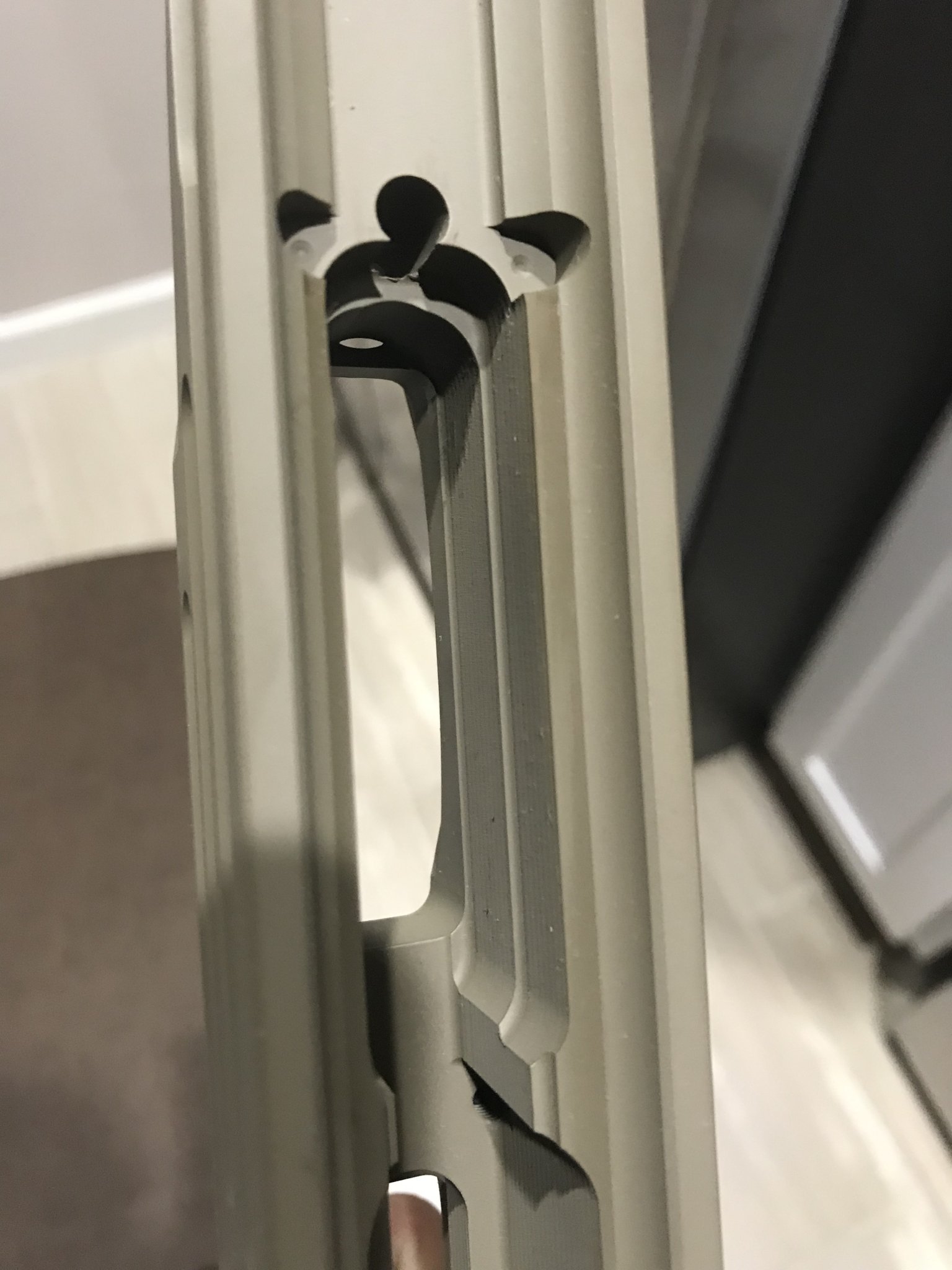

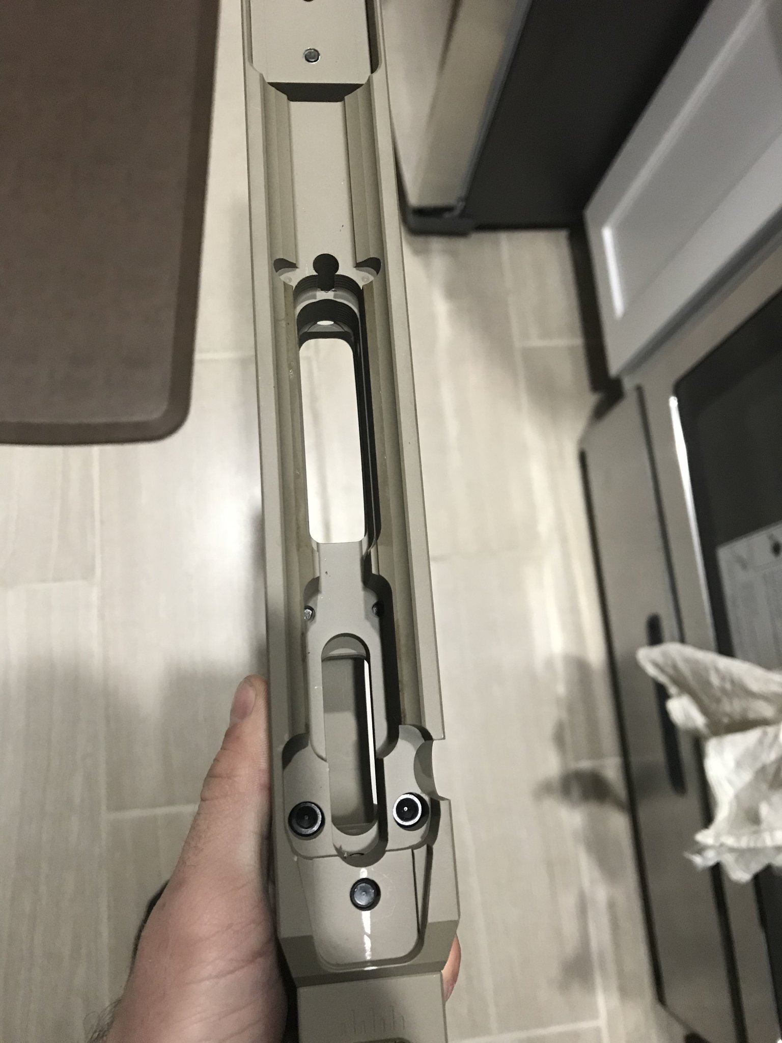

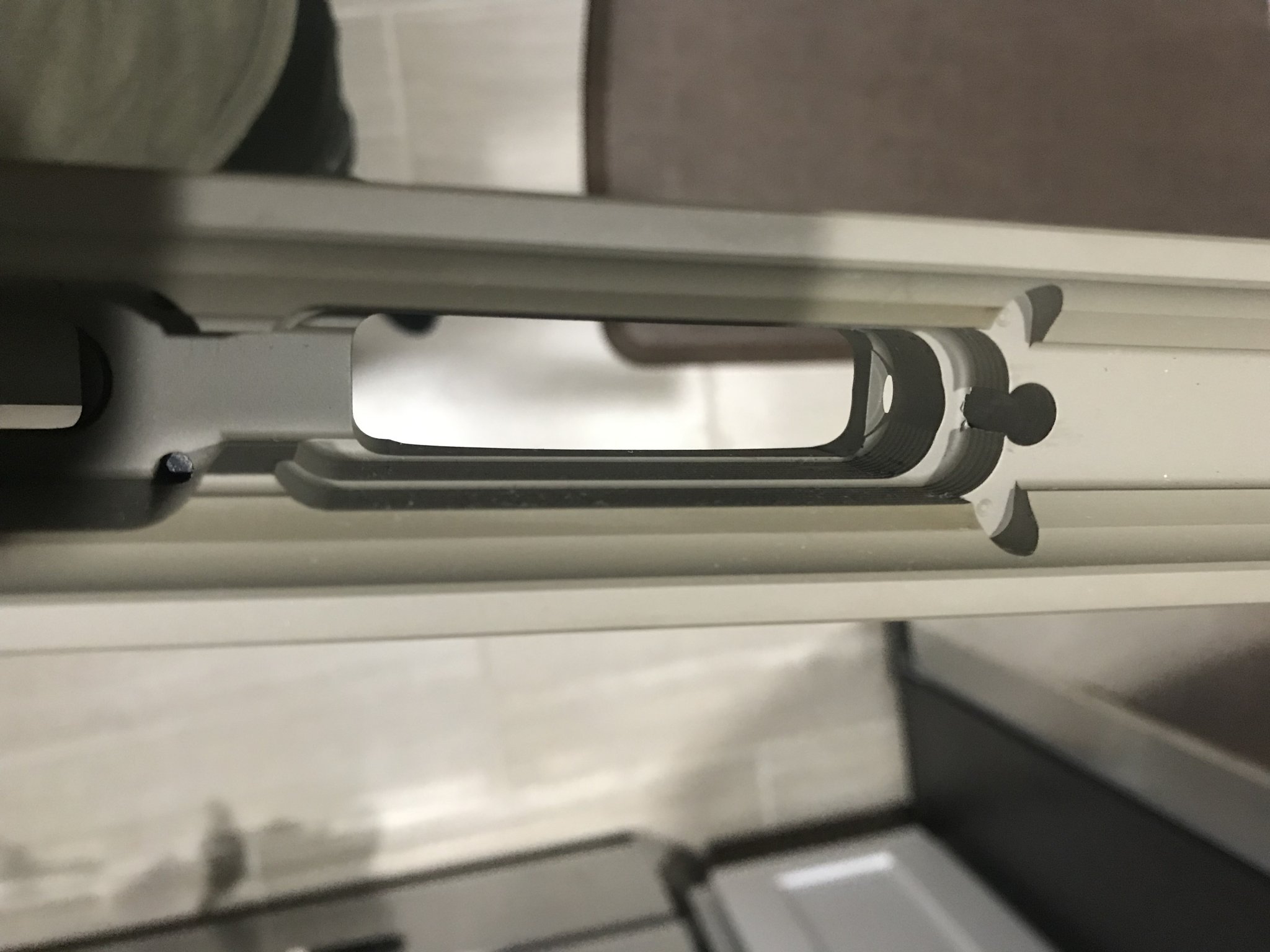

After inspecting the chassis more closely, it does appear that perhaps the tang is touching just lightly on the rear of the inlet. It's very obvious however that up front towards the end of the action there is some serious contact. It's rubbed the finish off the inside of the chassis on both side of the action.
There are some areas that need be touching and others that do not need to be. Chassis are set up in a V block configuration, so you take a round action and put it in a V there will be two lines of contact along the bore axis on each side, they should be equal in length, thickness, and location in the V on their respective side. So if this is what you are seeing then no worries, but if you see major irregularity from side to side then that may be an indicator there is a problem.
I was hesitant to post about the tang as when I bed a 455 I set up the rear of the tang as the recoil lug, so it does contact in that same area. However your chassis looked like there was a little more than simply some contact, it almost looked like a "ding" or "damage" at the top of the inlet for the tang. It is hard to convey what I am seeing via written word, and even harder to make an accurate assessment from a picture.
Where are you located? Maybe you have someone local that can check it out.
I would remove the magazine well and check to see if there is any interference there first. Probably not, but you're just ruling out things now. I would also remove the barrel (if it's not a DJ glue-in) and see how the bare action fits. It should drop in with no resistance. As for the clearance, you are looking at a few thousandths of material, probably not much more than the thickness of the Cerakote finish. You could try to clean that up yourself with emory paper or something. The skim bedding is easy enough to do yourself if you watch some instructional videos, protect the finish of the chassis, use very little epoxy and plenty of release agent. If there are clearance issues, it is probably due to the machining of the CZ, not the chassis.
