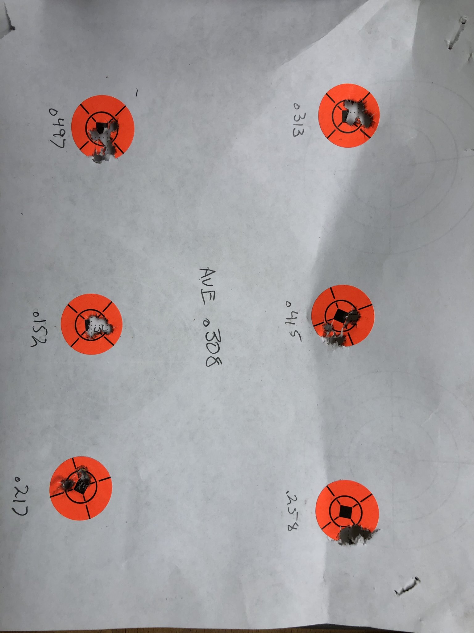

How does your current barrel shoot? I ask because I have a CZ 457 that I had planned to rebarrel when I bought it. After taking it out and shooting it with an ammo it liked I don’t think I can expect much better accuracy out of a rimfire. The rifle seems to average right around .3 with anything made by Lapua when I shoot a 5x6 at 50 yards. I may be able to improve that a little but not enough to justify the cost of a new barrel. Honestly if I took my time shooting I think the rifle could shoot even better. This was with SK Standard plus and I actually rushed this. I’m positive the two groups with flyers was me and not the rifle. One was cold bore however. It seems to group the best at 100 with SK Pistol match. At 100 it averaged around .7.
My CZ's won't do that consistently at 50 yds. I haven't tried shooting groups recently so can't post any pics or measurements, but they 're definitely not that good. And I use Lapua Center-X. None of my guns liked Pistol Match when I tried it, though a couple of shooting buddies have done very well with it, and I can't use SK due to a high frequency of flyers. If my 455 would shoot as good as your groups show, consistently, I sure wouldn't be considering another barrel. The operating word is "consistently".
