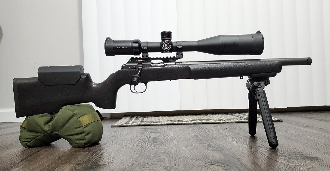

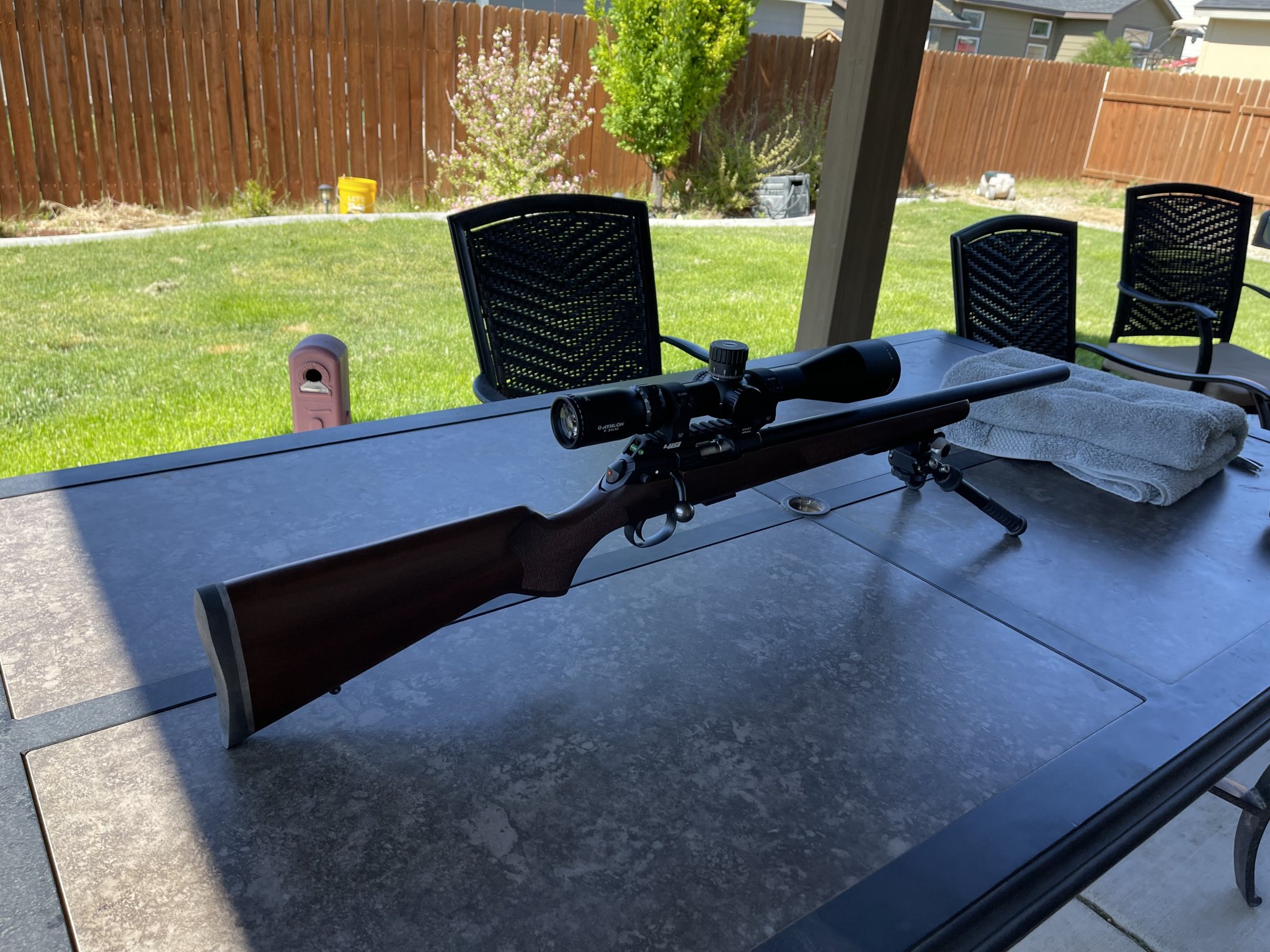

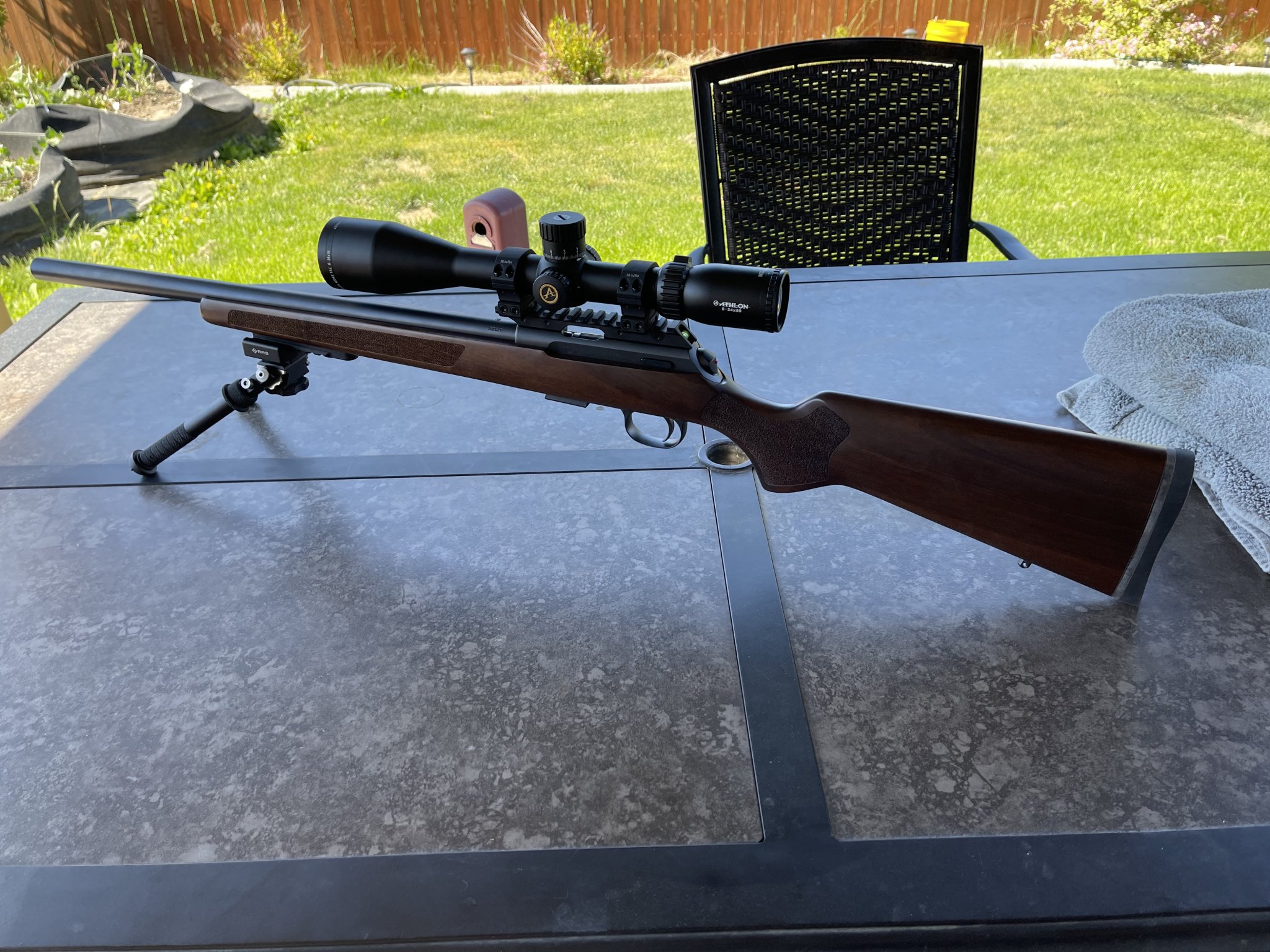

I recently bought a 457 VPT with 16.5 inch barrel as a host for my incarcerated DA Mask.
My property only allows about 150 yards max so I installed the 0 MOA DIP scope rail and then an Athlon Argos BTR 6-24x50.
Just got the scope mounted this morning and haven't shot. But mounting the rifle, I have no issues with cheek weld. I thought maybe I'd need a riser but that's not the case.

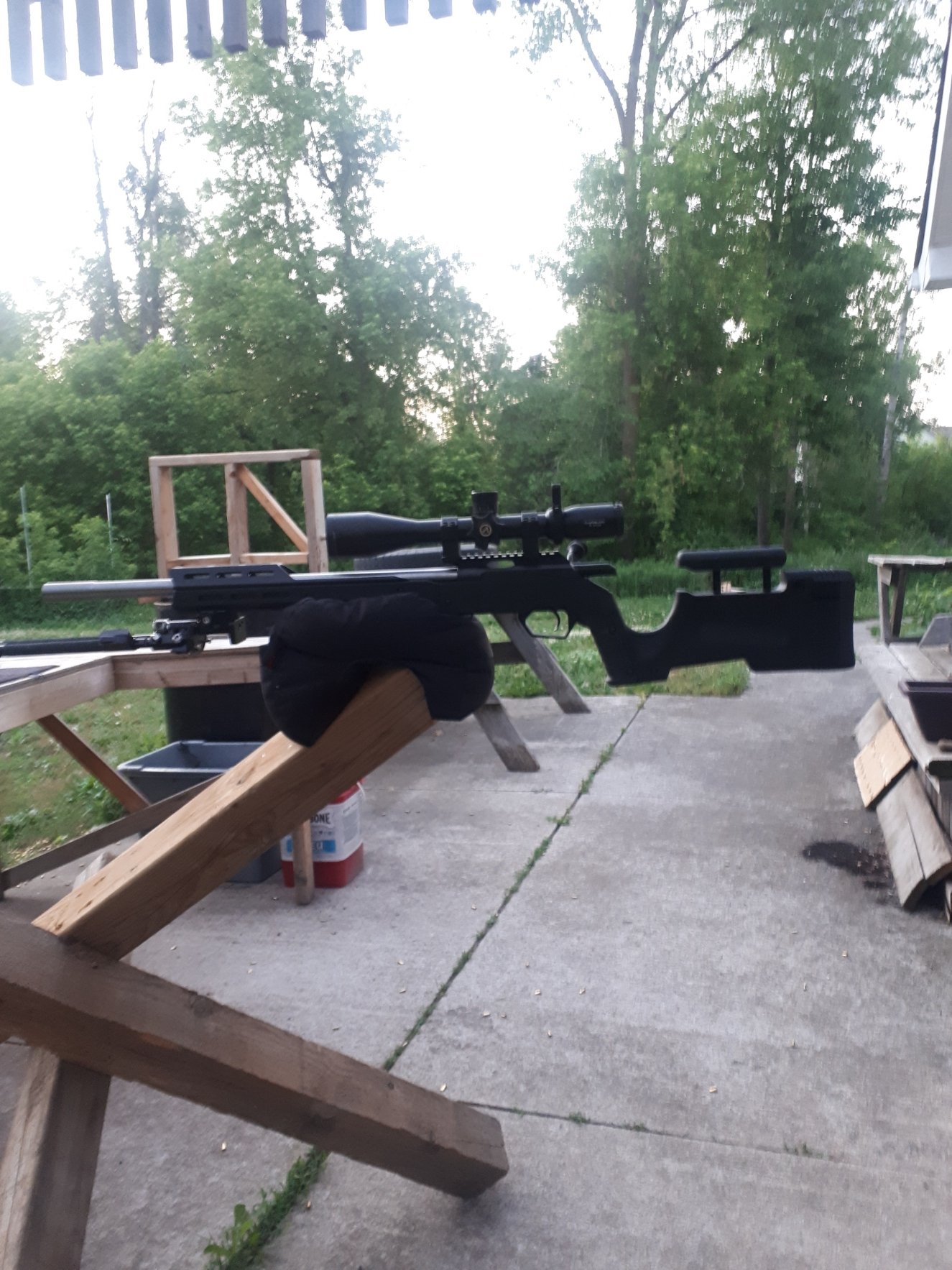

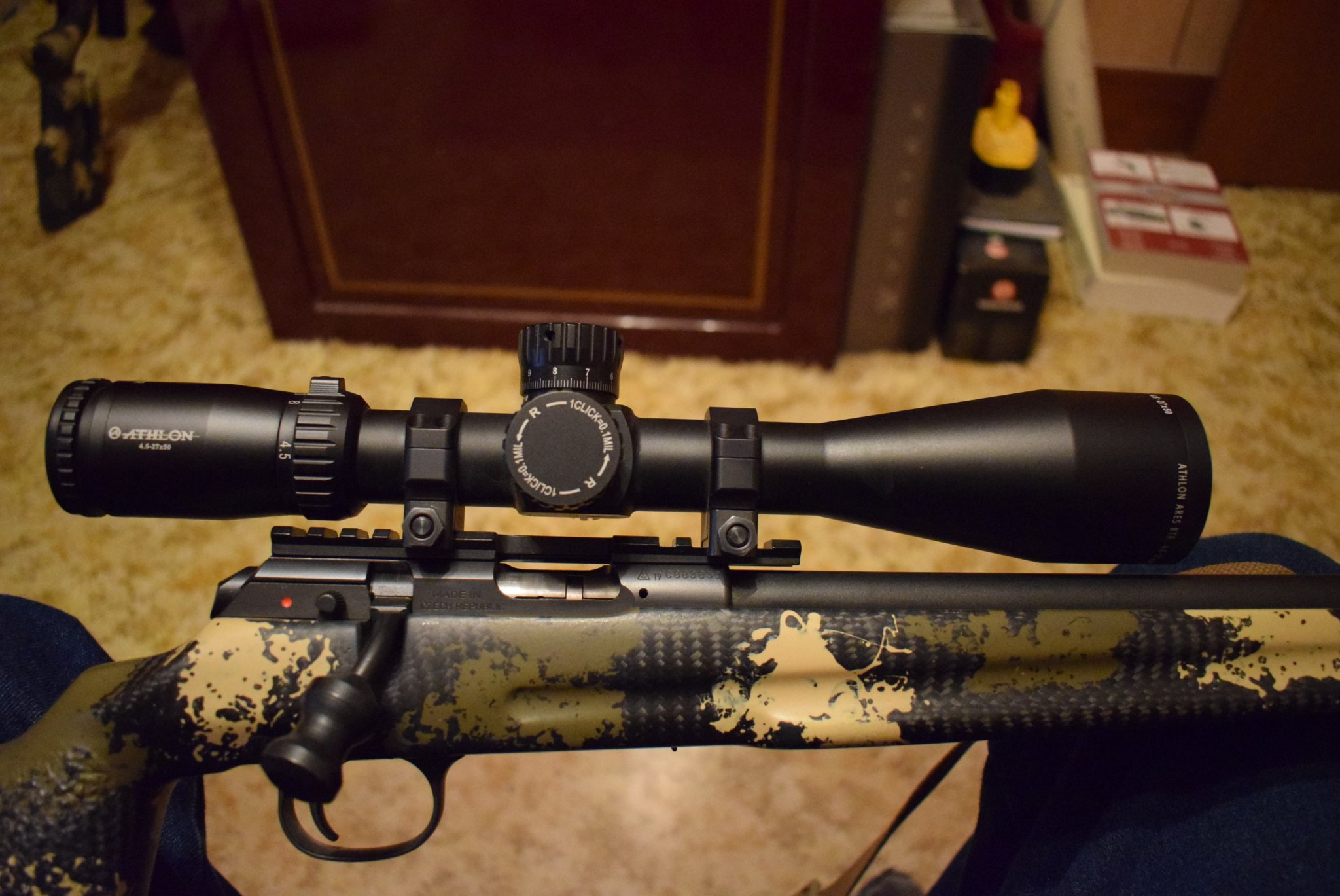

I used a TBScar original 25 MOA scope rail on my VPT, with an Athlon Ares 6-24x50 in TPS TSR low rings. As you can see in the photo, there's about 3/16" clearance between the objective bell and the Shilen .854" straight cylinder bbl I put on it, which is slightly larger than the OEM 24" bbl it replaced. I'm pretty comfortable with the height of the scope with this set-up, though a thin stick-on pad wouldn't hurt anything...

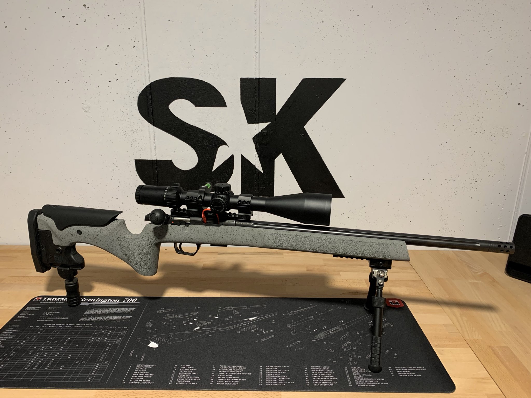

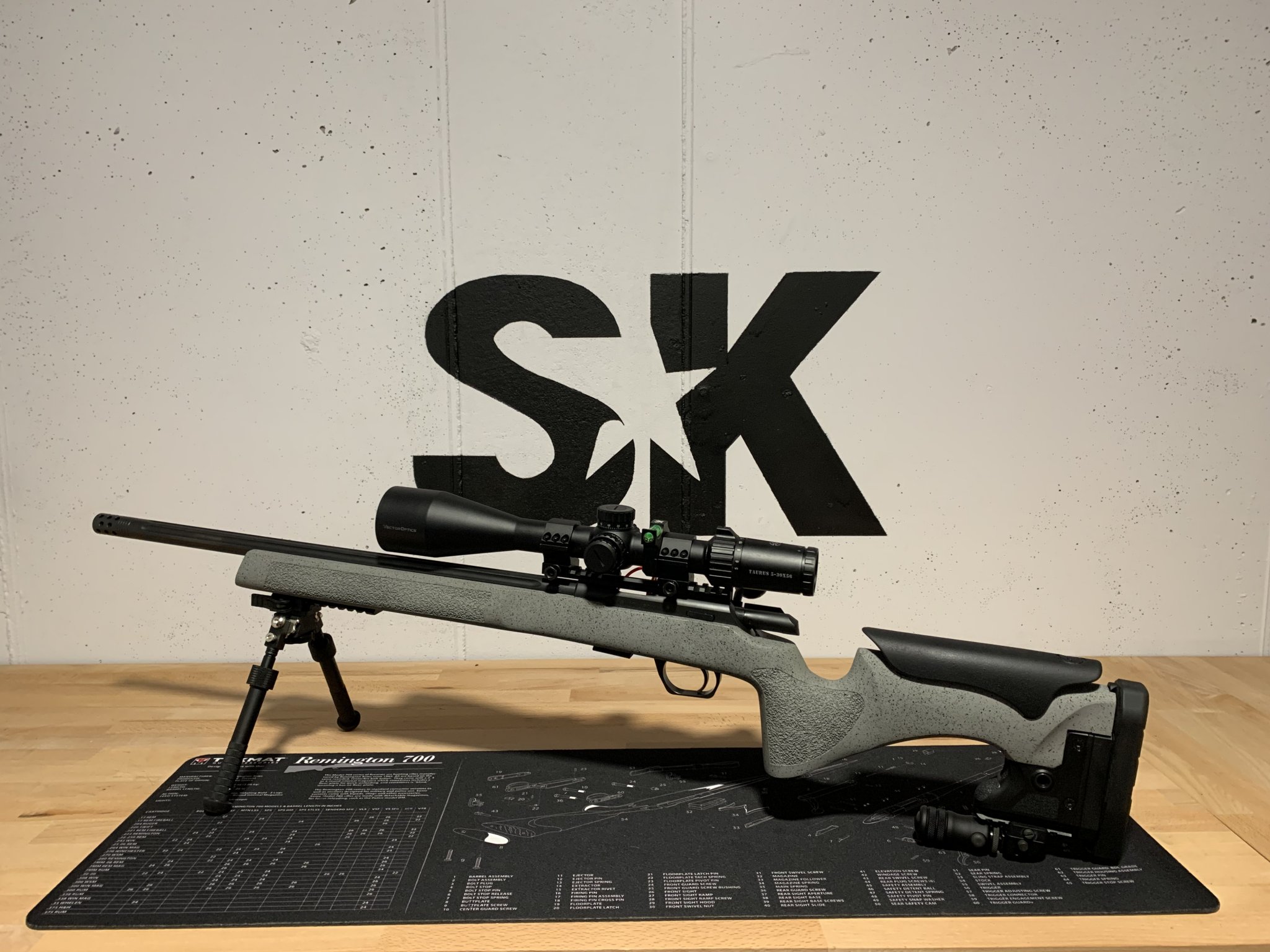

Sweet! Are you sponsored by SK ammo? Photo from the SK team room?
Wish I was! No, its my gun room. I painted it on the wall, same with the CZ logo on another wall and Jack Daniels on the safe. in time I’m gonna place some cabinets abive the sk logo with some lights under it.

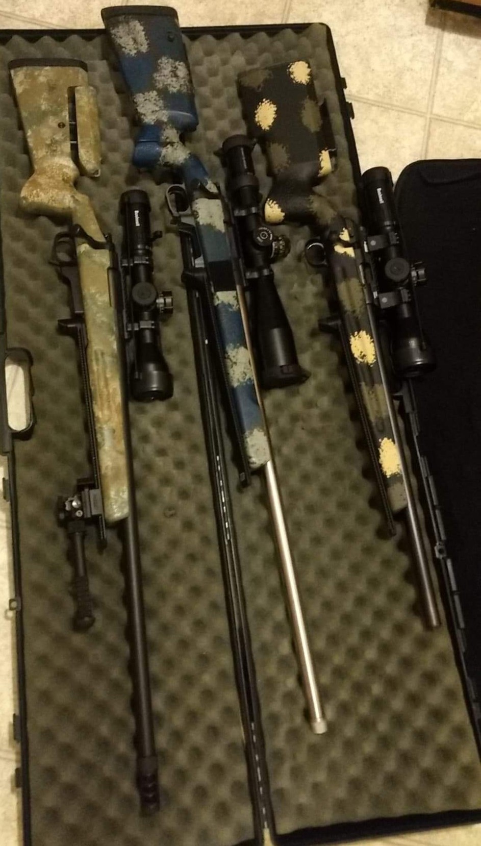

Here is mine get up like my Defiance and Surgeon

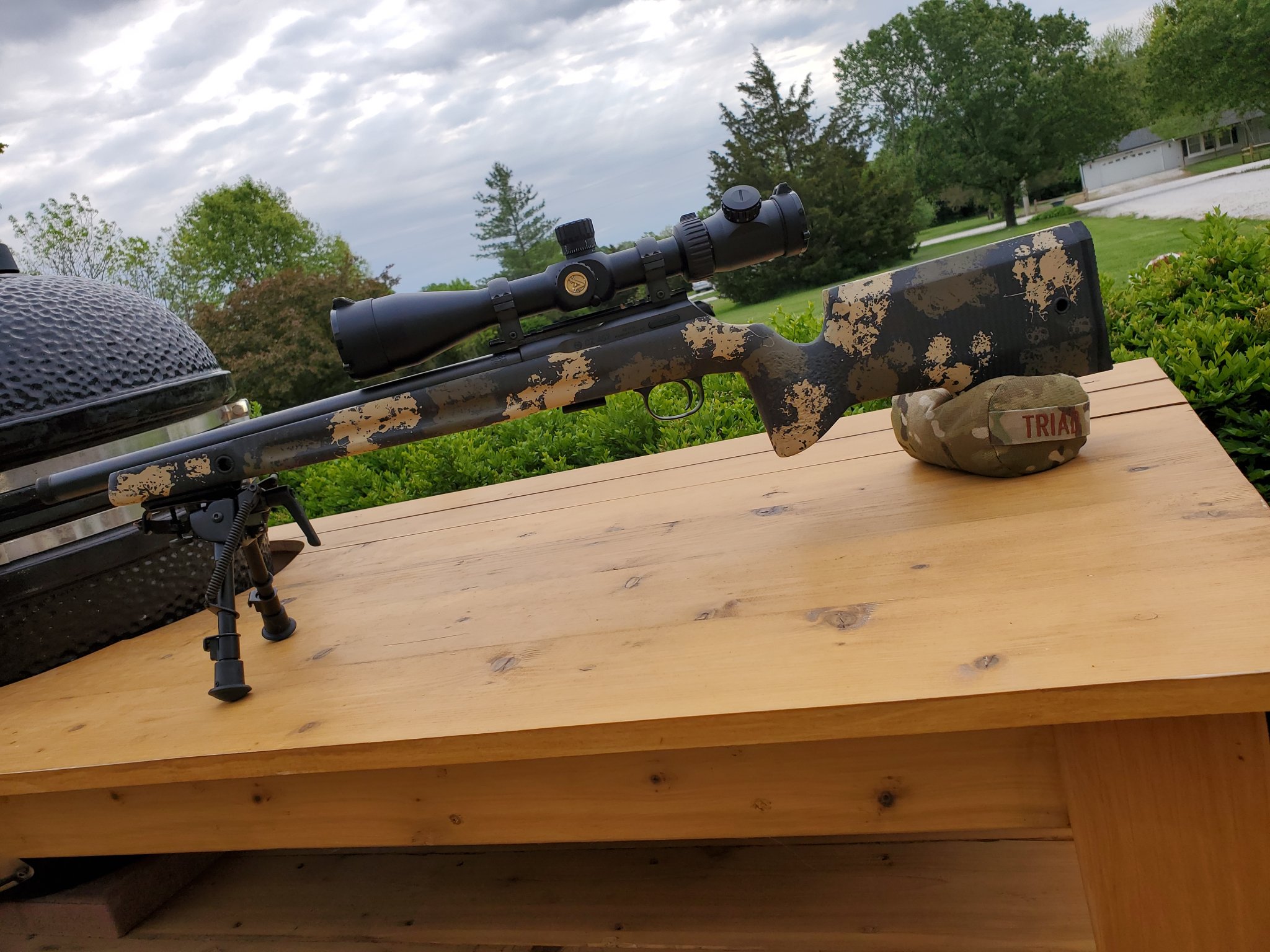

I got the rifle and am all setup for now.
Ended up using the Midas Tac and MDT High rings that I pulled off my Bergara. I have just enough clearance for the sunshade over the enclosed forend when I need it.
Anyway, here she is.
-MDT XRS w/ ARCA Forend
-Athlon Midas Tac 6-24x50
-IBI 22"
-Anarchy Outdoors Bolt Knob, Mag Release and +3rnd Mag
