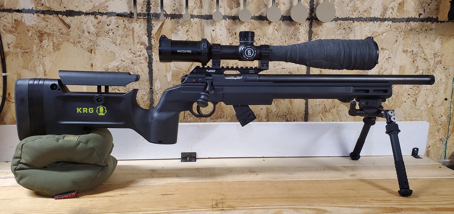

You might be able to build up the area by wrapping self adhesive medical tape (Coban / Vet tape). It can be found in a multitude of colors. Its inexpensive so you can experiment. It's easily removed without leaving any residue.
Ordered a roll of the 3M vetrap in black. I wanted to put some of that around the front area of my scope anyways, so 2 birds with 1 stone.

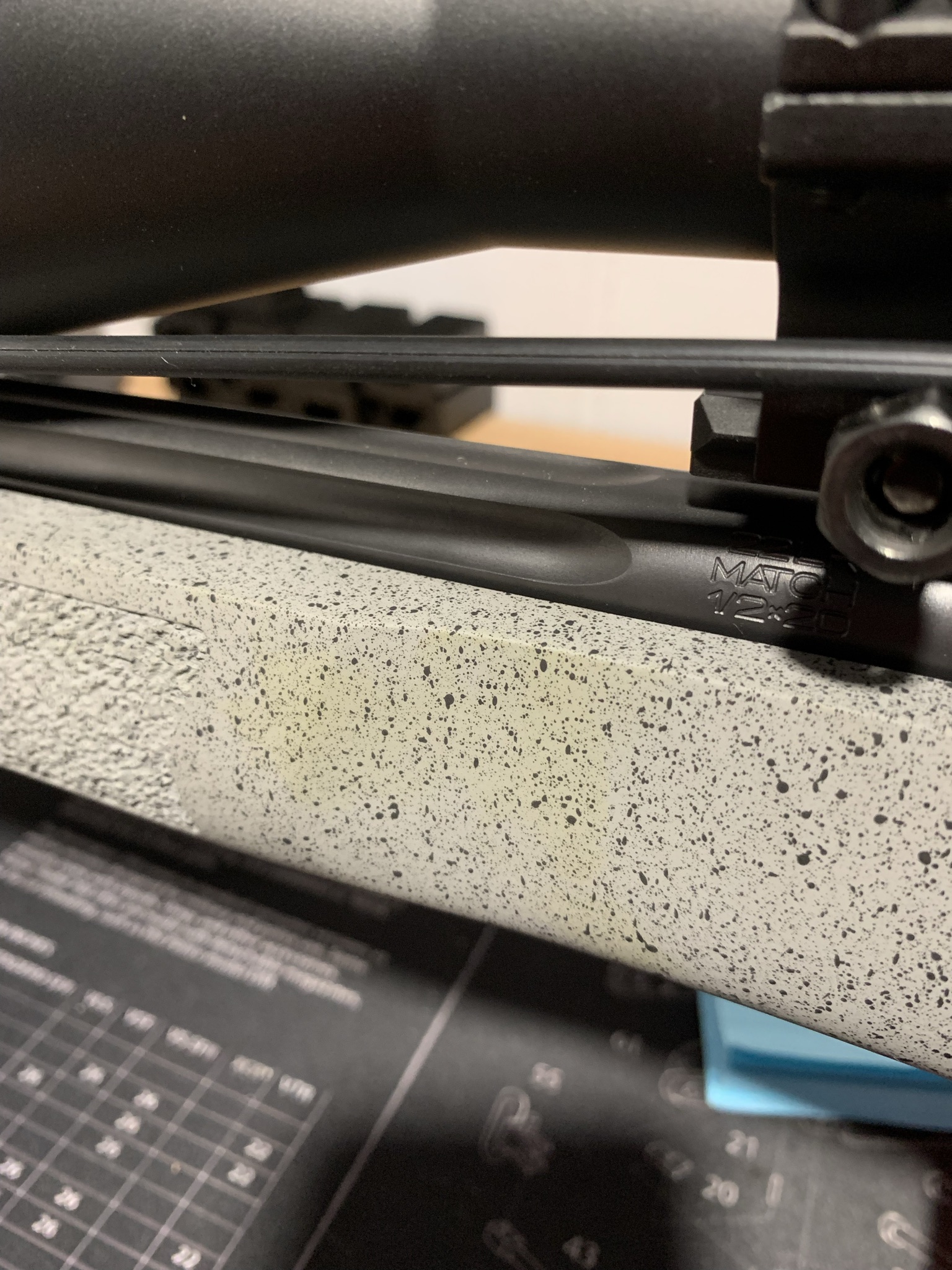

Do you have yellowish spots on your stock? I hope yours is fine.
I just went back with mine it has some yellow comming thru the gray coat.
I think it’s because of the berk stock being not dry (yet), and when you touch it your grip pushes out the moisture. Im looking into getting an MDT acc chassis for mine.

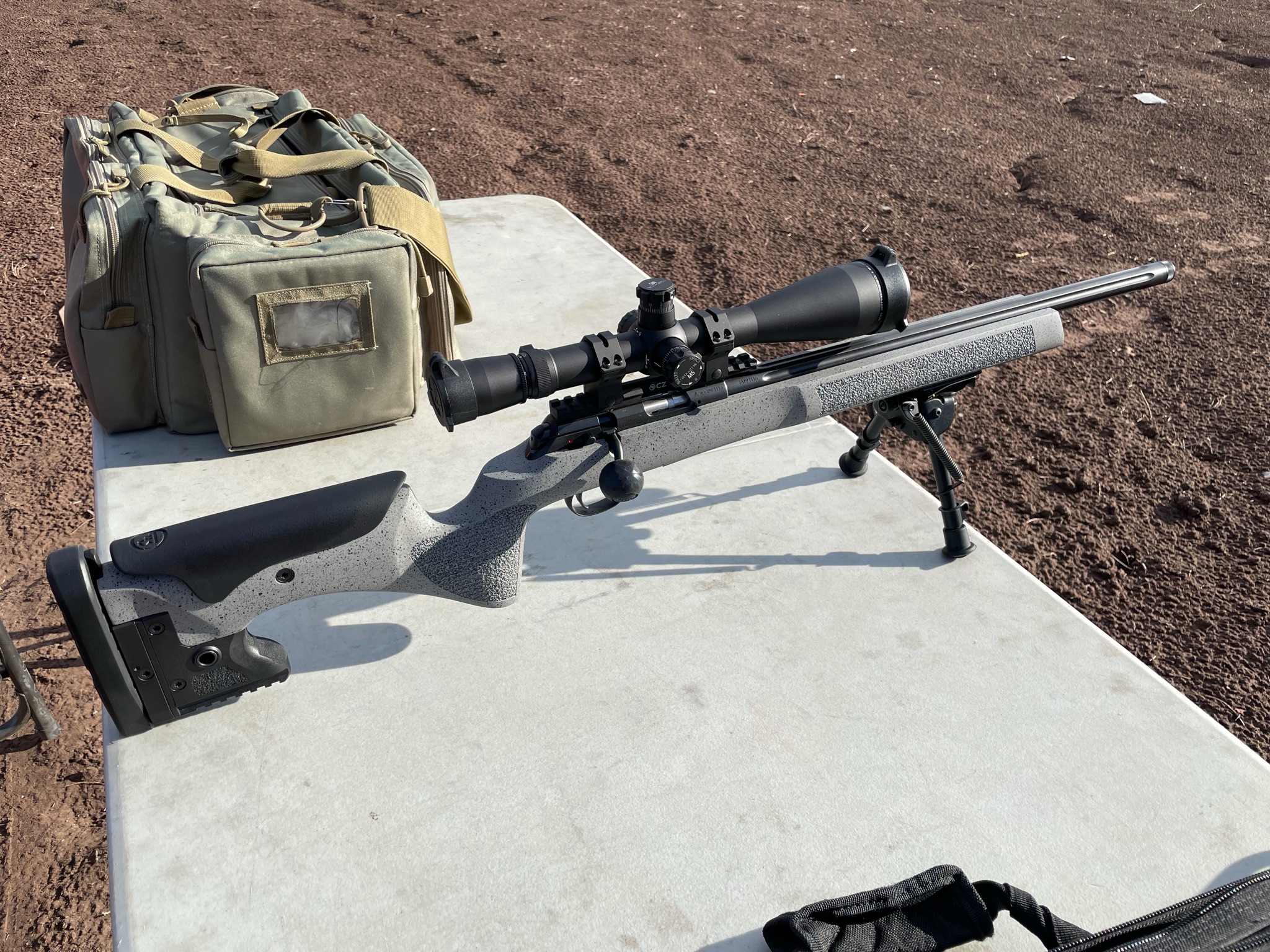

I have the ProVarmint stock and I've never liked it b/c of the difficulties with cheek weld. Looked at a KRG, but not enough cheek riser height. I bought one of the kydex adjustable cheek risers which arrives this week and I *think* this should do it b/c I can choose exactly where I want to drill the screws with respect to top of comb plus it's up to 1.5" of rise so way more than I need, but enough to get what I want. Only thing I'd like different after that would be a truly vertical palm swell like the MTR stock, but I can live w/o it until I chance onto a smoking deal....it's a want not a need at that point. I'll update once the adjustable riser is in place:
I don't "yet". I say "yet" because I've heard that oils, greases and other chemicals on your hands stain the rubberized coating. This can even be from the lubricant on the bullets.
Guys I'm really wanting to put my 457 in an MTR stock. Looks like there isn't quite the radical drop in comb like my ProVarmint....if you would care to comment on your fit with it I'd be grateful please b/f I begin my search. Buddy has an old Anschutz with a similar style stock and the palm swell/vertical grip and cutout are so comfy. I'd be pumped to find one, but not being able to put hands on an exact MTR to try I'd be grateful for your opinion. Thanks
Reactions: fullsemiauto556
I find the MTR stock to be very comfortable for me. I like the palm swell on the grip and how the grip is vertical to the trigger. It's all very comfortable and just has a solid feel. The problem I had was when I added the Picatinny rail so as to mount my scope; I didn't have a good cheek weld to the stock, as the eyepiece of the scope was now too high. I solved this by taking the rail off and replacing it with 11 mm rings which mount directly to the receiver rail. That dropped my scope just the right amount. Now my eyes are in perfect alignment with the scope and I have a good cheek weld. For the type of shooting I do with the rifle (ARA factory bench rest), I don't need any cant in the scope mountings.

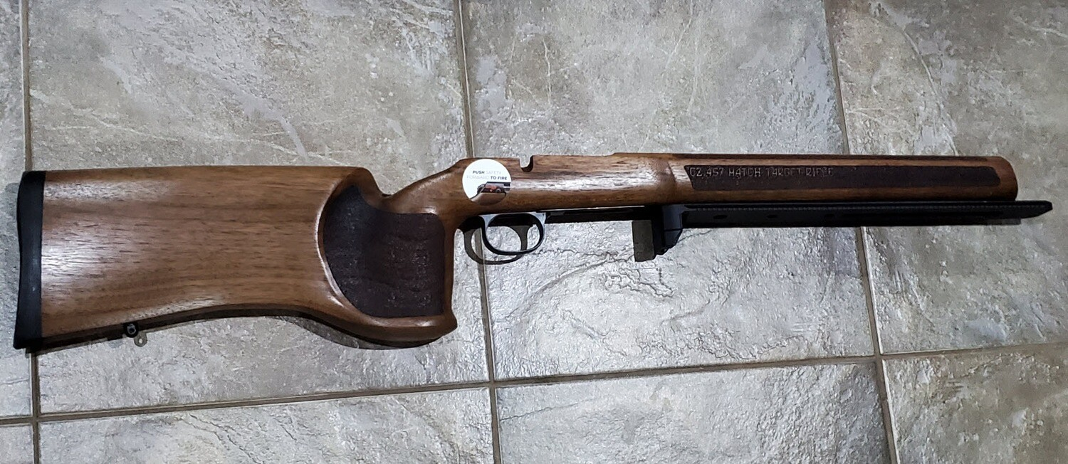

CZ has the MTR stock available to buy for $289.
https://shop.cz-usa.com/5083294021.html
Reactions: lash
Except, maybe you like the MPT and the wood, so…
Nothing wrong with it but for $289 you could get a lot more for the money. You will probably have to spend more to get pillars and bedding just to get to the same level a chassis is already at.

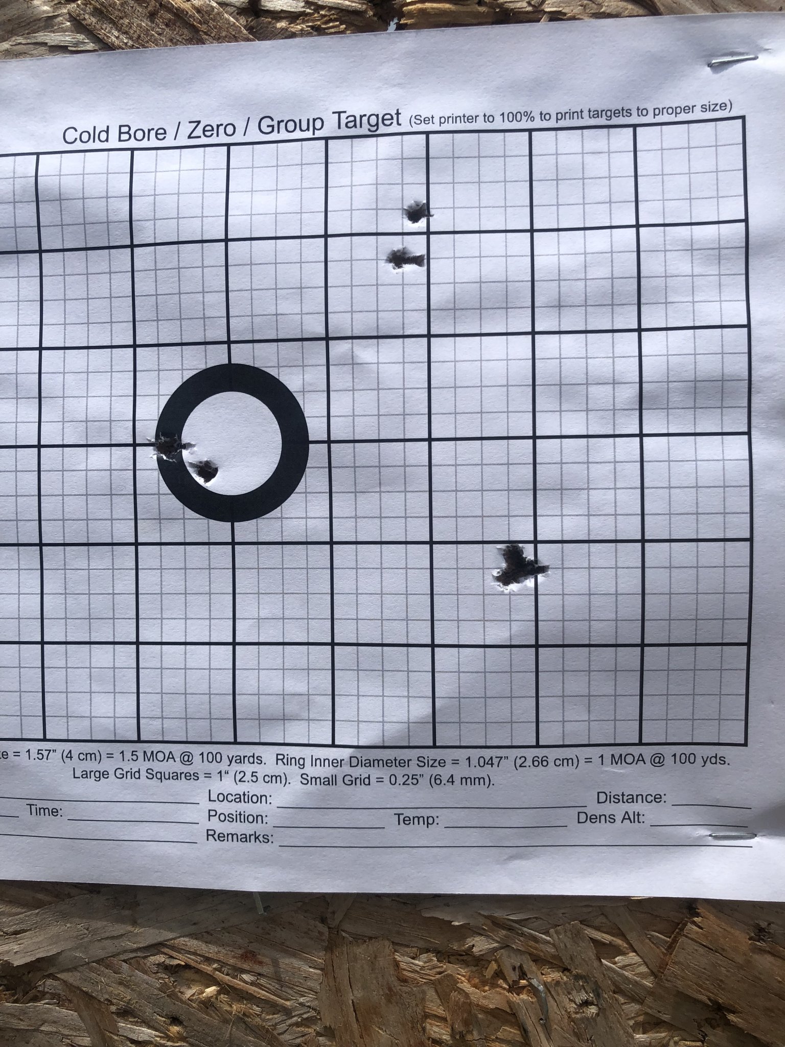

Here’s a picture from Tuesday when I was zeroing a new scope at 50 yards. The first two shots are in the upper part of target, then I adjusted once and put the next three in the eight o’clock spot in the bull. Next I adjusted once more and put five rounds in that ragged cloverleaf in the lower right corner of the target. It shoots the same level of accuracy at 100-200-300 yards too. Oh yeah, I zeroed the scope and shot that while standing at a bench behind the rifle with bipod and bag, not bench rest. I think that will work fine.
