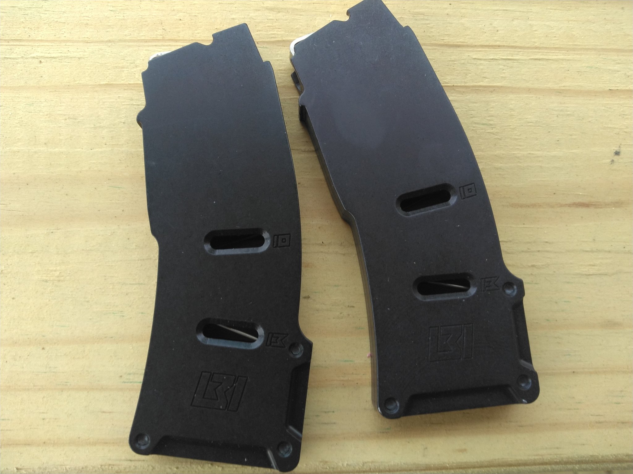

CZ 457
What do you mean by that? I realize that the 10 rounders are not supplied with a rifle as purchased, but they are most certainly stock CZ mags.
That the pics I posted aren’t the stock stamped metal ones. They are machined and have been running better than the standard 10rd plastic ones.
Ah, okay. I missed the reference and thought you were talking about the plastic ten round mags. As I may have mentioned before, I bought a metal 10-rounds mag from cz-parts in Czech Republic and it did not fit correctly into the mag well of my stock 457 and then I was unable to get it out without taking the action out of the stock and removing the mag well.
Never even tried to shoot and see how it fed. It sits in my drawer of junk now.
That’s why I’m so interested in your metal mags.
I can only speak to the 10 and 13rd versions.....the 15 rds are on the way. I have tested a pair of 13rd ones in many matches without any issues and that was before the specific longer springs were used. These are dialed in.

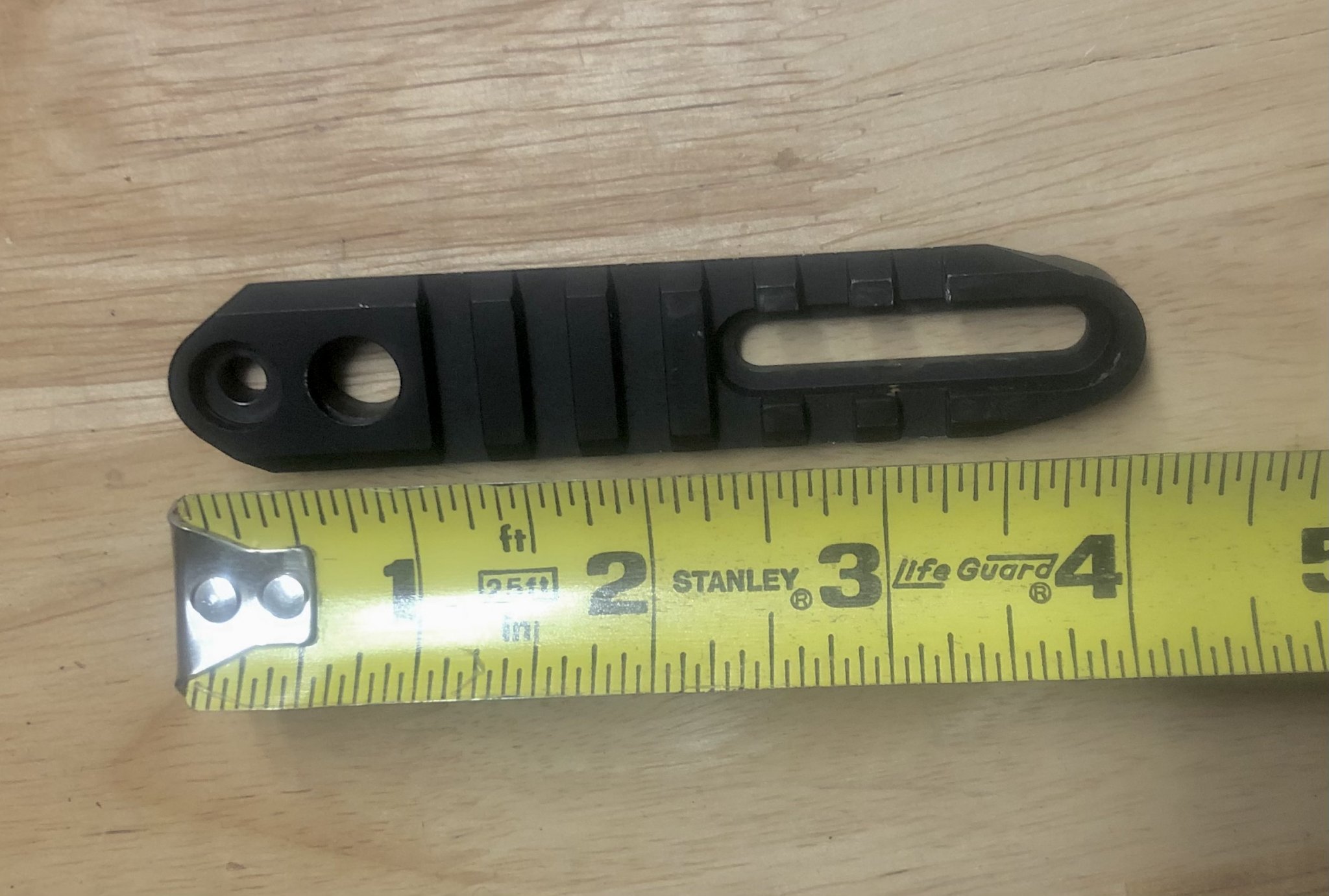

Just got a CZ457 MTR and does anyone know what the spacing between the 2 front studs is?? I want to use a pic rail.
Thanks for any help.
I did that on mine, but be forewarned that the studs on the MTR stock are just short wood screws. The are not the typical machine screws and will likely pull out under any heavy use.
In my case, I purchased a couple T-nuts and used a Forster bit to drill the recess on the inlet side with machine cap screws to attach the rail.

I agree with Lash - T-nuts and a Forstner bit to get a firm mount of the rail, instead of the sling stud. I've got the A-419 'Bubble-rail' and the forearm under-rail. And an Atlas-clone bipod on Amazon is about $25.
