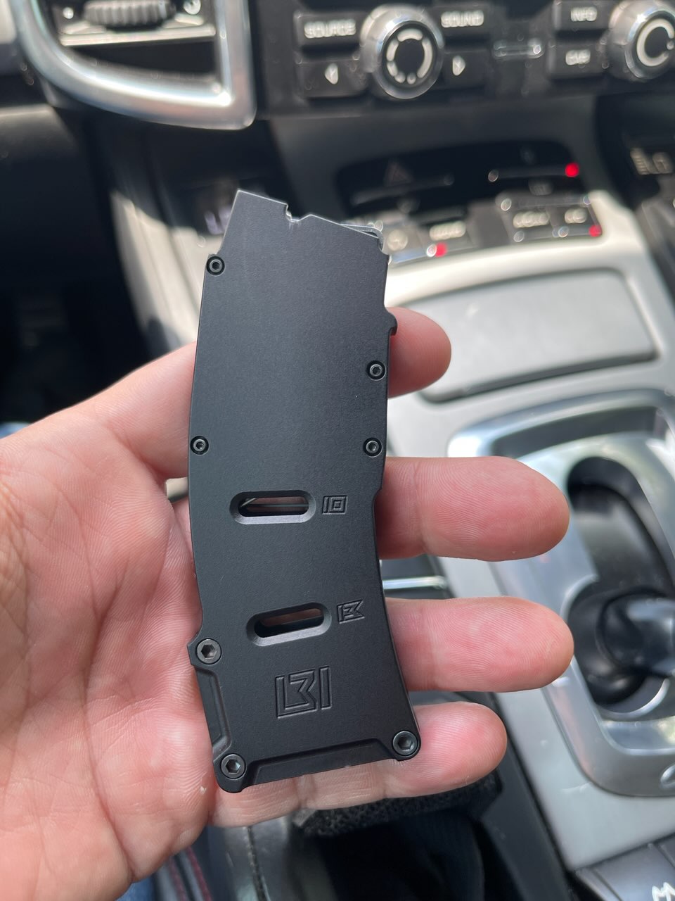

Billet mags are still making progress. We found an awesome shop to help manufacture and get these to market as fast as we can. Fixtures are being made right not for the machining and springs are in process as well. It's hard to say how fast we can move but we are pushing hard to get the first shipment out still this summer. We put them on the site so people could sign up to be notified the second they show up in stock.
When we launch a new product we typically run a sale on products that can go along with it so when these go live be sure to look at the CZ bolt knob, extensions and mag block prices.
awesome looking forward to them. my state limits to 10 rounds if those will be available at launch time.
Progress! 13rds will be launching first and we're looking to hard anodize samples next week.
Plus the 10rd design is done 👍.15rd design will be next.

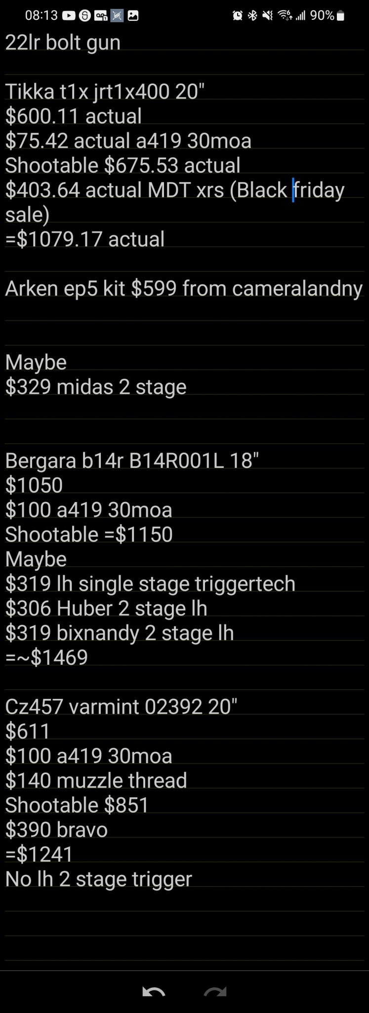

I was considering between the Tikka t1x, Cz457, and Bergara b14r. Did this to help decide. Yes I was looking left handed so models and options are oriented that way with the general slight price increase that entails. Going off msrp except for my actuals on the T1x I got.
Shootable for me was gun + rail + threads since I have a Thunderbeast 22 take down.
Y’all been giving those mags hell I bet at matches and the range. Tossing them on the ground loading them in the rifle pressing against bags and barricades too
The 2 test ones I have function well and have been shot and tested by quite a few people at local matches......they are using my 10rd stock mag springs, and the springs for the 13 rd are in process. These are very very close......beauty shots will be posted later with the hard anodized on.

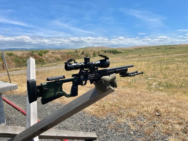

Was playing around with the krg bravo and figured I would try to switch to the xray rear. Took a little bit of trimming on the grip, very minimal, but it bolted right up.
Nice - how does it handle? I was hoping they came out with a Whiskey 3 rear end for it. Does it affect/alter the weight/balance? Was looking at going Bravo, as this is an all in one rifle for fun/hunt and occasional competition. Not looking for super heavy, but must be balanced.

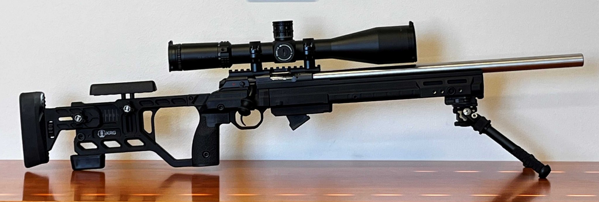

I'm torqued to 35 in a krg bravo.

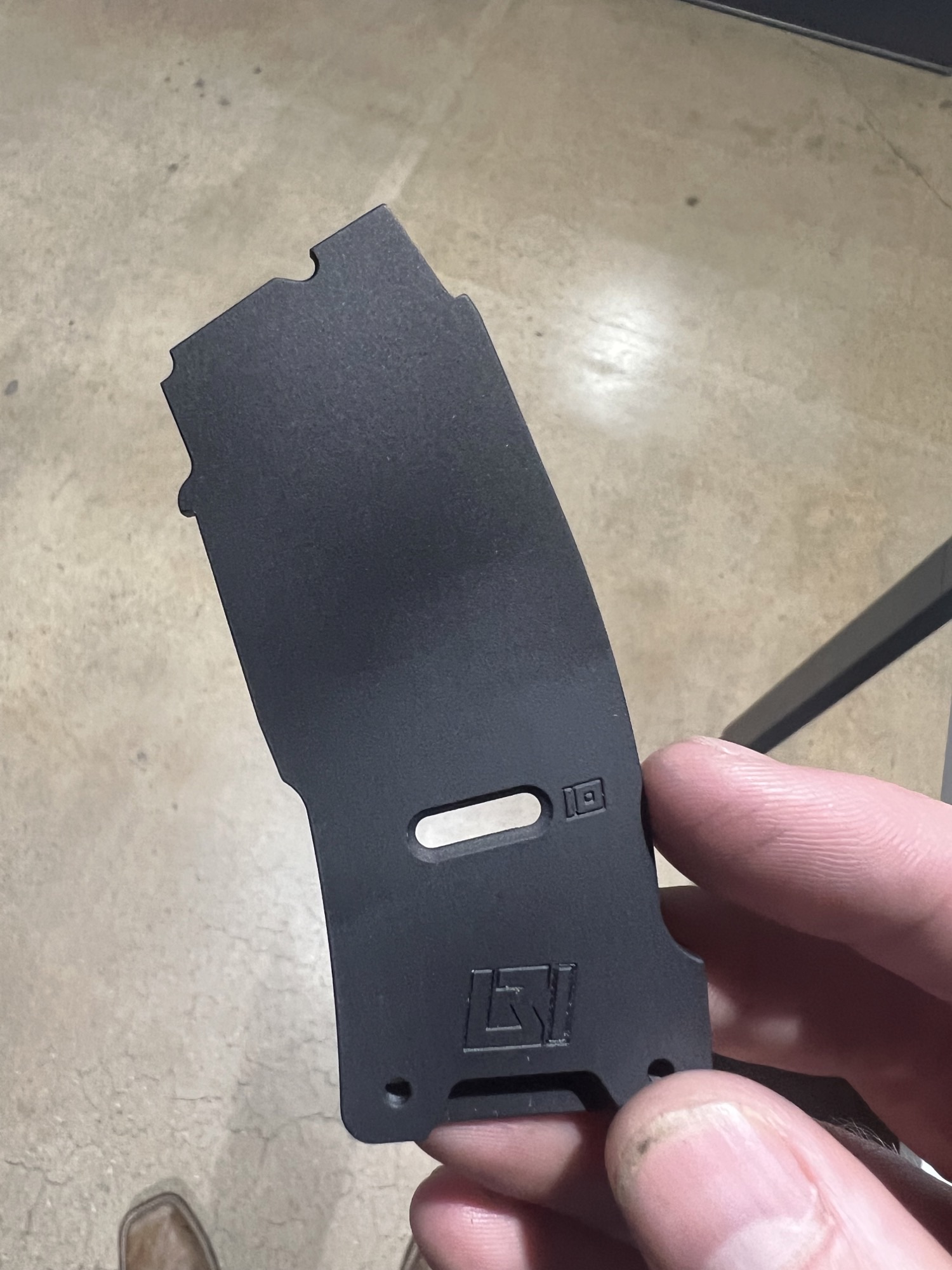

Mags are still moving forward. Springs are in and good to go. First mags run will be a limited clear anodizing since we've had a ton of interest in the raw aluminum. The clear will protect better than just leaving it raw machined although really it's a metal mag so it's not like you can hurt it. The clear will be limited qty's and then black will be the standard so if you want to wait on the black rest assure that it's coming. If things stay on schedule be looking at the site for the 13rd within a couple of weeks. Coming it hot right after that is the 10rd for guys in "those" states, and then a 15rd bench version for guys who want all the rounds and don't mind it curving forward, should be nice for bench/prone days.
The 10rd is looking cool as well!
I am pretty sure that the xray back end is lighter than the bravo but I am not positive. Its not going to balance without some weights on the front of it, Ive get two sets on it and a different forend on it so I could use the weights. Handles pretty well but it would be heavy for sure as a hunting rifle to carry.
I spoke to KRG they are working on a Whiskey 3 backend for the Bravo that will work with CZ and T1x(maybe folding?) - no ETA. So I will be waiting for it. Hopefully they do a complete chassis with folding option. I really rather not have to buy a Bravo and get the Whiskey 3 backend separate.

Did you do this yourself? How was it done? looks like you are bedding the 457 action to a regular Whiskey3, as the front end looks to be standard Whiskey 3. Not the Bravo. Any issues with the magwell etc? The thing KRG is working on is using the Bravo front end with a Whiskey 3 backend I believe.
I had a Whiskey-3 for a Remington 700 SA lying around - used the Bravo backbone and trigger guard and fitted the W-3 forend, grips & rear. No mods and trimming required and no issues with the magwell.

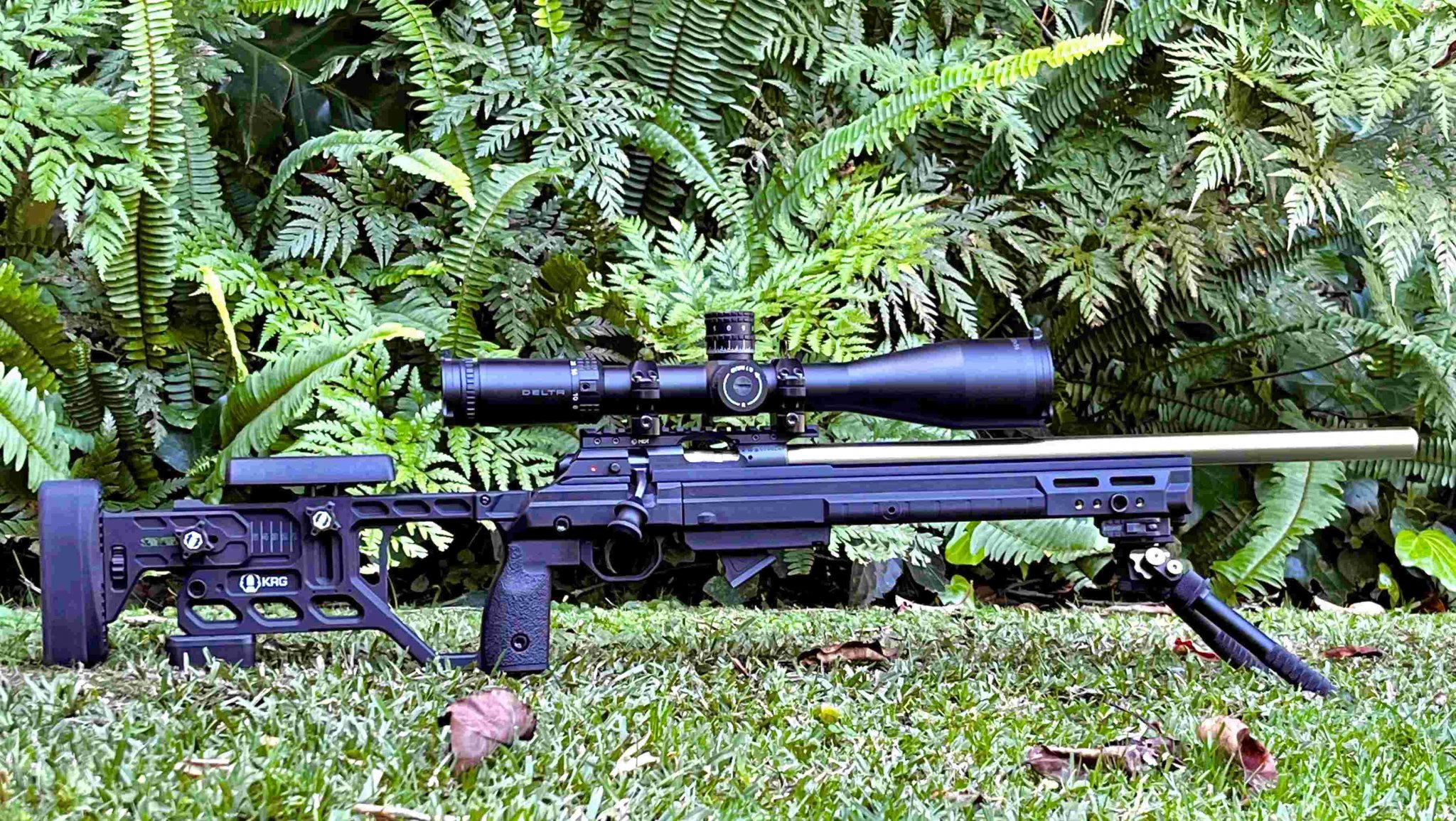

The long awaited stamp for the can came in for the 457. I’ve got a KRG Bravo on the way and I haven’t been this excited to shoot a 22 since I was like 12.
Trigger could use some work. I’ve seen timney makes a trigger but I’d rather throw that kind of money at ammo. There is the spring swap which is easier on the budget. I’m realistically looking to have the trigger a little smoother and be right around one pound. Would this be in the realm of a sling kit and polish then?
