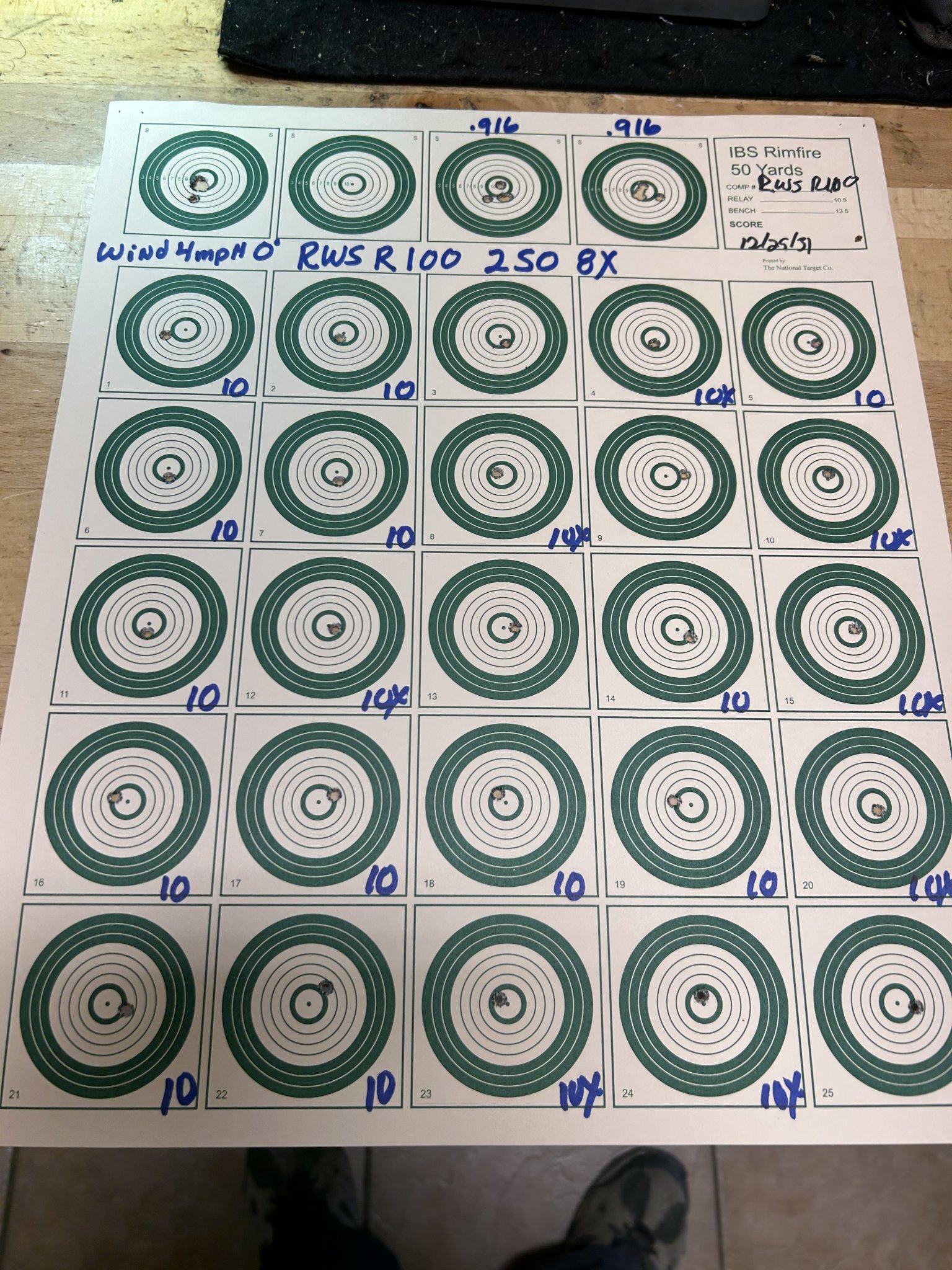

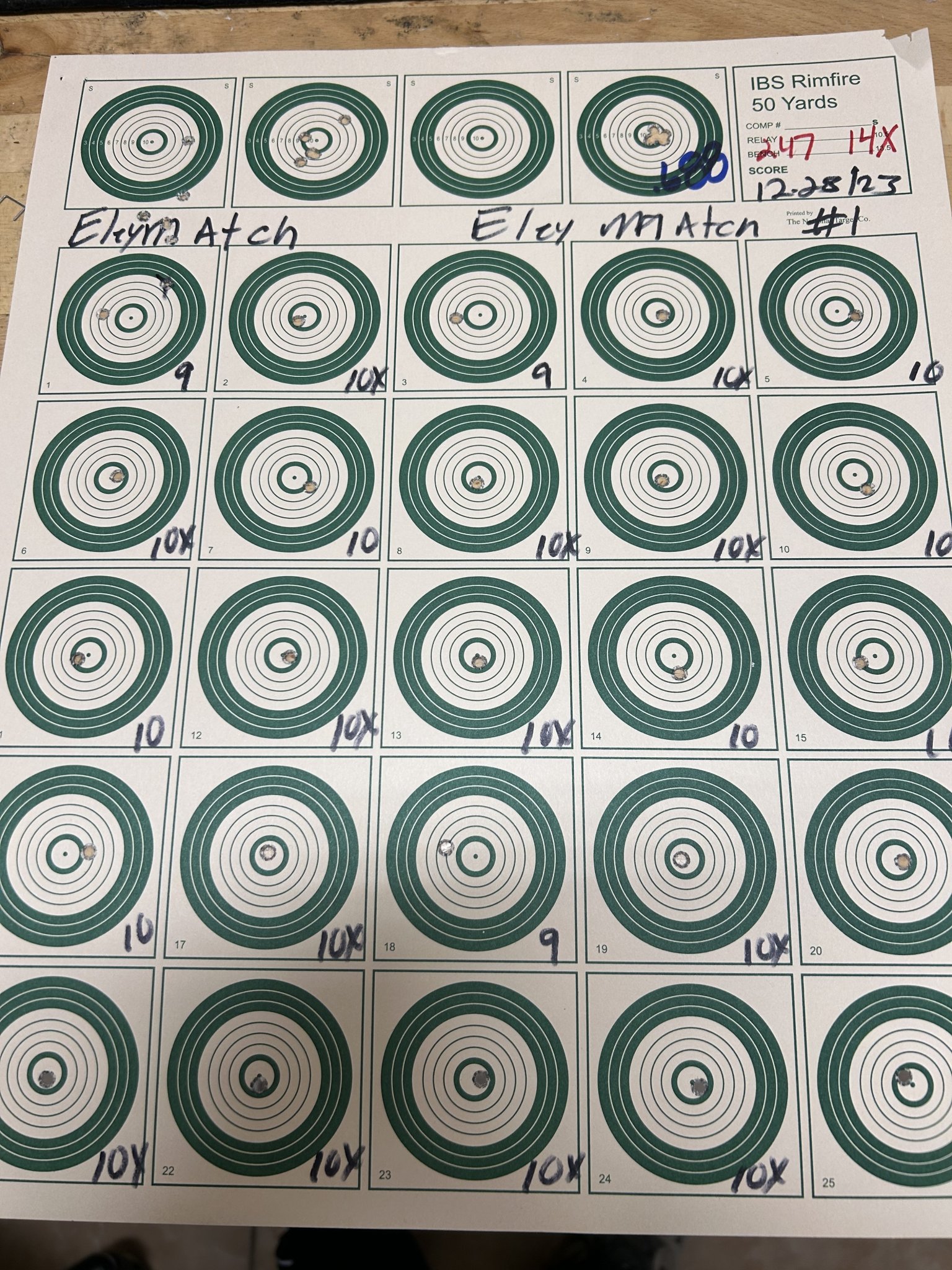

Here is a picture of the 2 best 5 shot groups I shoot. It's RWS R100 at 50 yards. Here is a target i shot with Eley Match Black box with about 2 mph wind . I can tell you the Lilja is better then stock as the groups have been tighter.

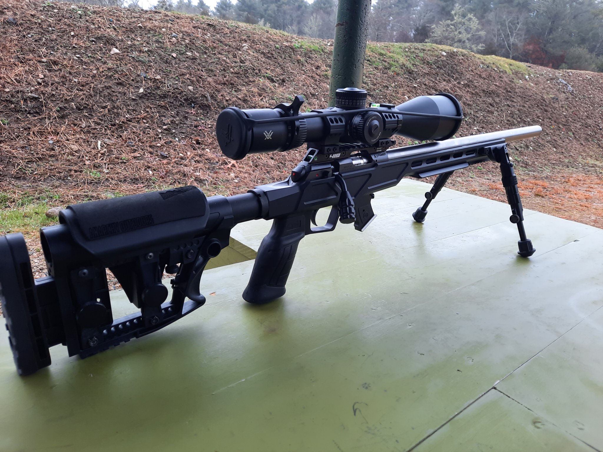

I have a 457 Varmint Precision Chassis model in that same factory chassis. The rifle is VERY adjustable and stable. I've made a few improvements to the Luth-AR buttstock but have to say I like it allot for the general /mostly off the bench shooting I do. Mine also wears a Lilja barrel. This rig will rival my Vudoo when I do my part.

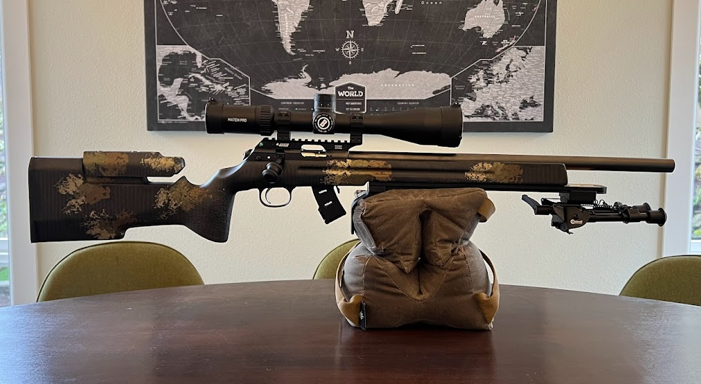

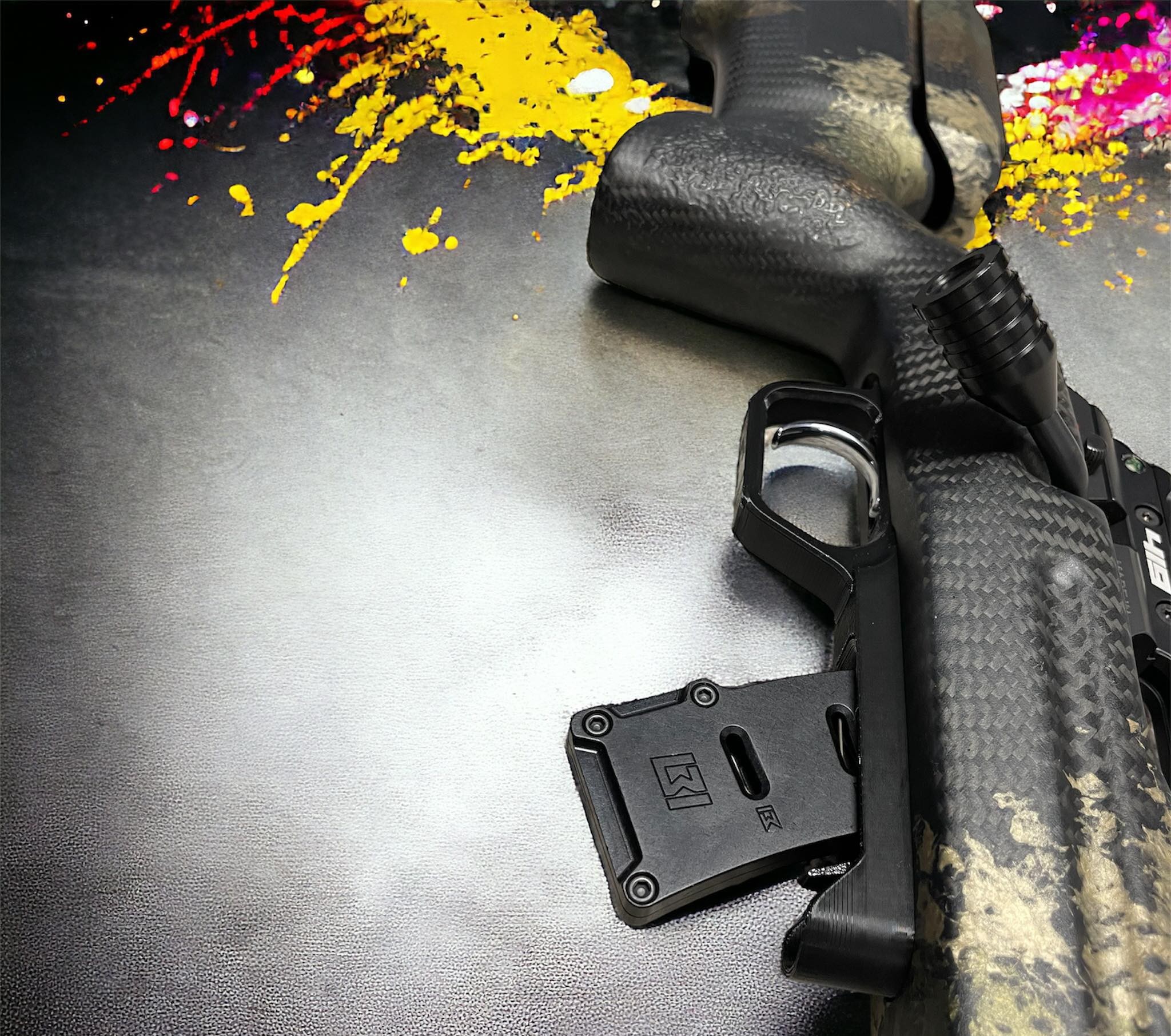

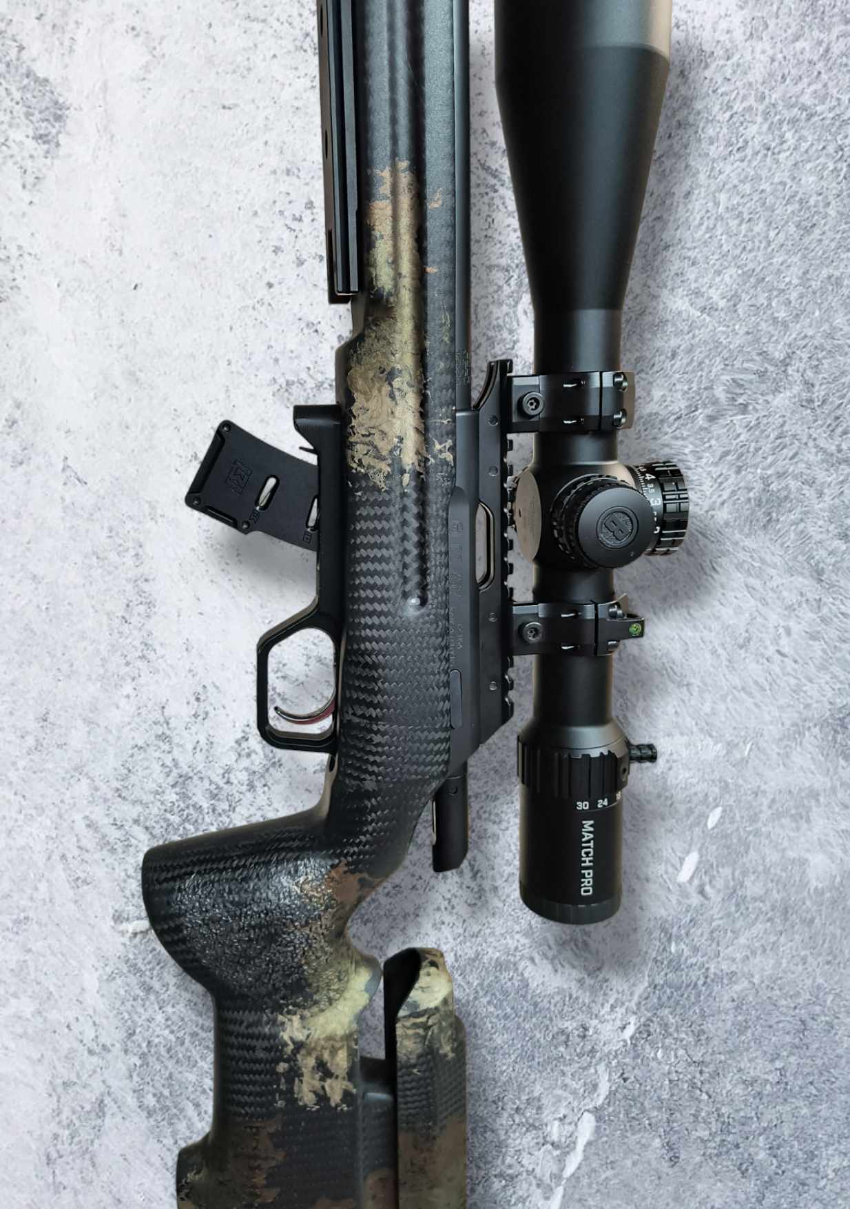

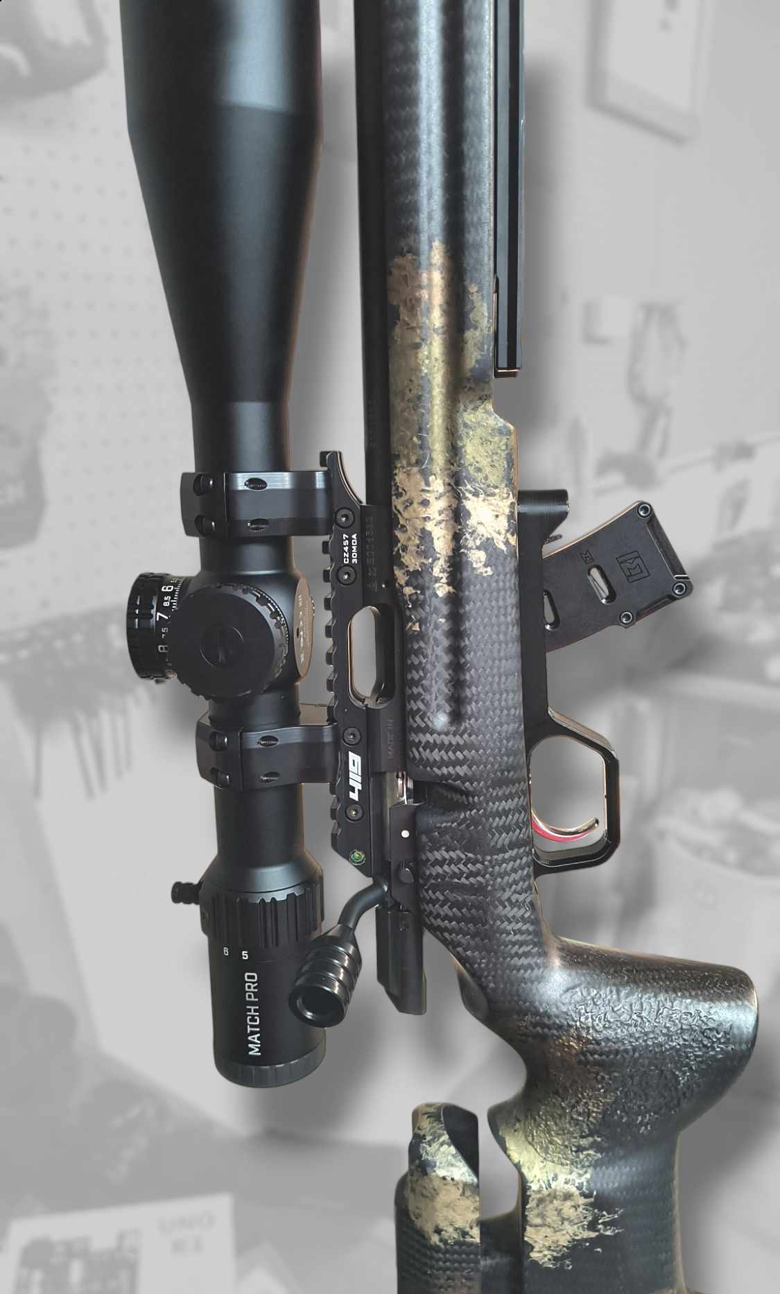

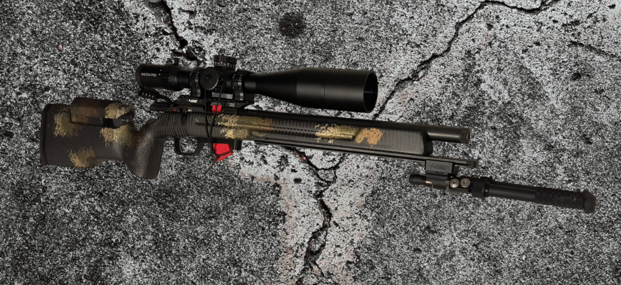

Just mounted our VMTR Barreled action in the Manners stock (from the VPT MTR) and I absolutely love it.
Parts list:
  • CZ 457 Varmint MTR Barreled Action
  • McMaster Carr 612 Trigger Spring and Polished Sear (~1.5 lb pull)
  • Area 419 30 MOA Rail
  • Bushnell Match Pro 6-24x50
  • Vortex Pro Series 30mm Medium Rings
  • Area 419 Weighted ARCA Rail
  • Caldwell Swivel Bipod with Area 419 Harris ARCA Lock Adapter
  • Gray Ops CNC Shorty Bag Stop
  • Area 419 Bolt Knob

Love this gun looks great!!

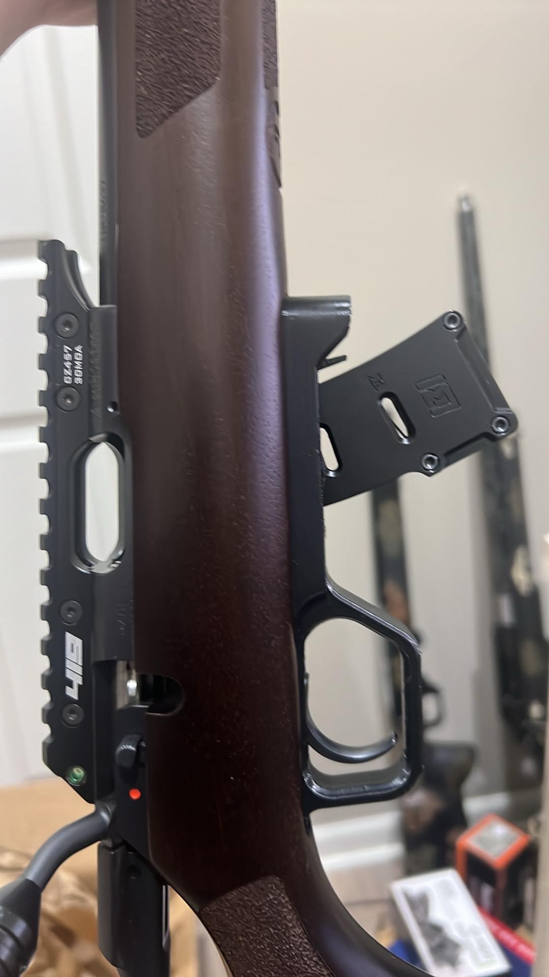

I went similar but I have the 16" MTR barrel, I might pull my LRP barrel off the 455 but my sons like how short it is.
  • CZ 457 16"MTR Barreled Action
  • Bushnell Match Pro ED
  • Zeiss Rings (I love them)
  • L3I Heavy steel ARCA Rail
  • Area 419 ARCA Lock Adapter w/ Atlas CAL
  • Super secret magwell/ latch
  • L3I Bolt Knob
  • L3I mags (all the L3I mags)
