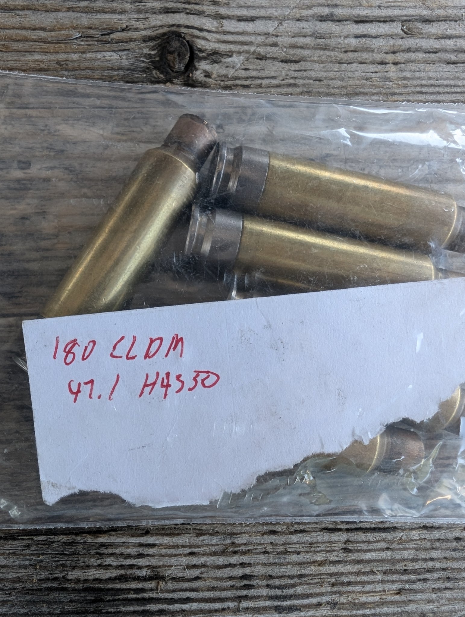

So accuracy is great, but the velocity has tapered off with the 180's. 44.5--->47.7 only gets me 80fps.

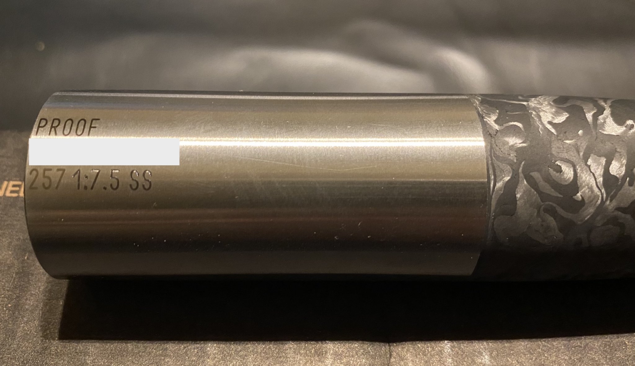

I’ve got a 25-06 AI I just started forming brass on. Planning on using 87 grain speeR TNT bullets if they shoot well. Shoot scoot along pretty good. I have a fast twist brux barrel in the safe… I’m gonna do some sorta 25 cal to shoot heavies with, just haven’t decided what yet. I’m a big fan of the 257 AI, just have to find someone with a reamer

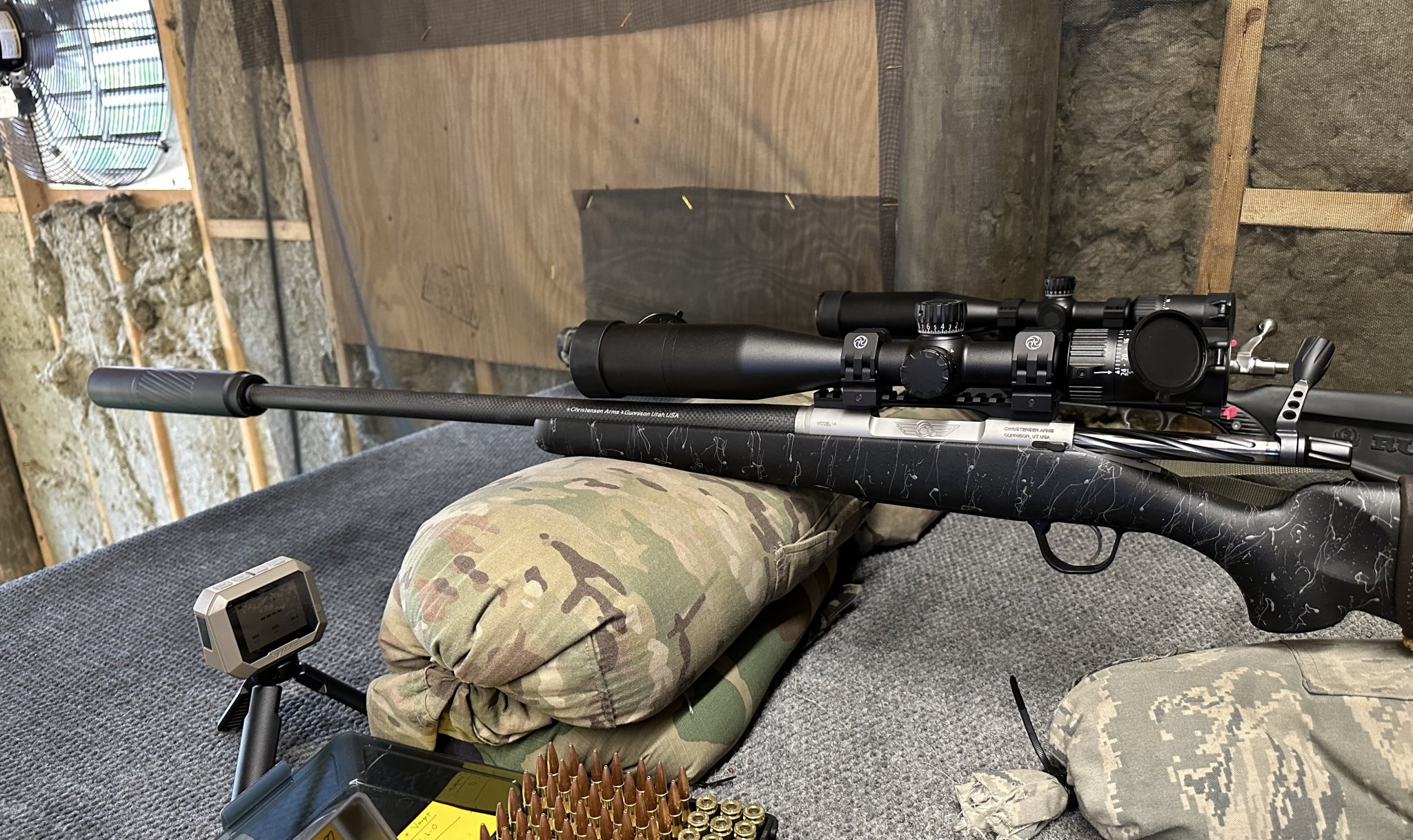

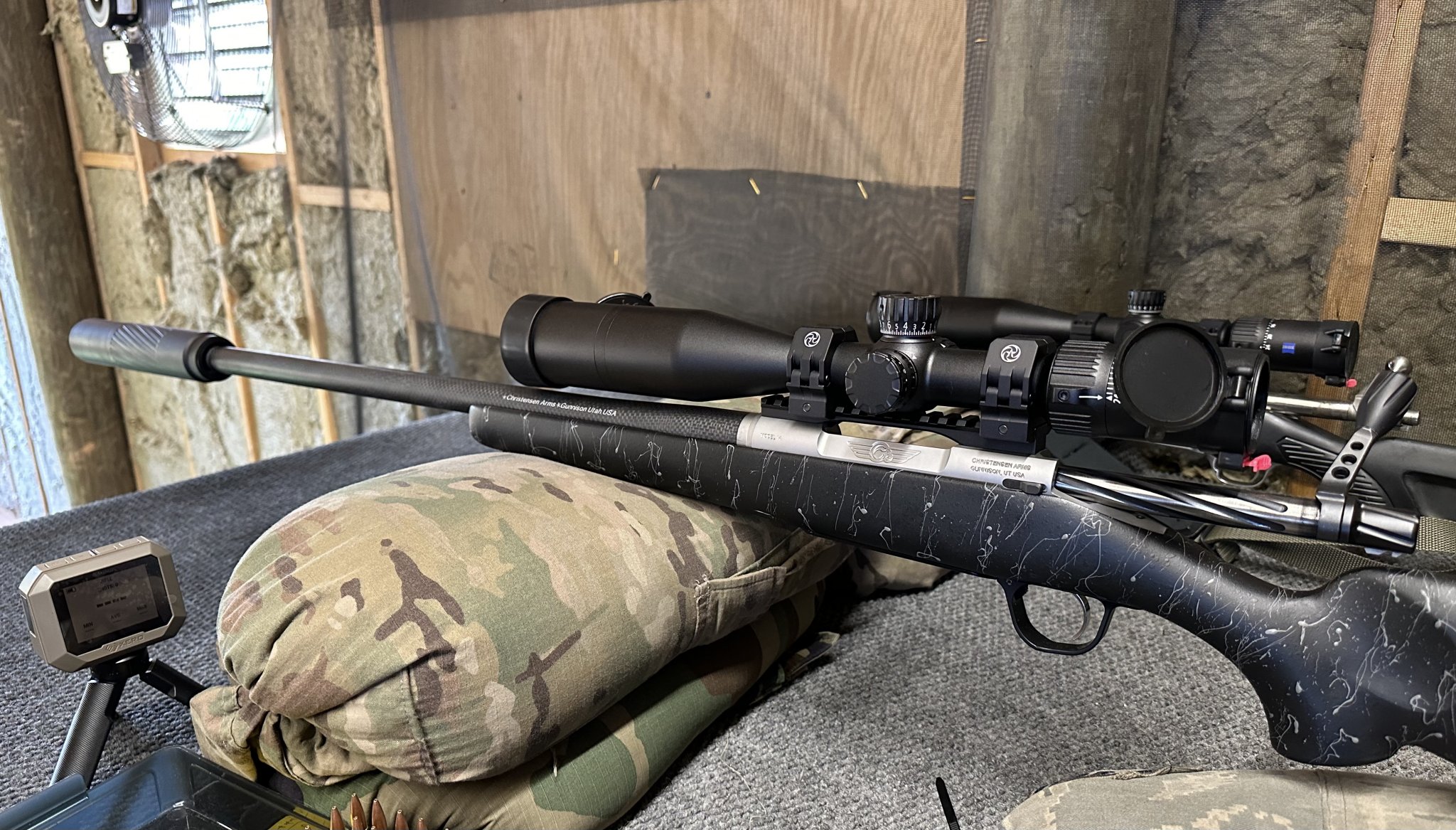

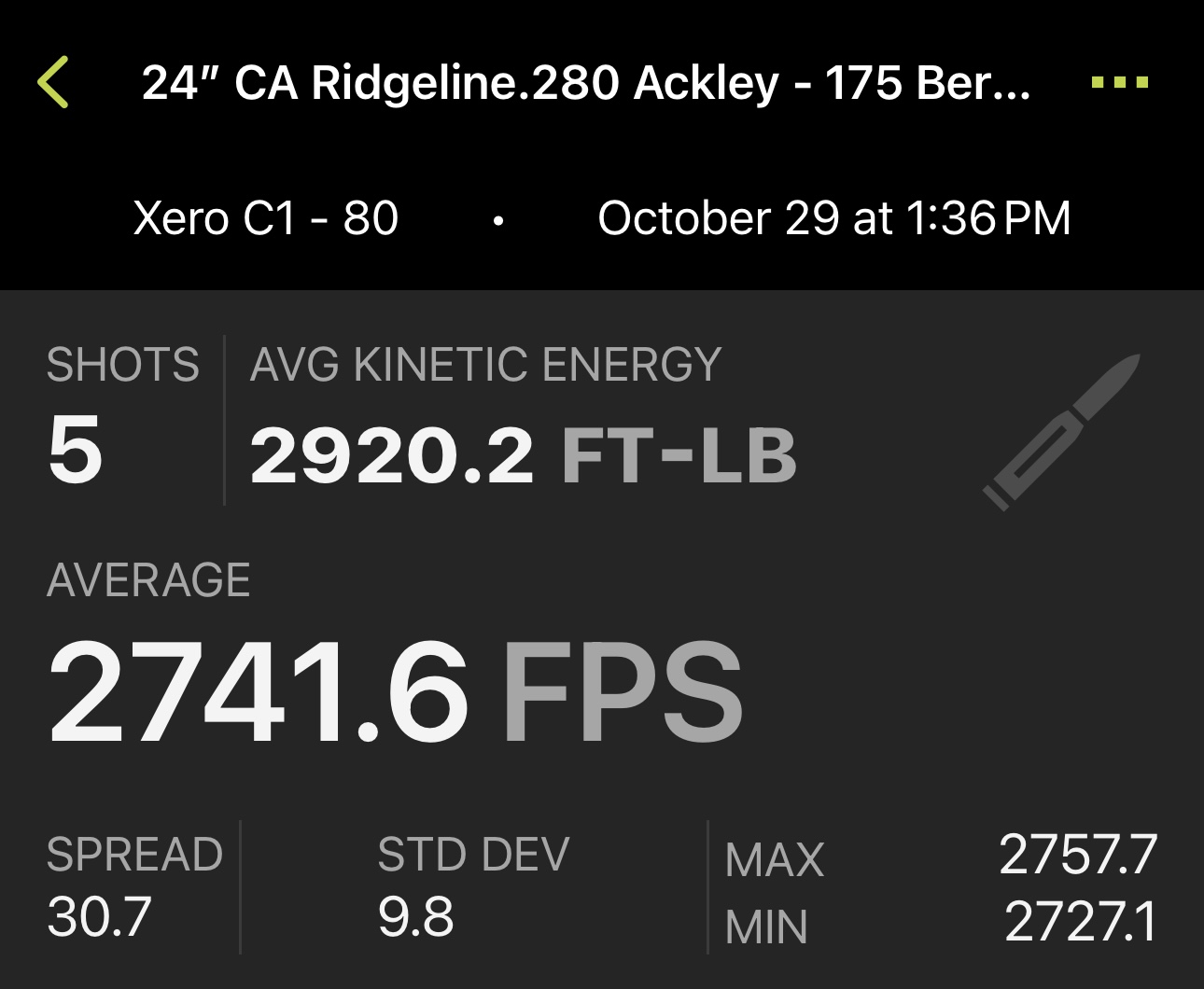

@christensenarms Ridgeline 24" .280 Ackley Improved with Berger 175 Elite Hunters, IMR 7977, Nosler .280 AI brass, and CCI 200 primers... Chrono'ing at a multi-session average today of 2,741.5 FPS muzzle velocity. Quieted down with my newly released from NFA-jail TBAC Magnus-HUB w/ an Otter Creek Labs ZR0-DTA mount.
Alamo precision rifles did mine. It’s a 7 twist originally planned to shoot blackjacks but got screwed in that deal like a lot of others. I’m liking the 110 accubonds and may leave those with it as I’m looking at two more 25 cal builds for the Berger 135s
