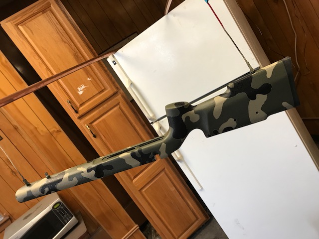

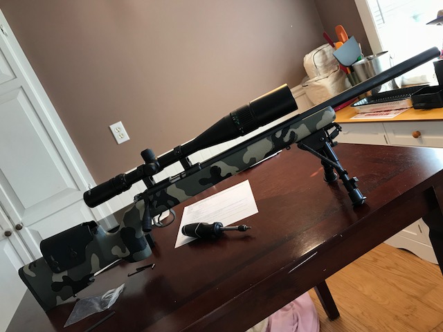

Decided to Rattlecan my Rifle
CZ 455 Varmint Boyds Pro Varmint Stock

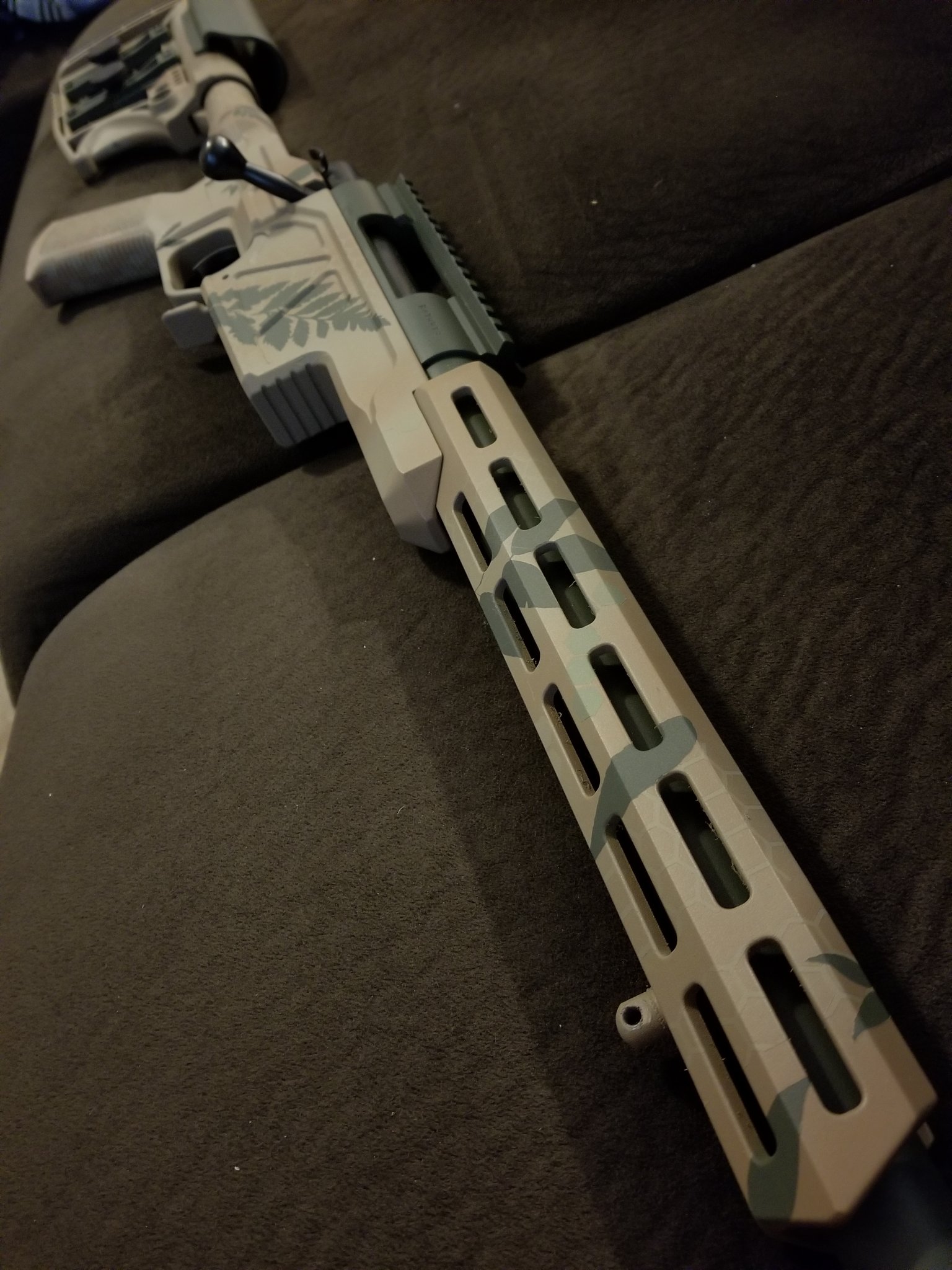

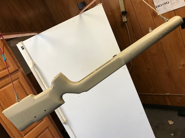

Nice work Op and others! I've got my RPR about 99% complete. I'll be adding camo to my dope card holder this weekend.

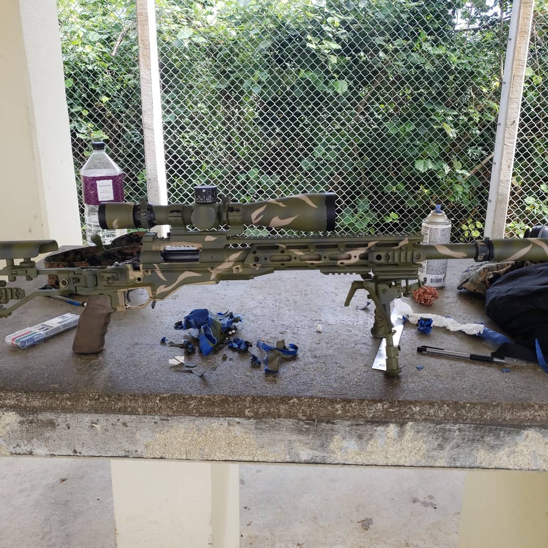

Just a few extra tips. I used the green automotive masking tape, it's stronger and seals better. I used a single hole punch to make small masking dots to keep paint out of small screw heads and mask other small things such as the parallax and magnification marks. Talk to the scope mfg technical support for advice and to make sure it won't void the warranty. They advised me to not overdue it. You don't need to make it a heavy protective coat, we're just trying to break up the pattern, any gloss and provide colors that will blend with the natural cover and shadows. You can always do touch up during down time. If it looks good at twenty yards and beyond, in the field, it's GOOD!

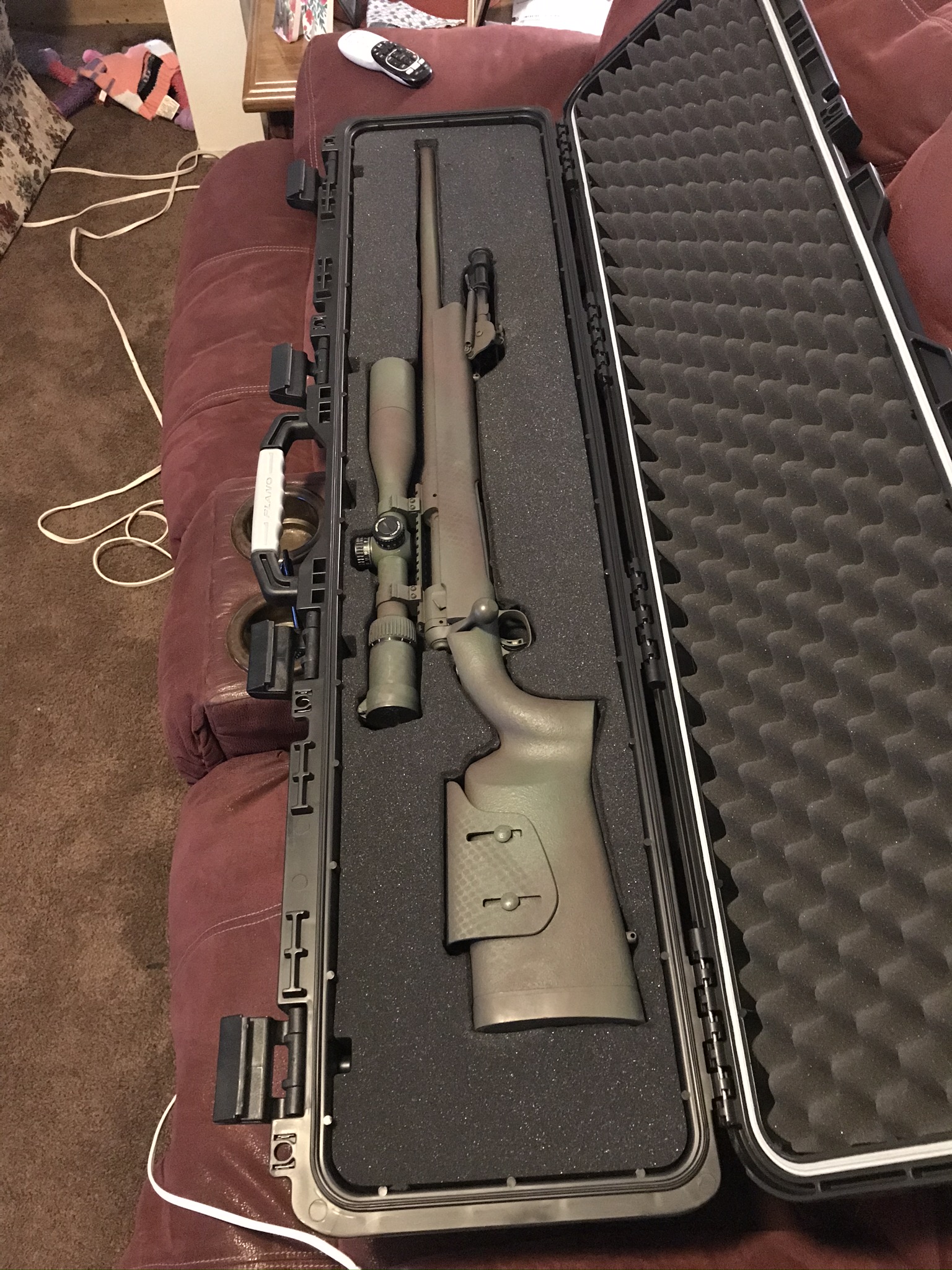

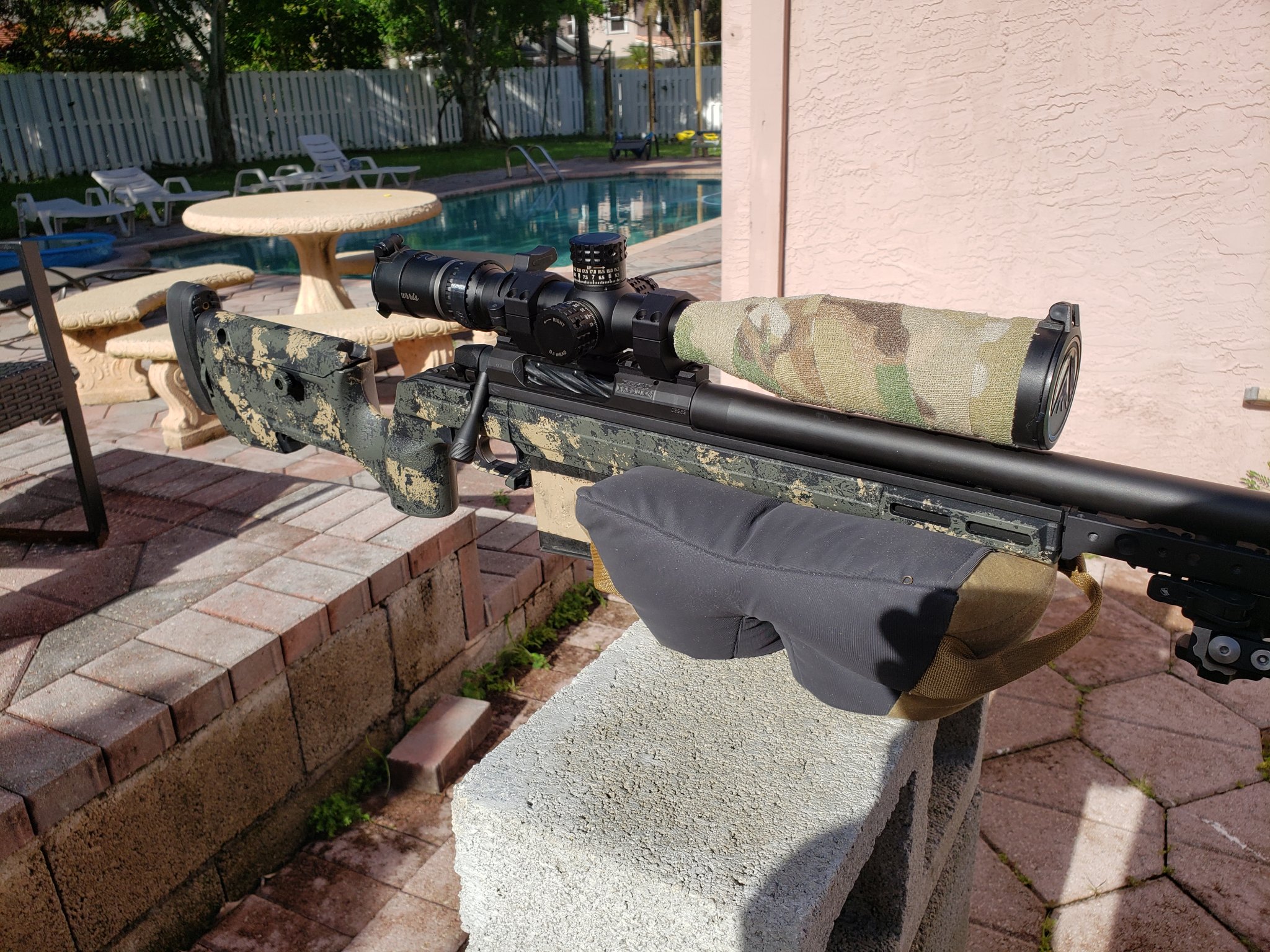

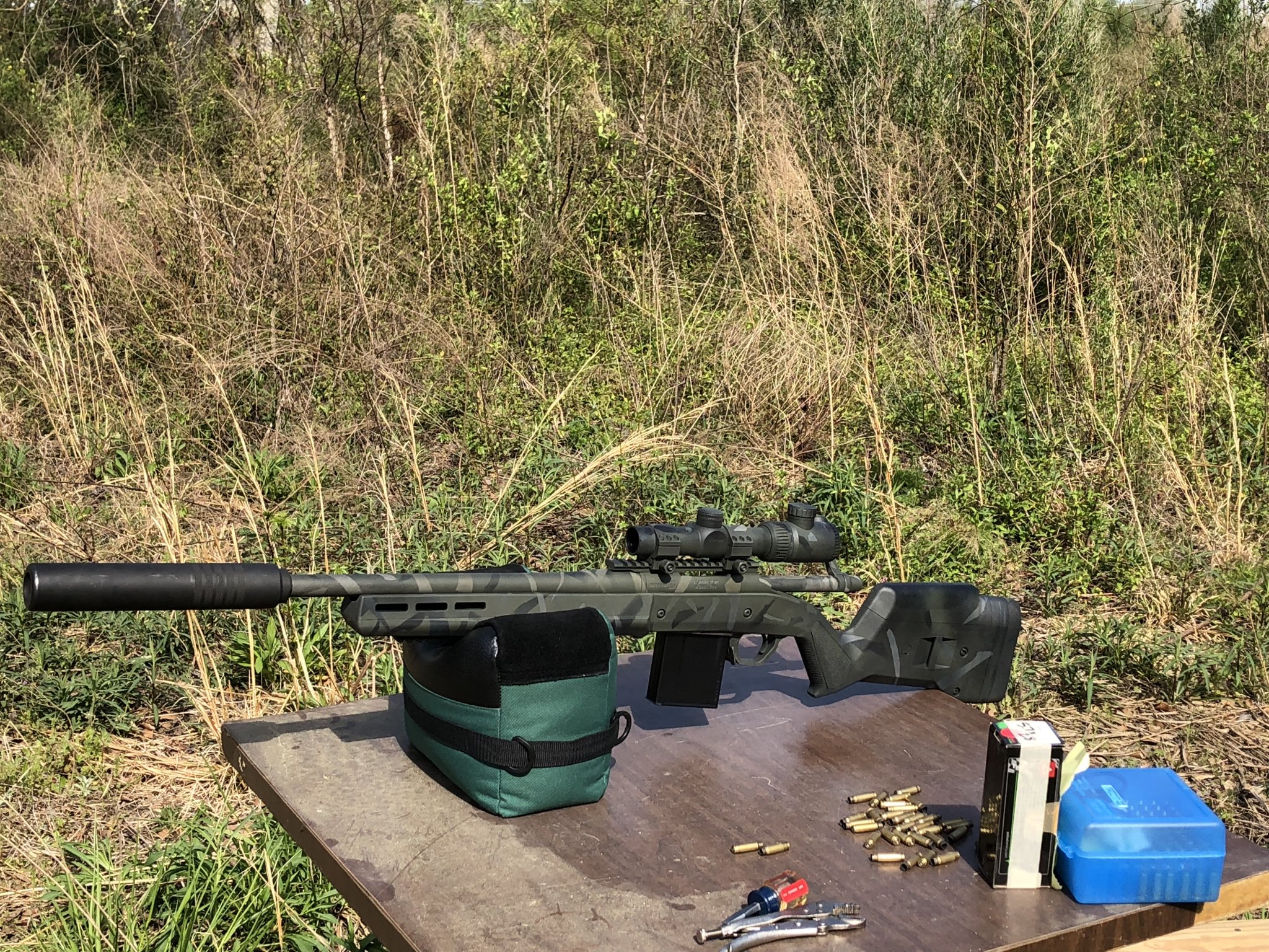

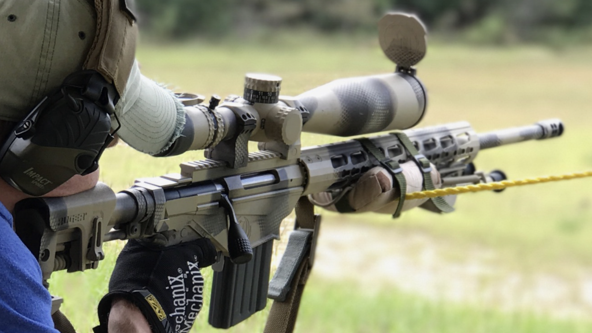

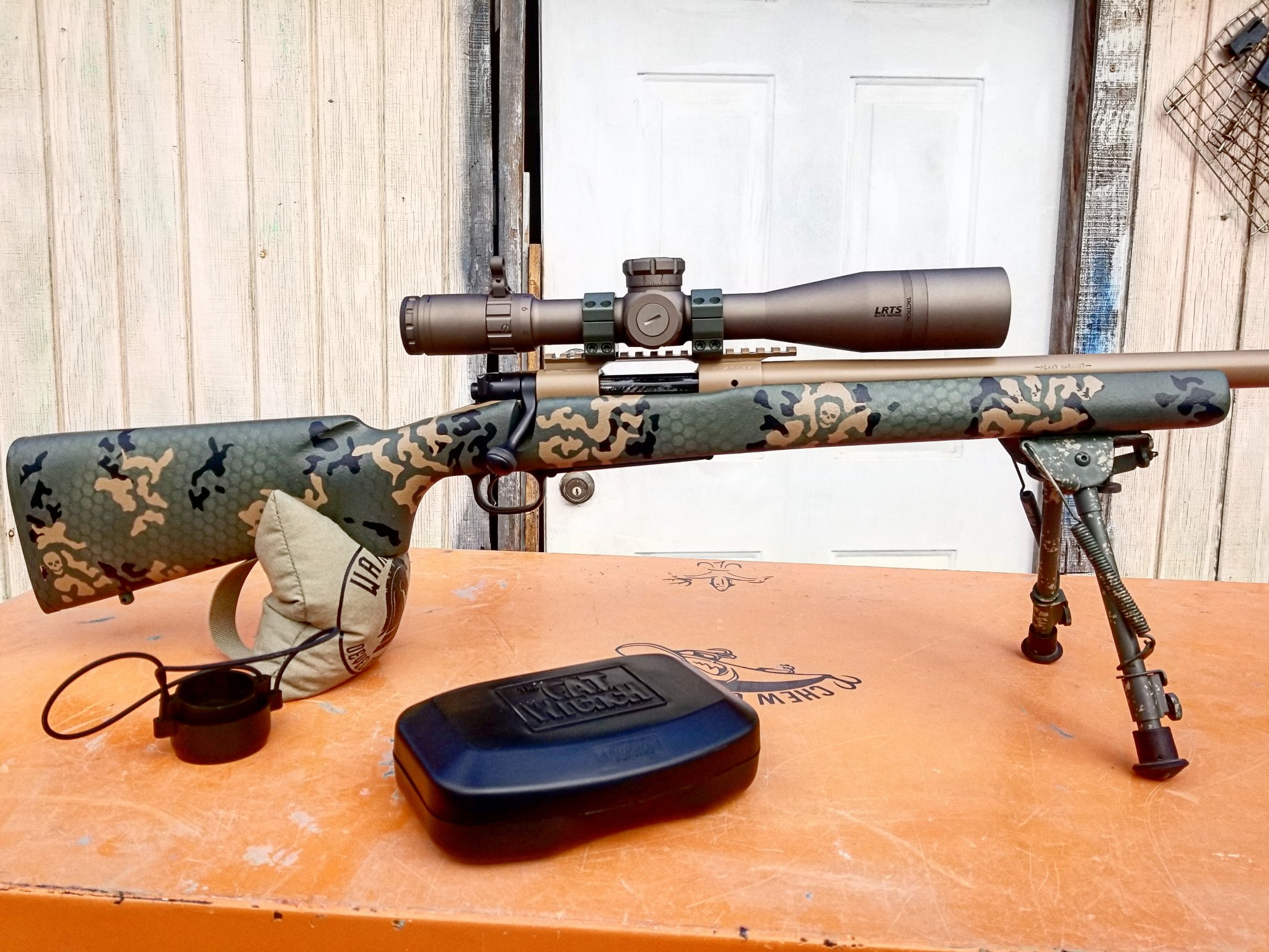

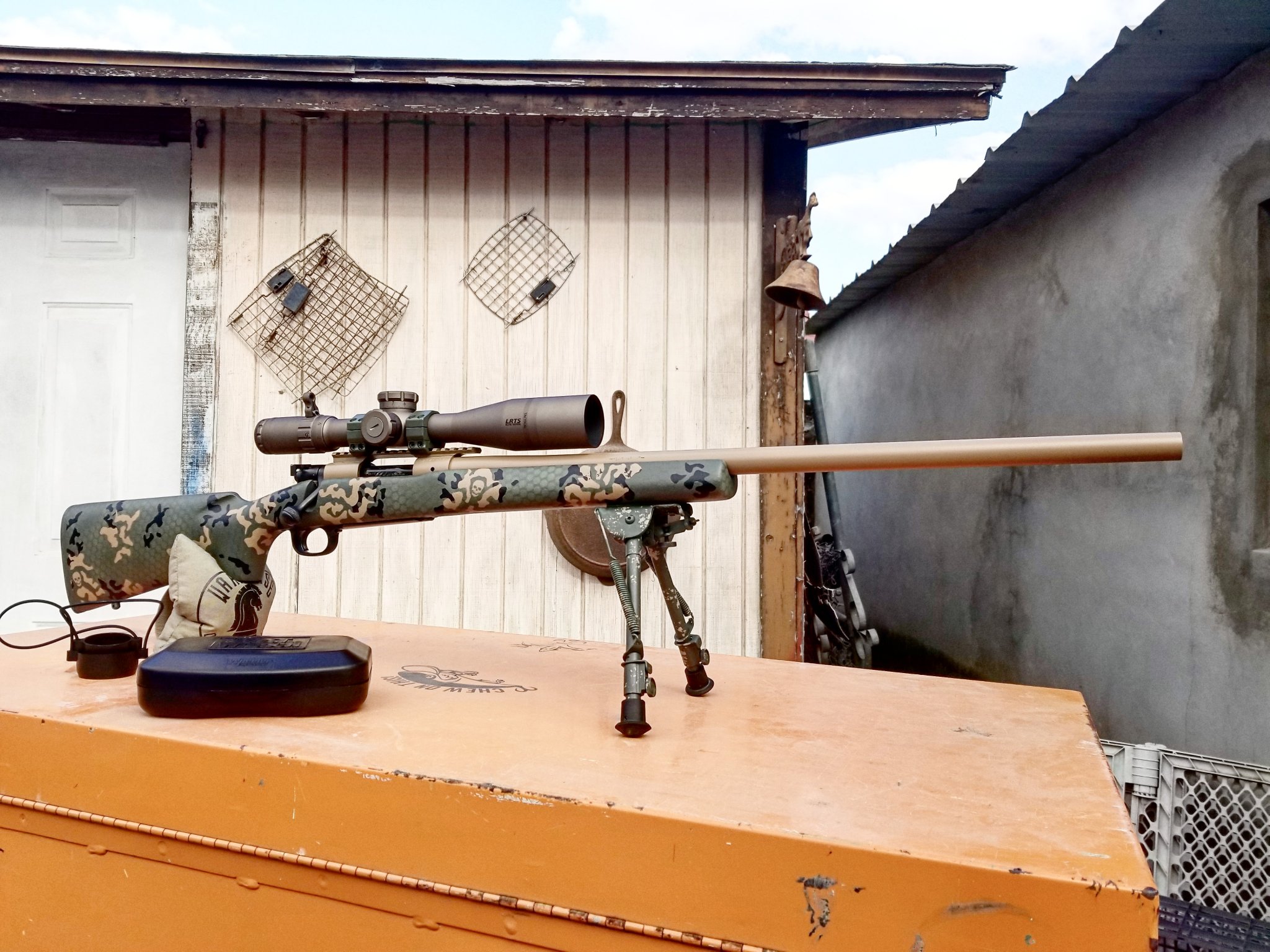

So after brewing some beer, I decided to rattle can my rifle that I just got back from Manners. . . . . MERICA! By the way, thanks again to Manners, the stock turned out fantastic. I took my time and spent probably about 2 hours taping and prepping my rifle, so I got that part right. I think the shade of green might be a little too light, but I'm hoping it'll grow on me. Theres a couple of blemishes here and there, but I'm pretty happy with how it turned out. Lemme know what you guys think, it's not exactly professional, but I made due with what I had (learned improvising early on in my military career hahaha). Also made due with my iPhone camera, hope you guys approve.
Looks good
Looks great, better attention to detail than I give. I use a similar green colored Rustoelum and really enjoy how it blends year round on the prairie and in conifer forests. I gave up using browns and dark greens in my area because the dark colors are too easy to pick out compared to the light colors in my experience.

Nice work! I can't bring myself to rattle can my rifles. Want to, but just can't muster up the confidence!
I thought alike when I had my fist custom rifle in my hands. I botched my first few attempts due to lack of proper prep work. Detailed de-greasing and taping is key to success. After painting dozens of my own rifles and friends, I would not consider paying someone else to camo my stick. Worst you can do is screw up and learn from it.

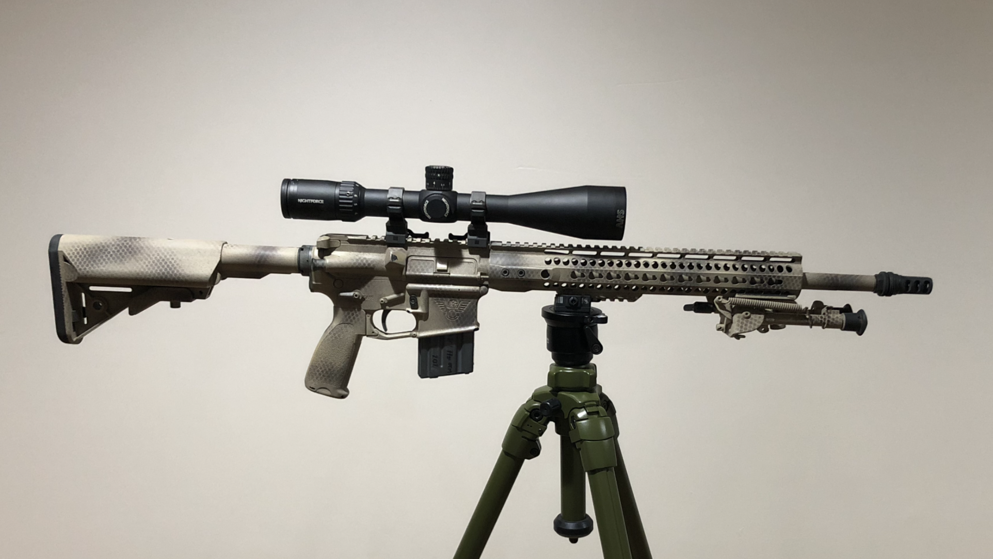

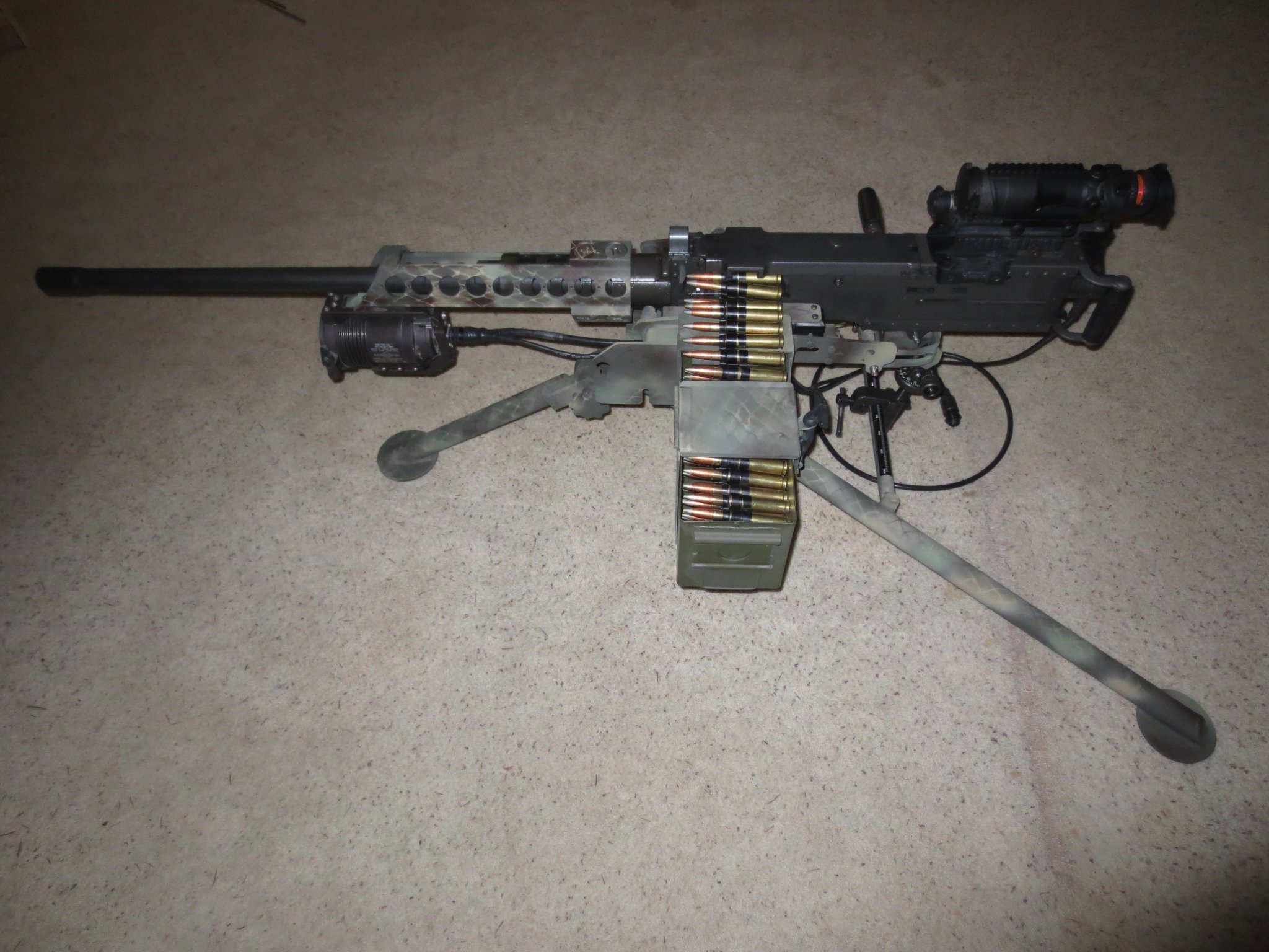

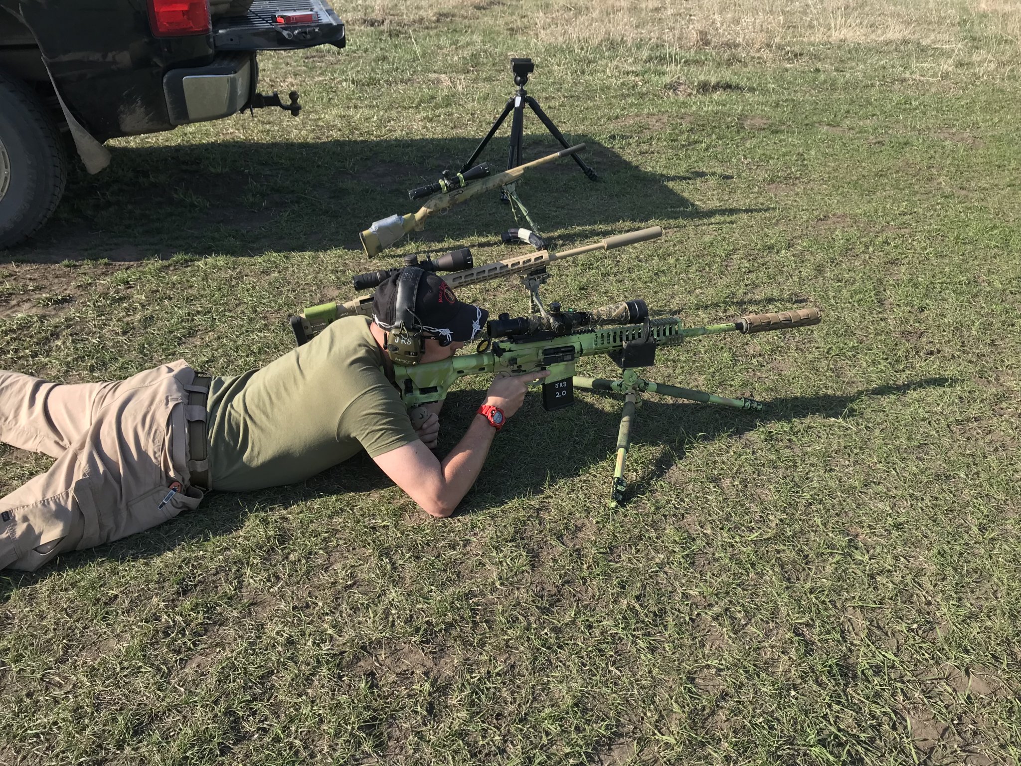

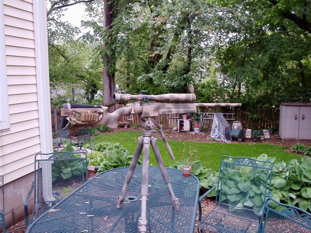

Here's a recent job I did to a tripod, mount and Surefire rail; lighting is bad but you can see how I just sprayed it solid dark OD and then sprayed other colors here and there and then used a piece of fish netting to add diamond patterns in the light and dark colors with over sprays. There is a matching UPA and 200rd. can holder for mounted use. Again, the lighting doesn't do it justice and there's actually more contrast than shown, particularly on that protruding rear leg:
The M2 could have been ordered Cerakoted FDE (or other colors too I think) for $500 I think. Still kicking my ass for not having that done. If it was that price, it was a steal considering it would have been done inside and out prior to assembly. Damn. Oh well, it's still a very, very nice weapon. And a lot of fun.
In a field condition where it's actually deployed, fish netting, burlap and natural vegetation combined with a concealed dug in hasty bunker position with sandbags and camo would pretty much conceal the rest of it.
But the paint was mostly just to protect the finish of the tripod and mount, the UPA and 200rd. attachment needed refinishing. Gives it a bit of character too.

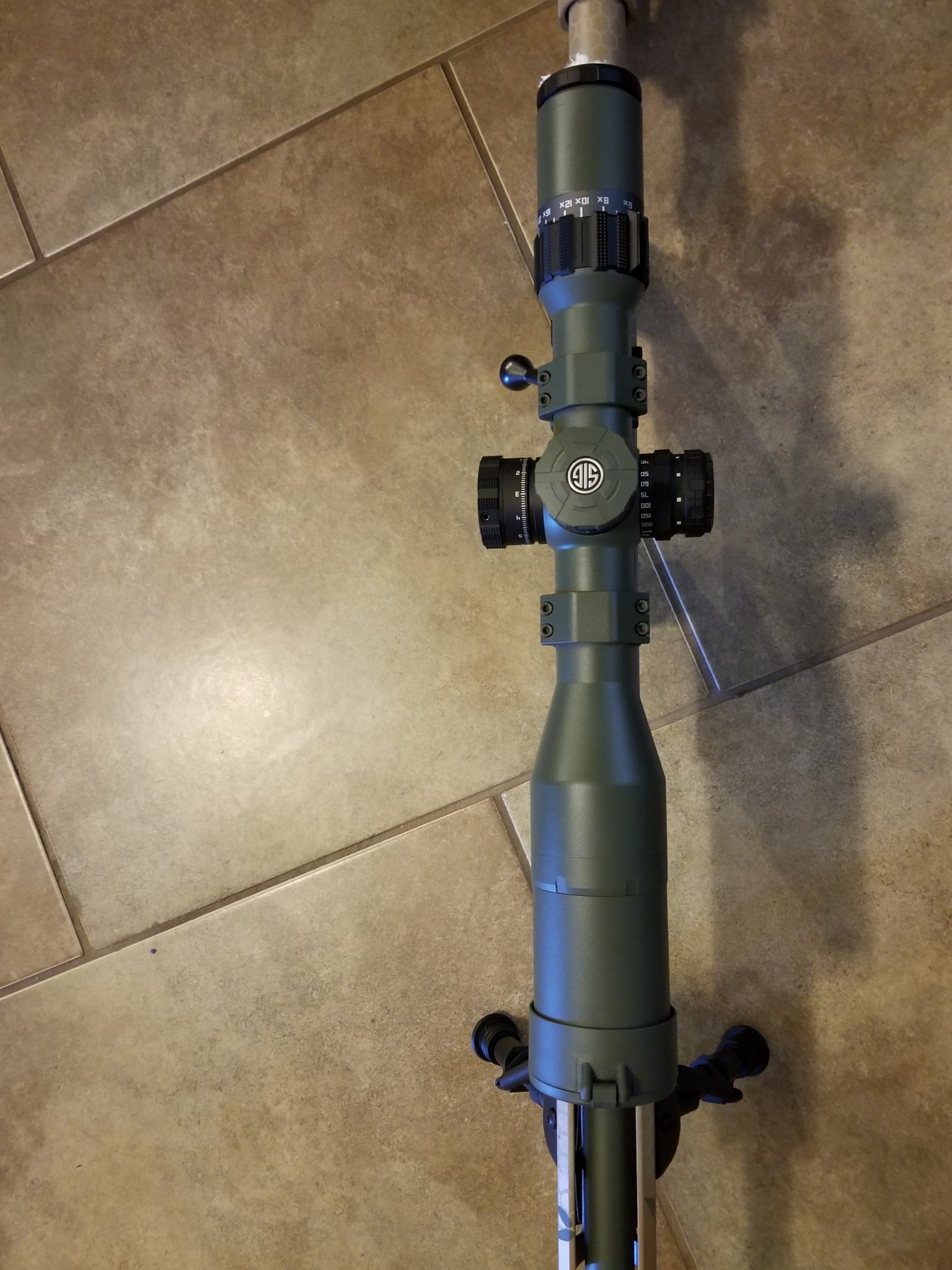

I've done a few rattle-can jobs in the past, but found myself switching to Cerakoat or Duracoat. Cerakoat mainly for things that I can bake and Duracoat air-cure for things that I can't.
Still can't bring myself to do an optic. Getting around all of the knobs and other controls - just impossible without disassembly (which is virtually impossible outside of the factory). Typically end up just using McNett wrap.
I can do strictly concealment painting - wouldn't win any awards though. Done it before on mediocre optics - nothing high-end.
No need to disassemble a scope, just be really extra good at masking...

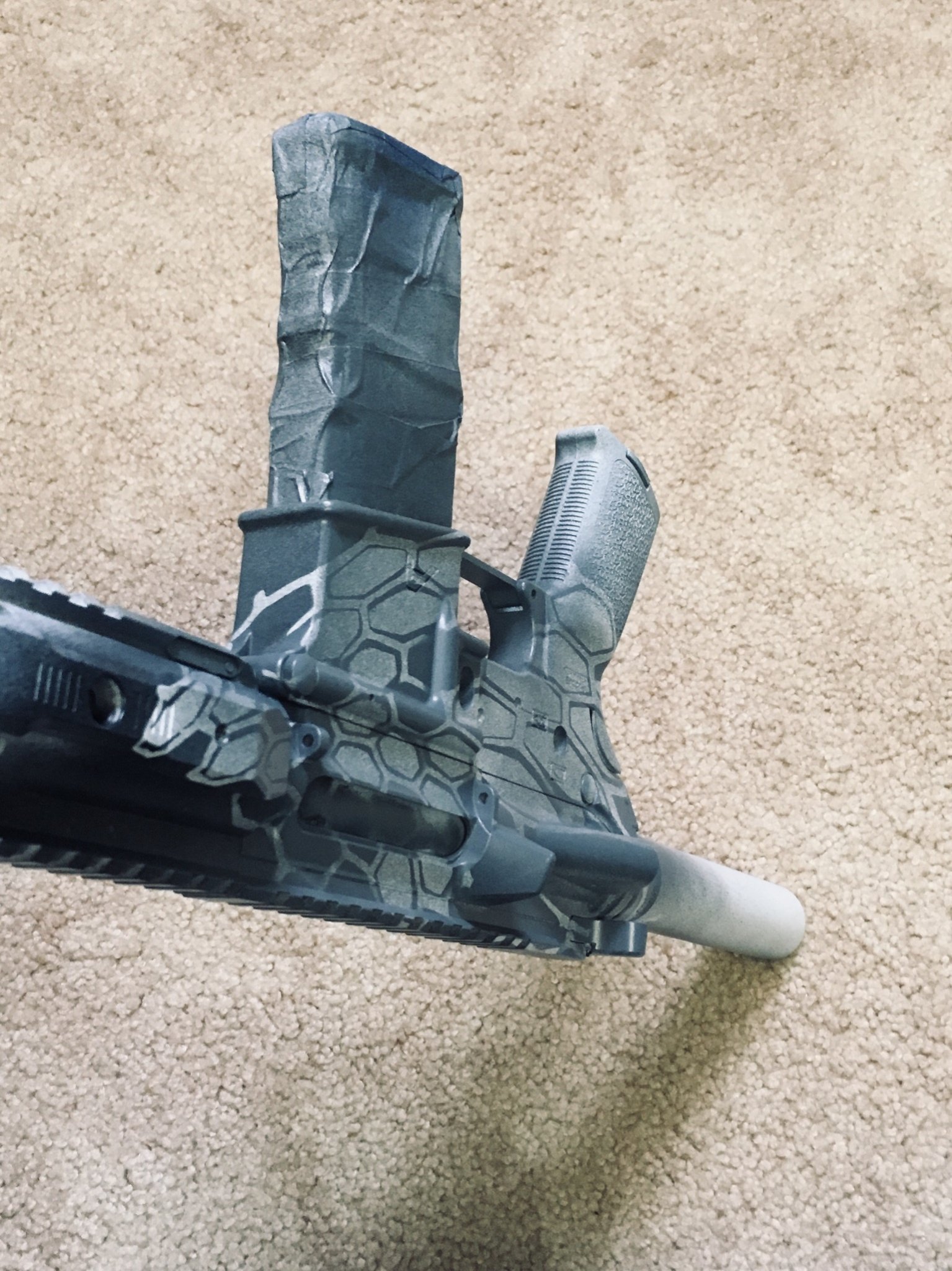

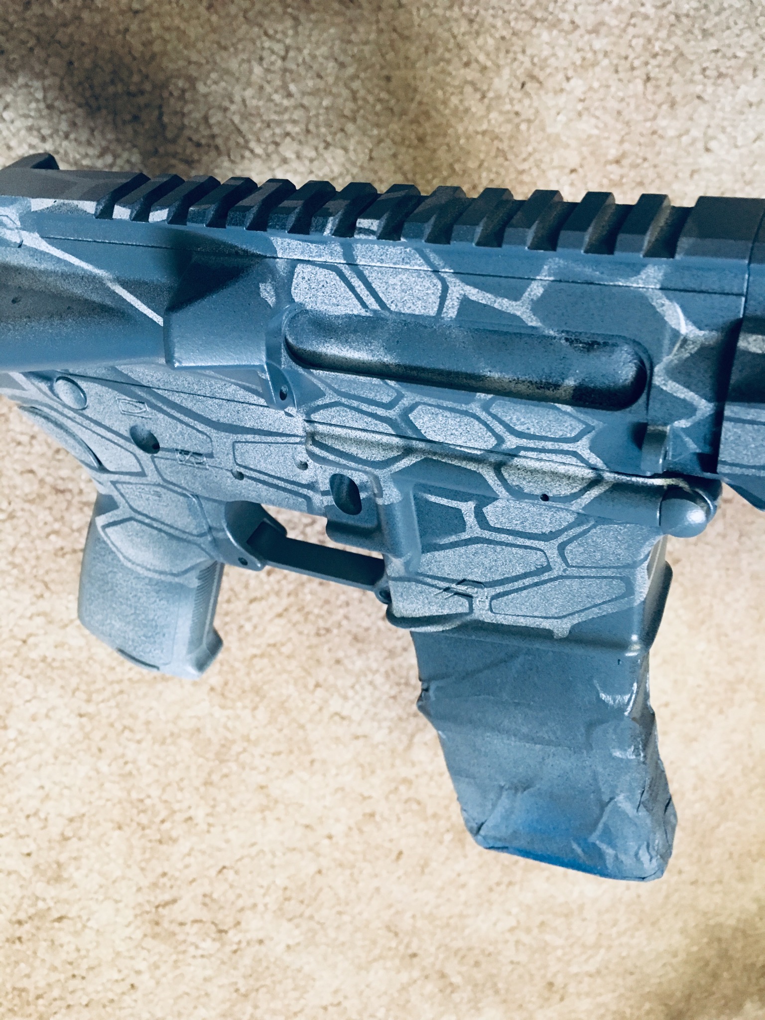

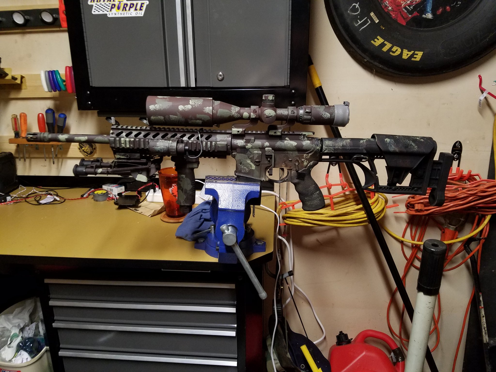

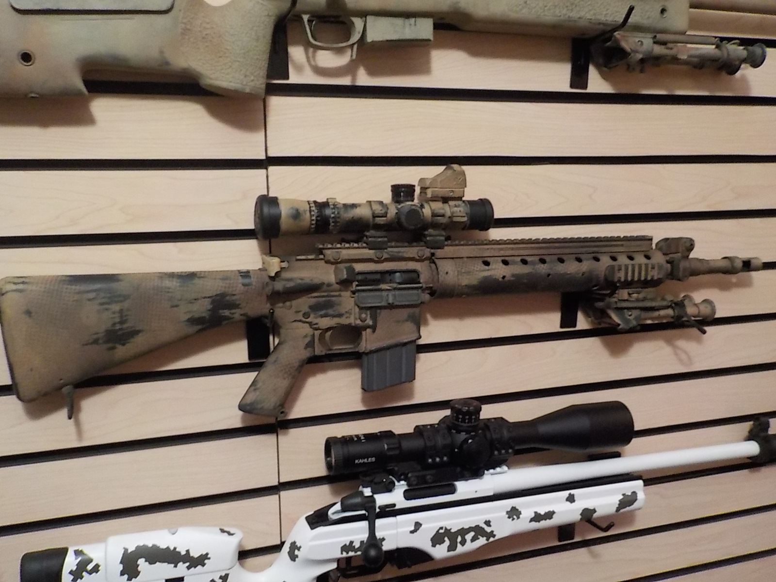

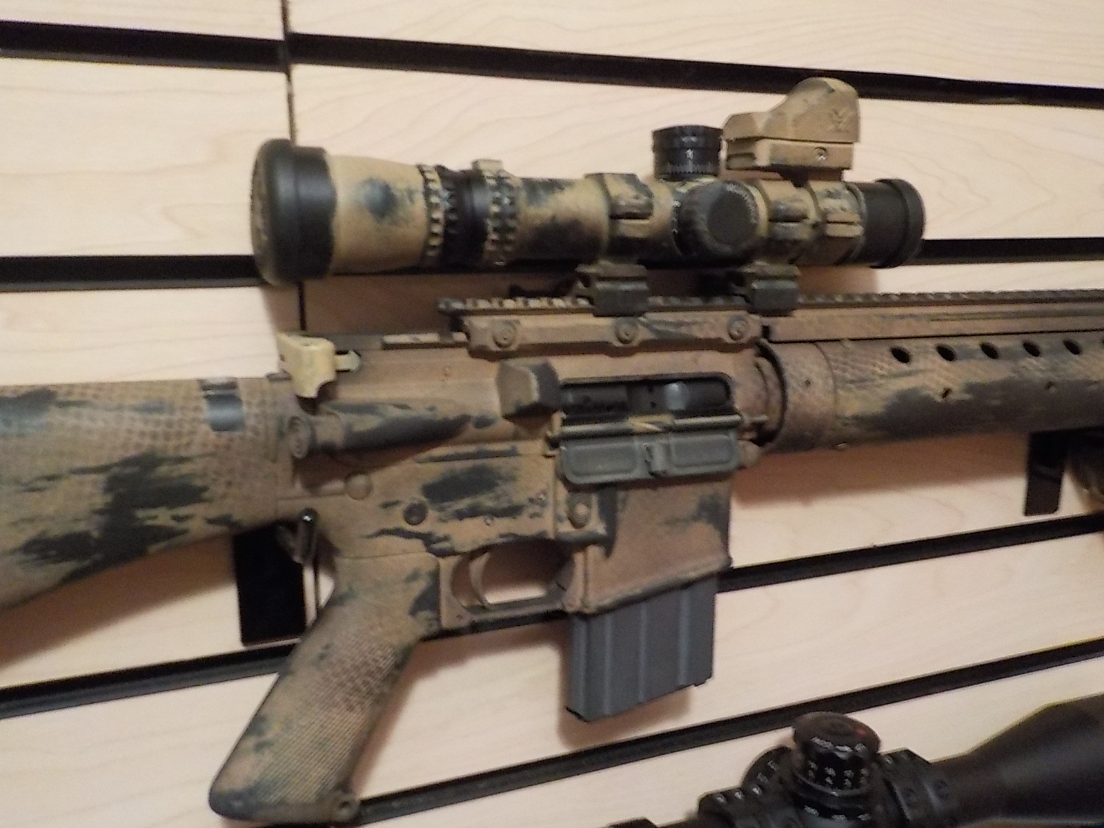

I really like Cerakote, but recently I have been building a bunch of rifle clones as used by USSOCOM. Researching these guns, almost all had a spray paint finish and all had battle wear. I really like the look of a rifle that has been used hard and has a story to tell. Consequently, I've been giving a lot of my USSOCOM clones a battle worn spray can finish. Here is a very accurate Mk12 Mod 1 Special Purpose Rifle clone. I'm still waiting on my Allen Engineering suppressor.
Colt m16a1 lower
Colt upper
Brownell's Mk12 SPR 5r rifled barrel
Allen Engineering brake and collar for Allen Engineering suppressor
Gas Buster charging handle
M16a1 original surplus stock
Precision Reflex carbon fiber handguard
Precision Reflex gas block w/ front sight
Swans #40 buis (not shown)
Colt bolt
Harris Bipod
m16a1 grip
Nightforce 2.5-10x scope w/ swans rings
Vortex red dot
Reactions: pilotjoe
I’ve got a bit of hesitation to use something when it’s new and perfect. I want to keep it looking new and perfect for as long as possible. I found that putting paint on them let’s me not care. I don’t abuse my rifles because of it, but I don’t try to keep it perfect by not using it. So when it gets banged off a barricade or it starts raining and is muddy I don’t have that hesitation to not use what I have. If you’ve used quality stuff in your build, using it won’t hurt it. The paint allows me to get past the asthetic issue I’d normally have where I don’t want to get marks on my pretty new rifle.

you mean MK12 Mod 0
very nice rifle, just not a Mod 1

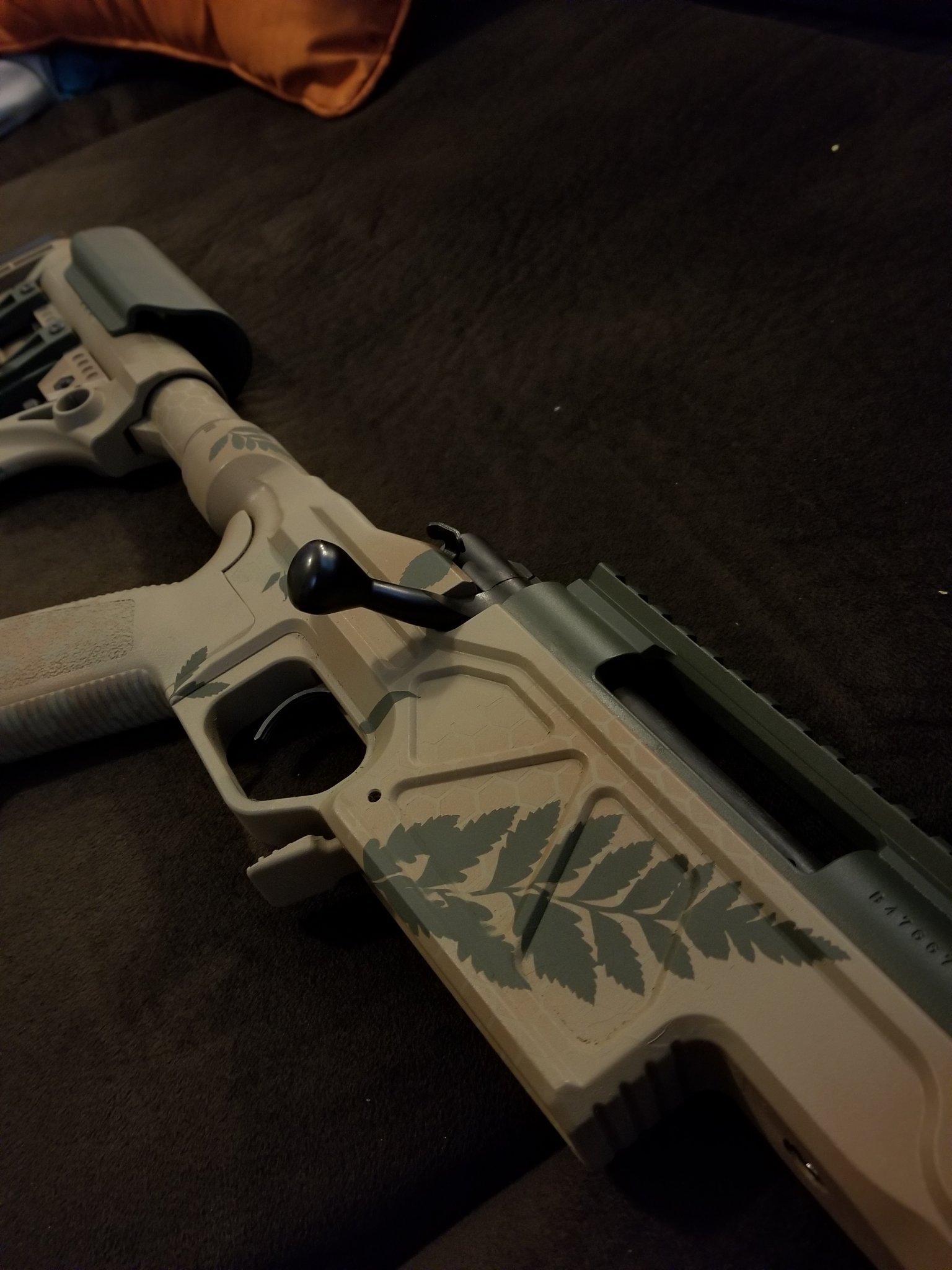

Patterns: Nothing isn't useful. Take a stalk of pine needles, spread them a tad. Plant leaves with distinct edges. Even the mesh bags in the supermarket that hold onions and potatoes are awesome. Grab up some cheap laundry bags, nice mesh pattern. Not to mention stickers in whatever shape you like to use.

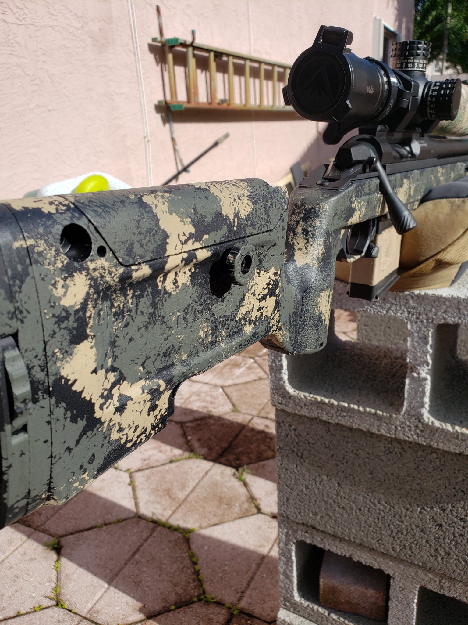

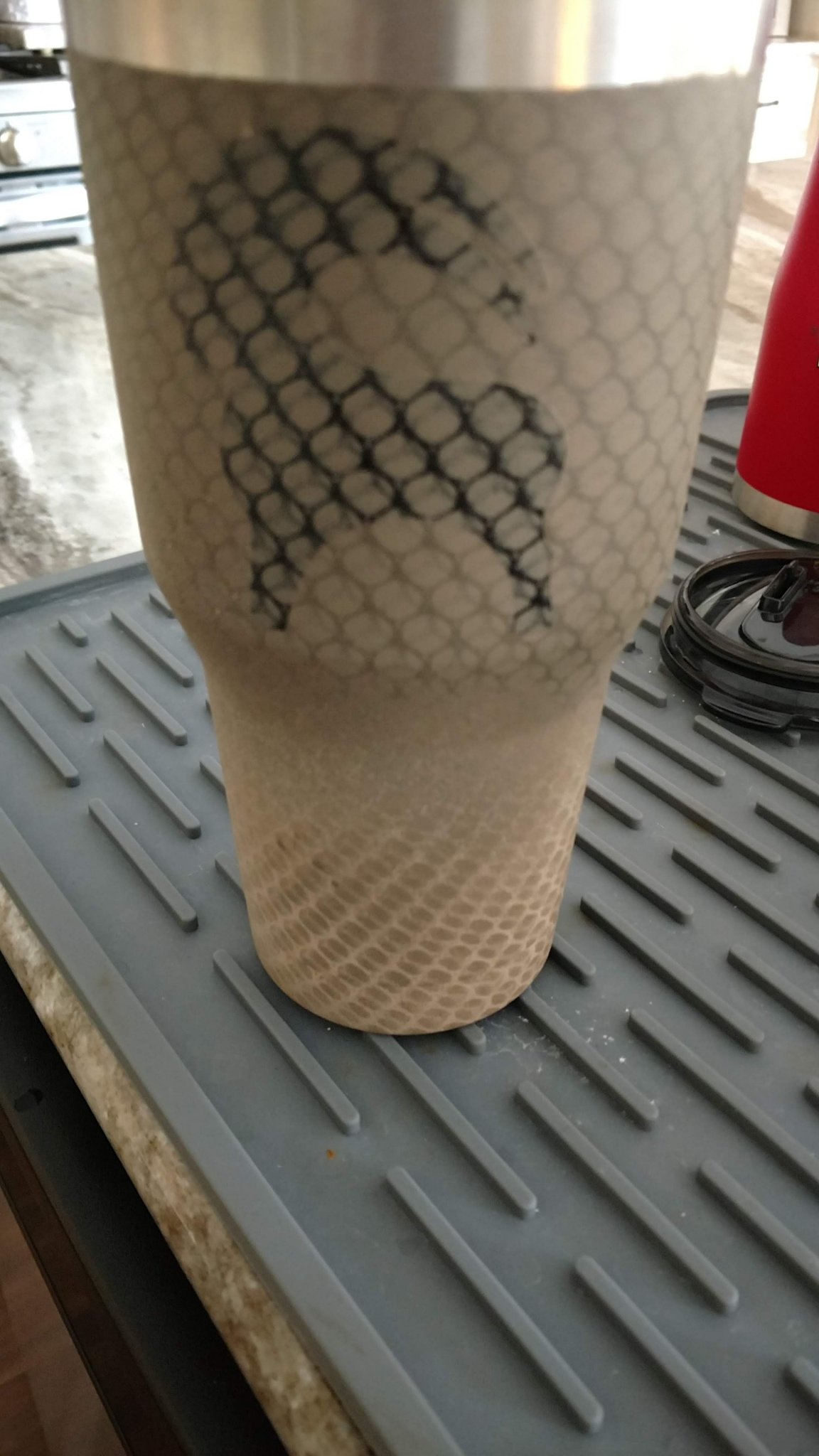

Took to practicing skills on a cheap stainless tumbler.

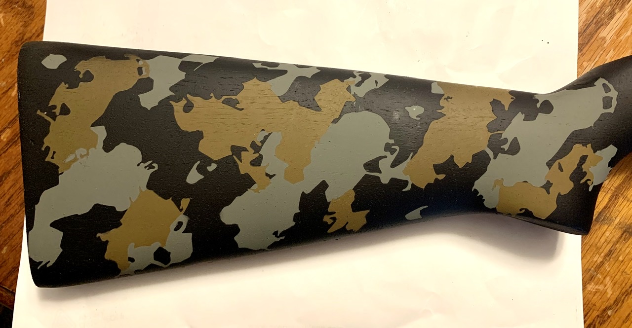

Does anyone wanna recommend color/pattern ideas?
I hunt will all my rifles so I'll probably use colors that go with the foliage around me but could always introduce new ones.
My rifle will have a McMillan A2 so it's got room for stuff.
I'll post below what my current rifles look like.

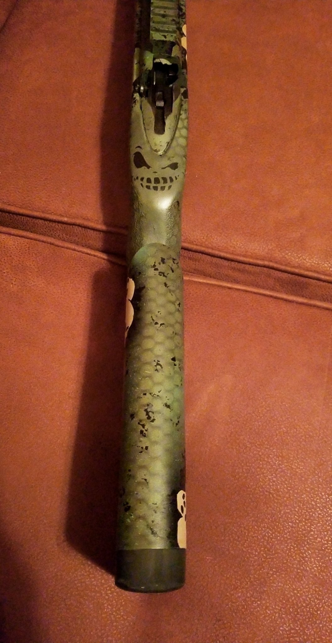

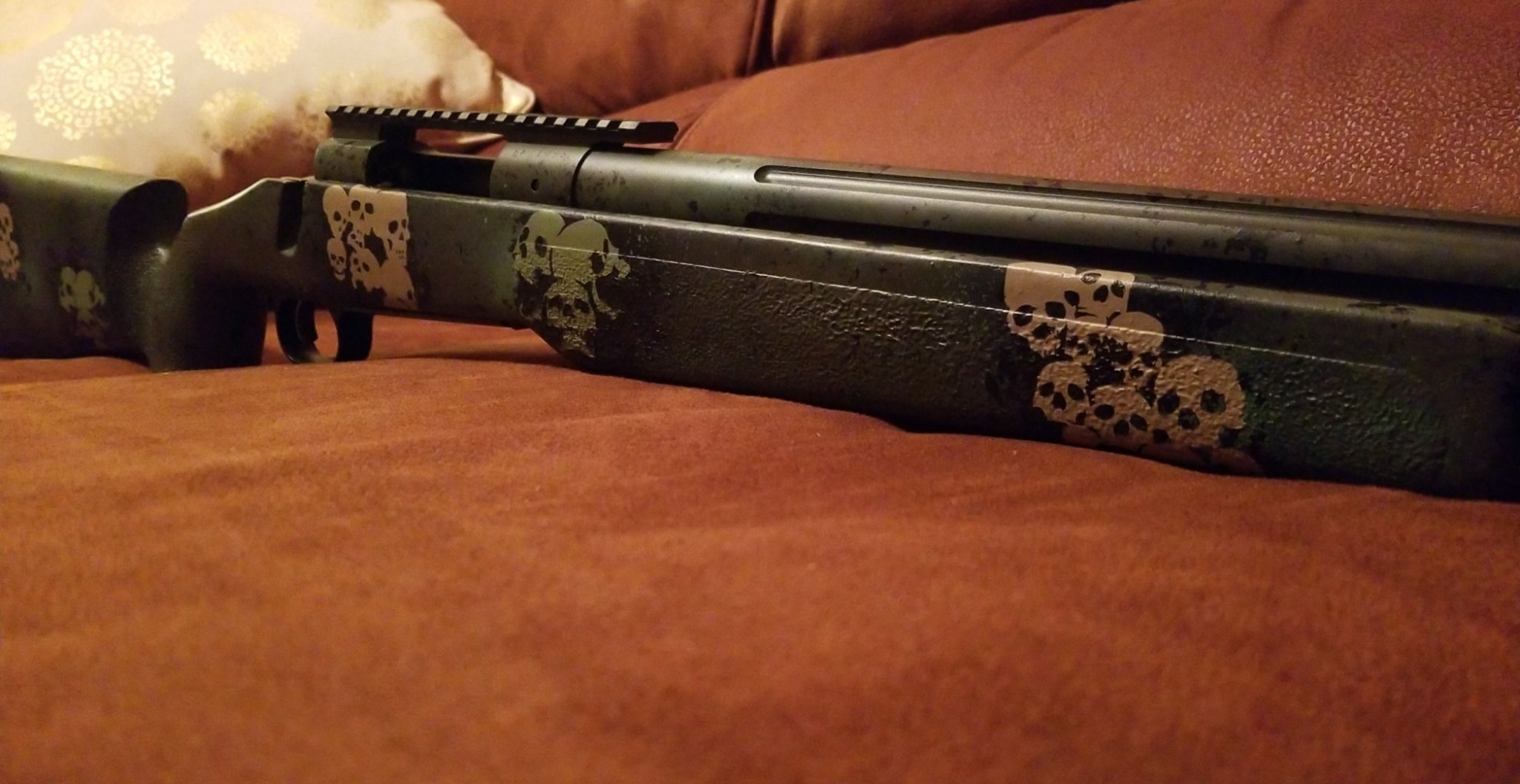

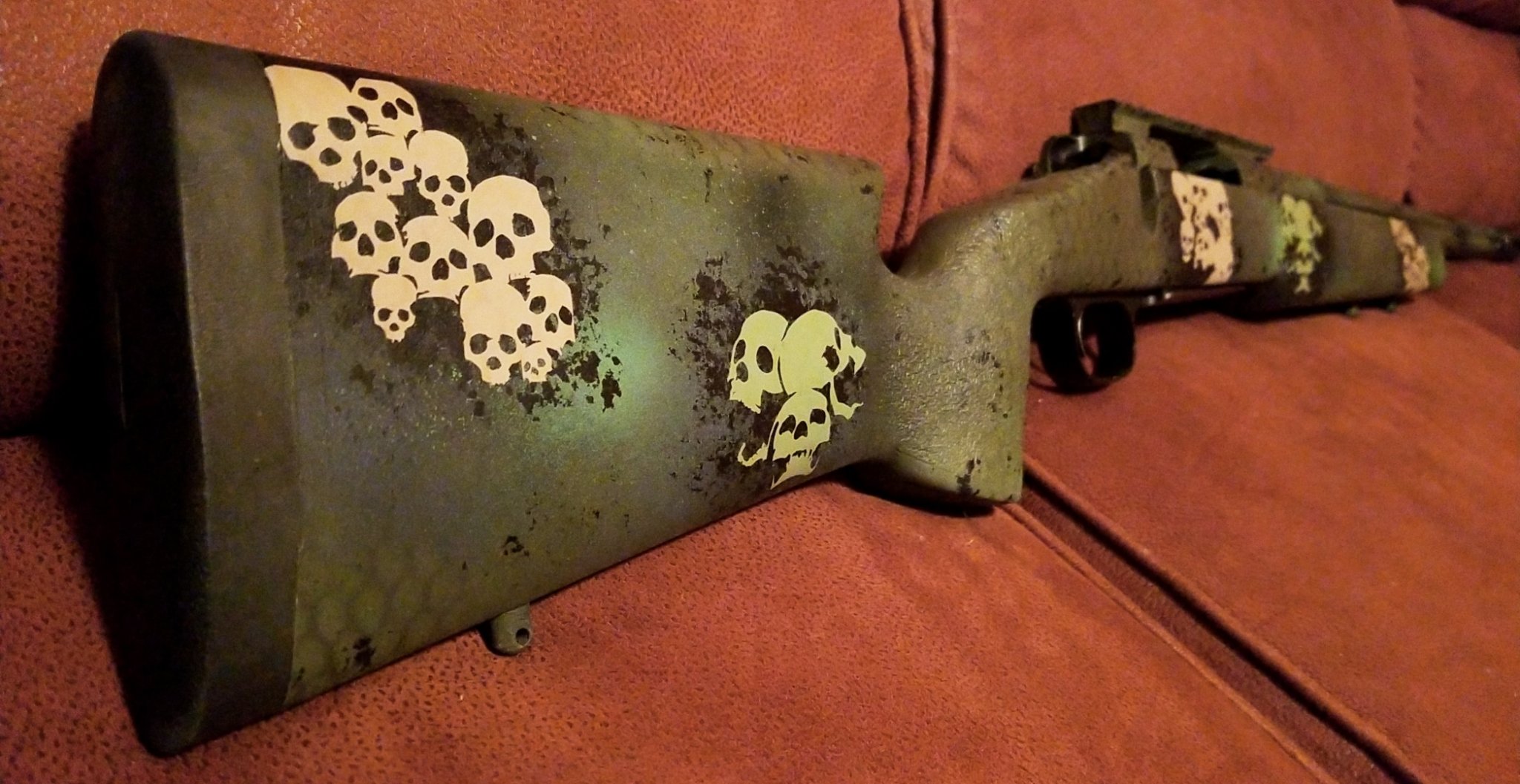

I think im leaning towards some sort of skull camo on this new one.

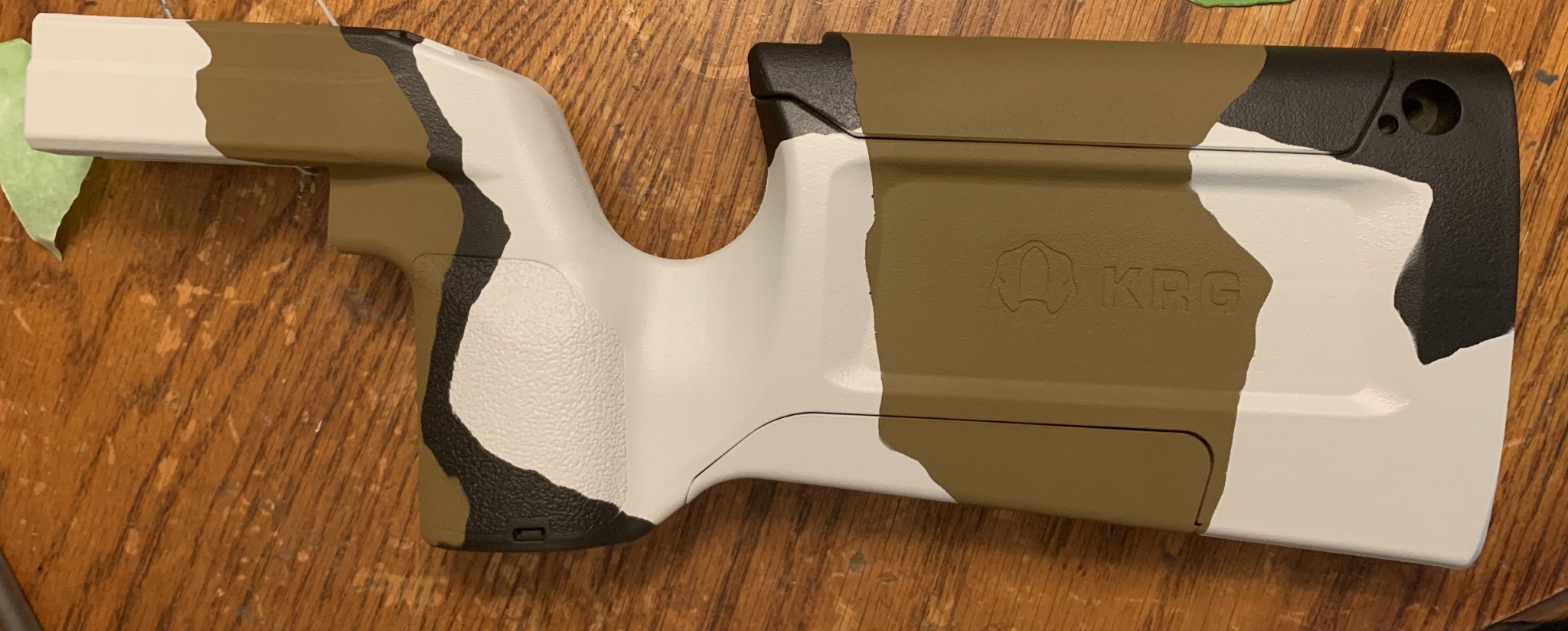

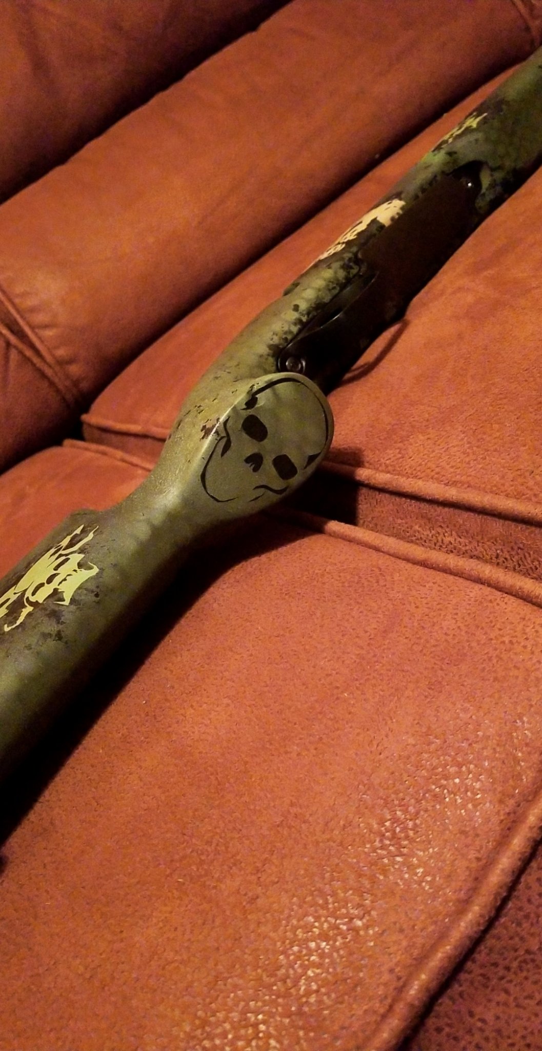

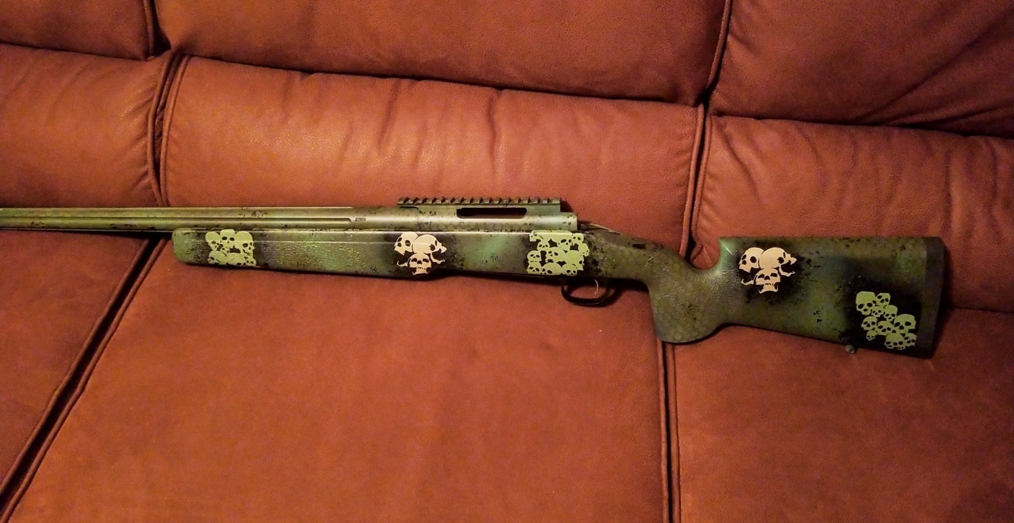

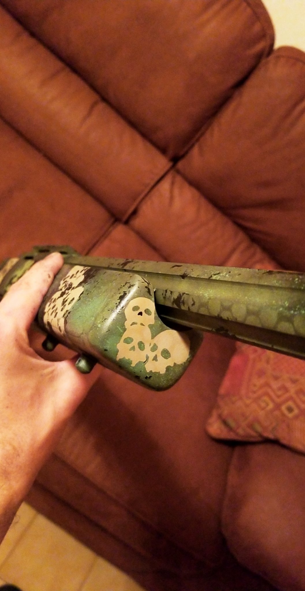

Just did this as a trial run to see how well the colors looked with each other...
I plan to use those colors on my newest rifle. However, the stencils will be skulls and not those curly funky shapes. I'm also not sure which one of those two lighter colors (sage green or tan) I'll want to use for my skulls. I prefer to only use one but if I can't decide I may just use both.
I had also thought of adding a bit of natural sponge-ing just around the skulls to create even more contrast. Still thinking on it. I may have to paint something else using that method to see if I'll actually like it.
Thoughts???

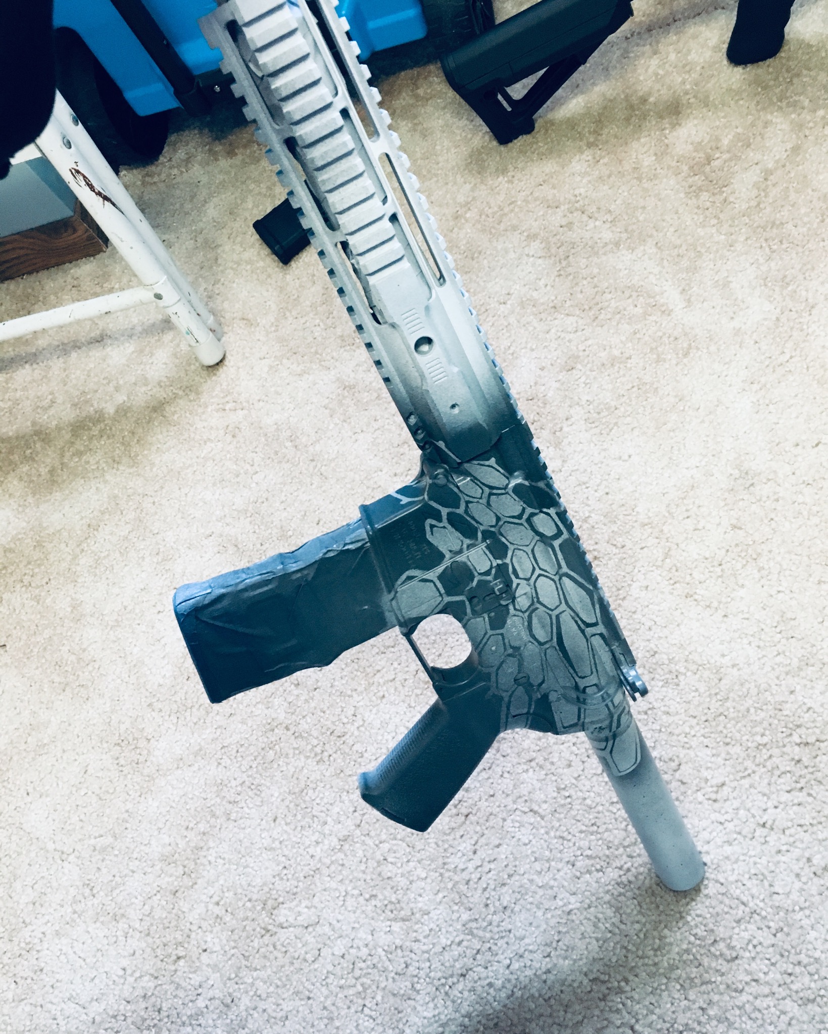

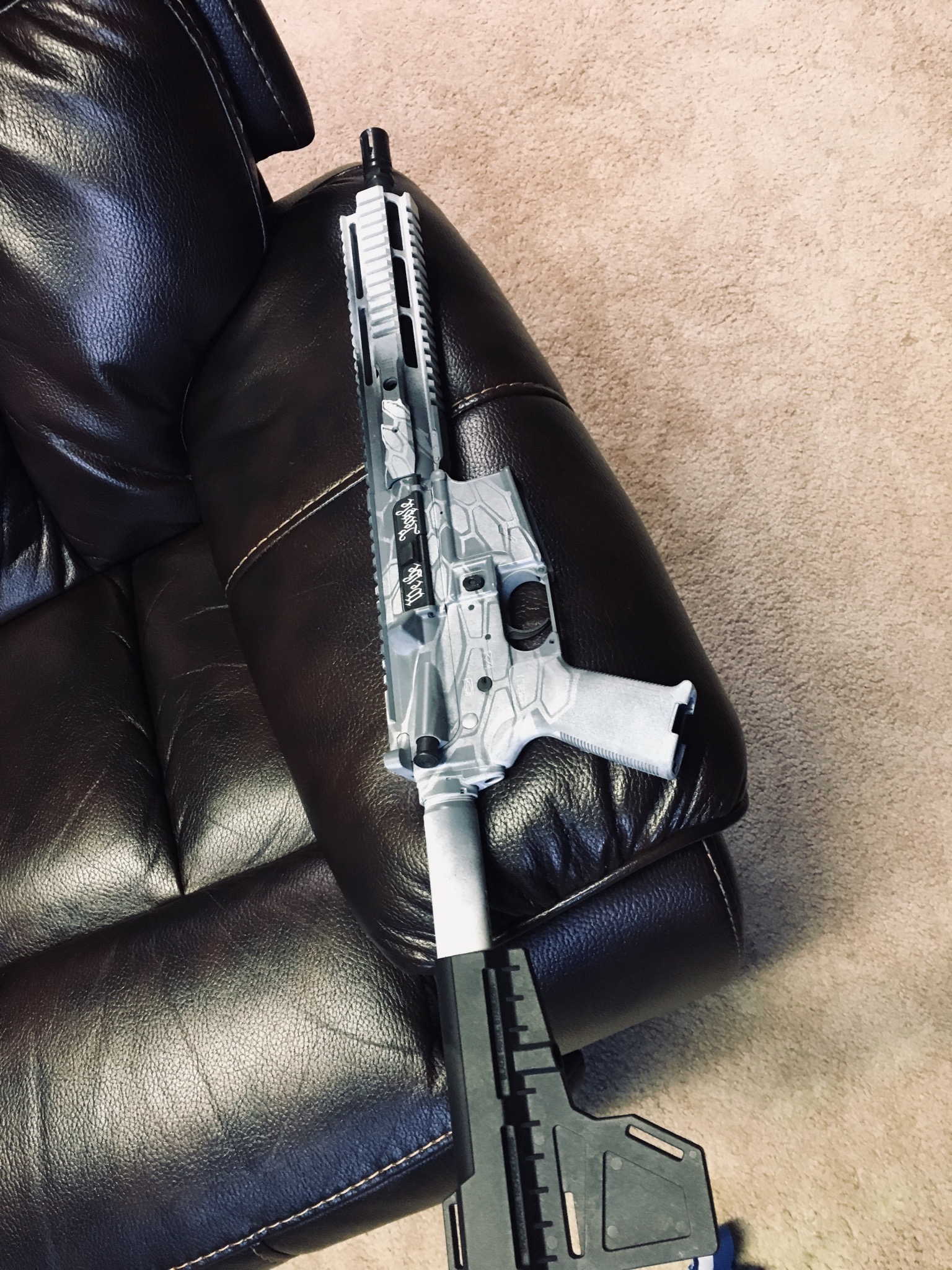

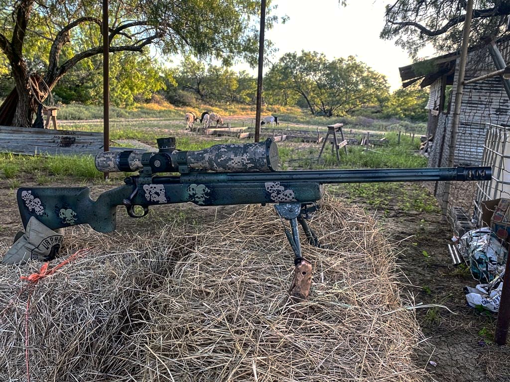

I was going to sponge my Bravo but switched gears and bought some stencils. I’m waiting for the rest of my Aervoe to show up but I’ve been trying similar colors on a junk wood stock. I’m thinking of increasing the amount of field drab vs. foliage green. Any suggestions?
Has anyone compared Krylon Fusion to Aervoe? I found out that both are Acrylic Enamels, so I’m trying to figure out if Fusion specifically is equal to Aervoe durability. I know regular Krylon isn’t close. The Aervoe Foliage Green is just too light for my 3rd color and I can get the Fusion Moss Green locally.

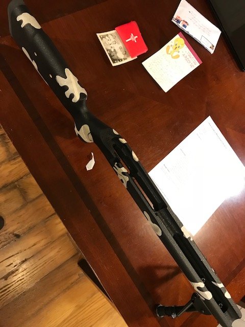

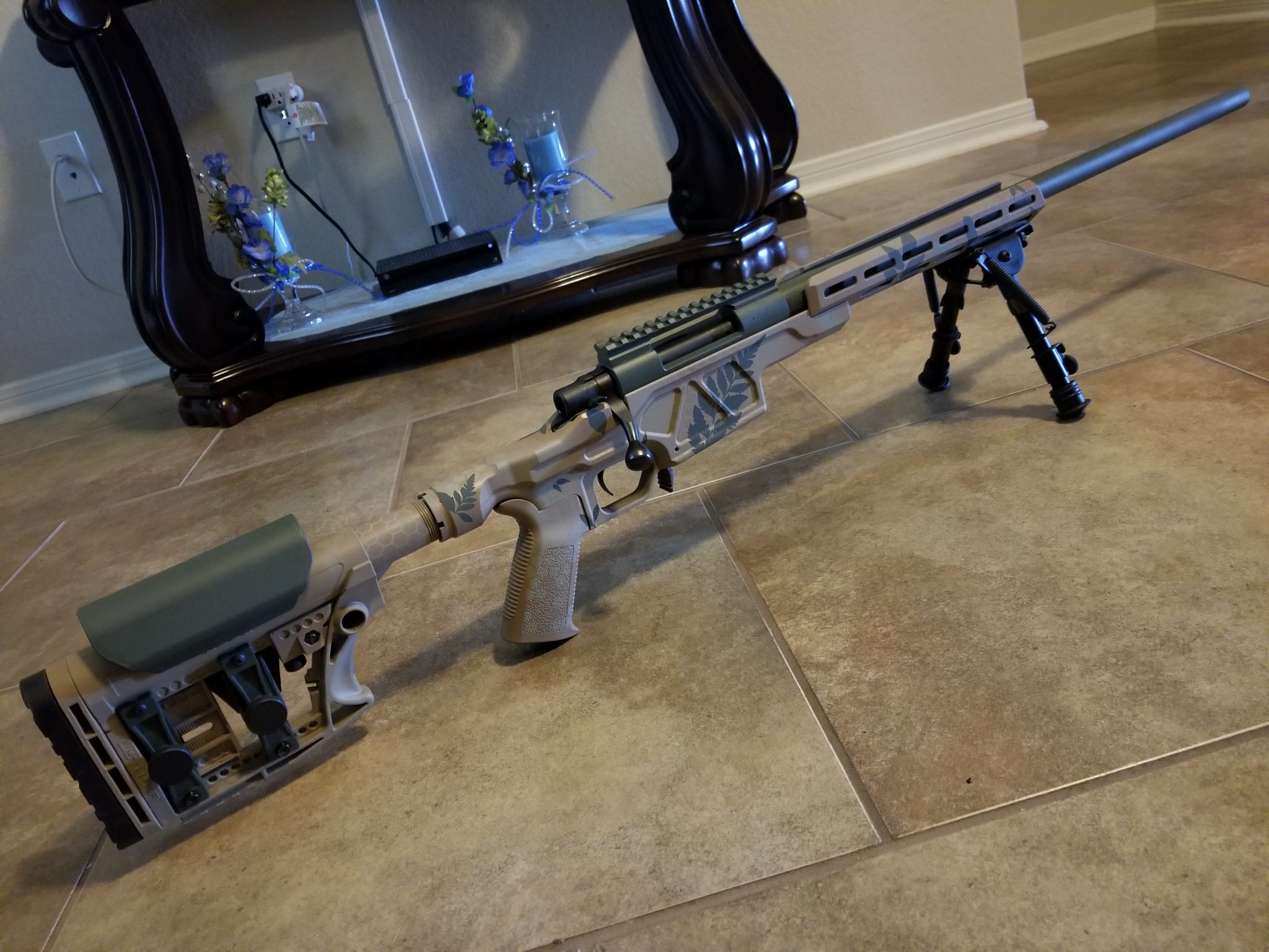

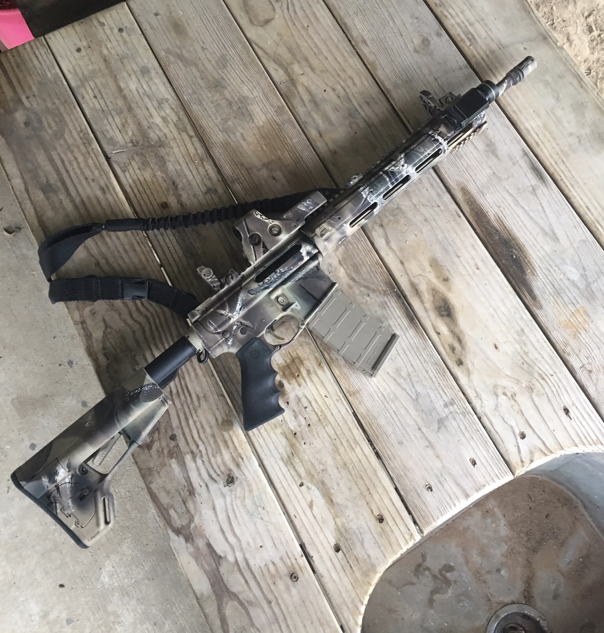

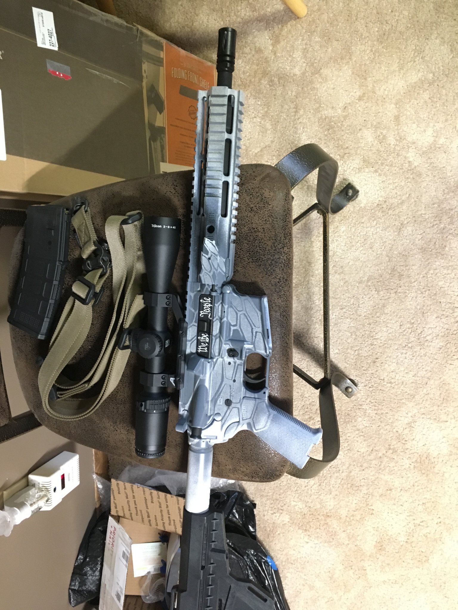

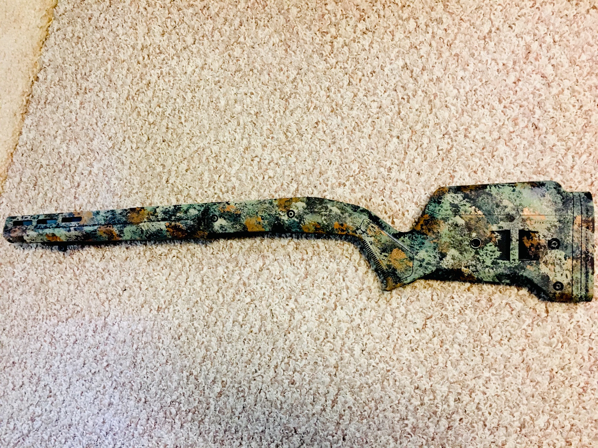

3rd try is the charm. I didn’t like my store bought stencils so I did the sponge camo. It looked too busy to me. I wanted a large contrasting pattern and I didn’t want the same old thing. I looked at a bunch of different camo jobs online and borrowed a few ideas then made my own stencils with Frog Tape. It still has an Aervoe base coat with Krylon Fusion (flat black and arctic grey) on top. When it fully cures I’ll take some 0000 steel wool to it and get rid of some overspray spots and smooth the ridges between colors. Then I’ll clear coat it with something and be done.

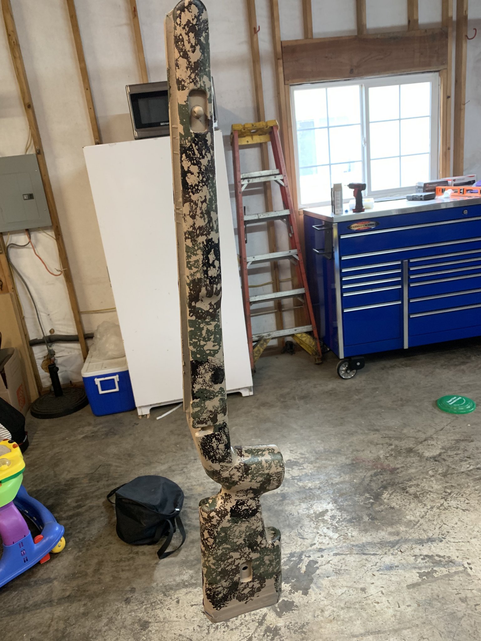

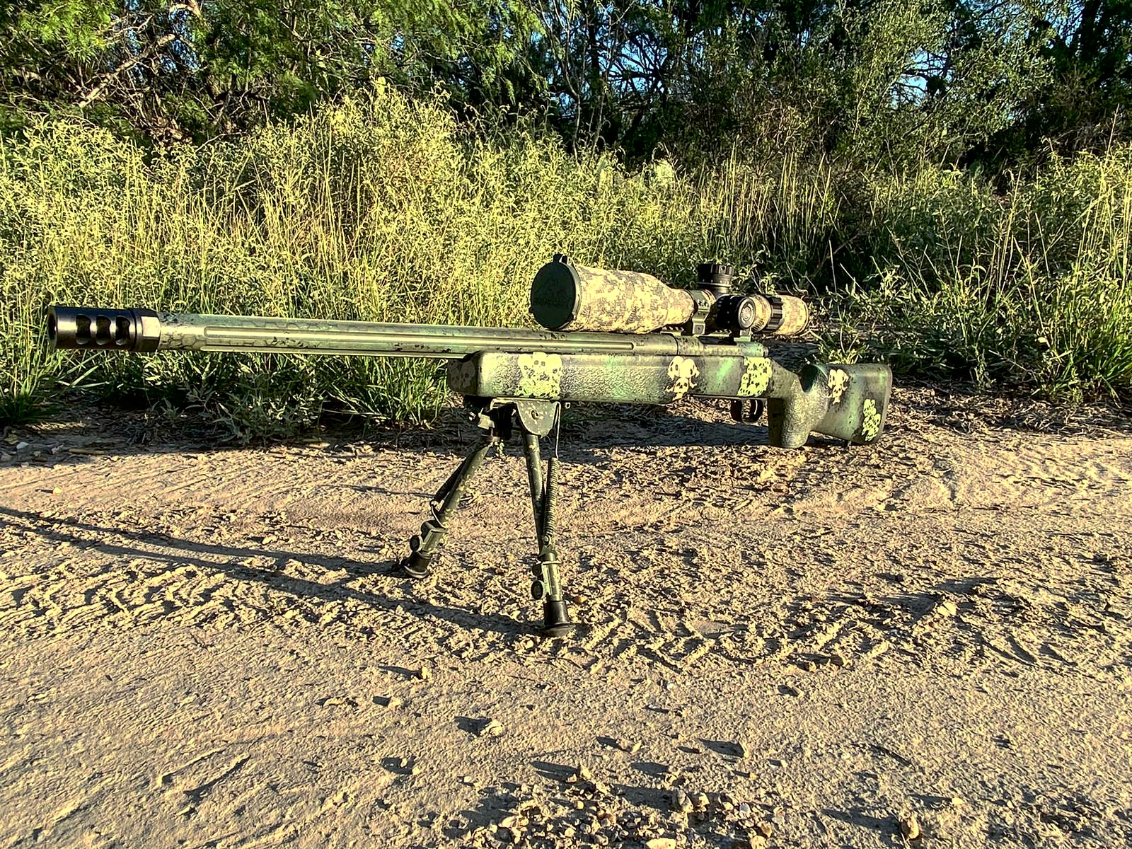

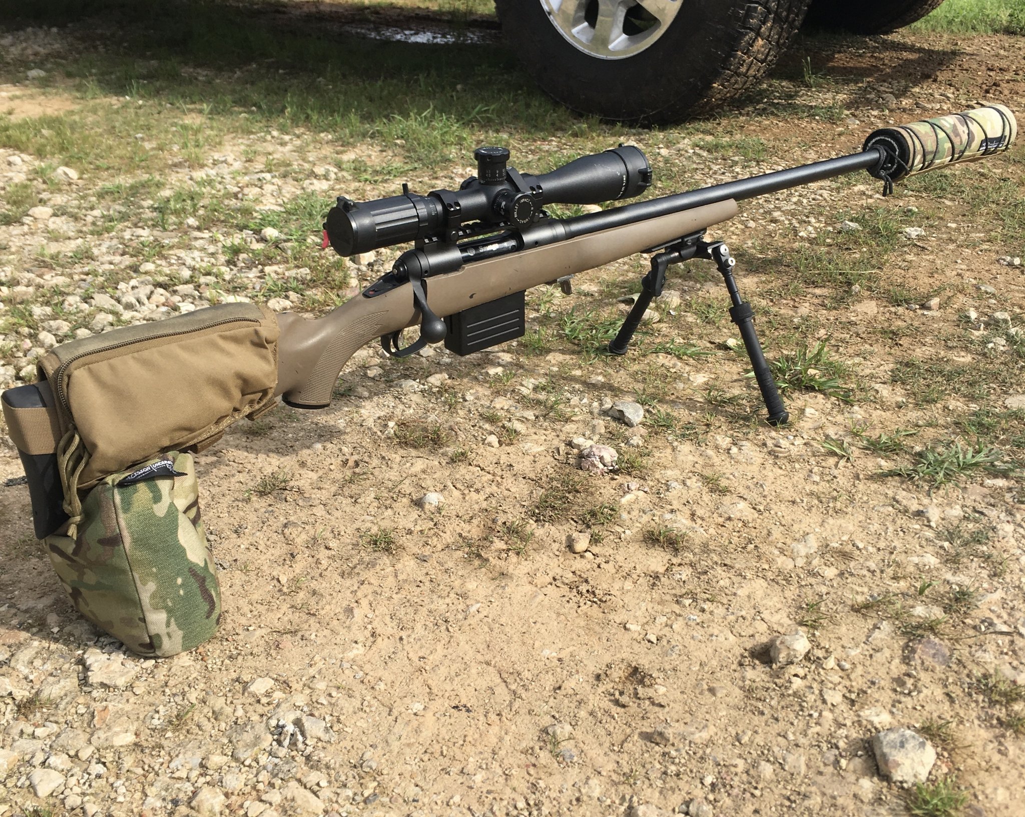

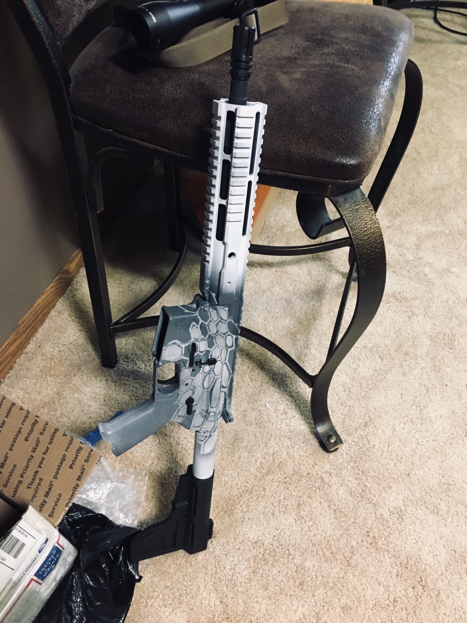

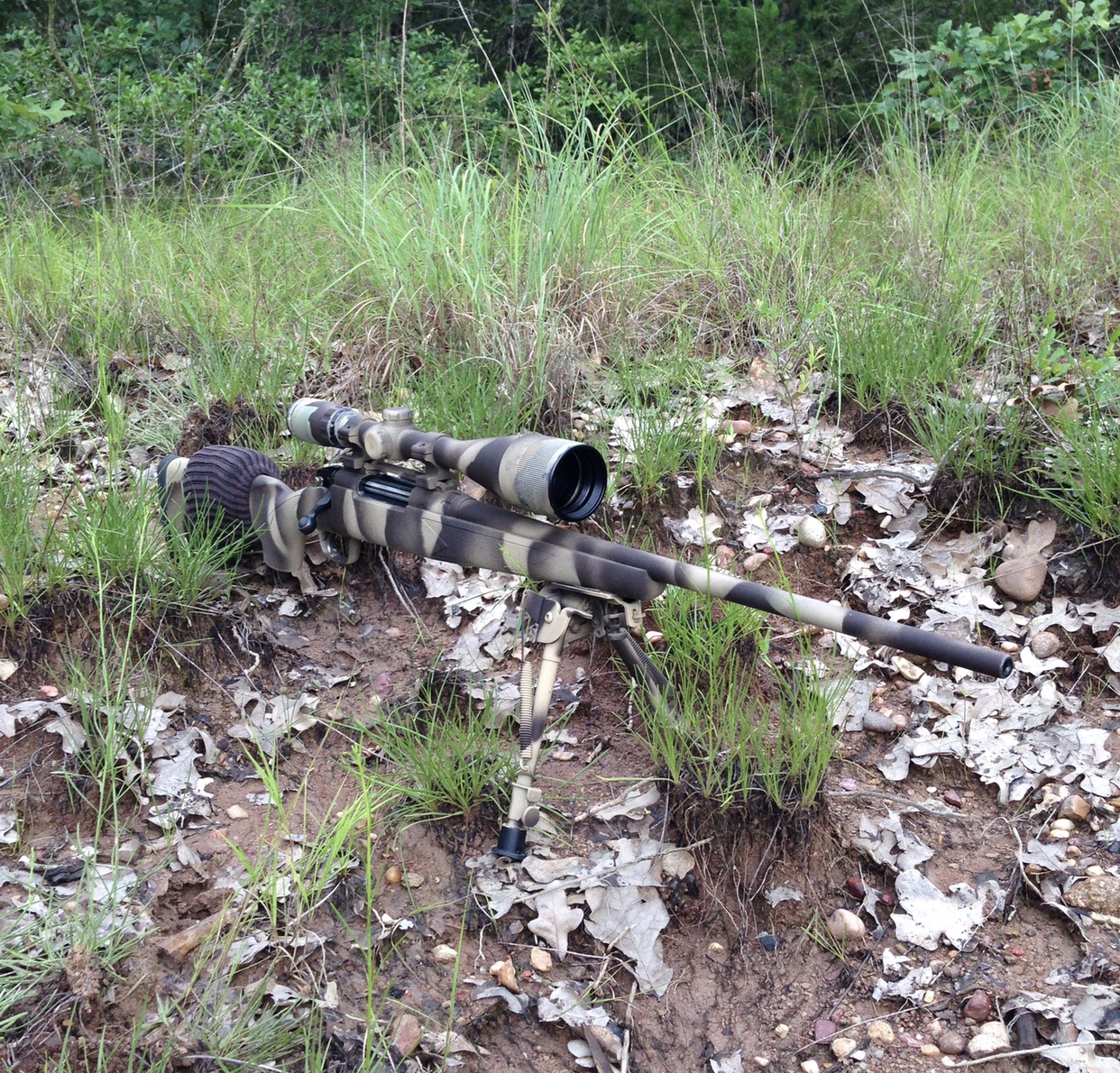

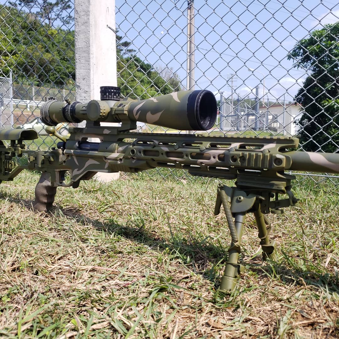

Y'all inspired me to send it on a rattle can paint job on my KRG bravo. Used rustoleum OD green and tan with a sea sponge. Finished it off with a matte clear coat. The polymer really takes well to the paint. All I did for prep was tape and degrease. Didn't feel like I needed to rough up anything.
