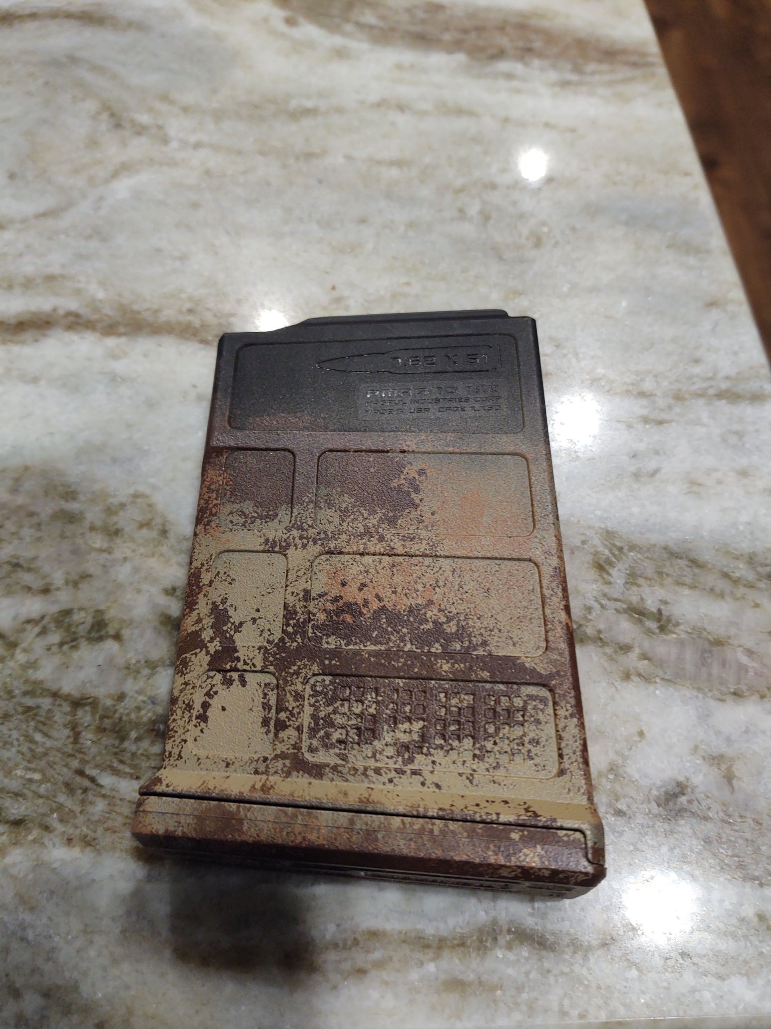

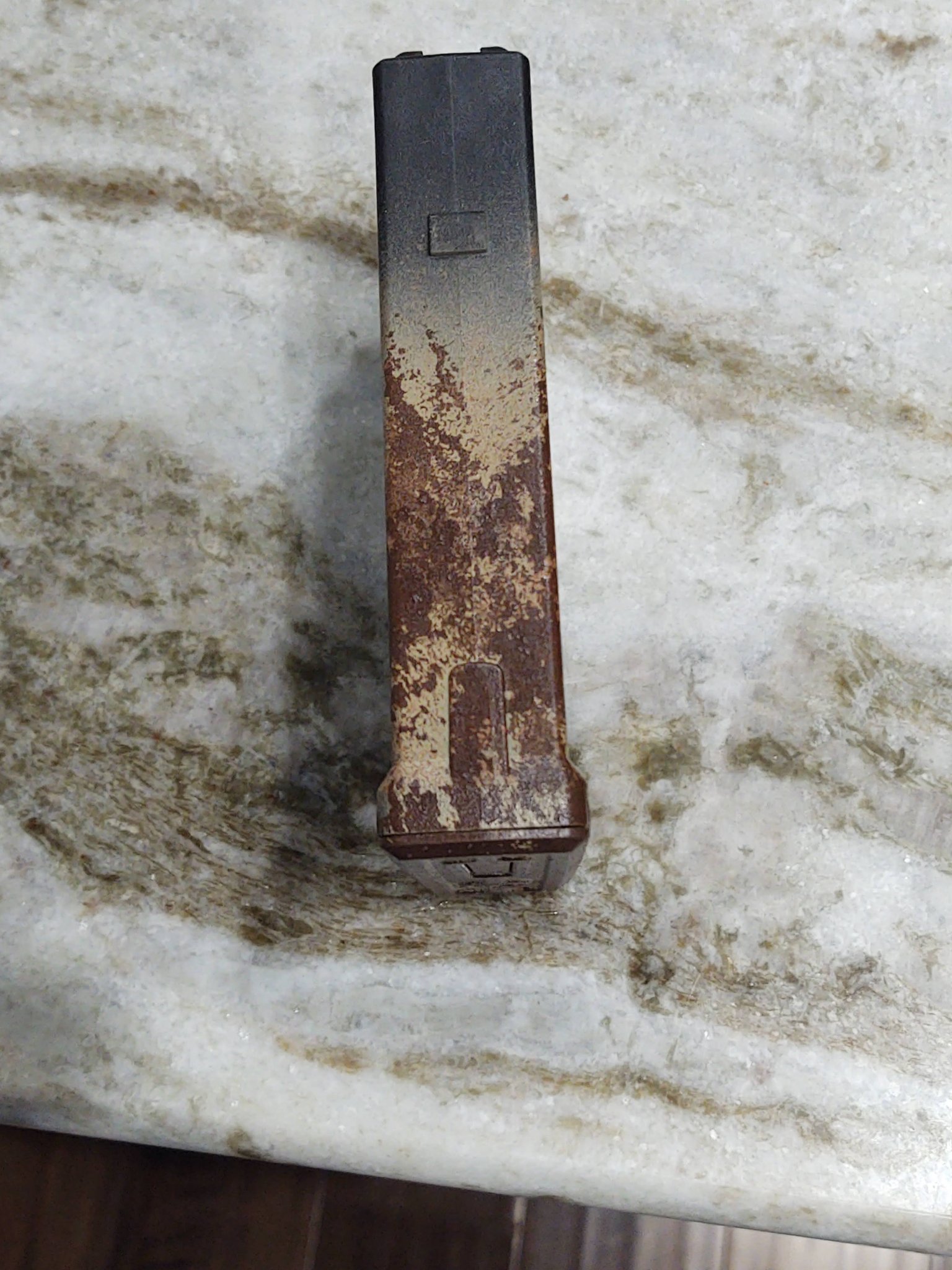

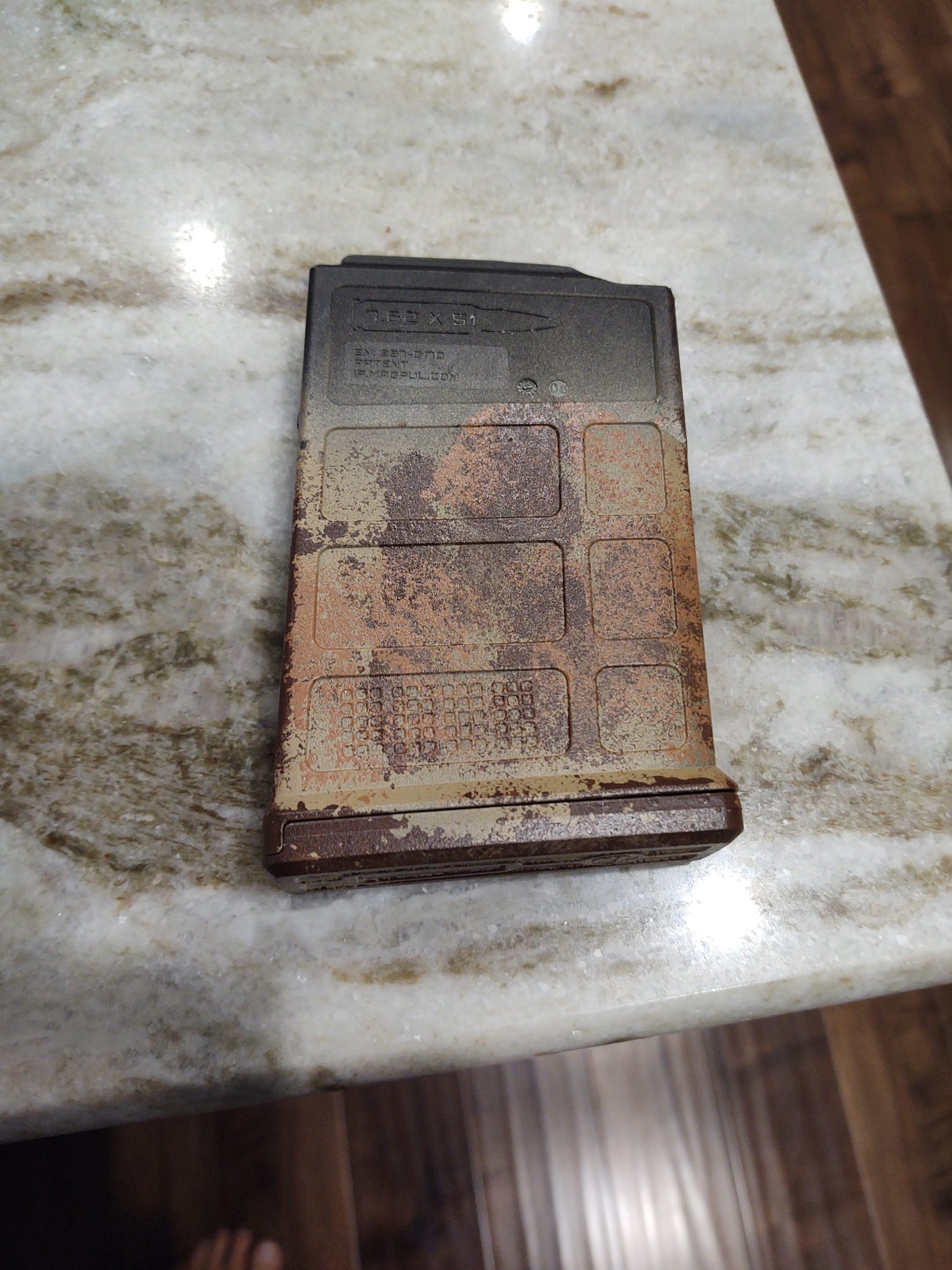

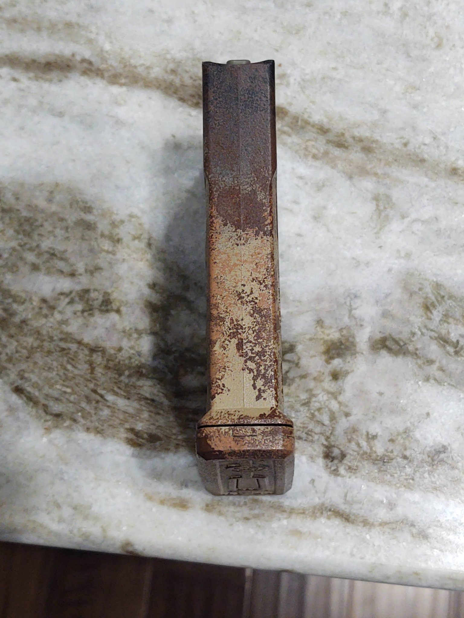

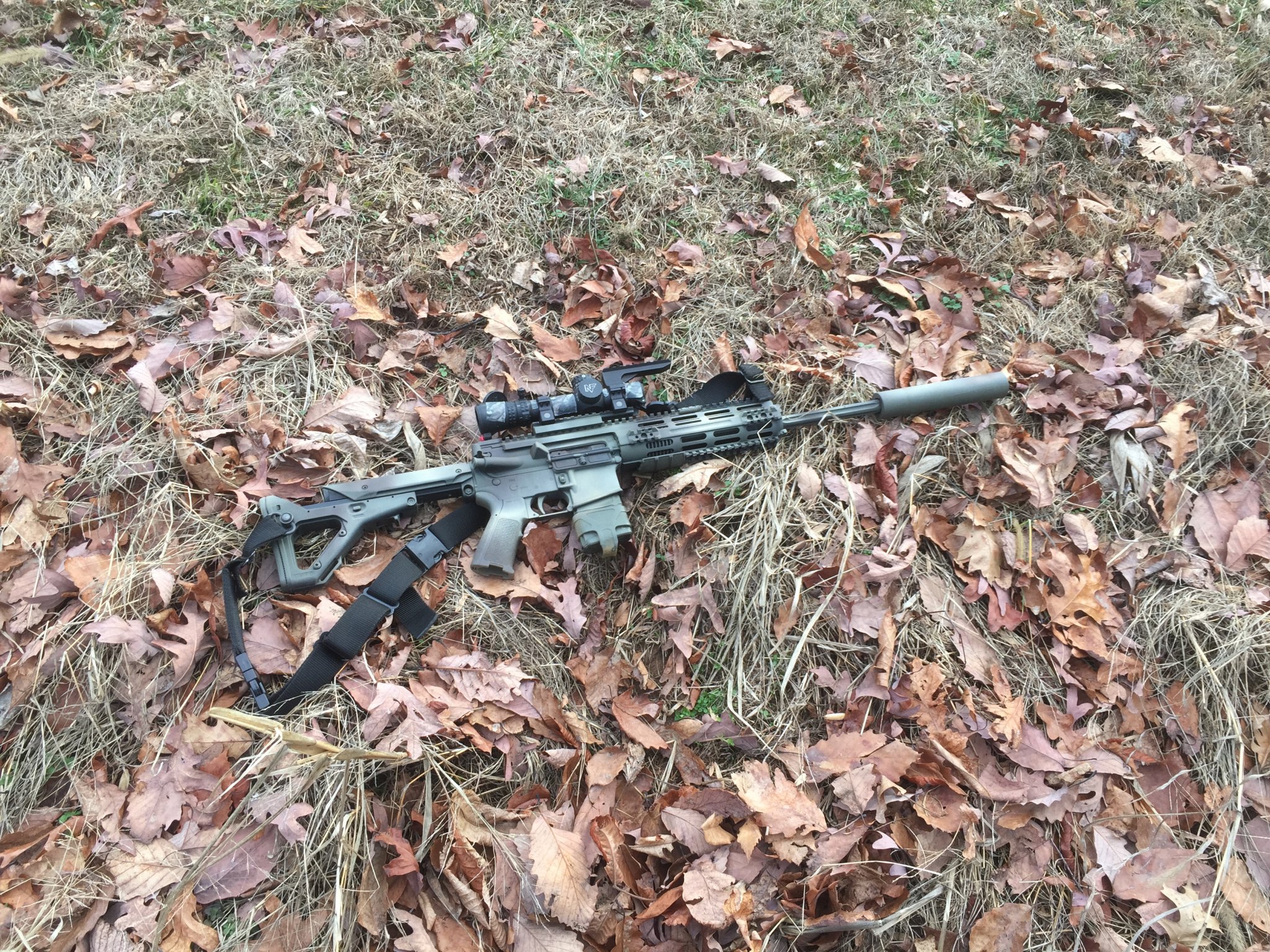

Decided that due to rain we would have a bit of an arts-n-crafts day. Ended up better than I had expected, might add some green to it. I'm learning that one needs to just stop trying to make it better when it's looking good. LOL I got more mags so maybe the next one I'll add in some green to it.
Sprayed the base color in a textured sand. Let it stand a bit. Then I just tore/sliced off chunks of sponge using some Adobe and Expresso colors. Sprayed the sponges....dab here....dab there....change colors.....boom done. I'll have to figure out a way to tamp down the sheen since it was a Satin paint.

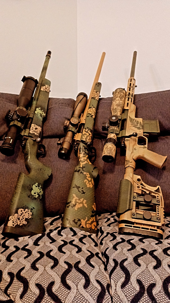

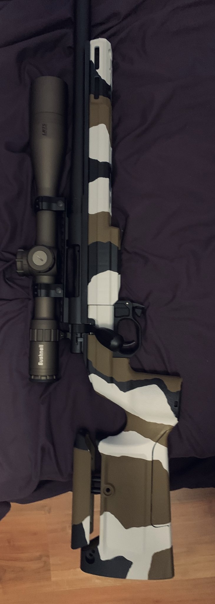

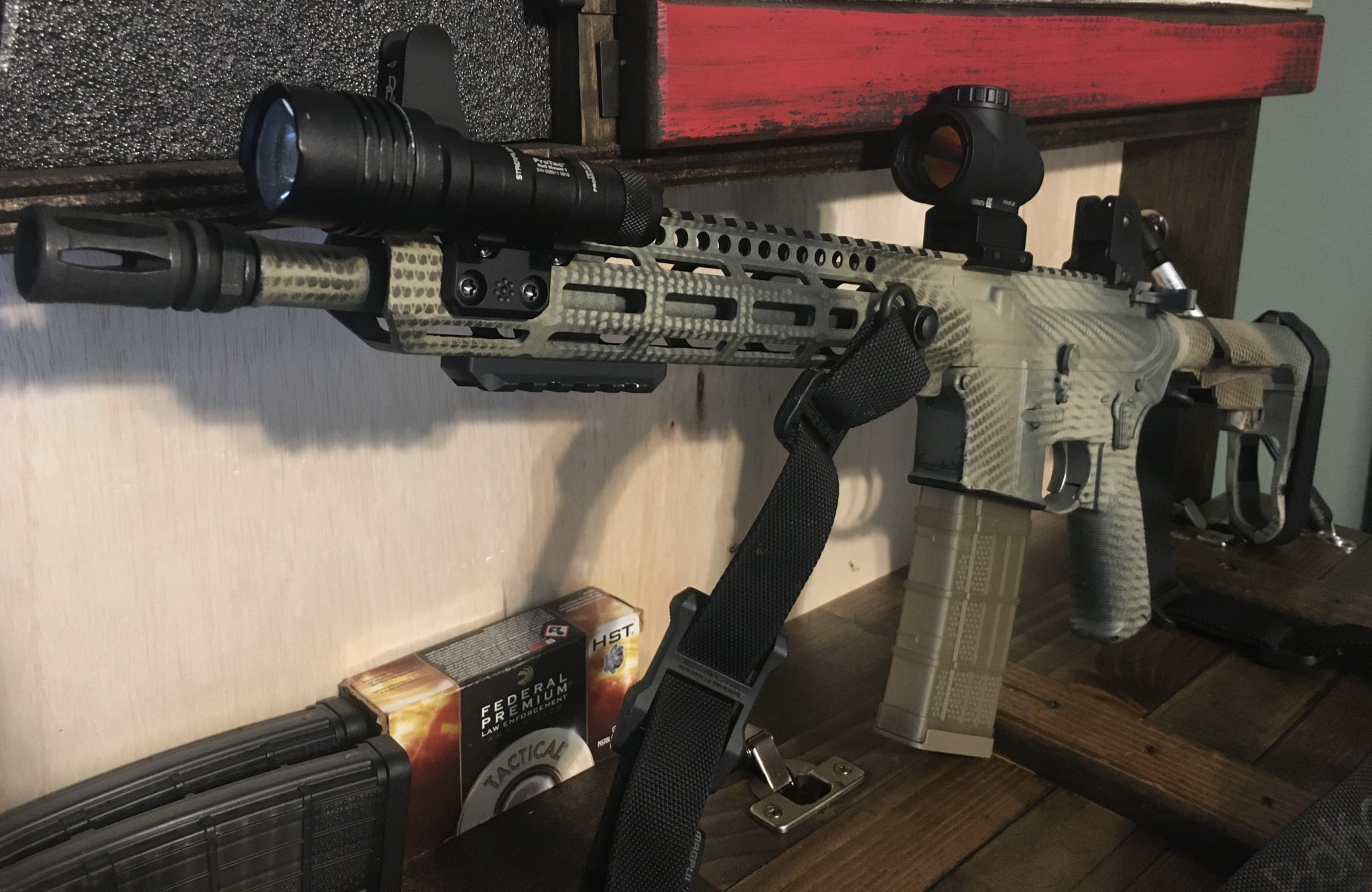

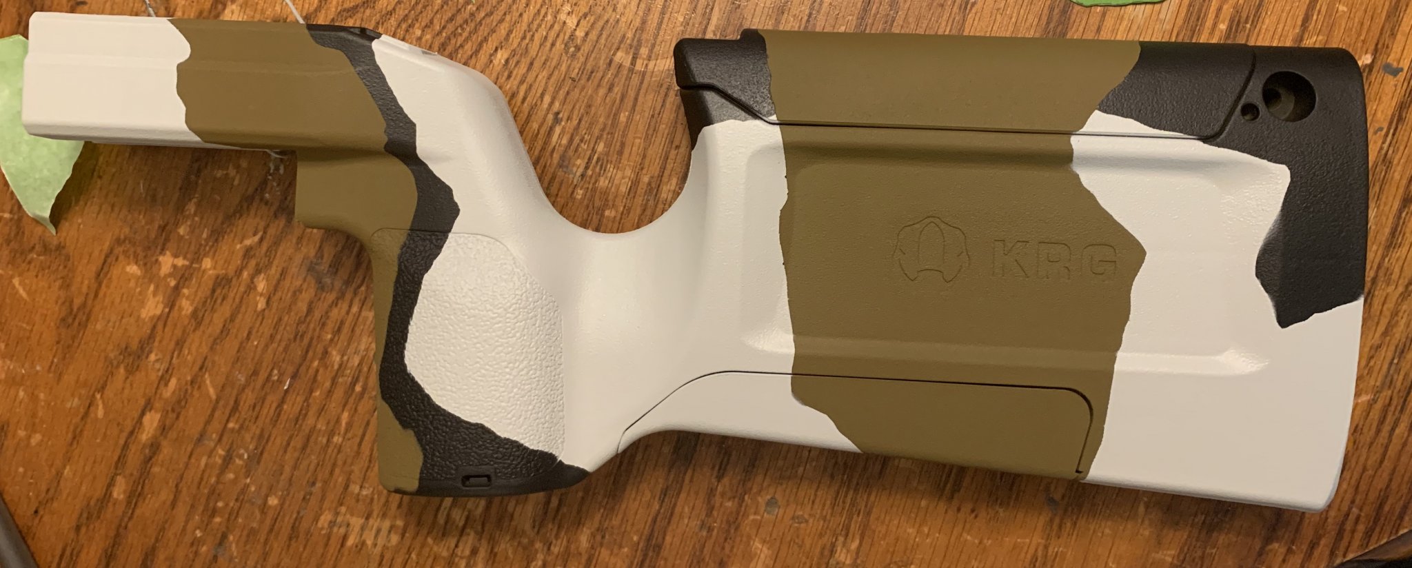

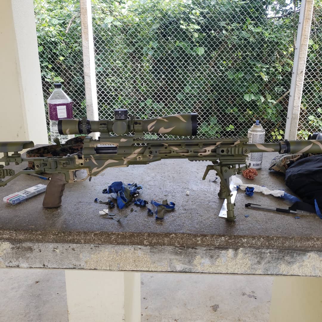

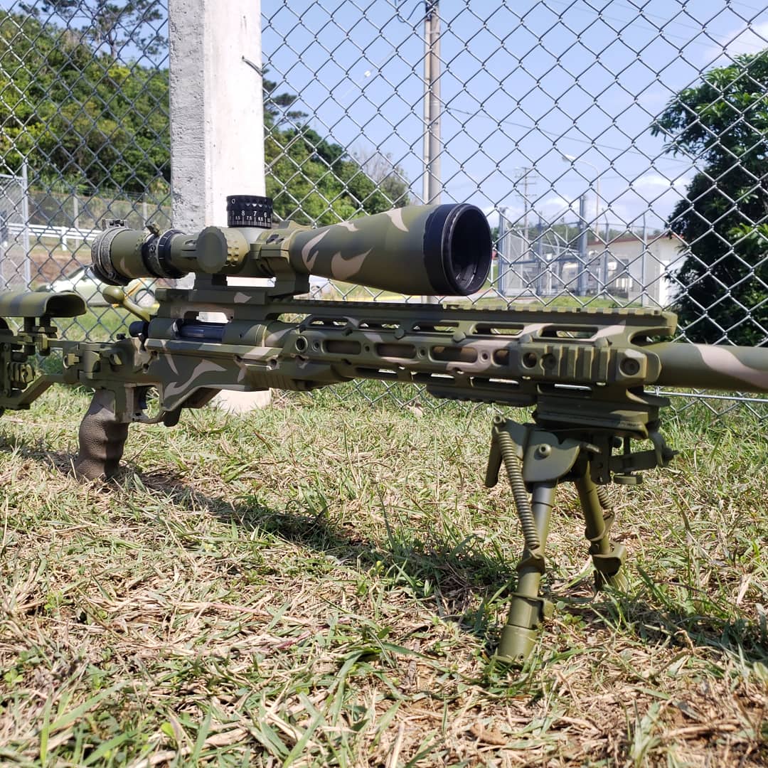

3rd try is the charm. I didn’t like my store bought stencils so I did the sponge camo. It looked too busy to me. I wanted a large contrasting pattern and I didn’t want the same old thing. I looked at a bunch of different camo jobs online and borrowed a few ideas then made my own stencils with Frog Tape. It still has an Aervoe base coat with Krylon Fusion (flat black and arctic grey) on top. When it fully cures I’ll take some 0000 steel wool to it and get rid of some overspray spots and smooth the ridges between colors. Then I’ll clear coat it with something and be done.
I dig this, any pics of it complete?

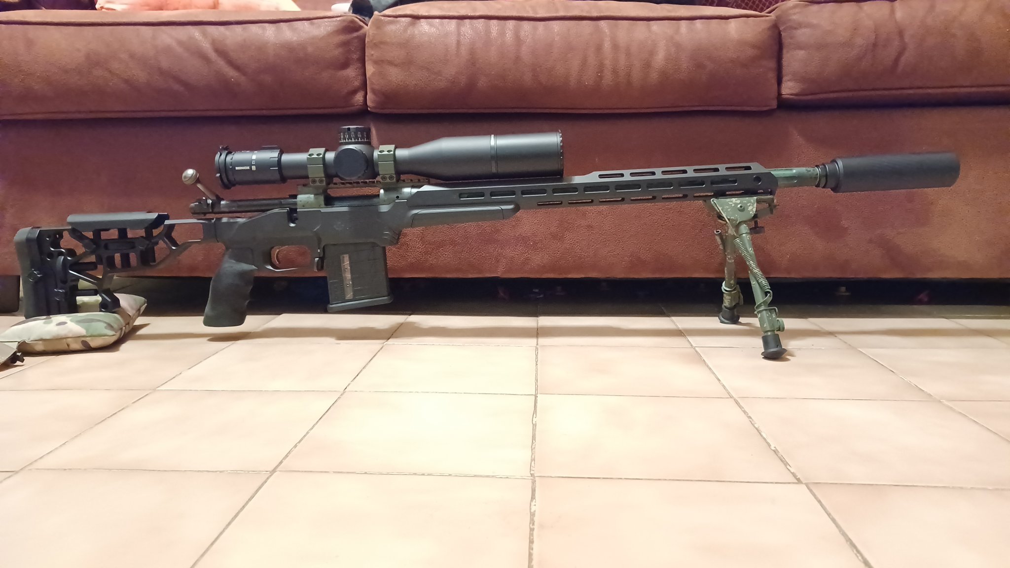

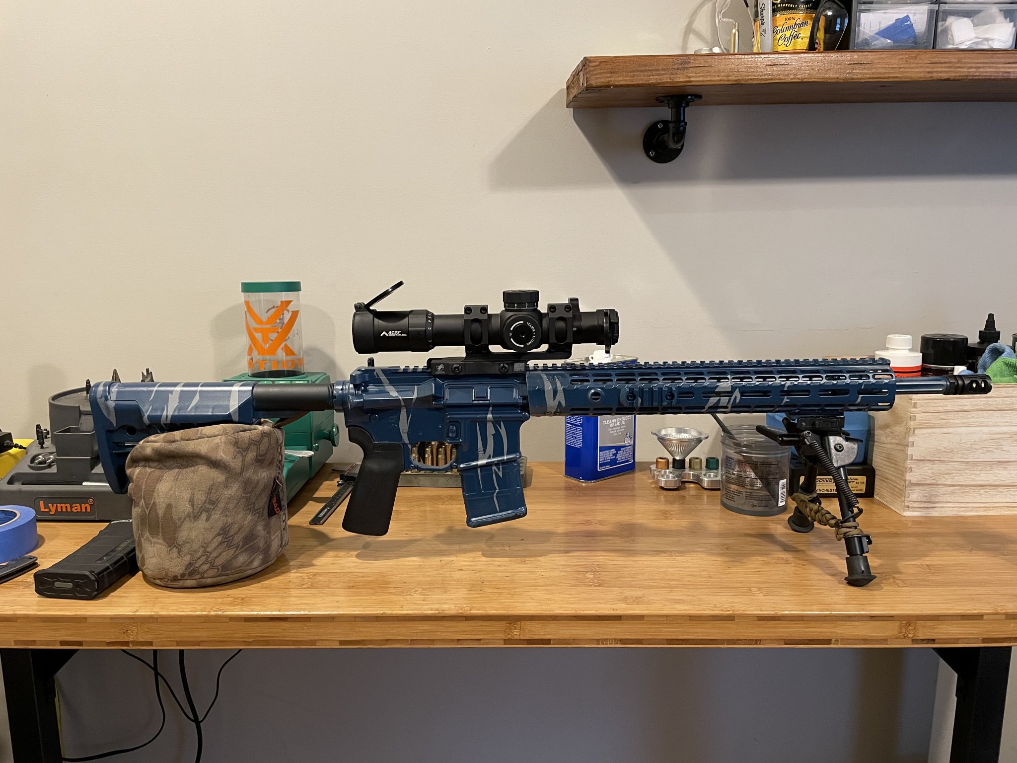

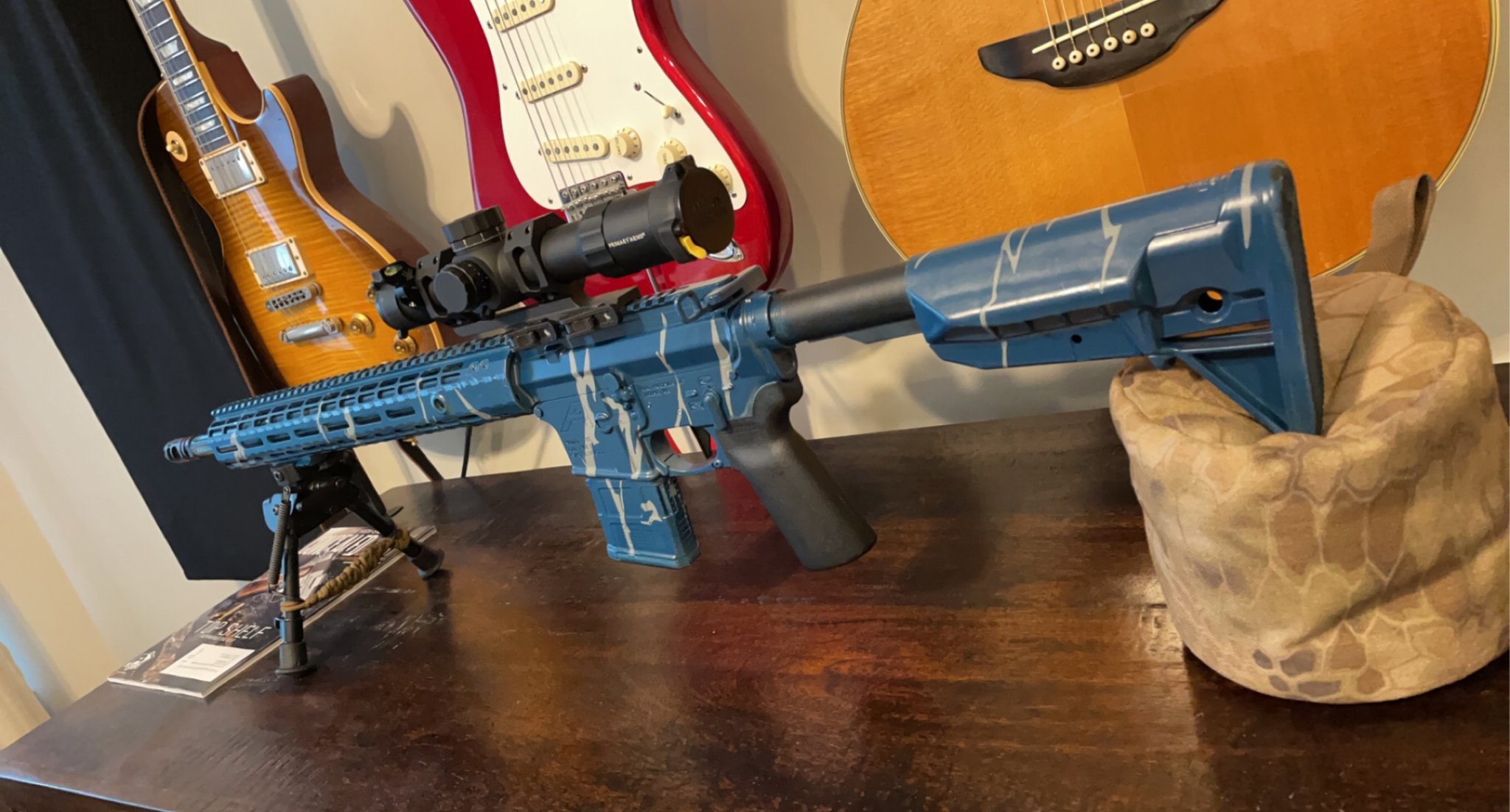

Rattlecan job on a couple ARs over Christmas/New-Years break. Just tape and Krylon. Not perfect paint jobs, but looks pretty sweet. Learned a lot the hard way, painting in 30 degree weather outside was not the best idea
