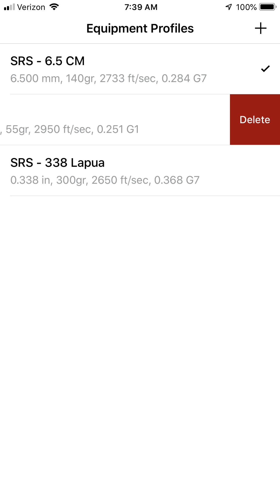

2.) Please provide means for equipment deletion. I have some duplicates that I believe are from syncing (the three hardest problems in computer science are off-by-one errors and caching). Could be user error, but in any case, I’d like to clean it up.

@christopher.dow just FYI - you can delete equipment profiles. From the selection screen, just swipe left to delete. See here:
If you’re seeing duplicates, it most likely occurred during migration from the old app. Luckily it’s pretty easy to get rid of the ones you don’t want.

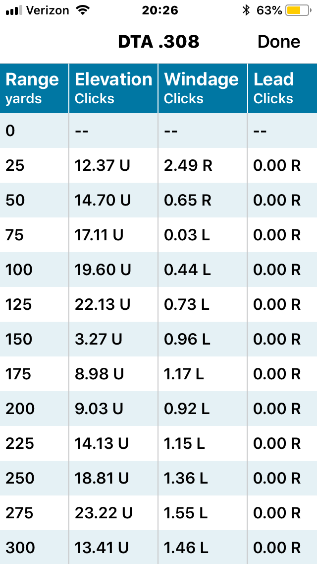

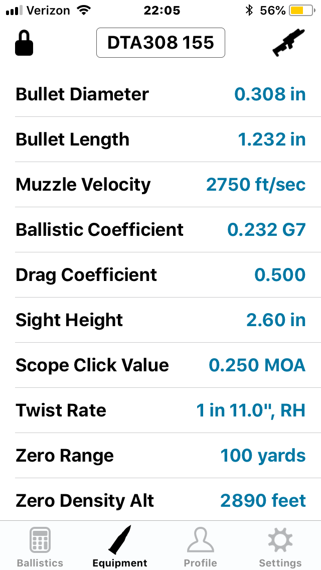

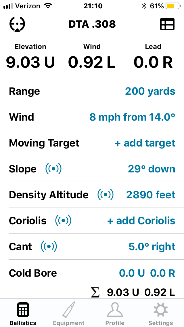

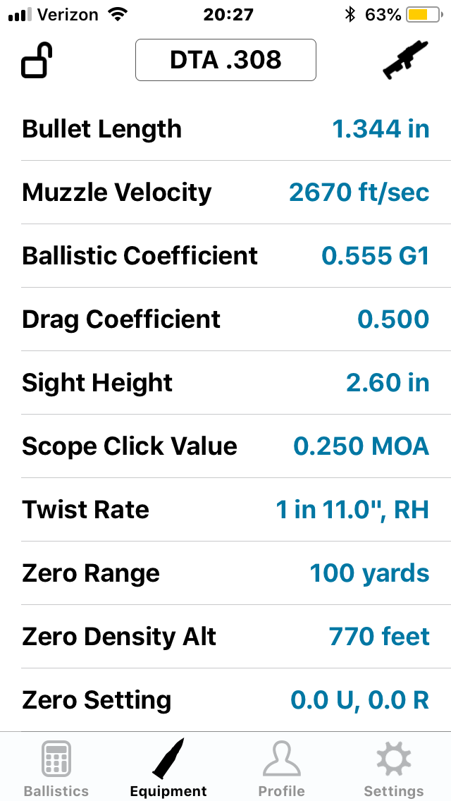

Im having problem. I paid for the full version but when I go to the heads up display it says I need to up grade. It also states Im in free trial version.
Here and thanks

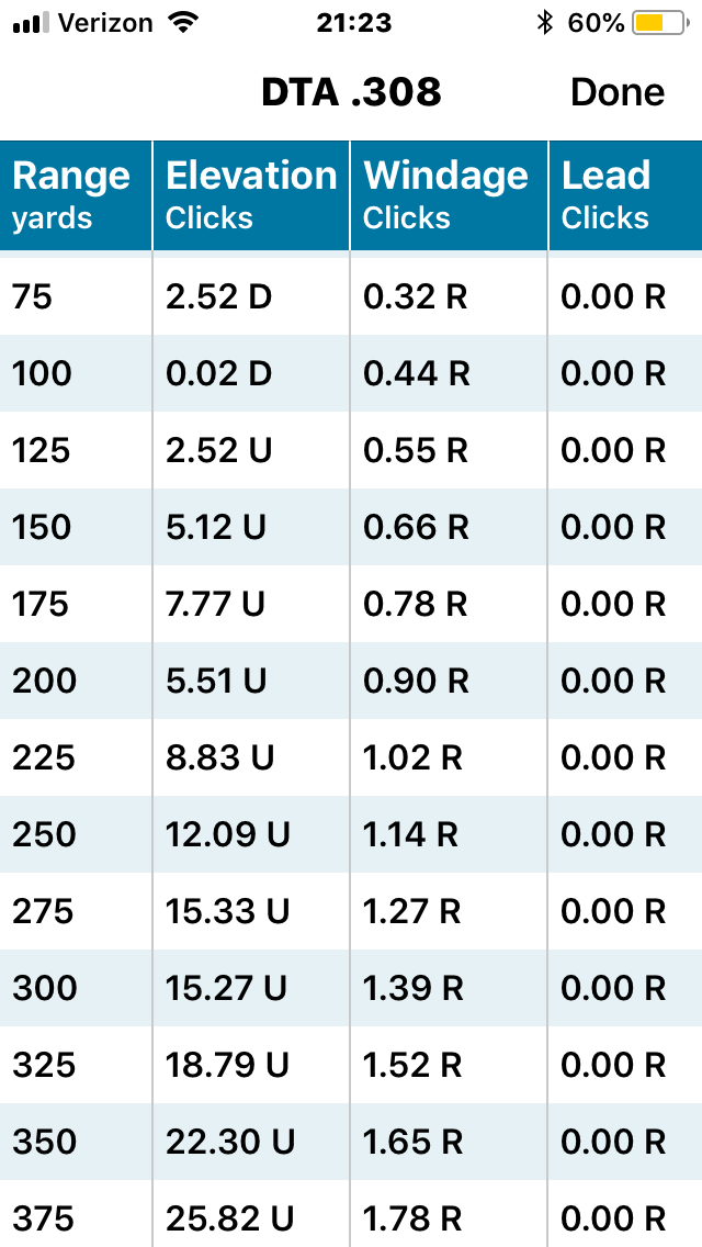

@cro789 It looks like your slope and cant are the culprits. Shooting 29 degrees downhill is pretty steep - it's effectively moving your zero from 100 to 150. Maybe it was accidental, so it's good to check those values before you shoot. Hope this helps!
@cro789 , what version of TRASOL are you using? Ver. 2.0.1 for iPhone?
What bullet weight and caliber are you using? I ask because I don’t see that in the picture you provided of your equipment screen.
Also, just to try to eliminate as many variables as possible, can you make the atmosphere on the ballistic screen match the atmo on your equipment screen and check your settings screen to make sure it makes sense.

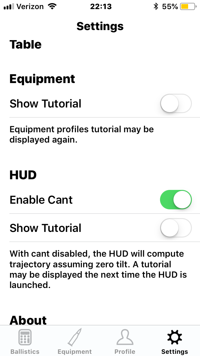

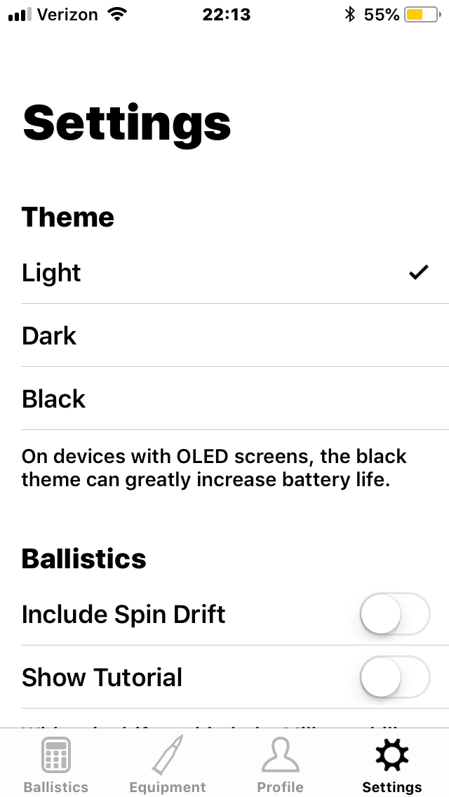

Is your Bullet Weight on equipment screen set to 155 grains? Make sure ‘grains’ is selected. I can’t see that value on your screenshot on my iPhone 7 Plus. Could be cause your screen is smaller on your phone and you can only see it when you scroll.

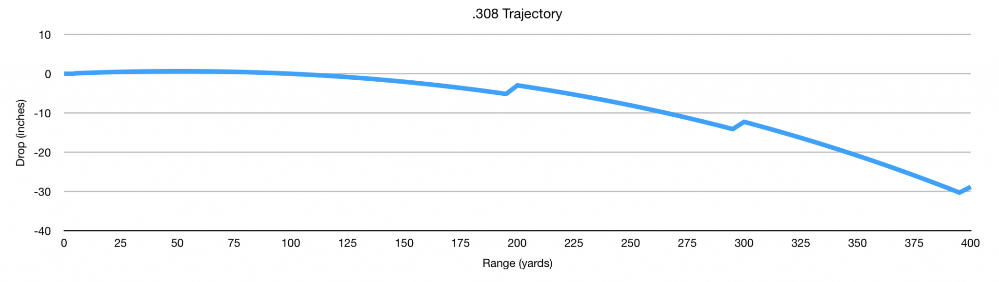

@cro789 your settings are fine, and the app is working as expected.
What you're seeing is an artifact of the underlying ballistics engine, where the trajectory periodically needs to be "adjusted" to account for the changing velocity throughout the bullet's flight. The theory is pretty heavy, but basically: your Ballistic Coefficient is dependent on velocity (most published values assume a specific set of conditions), and as the bullet slows the drag needs to be re-computed to account for the new velocity. In a perfect world this would happen at each time step (i.e. each yard), but this would be pretty compute-intensive, so instead the adjustments happen at predetermined intervals.
To help visualize this better, here's a graph of your specific bullet's trajectory, zoomed in to the interesting portion:
Here you can see 3 instances where the adjustment occurs, and the first "spike" explains the result you're seeing. This might seem undesirable, but keep this in mind: these spikes are relatively small (I adjusted to graph to exaggerate the detail), and the effects actually become less pronounced at longer ranges. At the distances most shooters are using TRASOL, the effects are completely negligible. The benefits to these adjustments, however, are significant.
Hope this helps.

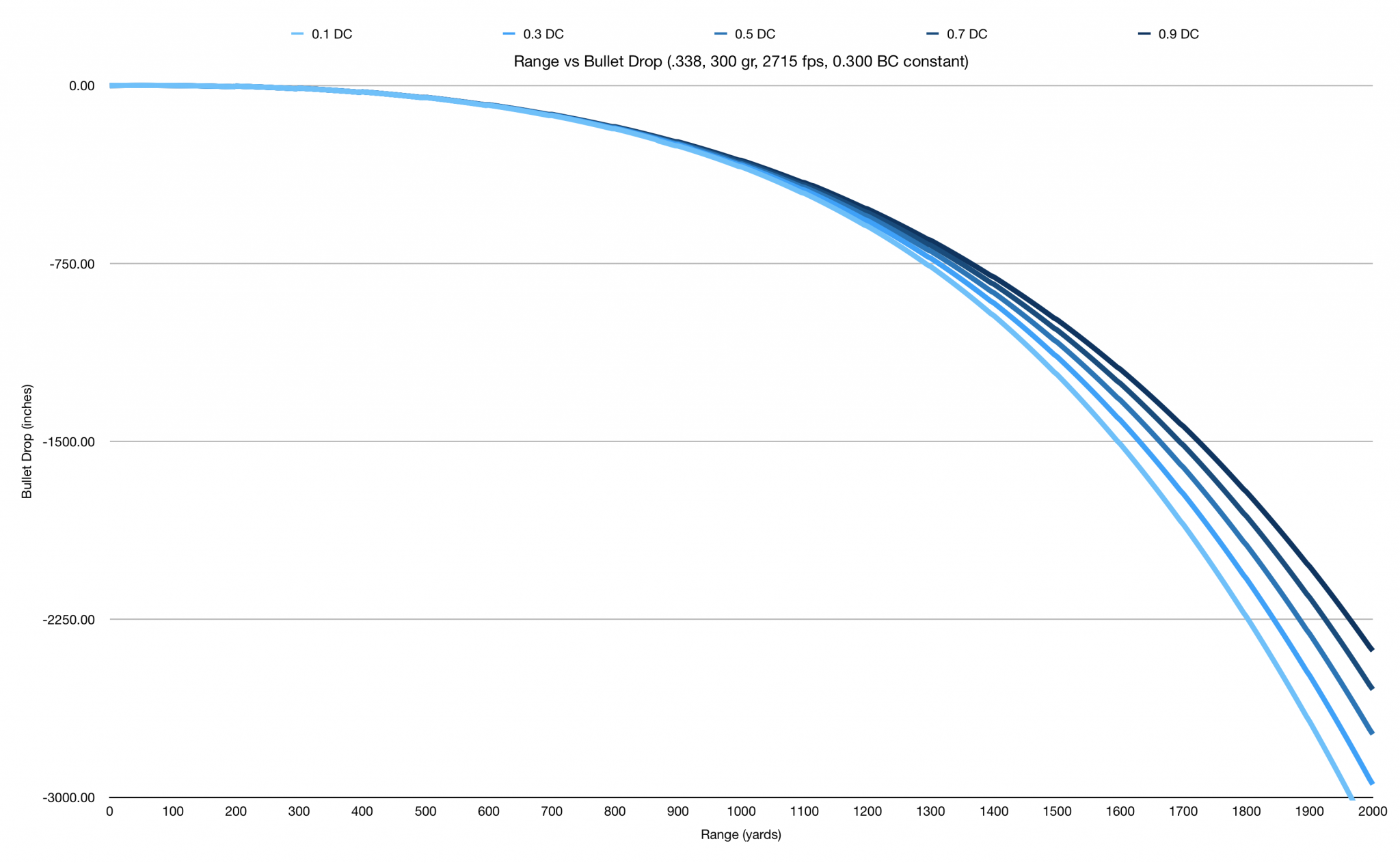

Although the mechanisms are different (and the math is fairly complicated), the ultimate effect of adjusting Ballistic Coefficient vs Drag Coefficient is very similar. Take these two examples for a .338 projectile:
In the first graph, the Ballistic Coefficient is kept at 0.300, and the Drag Coefficient is adjusted from 0.1 to 0.9. The full trajectory from 0 to 2000 yds is recomputed for each DC value:

Keep in mind that this isn't a perfect comparison, because the spread of the BC/DC values are different. If I had computed the drag coefficient on intervals of 0.15 (instead of 0.2), the graphs would probably look nearly identical.
I've run quite a few simulations, and have seen no evidence that BC vs DC adjustments produce significantly different curve shapes. Instead, I see Drag Coefficient as more of a "finer" Ballistic Coefficient; i.e. a change of 0.150 DC is roughly equivalent to a change of 0.010 BC (depending on other variables).
I'm happy to run more simulations if there's a specific set of parameters you want to test.

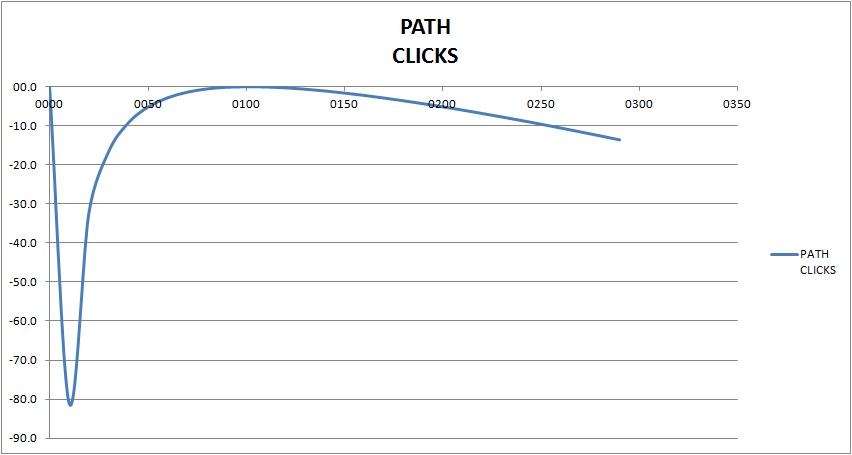

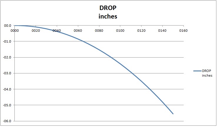

I tried out the same data plus many others from my saved tracks on CB Desktop and Drop in inches or clicks showed no bumps or spikes whatsoever. I don't know how the engine works in either Trasol or CB, just pointing out my findings FWIW
