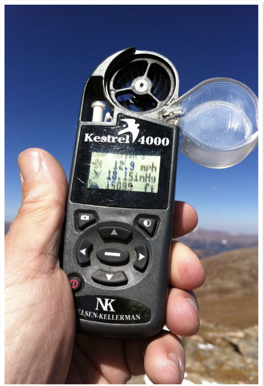

I think @Skookum does like what I thought must if us do. We look at our Station Pressure, temp maybe even guess the humidity and enter that into our solvers. This info may come from a watch or even a wheather meter.
You can do that nicely on TRASOL, but the little selector wheel stops dead at 25inHg. That gets you to the high desert in Colorado or Nevada where I shoot and some foothills. But as he pointed out, not in the Mountains, not in the Northern Plains like Laramie Whyoming or even Lake Tahoe basin.
In all honesty, 1,000 feet between the basin of Tahoe and 25 absolute is not a deal braker, but for some sites it sure is.

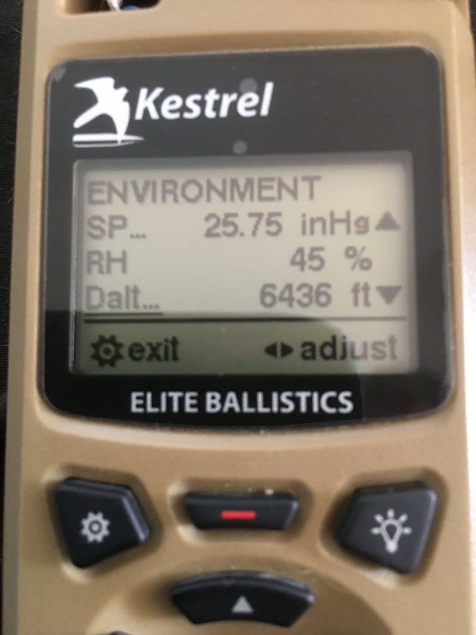

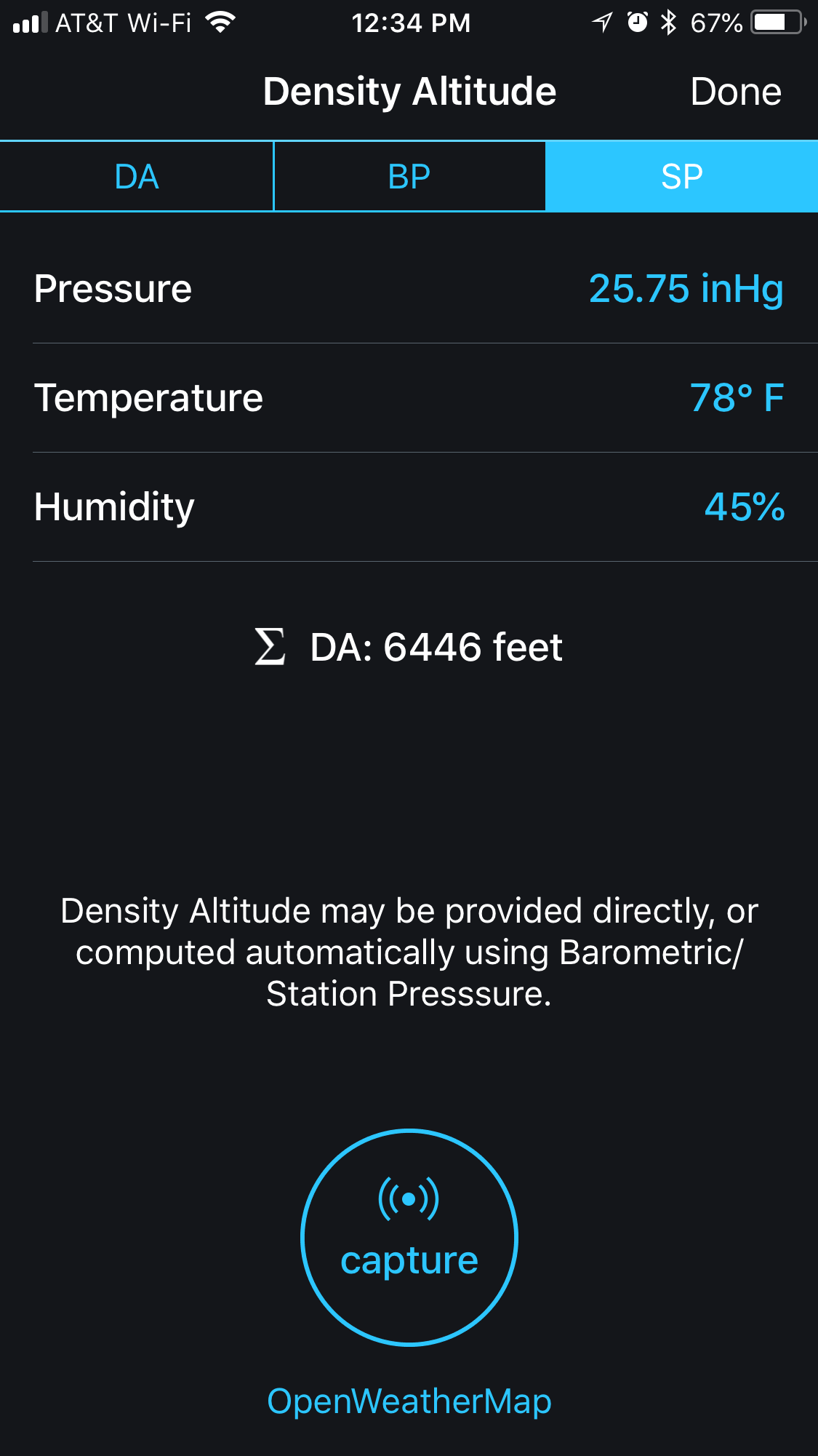

Im in west desert of Utah and TRASOL is again effing up and wasting lots of time and ammo for me
The BP is 25.75 in Hg the temp is 78 degrees and TRASOL says the DA is 11,000 feet. Thats almost double the true DA. Doesnt matyer if i capture the weather data or enter my own it gives that reault
AB gives the true value.

Perhaps you are using the "BP" tab rather than the "SP" tab? "SP" is for entering station pressure (absolute pressure). The "BP" function is for inputting barometric pressure which has ALREADY been adjusted for altitude.
No, because if that were the case, the DA would be too low not too high. I don't know what it was doing, but it was f%^&ing up, and I have lost confidence in the App because it has been treated like a stepchild for far too long. And I will wager that the newest guy trying to fix it won't last a year working there, for the well known reasons nobody can work for more than a year there. :)
You have that exactly backwards, if you are using the BP button and inputting station pressure, it will read a higher DA than actual. Unless of course, you are at sea level where BP and SP are the same thing.
When I put in all your numbers and use the SP button, I get 6446 ft. DA. When I leave everything identical and toggle over to the BP button, I get 10,956 ft. DA.

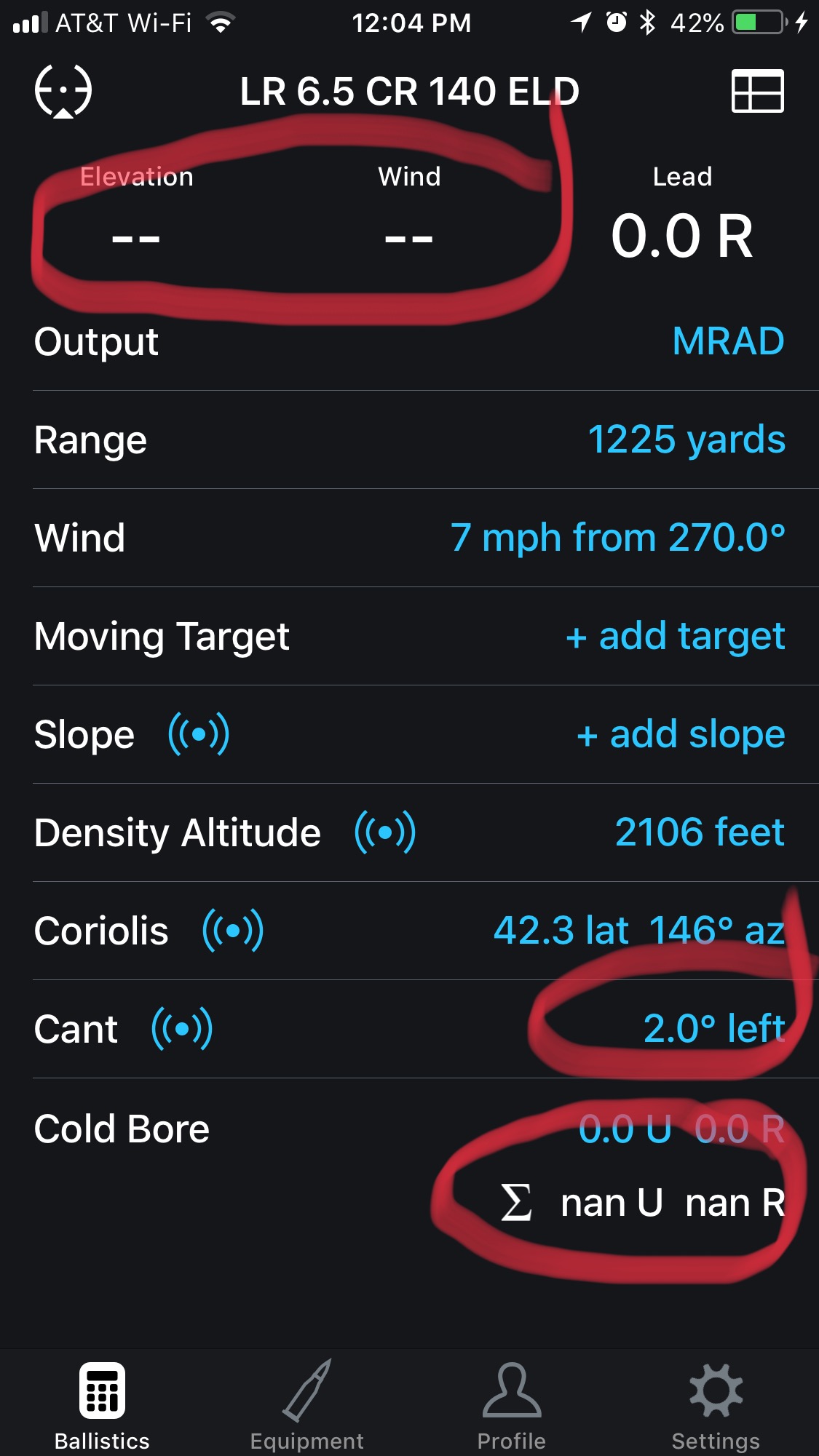

@Kobyashi72 @rover308 you're right - it looks like this happens when a provide a positive value for Zero Setting, and a nonzero cant. We'll have to take a look and see what's going on. Thanks for pointing it out!

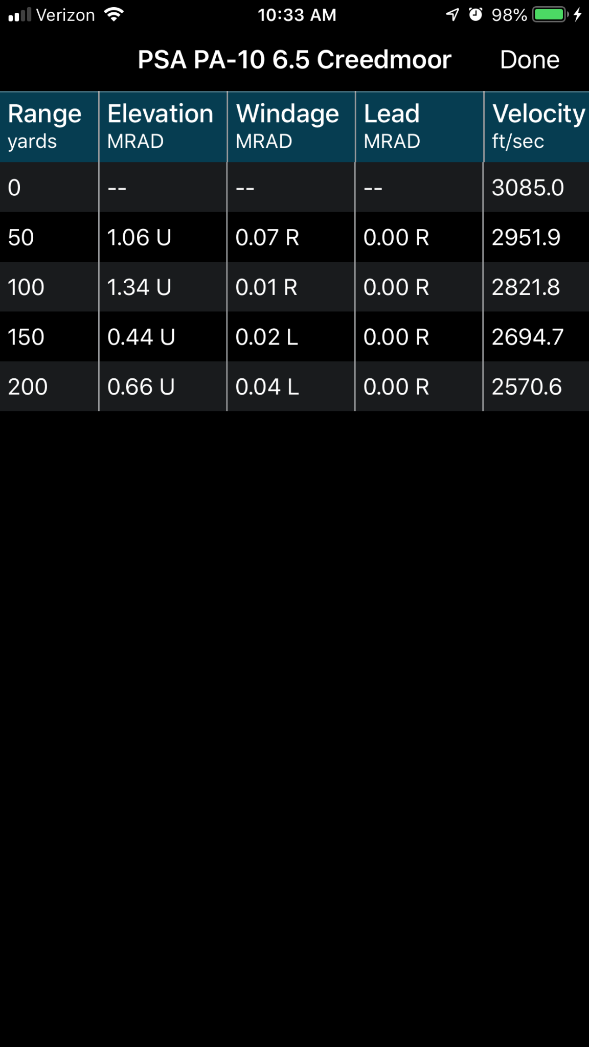

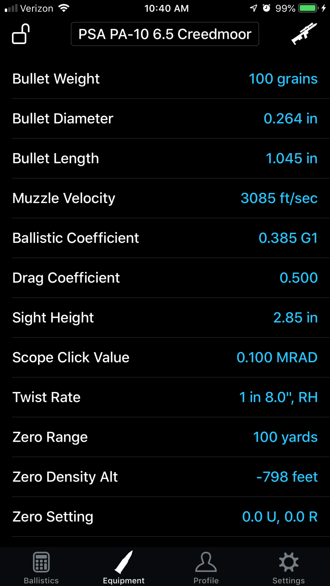

Yes on the sight height. As for the Density Altitude, I'm not sure. I used the "capture" button next to the Density Altitude text in the app, and that's what it gave me.
Your zero range is certainly at 100 yards. It might be s glitch. Go to your altitude menu and input your station pressure manually using the "SP" button and see what it tells you.
In other words make sure your zero altitude and your firing solution altitude are the same.
