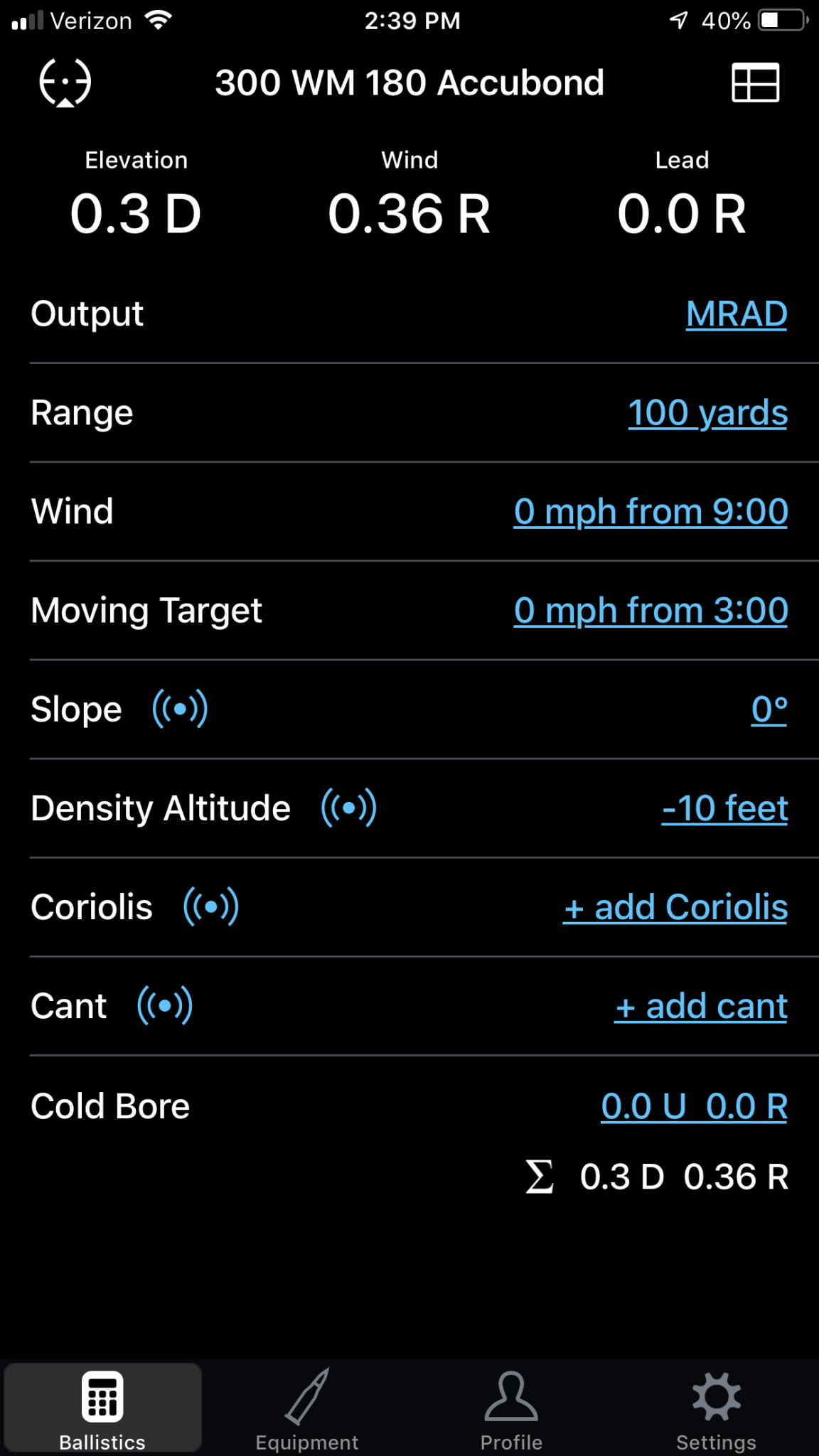

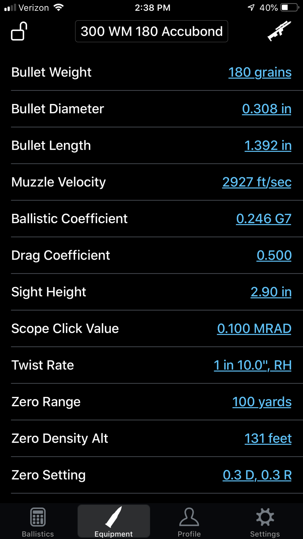

Has anyone run into this problem....
I put my 100 yard zero in as follows (1st pic) and went to ballistics and predicted a different windage turret at 100 yards with no wind (2nd pic). The difference is 0.06, just curious why it is different.

@Hundley - What am I doing wrong? Is the TRASOL Scope Click Value entry on the Equipment screen active/enabled? It appears to have no effect on elevation calculation on Ballistic screen whenever it is changed.
For instance, the Ballistics screen shows 10.36 U elevation at 1000 meters for my rifle/bullet combo. Scope click values are 0.100 MRAD on the turret.
Next, I select the Equipment screen and choose the "Scope Click Value" field which brings up the "Scope Clicks" dialog screen. I then enter the "Actual Value" determined as the correction factor for my scope and select "Done" - I leave the "Published Value" as 0.100 MRAD and change the "Actual Value" to 0.103 MRAD. I would expect the Ballistic screen to show a different elevation correction at 1000 meters than the 10.36 U correction previously shown when the "Scope Click Value" was set at 0.100 MRAD. In fact, I see no change whatsoever on the come up correction regardless of the input value entered on the "Scope Clicks" screen. I tried changing the "Actual Value" to 0.120 MRAD and it still had no effect. The Ballistic screen always displayed 10.36 U for elevation.

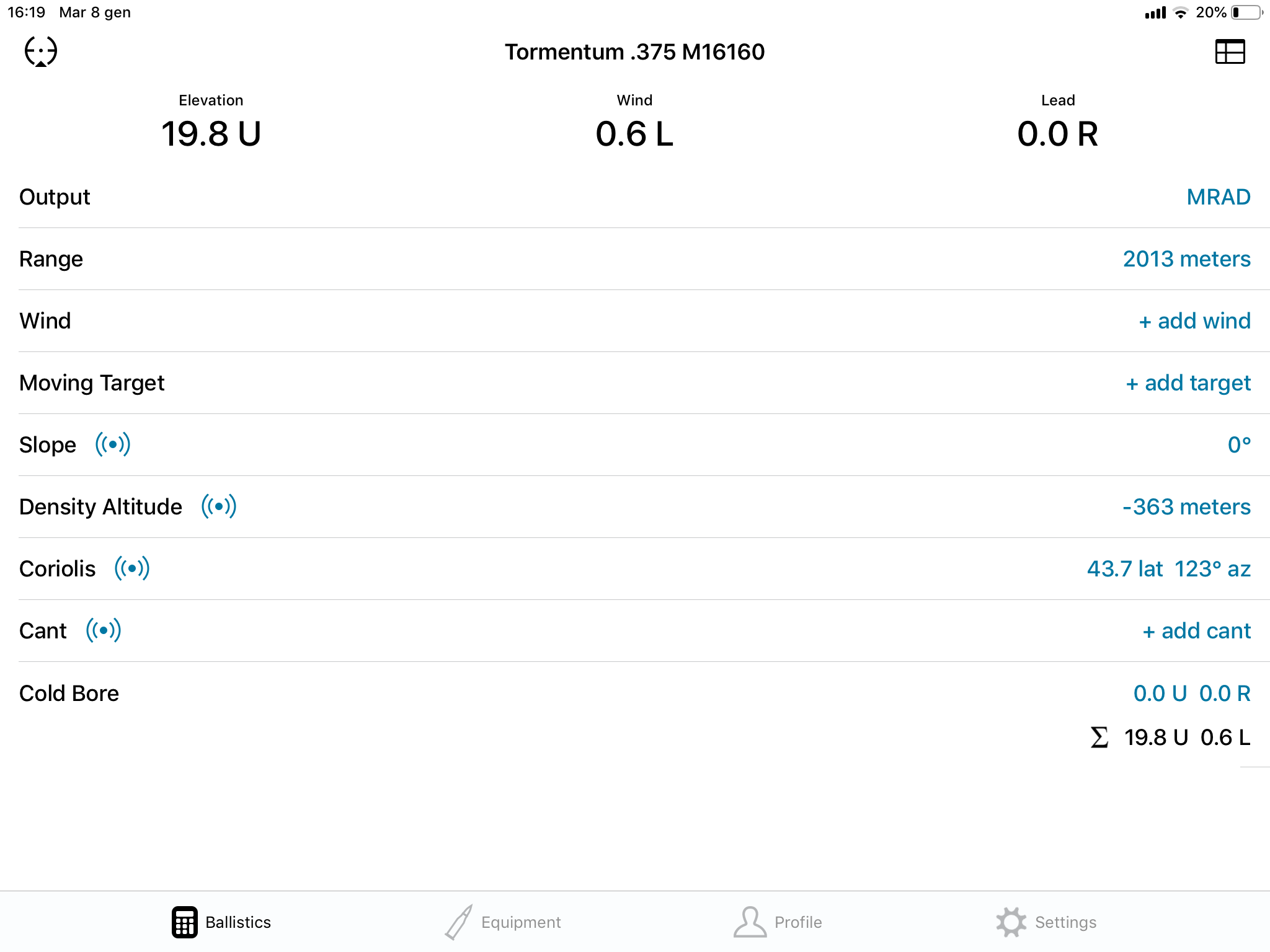

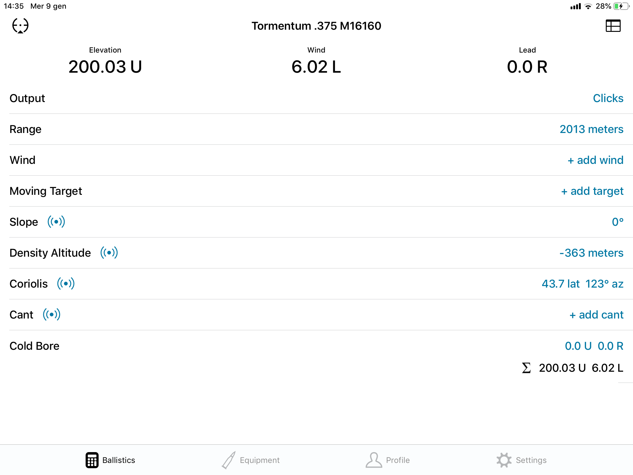

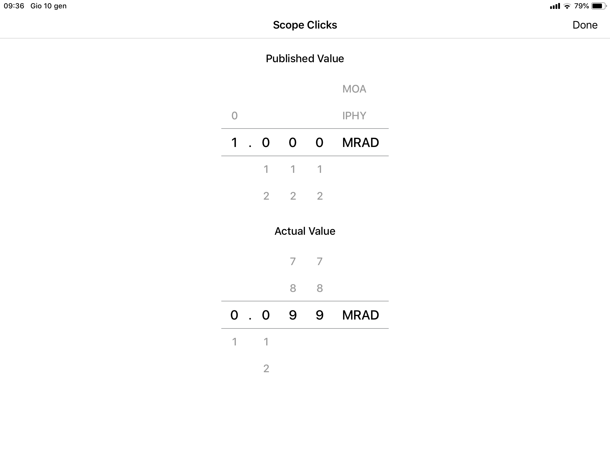

May be a bug ? MRAD the value for nominal clicks, switching to turret with 0.099 MIL I’ve 200.03 instead of 20.03

one shot ST, on my “Equipment” screen, when I click on “Scope Clicks,” it brings up an input screen with two entry fields, “Published Value” on top, and “Actual Value” on the bottom.
These are the two fields where you enter the click correction. Leave the Published Value set as 0.100 MRAD and change the Actual Value to either 0.099 or 0.101 to account for minor (+/- 1%) differences. The corrected input value then works as expected once you also select the output as “Turret.”
Note that when Output is set as MRAD on the Ballistic screen the Scope Click Published Value is used to calculate and output the elevation, the Actual Value input is ignored. However, when Output is set to Turret on Ballistic screen, then the Scope Click Actual Value is instead used in the calculation.
When thinking about it more it really only makes sense to apply the click value correction when the Output is set to Turret.
Kind of a convoluted explanation but I believe this is how the underlying implementation is coded. Hope this sheds some light on your question.
Or better, there is no difference between clicks and turrets

one shot ST, can you post a pic of your corresponding “Equipment” screen for that result as well as the “Scope Clicks” screen reached by selecting the “Scope Click Value” input field on the “Equipment “ screen?
As requested
Yep!!! Here lies your problem!
Your Published Value needs to be "0.100" instead of "1.000" as each click on your scope is only 1/10th of a Mil but you currently have it set at a full Mil per click.
That is the reason why your calculations are off by a factor of 10... your value of "1.000" is 10x larger than the value of "0.100" it should be set at.

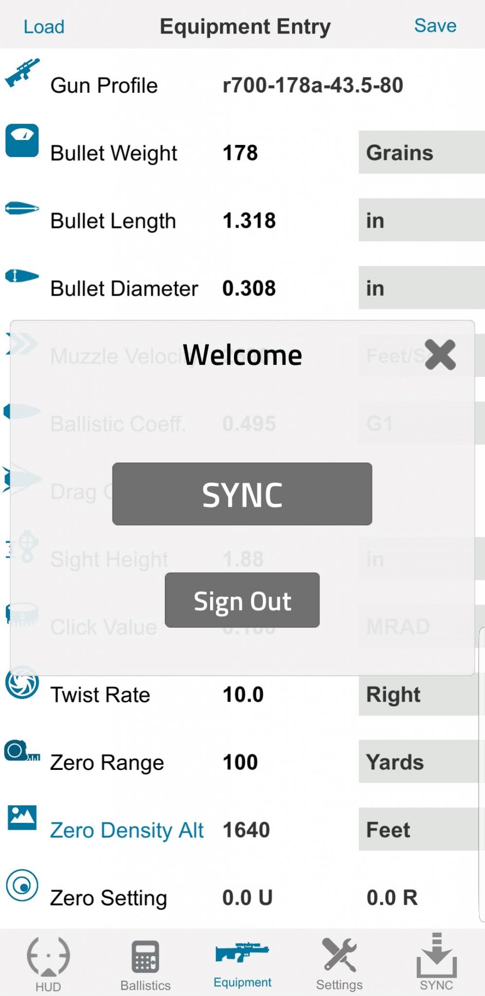

Isn't this "Trasol"? This is a screen shot from my phone.
So it just sits there and never actually syncs anything to the website. And if I three different androids running this same version, they all get this same message .... "Downloading profiles....." . Does anyone have this part working on their TRASOL for android (Samsung S9 +, Droid Maxx2, Droid Maxx). The app works fine on all of them. I can manually copy the /internalStorage/Android/*.TRASOL/data/files/TRASOLData/*.xml to each system, and all that works. But would love to use the "sync" option to simplify this process. Sorry if I did not clarify.

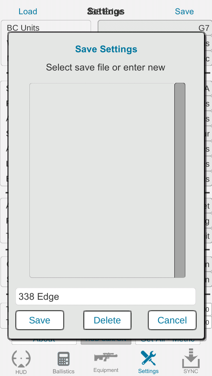

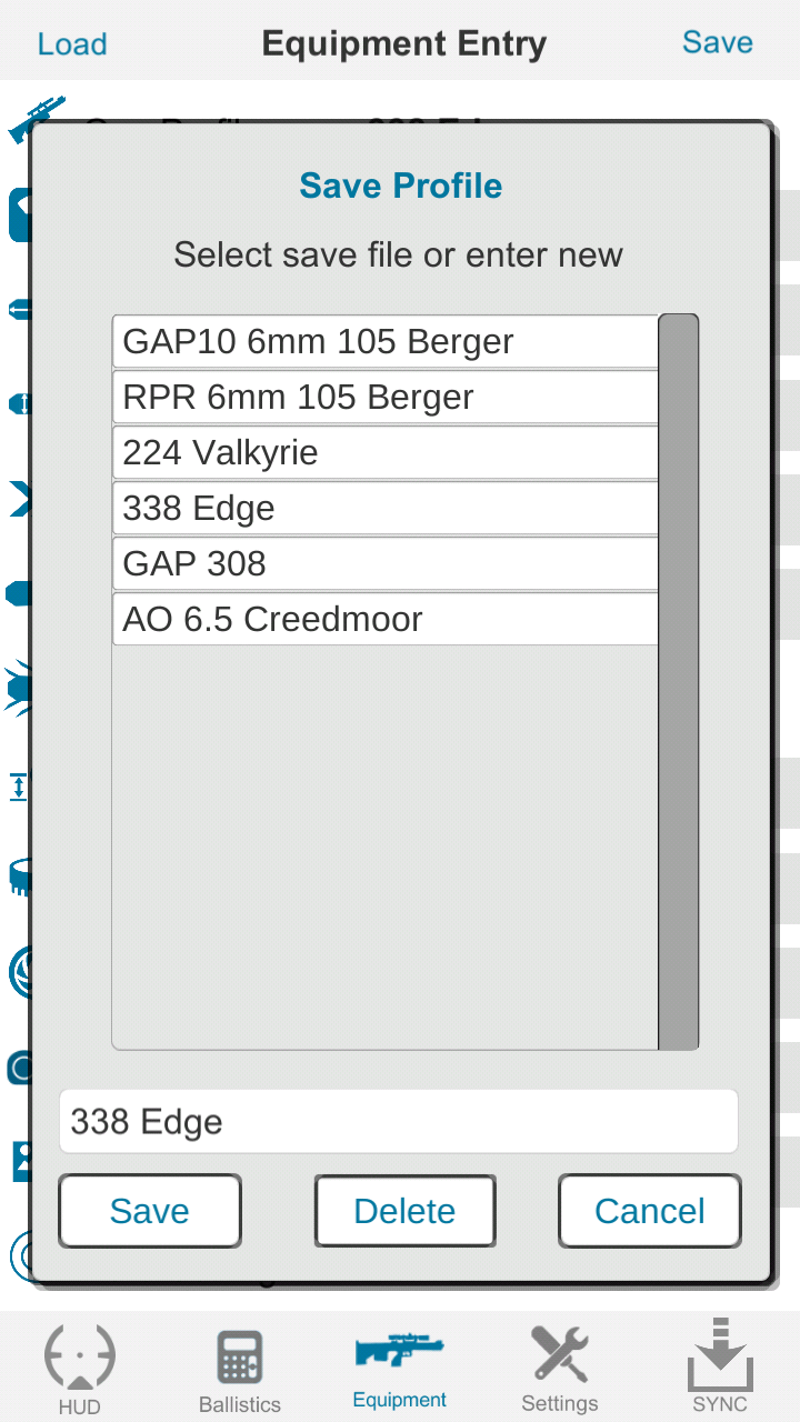

I have the same problem. (I thought I brought it up earlier, but maybe not). I'm using Android version and in the settings area, I can not get anything to save. I can get my equipment to save and give me a list, but no go in the settings area.
I sure wish they would get this working better for Android users. I was using this app, along with a couple others last weekend, shooting out to 2157 yards and this one seemed to work the best.
Here's a look at my screen:
The first one shows the settings and notice that there's nothing in the list to "Load". The other is the equipment and notice I do have other profiles to "load".
