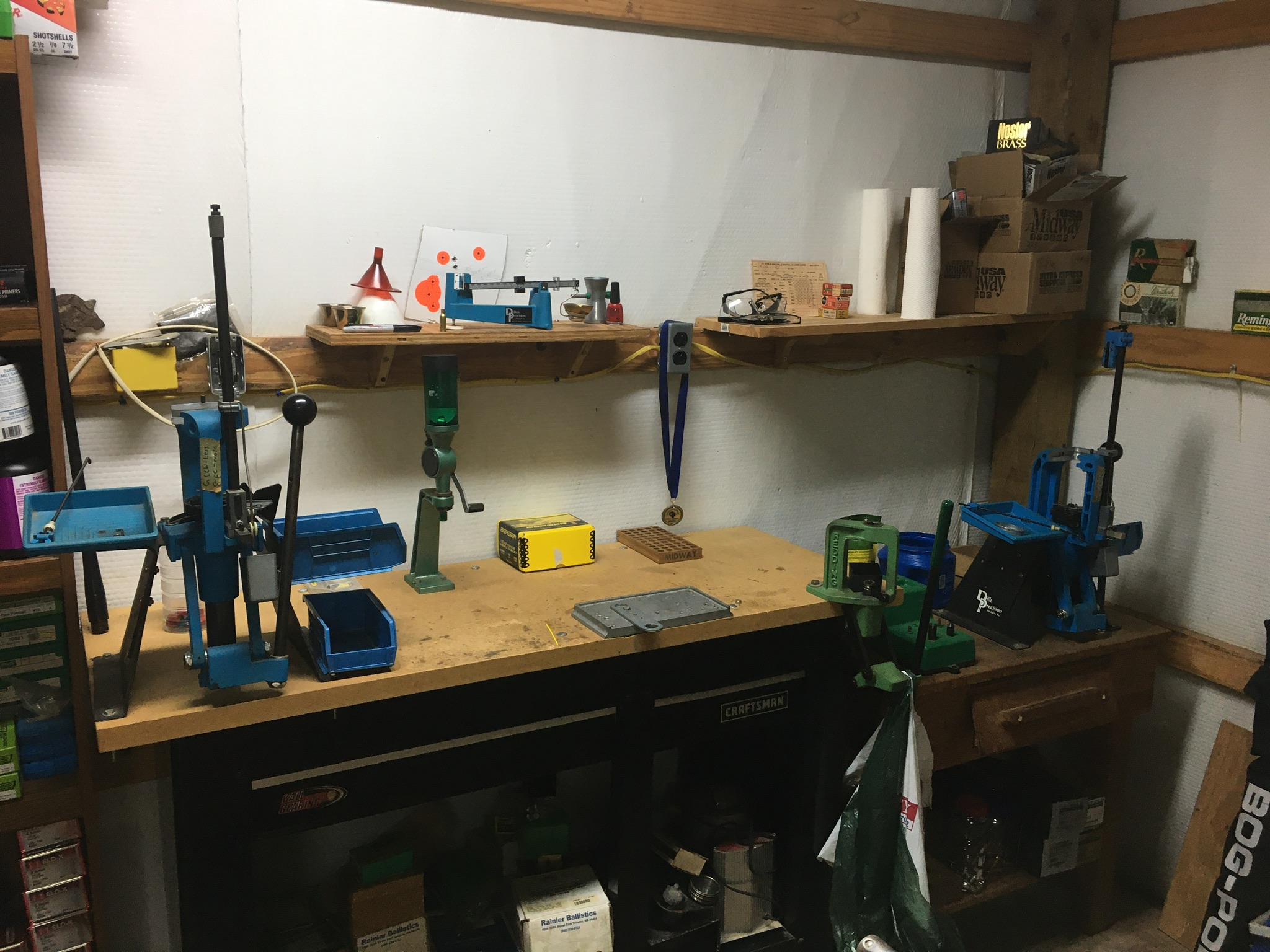

Nice looking setup. I used the Dillon powder drop for 223 and 25-06 varmint loads with good success. I may try it again once I find a load I like. Powder is definitely the long part of my workflow.
40 rounds are loaded up, ready for testing.

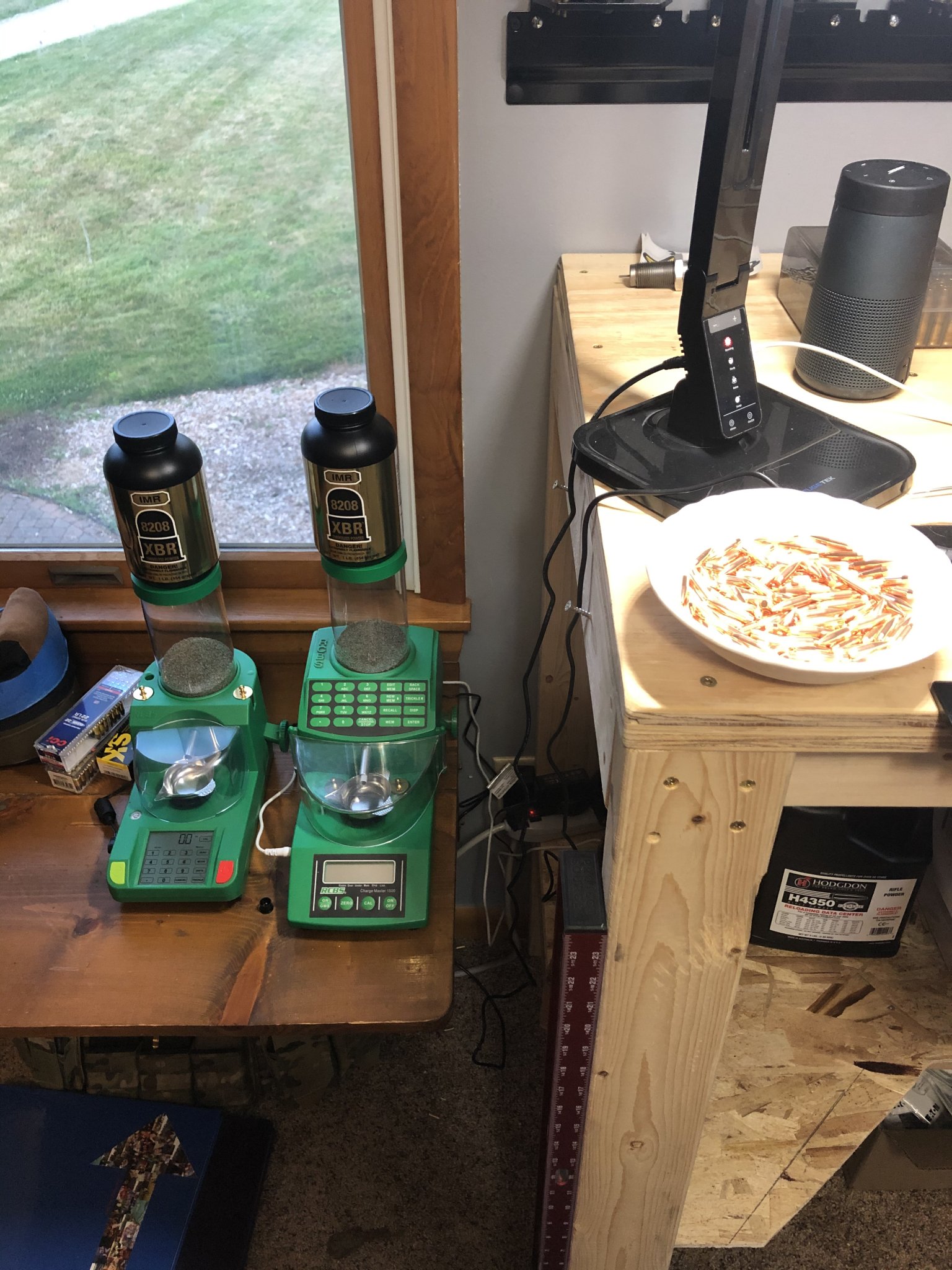

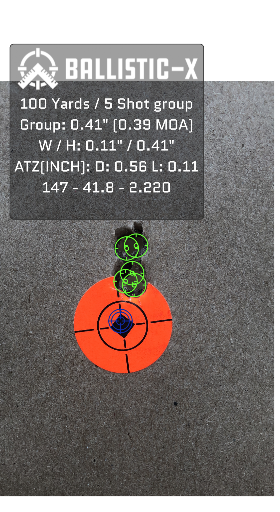

You're using a chargemaster to dump powder right?
I got a 2nd chargemaster this spring on sale and I'm so glad I did. Two really changes the game. My Chargemaster 1500 is quite a bit faster than my Chargemaster Lite though.
If I load up 50-100 rounds, my 1500 will be responsible for about 60-70% of the total throws. Once I modded it quite a bit, it will often throw within a few seconds, either barely trickling or not trickling at all.
My last outing with 6.5cm, I did 3, 10-shot strings, with 2 of those strings shooting for good 5 shot groups. (dot drills on last one).
1 - ES 22 SD 7
2 - ES 5 SD 2
3 - ES 17 SD 4
Composite - ES 33 SD 8.5
Out of the 30 shots, I had 2 shots that dragged the ES from 27 to 33. Personally, I'm extremely happy with this, especially across a large shot group.
All ammo was loaded on Dillon 550 with the two chargemasters in Starline SRP virgin brass. My goal is to always have ES under 30, which I did for the individual 10 shot groups.
Watching those F-Class John videos really gave me a lot more confidence in loading on the 550.
I'm still a novice precision shooter, so still working on body position and recoil management, but at least I feel like my reloading game is doing pretty well. Always room for improvement though.

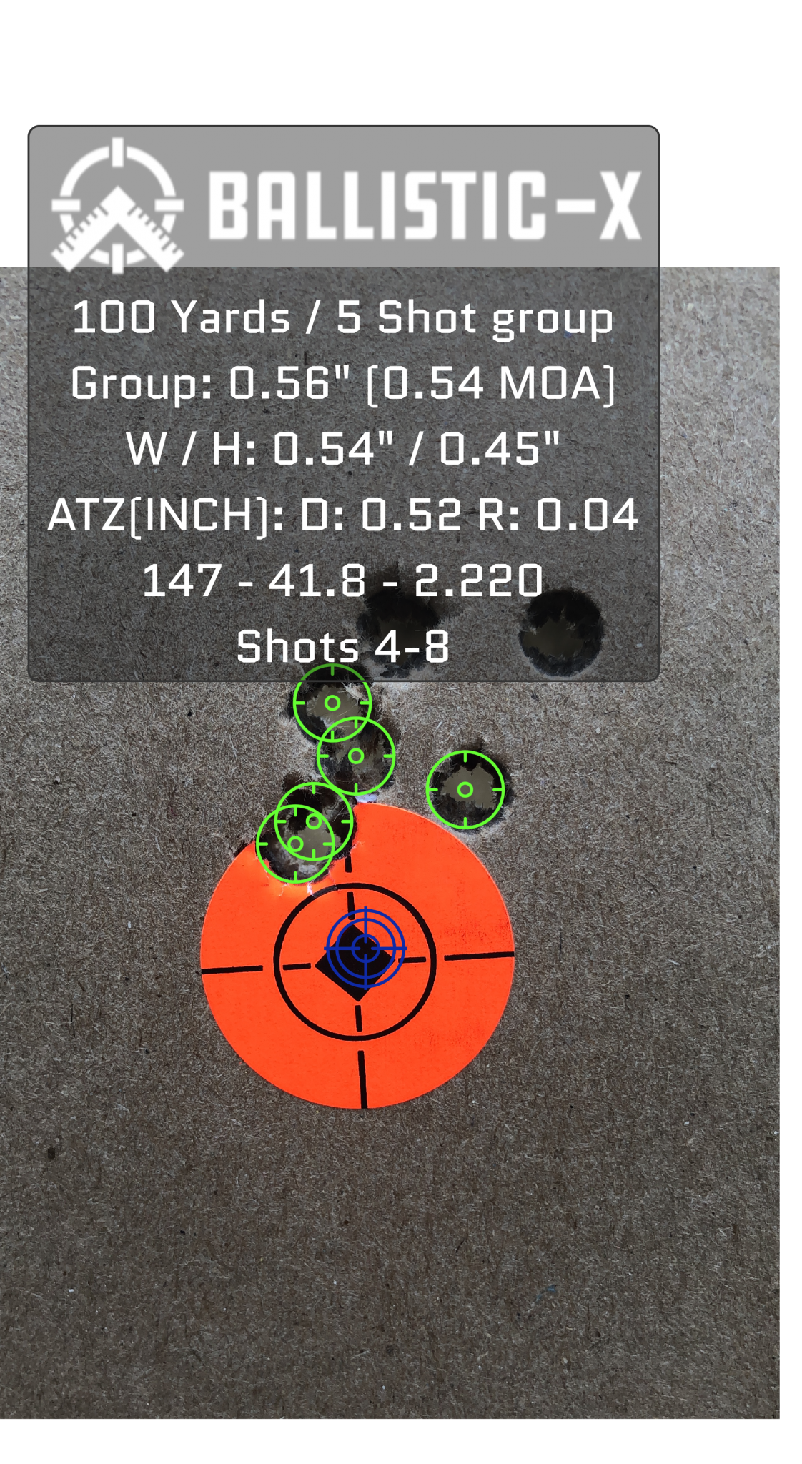

  • Ballistic-X-Export-2020-09-11 09:54:00.700027.PNG
  • Ballistic-X-Export-2020-09-11 10:03:57.056569.PNG
  • Ballistic-X-Export-2020-09-11 10:30:33.759097.PNG
  • Ballistic-X-Export-2020-09-11 10:42:23.702585.PNG

Back from the range. Pretty happy with the results. I should have gone bigger in my charge weight steps, but slow is safe. Jump didn't seem to matter much. Realistically, I'm only about a .4 moa shooter, so despite the 0.010 jump load grouping slightly better, that could have been me. I'm hoping to squeeze closer to 2900 before pressure, but so far I'm happy with this.
Note all speed tests were only 3 rounds.

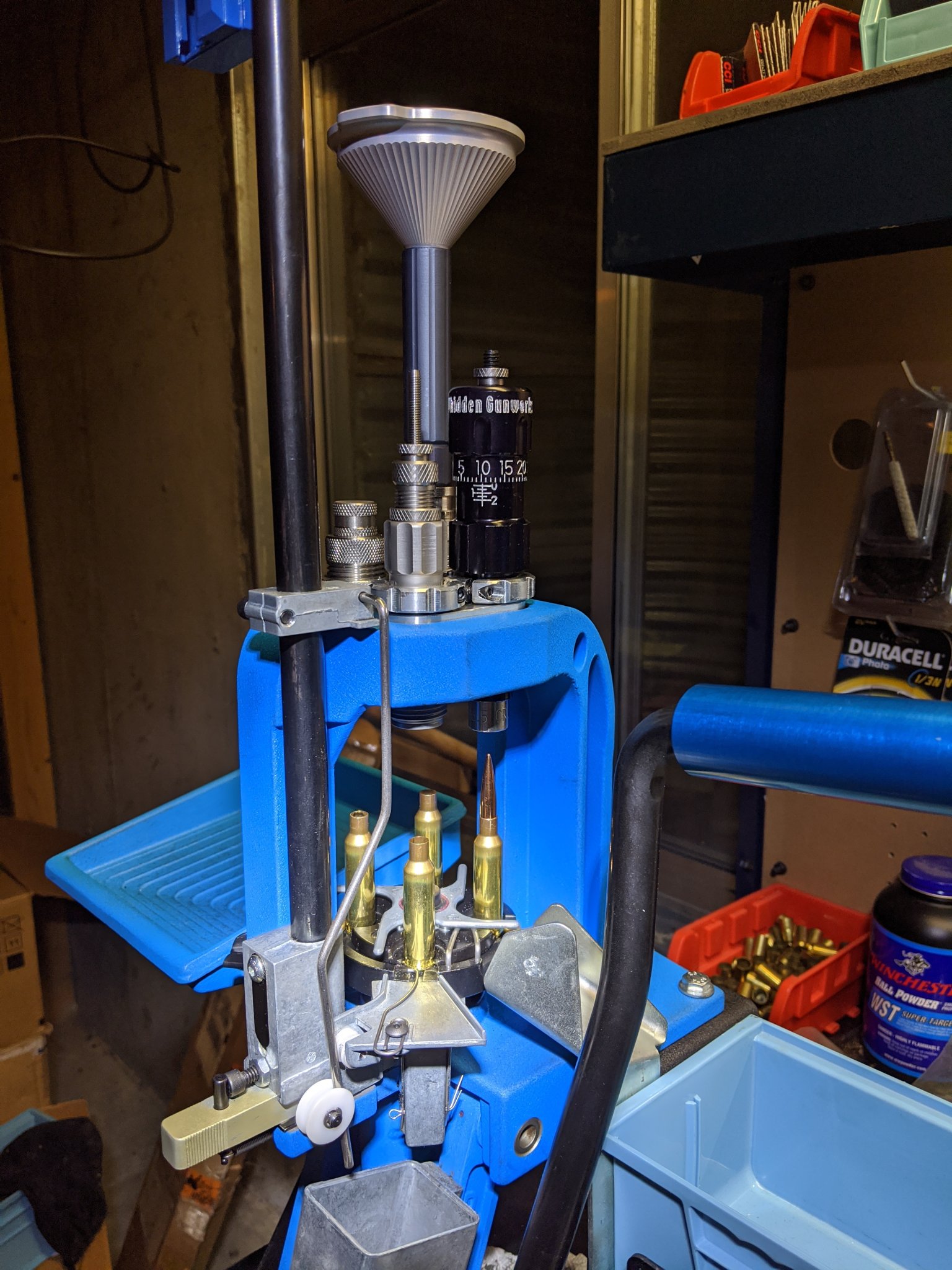

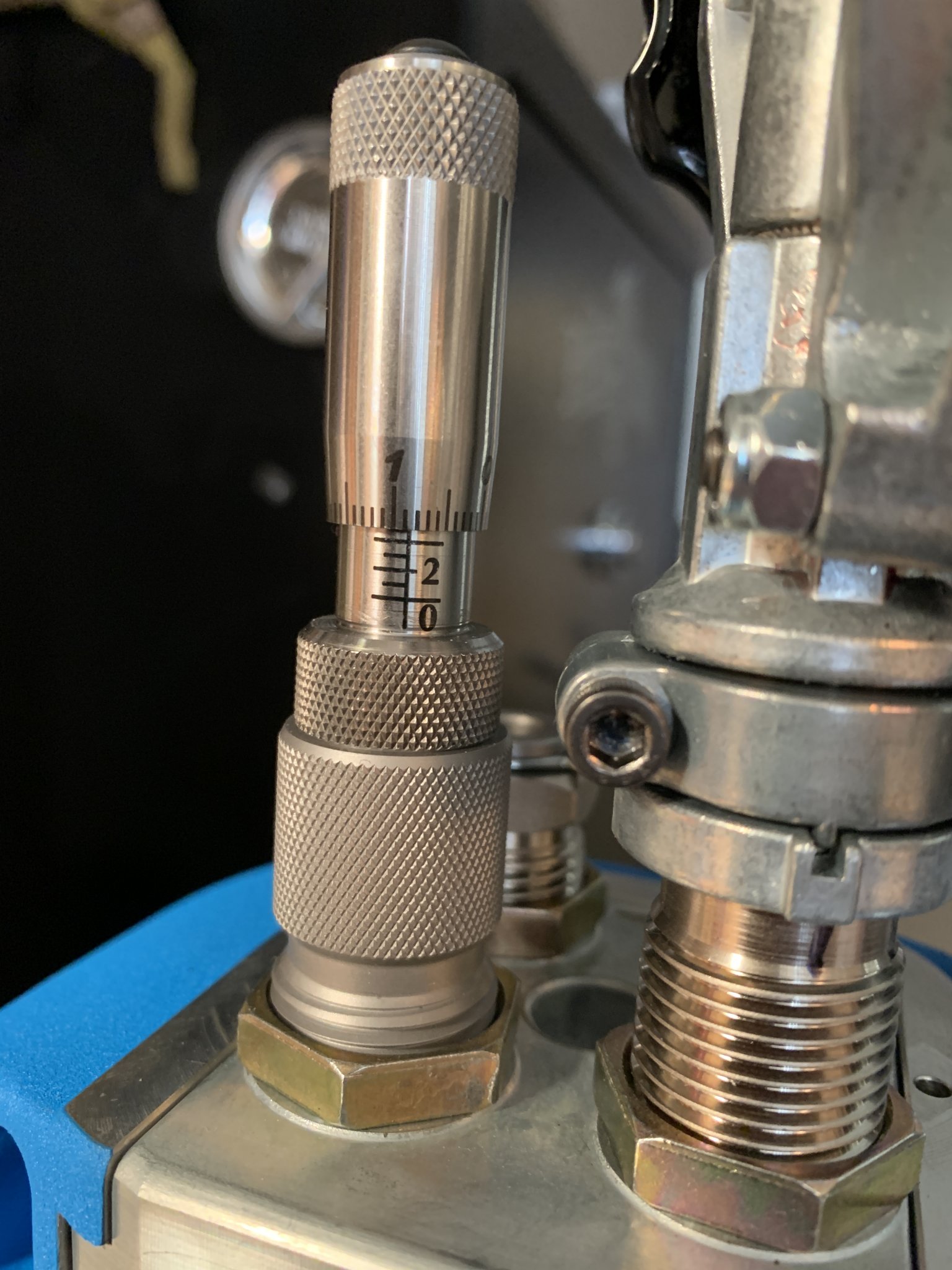

Being old and stubborn, I am using my 550 a bit differently when loading 6.5CM. I size and prime the case, remove the case to a loading block, drop the powder charge using an RCBS powder throw, weigh the powder charge on a beam scale and trickle if necessary, using a funnel drop the weighed charge into the case, put the case back on the 550, move the case to the bullet seating station, AND put a an unsized case in the sizing and priming station.
Works much quicker than it sounds, and it keeps from having to move powder from the scale to the press. Plus it is easier to verify that the case is properly charged.

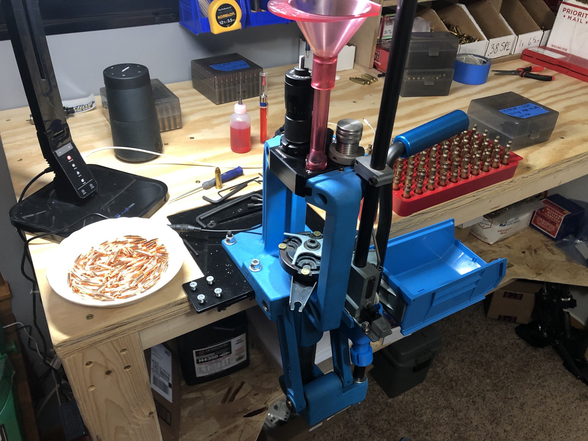

Heres my setup for precision powder. The funnel works on both my .223 and 6.5cm cases and stays in the die hole every time. Once I get to the top of the press stroke, I grab a powder pan, hold the funnel and dump and tap it. Put the pan back and lower the ram.
I see it as the completed opposite. It doesn't complicate it it makes it simpler. Every process happens on the down stroke instead of some on the up stroke and some on the down stroke. By doing it that way you can't accidently put powder in at the wrong time and spill powder all over the machine. If you figure out how to load sub 1/4 moa ammo at range using the powder drop then I'll think about that. Using something like a Redding powder drop if it was press activated should be a huge advantage from the Dillon unit if every charge is weighed. It doesn't have the possibility of getting powder hung up. I use an auto trickler and if I get the Dillon working well enough I will probably mount a Prometheus on top
So I'm correct in saying you want to mount a case activated powder measure, leave the top off, and when the ram is at the bottom, you'll dump weighed powder into the powder measure. That way when you work the press again, the case activates the measure and drops the weighed amount of powder?

Sub 1/4moa ammo at range? Rockchucker as fast or faster than properly setup 550?? :ROFLMAO: :ROFLMAO: :ROFLMAO: Some of you guys crack me up.
There are many of us on here that have been loading precision ammo on our 550's for a LONG TIME. This same topic pops up every few months. There are many threads detailing every little question, mod, setup, trick, hardware, etc. that is being posed and argued in this thread. All you have to do is do a little searching....
I've got a 550c, 2 XL650's, Rock Chuck and Co-Ax. NOTHING is faster than the 550c for precision bolt gun ammo... There is ZERO accuracy or SD difference between the properly setup 550c and Co-Ax. The only difference, speed. The 550c wins out every time.
Uniquetek Clamp Kit
Whidden Floating Die toolheads
Area419 Dillon adapter and funnel kit
A&D FX120i AutoThrow and AutoTrickler Bluetooth Setup
Dedicated Case Prep Toolhead
Dedicated Loading Toolhead

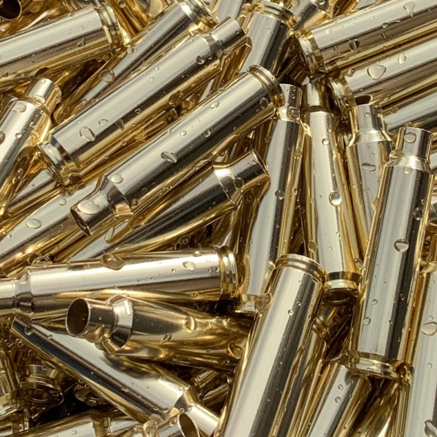

1) Tumble your brass when you come back from range in corn cob then run through dedicated case prep toolhead
2) Optional step for those of you that anneal, now is the time to do it
3) Spray all your brass in a plastic bin with 90+% alcohol/Lanolin mix and let dry for 5min
4) Run through dedicated case prep toolhead
Station 1 - Mighty Armory Dillon Decapping Die
Station 2 - Either FL honed sizing die or FL bushing sizing die
Station 3 - 21st Century TiN mandrel setting final neck tension and ensuring concentricity
4) Tumble your brass however you feel (dry, SS, ultrasonic, etc) But I tumble in corn cob to remove lube. (hint for your new guys that never tested it extensively but, shiny brass from SS and Ultrasonic does nothing for accuracy, it just looks nice and CAN hurt accuracy
5) Run brass in dedicated loading toolhead
Station 1 - Mighty Armory Dillon Decapping Die (to make sure flash hole is clear)
Station 2 - Dillon Powder Die with Area419 Dillon Adapter, Drop tube and funnel set to just barely pick up the tube for positive contact
Station 3 - Micrometer seating die of your choice
I have done side by side testing of all of the above scenarios... SS tumble vs corn cob vs ultrasonic.... Co-Ax vs 550c for accuracy and SD, shiny clean brass and primer pockets vs corn cob tumbled and dirty primer pockets.
Im gonna tell you, the target doesnt care down range. no difference...
None of this matters if you dont know how to do proper load development. There is a reason why doing proper load development and selecting the proper charge in the center of your node is... This has also been discussed and explained and proven in many previous threads. If you change lots, you drop a charge a little high or a little low of your center node charge, its not going to matter downrange.
If you dont know how to do proper load development, and are shooting a load not in the node, not in the center of the node, on the edge of a node, any slight deviation in powder charge or powder lot will cause havoc down range. This is why proper load development is SO IMPORTANT.

Installing the micrometer powder adjustment. Both these and the internal sliding channel have been polished

There’s always the hornady micro top...it’s small... View attachment 7423196
I’ve been using a couple of these Hornady micro’s for a while, I only wish the hash marks on the corresponding micro for the powder drop actually represented some form of weight measurement (I’ve been running the Hornady AP). Does Dillion or any other manufacturer have one that does?
Obviously no powder bar can be exact with their measurements because different powders are different sizes/volumes... but its prolly as close as you'll get. I know a few guys on here that use them and have said they like it.
Here you go... I use them on ALL of my Dillon powder dispensers..
