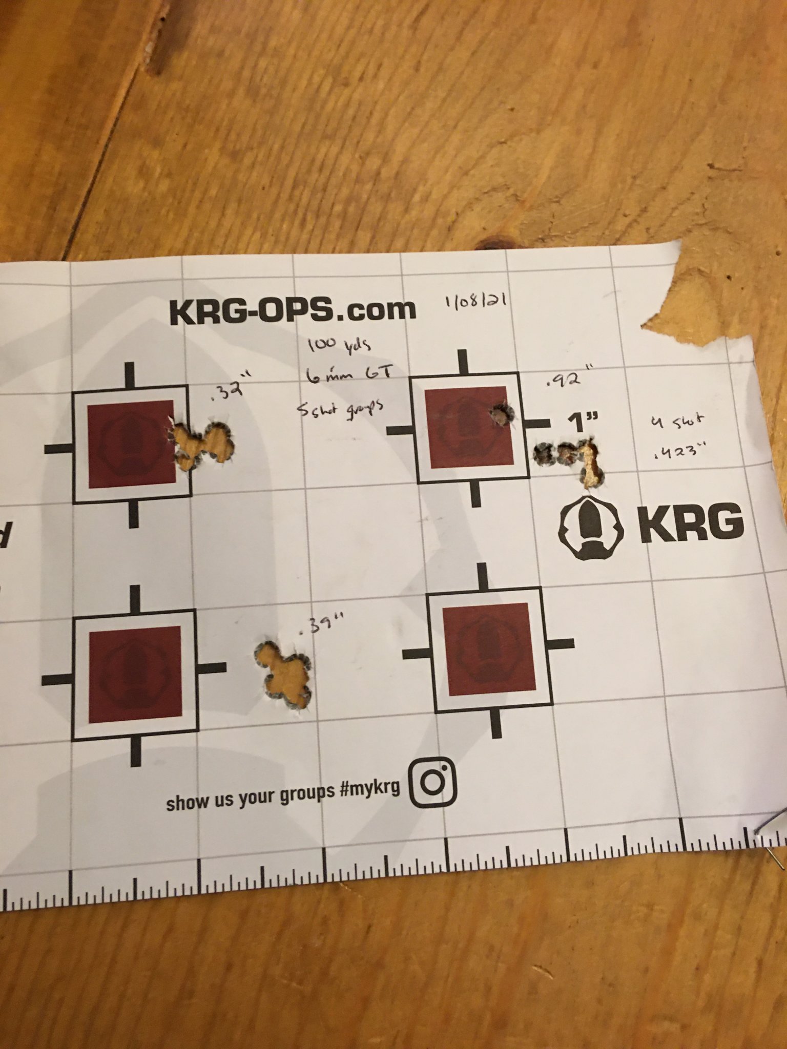

Sorry for the time away. Life happens sometimes. I got back to the range today to do a seating depth test. Being a weekend, there was a lot of carrier in out movement, and that's what caused one of the flyers (my target was bouncing left-right). Regardless, extremely happy with these results and definitely have found my "new brass" load for sure. I don't know what runout is, but I know I can control oal to +/- 0.001", and that seems to be good enough. One of these days, I'll test a Dillon powder drop.
Off to work on a valkyrie load next.

I would ignore runout unless its massive. Looks good though, keep us updated.

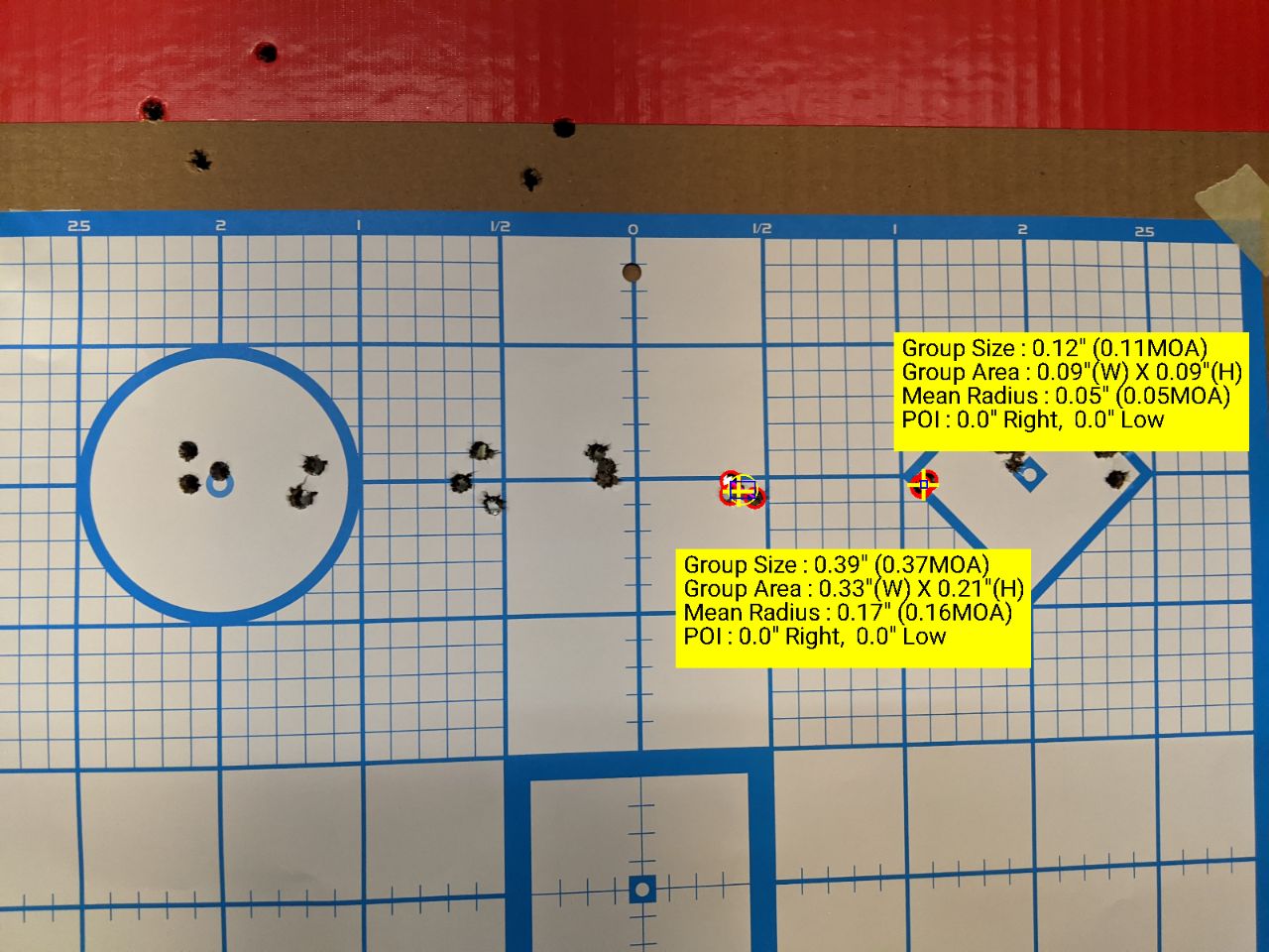

I finally made it out to the long range. Everything lines up perfectly with Kestrel AB out of the box out to 1000, so that was nice. I did notice a pretty healthy speed increase with the latest batch I loaded. I pulled one down just to verify charge weight, and it was right on the money. I suspect it's the powder drying out and speeding up. I'm going to have to back off a fair bit to get back into the node.

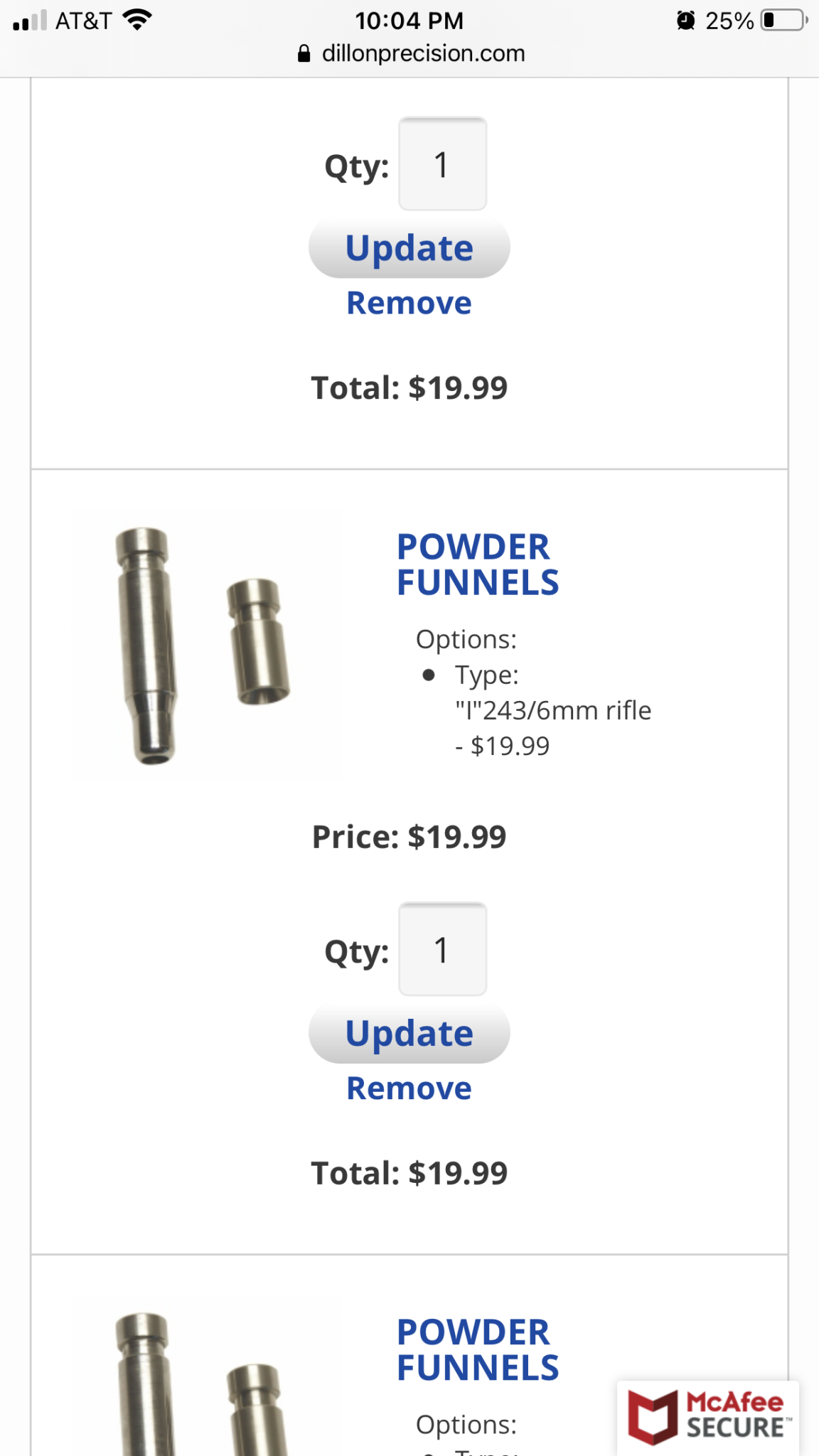

Does anyone have a powder die to run a funnel with 6br. If so could someone get me the measurements of it so I can get one made
Dillon powder die with the 6PPC funnel.
I run mine with the 419 funnel and drop tube. It's a slick setup.

I dont think you understand. All powder dies for Dillon toolheads are the same....the Area 419 funnel with their Dillon adapter allows you to use their funnel in Dillon powder dies. You drop the 6br funnel that comes in the Dillon 6br conversion kit into the die.
I can't get a 6br conversion kit
Could you get me some measurements from the 6ppc one. Plc and br are the same.
I think what they’re saying is you don’t need a “6br” specific powder funnel. Buy the generic Dillon powder die and buy the Dillon “6mm rifle powder funnel”. Then add area 419 adapter/funnel and you’re set. I hope that’s how it is because I’m ordering a bunch of Dillon parts tonight for setting up seating/powdering toolheads.

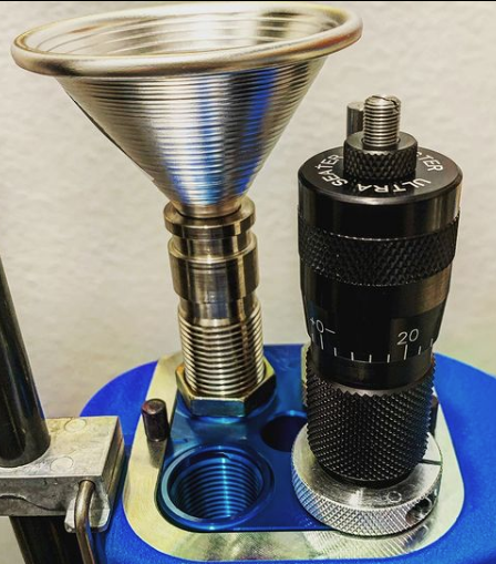

I've found the Hornady Lock-N-Load AP Powder Funnel Die works great with this funnel set
No modifications required a a snugger fit than both the Dillon & 419 dies.
I can also attest that the Satern 6.5mm funnel fits the top of the Powder Die perfectly. I've used it with a Hornady Powder Cop in station 3 and Forster Ultra Seater in station 4, so there's just enough room.
edit: I lower the Powder Die down until the cartridge-specific funnel in the die just starts to push the Satern funnel upwards, so that it makes full contact and leaves no gap between them.
