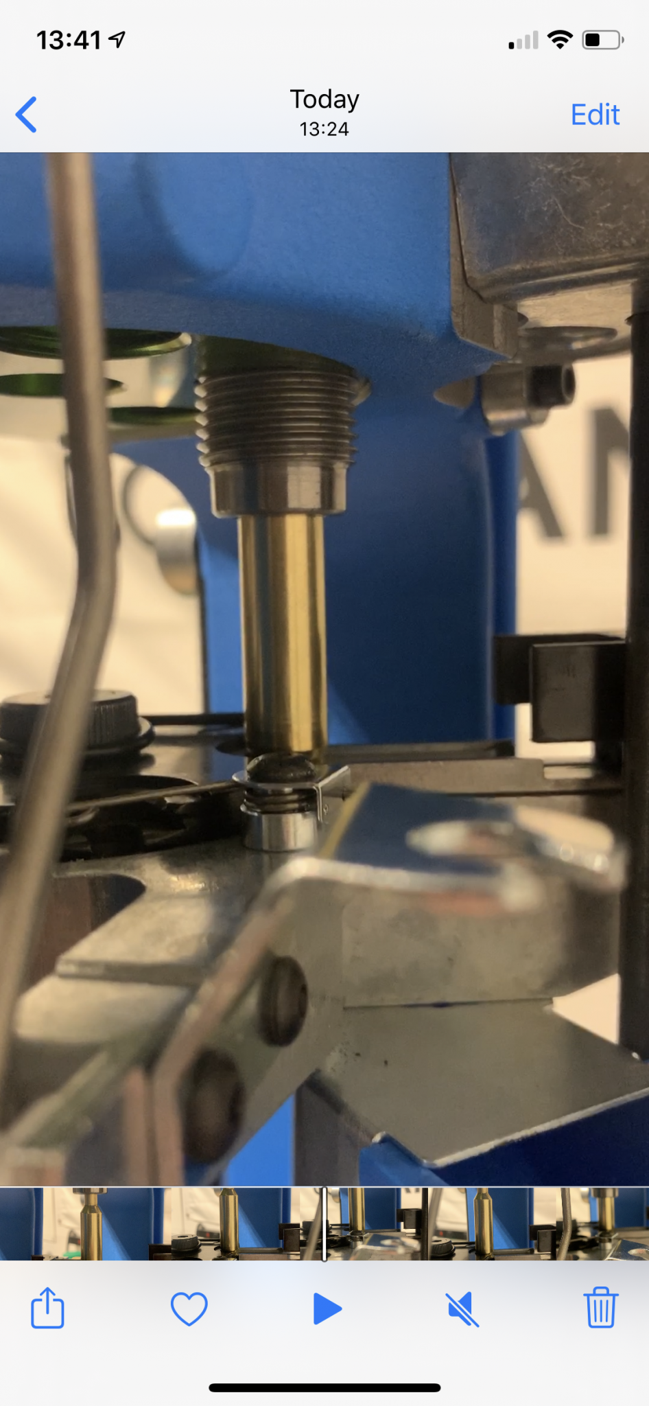

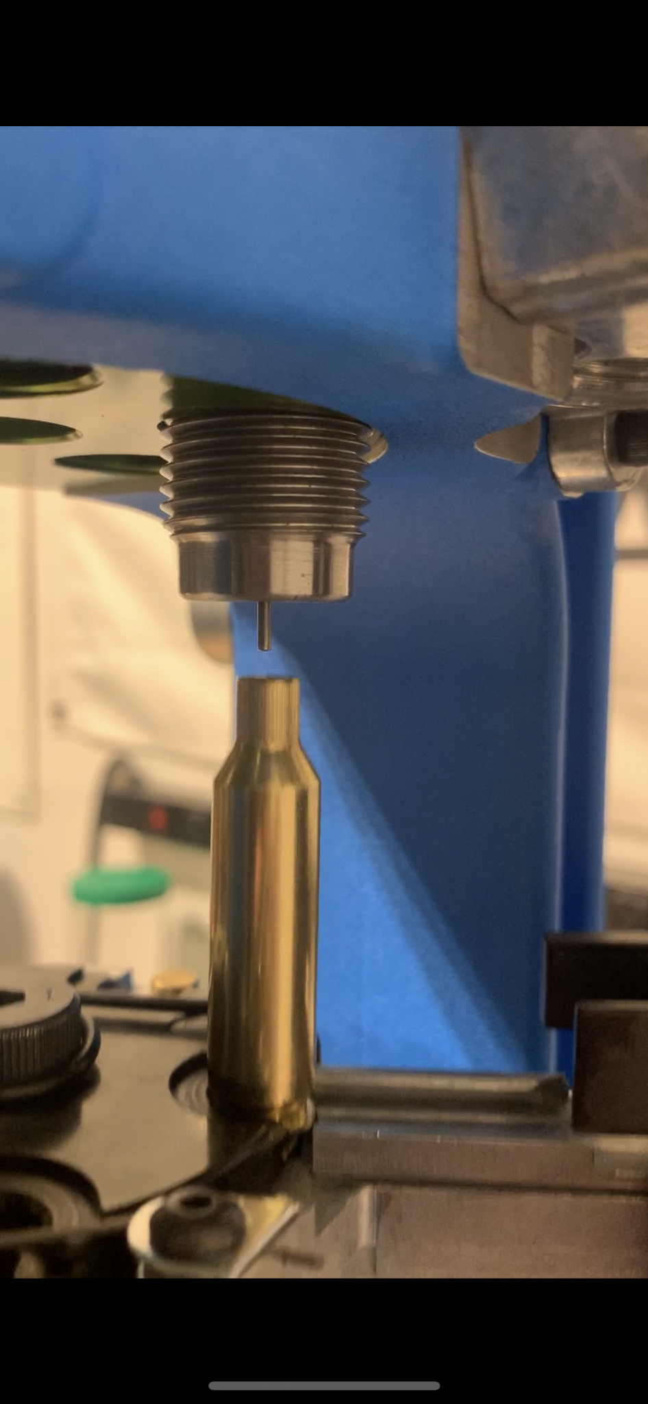

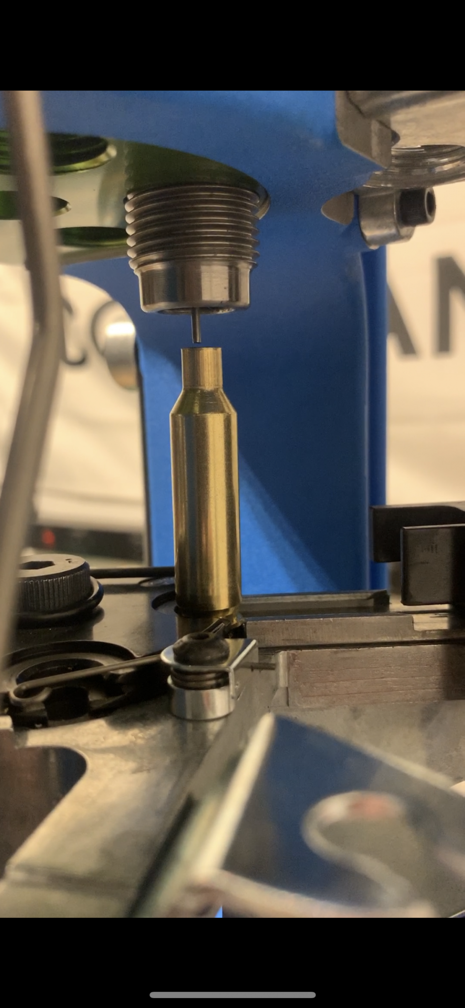

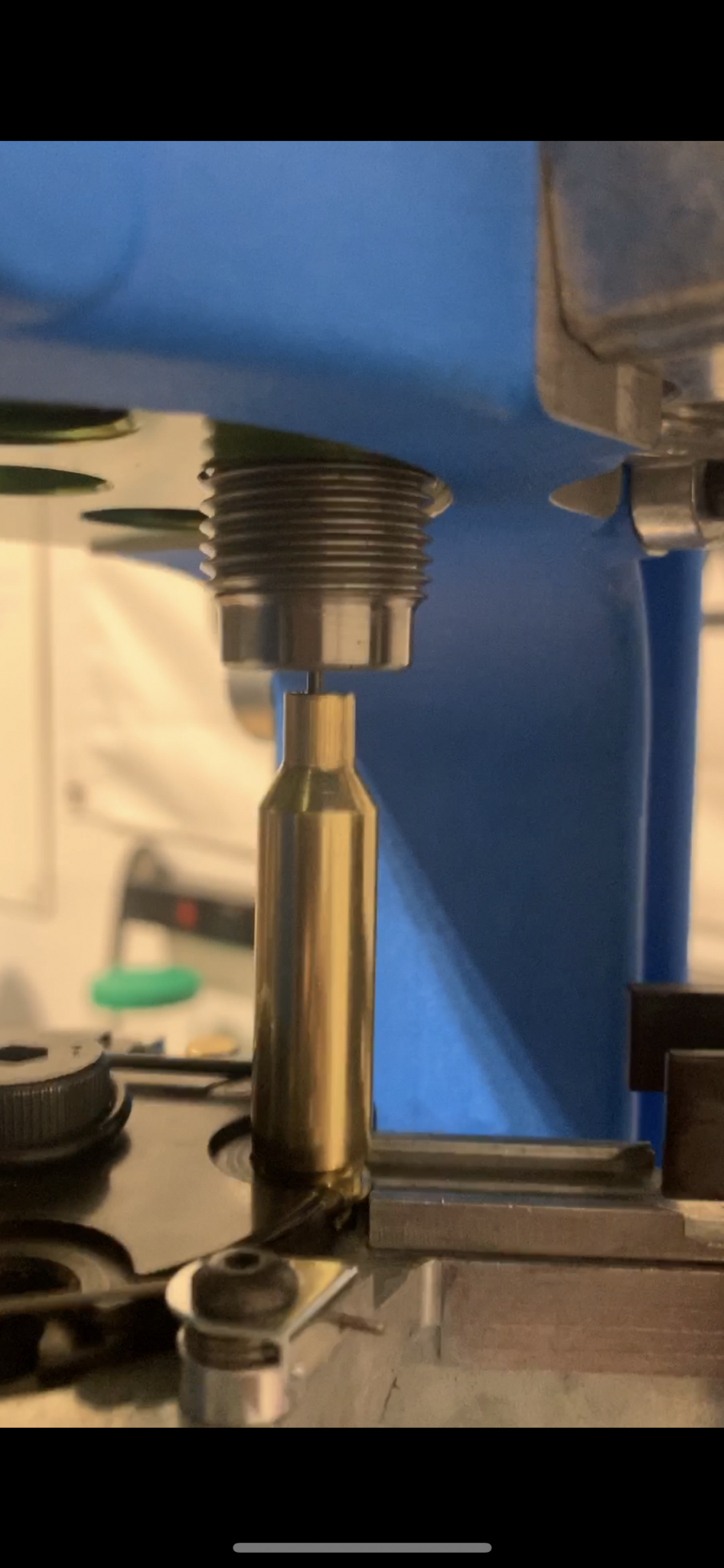

    See attached video, im FL RS & DP 6Creedmoor Hornady brass with a redding die.
    Using a jofer toolhead & forester lock ring.
    Everytime i resize the brass looks ever so slightly tilted.
    Im using the FL/RS in station 1 with a universal deprime in station 4 both putting the same amount of force oj the shell plate.
    Why am i still getting the brass ‘tilted’ or not fully in the shellplate.
    Thoughts?

    I can't confirm this, but I have a Jofer toolhead for my .357 mag loads and I swear it does the same thing.
    I'm wondering if those Jofer toolheads aren't just a tad wide on the hole placement. I need to switch my dies to a Dillon toolhead I have and see if the problem goes away.
    It looks like the die hole in the toolhead is not aligned/centered with the shellplate. The brass is as far towards center as it can go on the shellplate, but the die is just a tad further. It has to lean.
    I think you need a new toolhead.
    Did your 750 come with a Dillon toolhead? If so, put the dies in the Dillon and see if the tilt goes away.
    So i solved this issue, ill take some pics and do a write up if anyone else has the problem, essentially i greased the underside of the brass tray that holds the brass from the fill tube to the shell plate (less wobble), also tightened shell plate ever so slightly. As well i adjusted the rod that sets how much pressure is pushing against the case as its being set in the shell plate, all of these adjustments in secession have made it to where the brass is center aligned on the deprime pin.
    Interested to see how that fixed it. I guess if the shell plate wasn't adjusted right I could see some wobble there or something.
