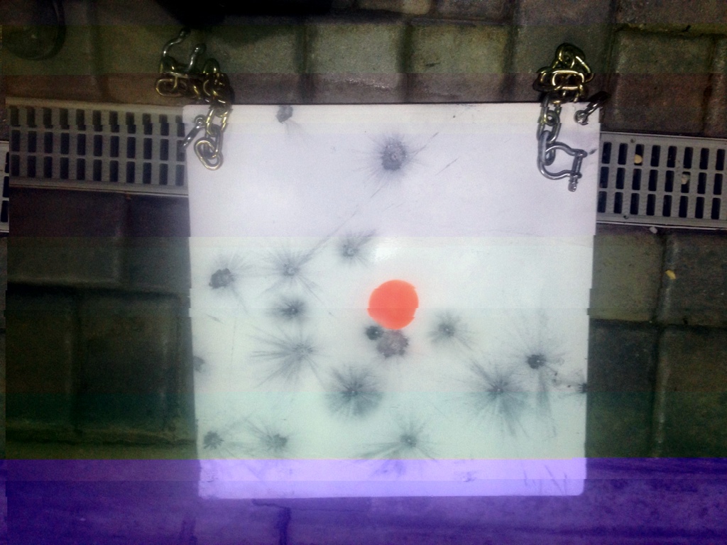

Update it's nice to have a record function -
Set out to do a few cold bore shots at 1100y on various rifles (338LM, 7mag, 223 and 3o8), so a traveling buddy could use mine to get out around 2k..
After my friend shoots 4 rounds on the upper right side of the target. (I shoot left handed and he shot right handed without making scope adjustments) a bird lands next to the target just after my cold bore on a 308.. Well, it's laying in the left shadow of the target you can see it's feather moving a bit in the wind.
I figured the 308 is shooting well so I hit record and try for the clay on the right. I was not the best hit.... But a hit. YouTube target can video below
http://youtu.be/jWlZbRAViZM
Below are how the sighting in impacts played out-
7mag 2 shots, Cold bore 11 o'clock above 3" center, 2nd in ornge
338 2 shots, Cold bore 6 O' clock below center, 2nd in orange
223 3 shots, Cold bore 2 misses, 3rd furthest left above center
308 1 Shot, Cold bore 1 shot 5" right of center
308 -on clay shown
Shooter JC -- on 7mag 4 shots vertical string right side of plate --
11oo yards on clay & cold bore sight in w/ 338, 7mm, 223 and 308 - YouTube
308 -on clay shown
