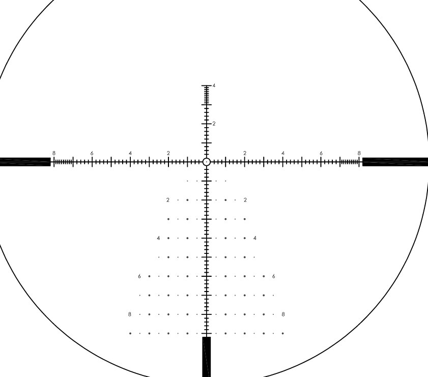

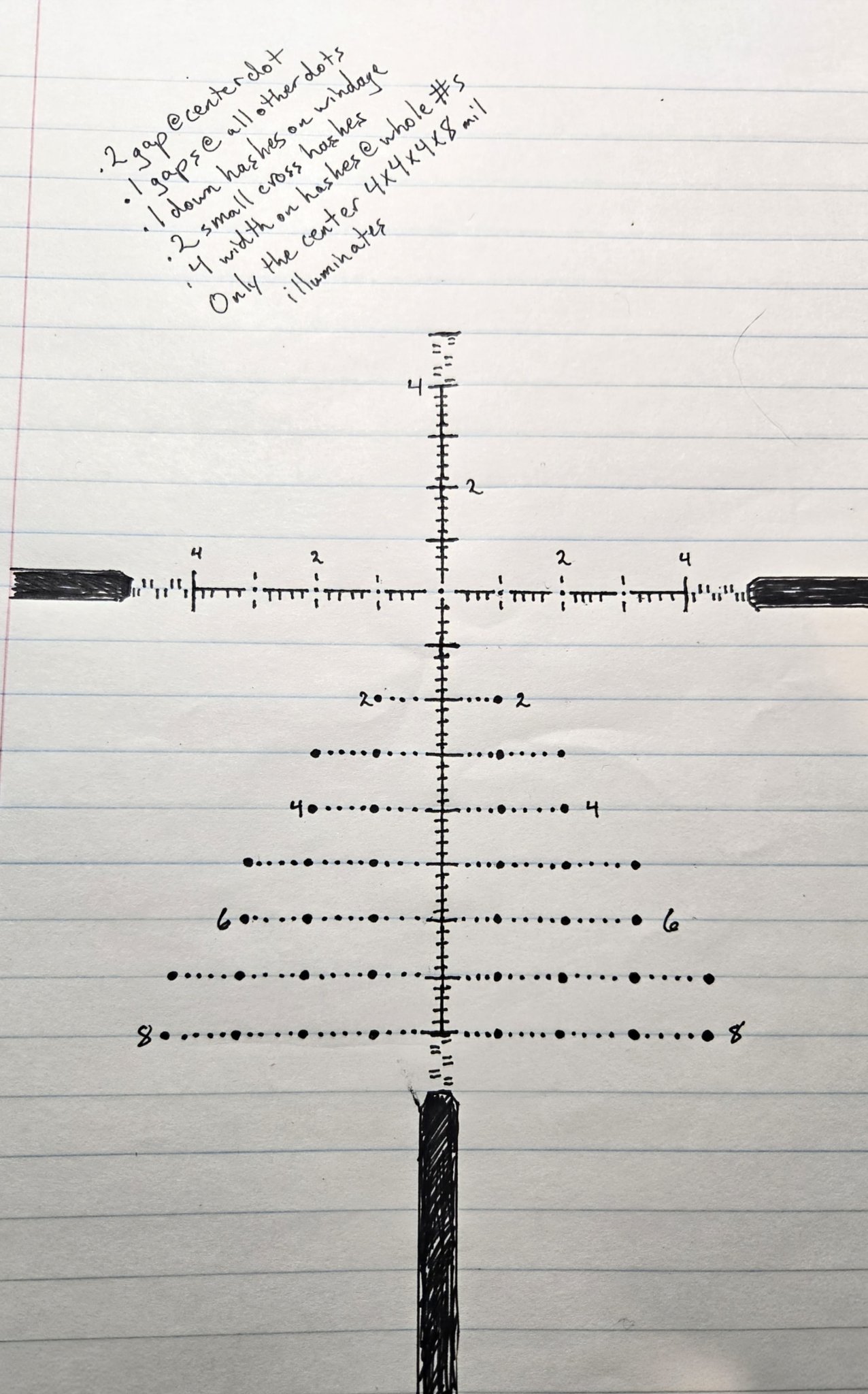

I'm no artist, and this isn't to scale...but I could run something like this or slight variation of:
Probably more 5-25 ideal to me and stripped version for 3-18.

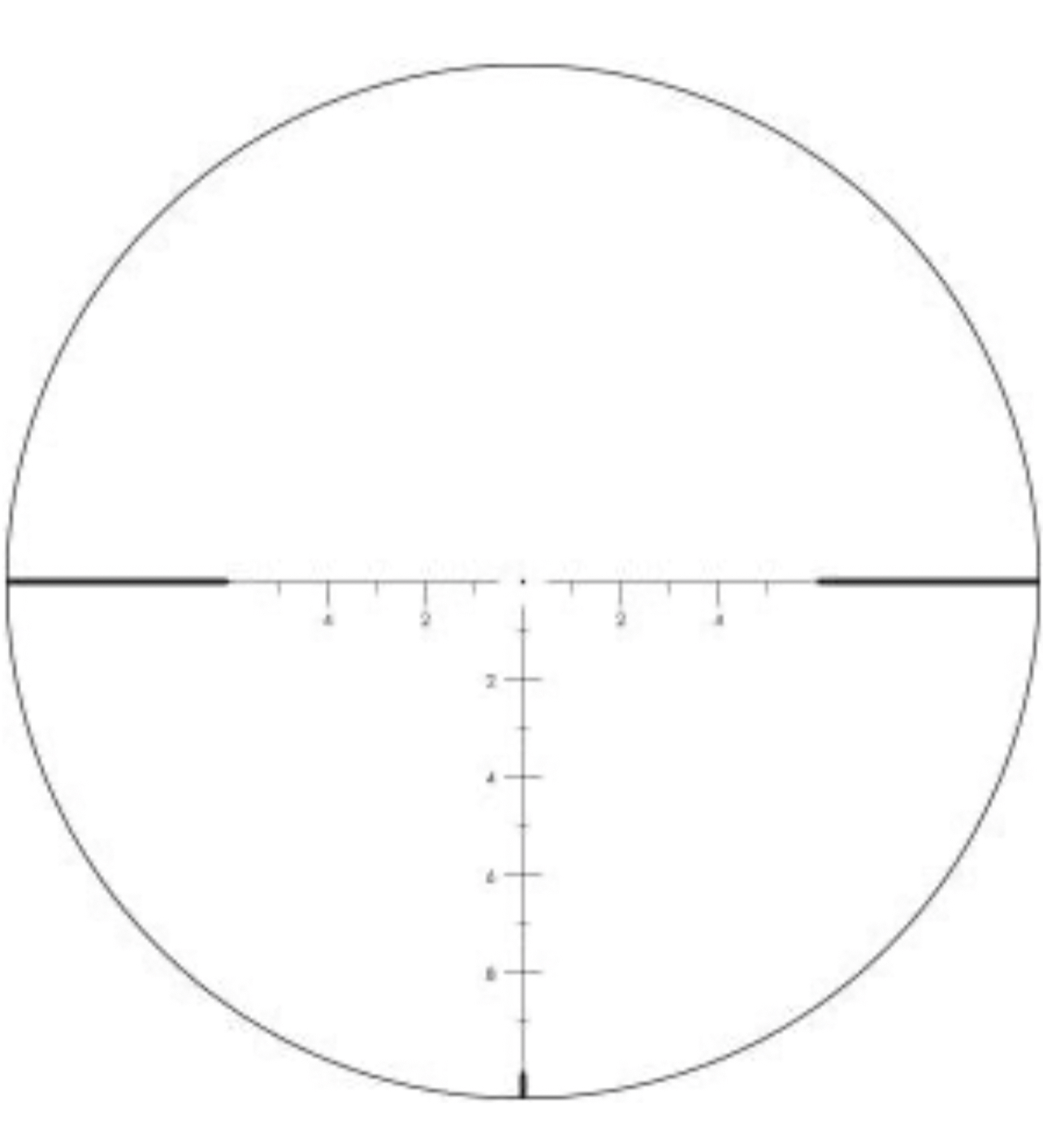

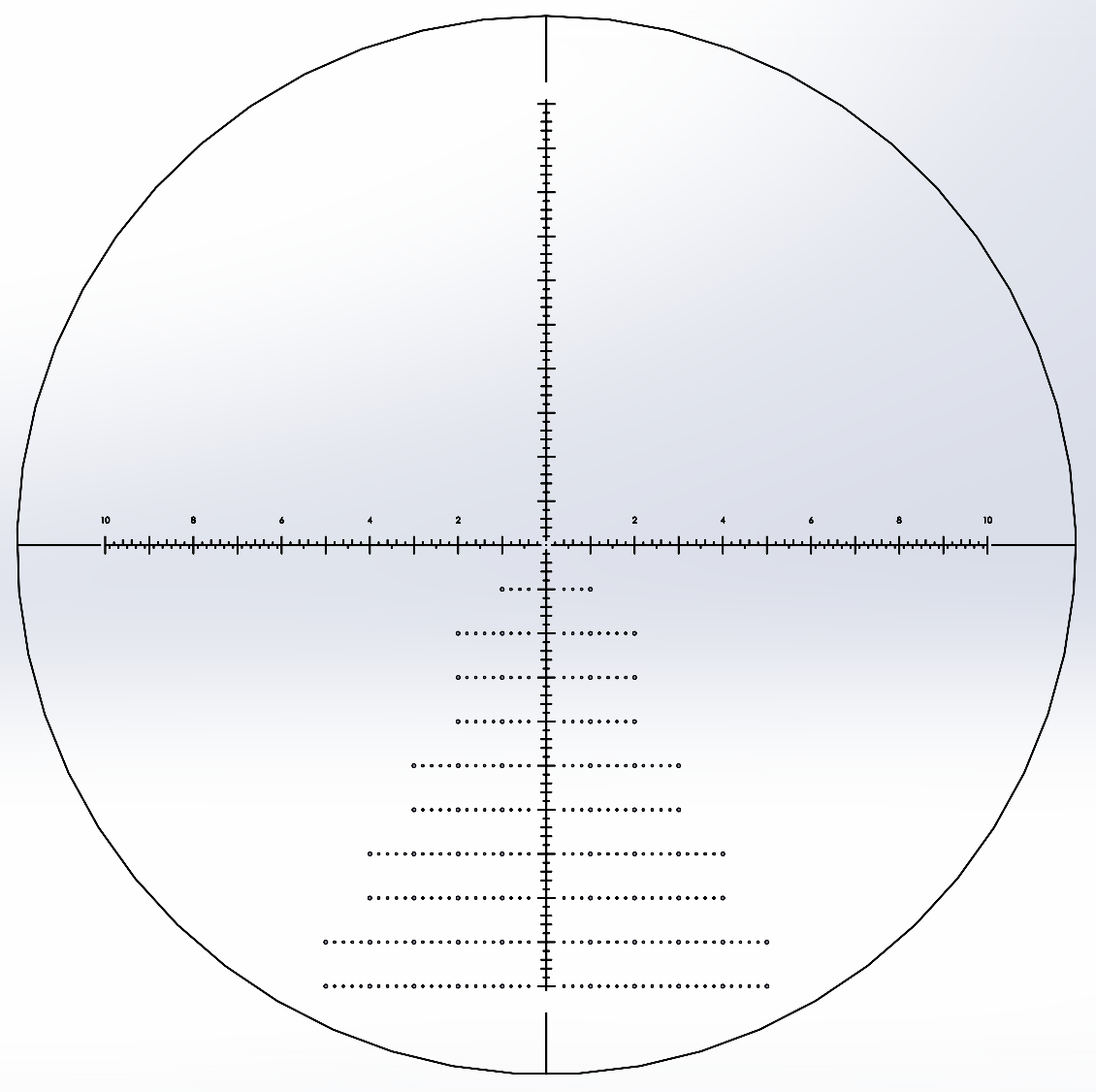

Here's my take. This reticle would be primarily for 15-25 power use, and probably wouldn't work for shit in a 3-18. It'd be damn close to my ideal for PRS. Can't think of anything else I'd want for ELR, tactical, or general long range but those aren't my strong suit.
I like the EBR-7D a lot, but my gripes are as follows:
- No differentiation between .2, .4, .6, & .8 on the vertical. It sucks ass.
- No differentiation of the same in the horizontal. Less shitty as there's at least a half mil mark in there
My favorite parts about it
- Dots in the tree make it significantly more see through
- .025 mil center dot. Super fine is great for punching paper
- .1 mil open per side is tits. I use a .1 hold all the time. I hate having to interpolate like that on tiny targets.
- .025 line thickness works great in the higher power range. Not so great at lower power but if the FOV is large enough, you get away with it.
Changes to EBR-7D:
- All .2 & .8 stadia are .075 mils tall on the horizontal, and .150 on the vertical
- All .4 & .6 stadia are .125 mils tall on the horizontal, and .250 on the vertical
- 1 mil worth on windage removed from either side of the 2 mil line in the tree. Could probably do without more, but it doesn't affect me much leaving it.
Additional notes:
I got lazy and didn't put the vertical numbers on or the .1 section past the 6 mil mark on the upper half of the vertical stadia.

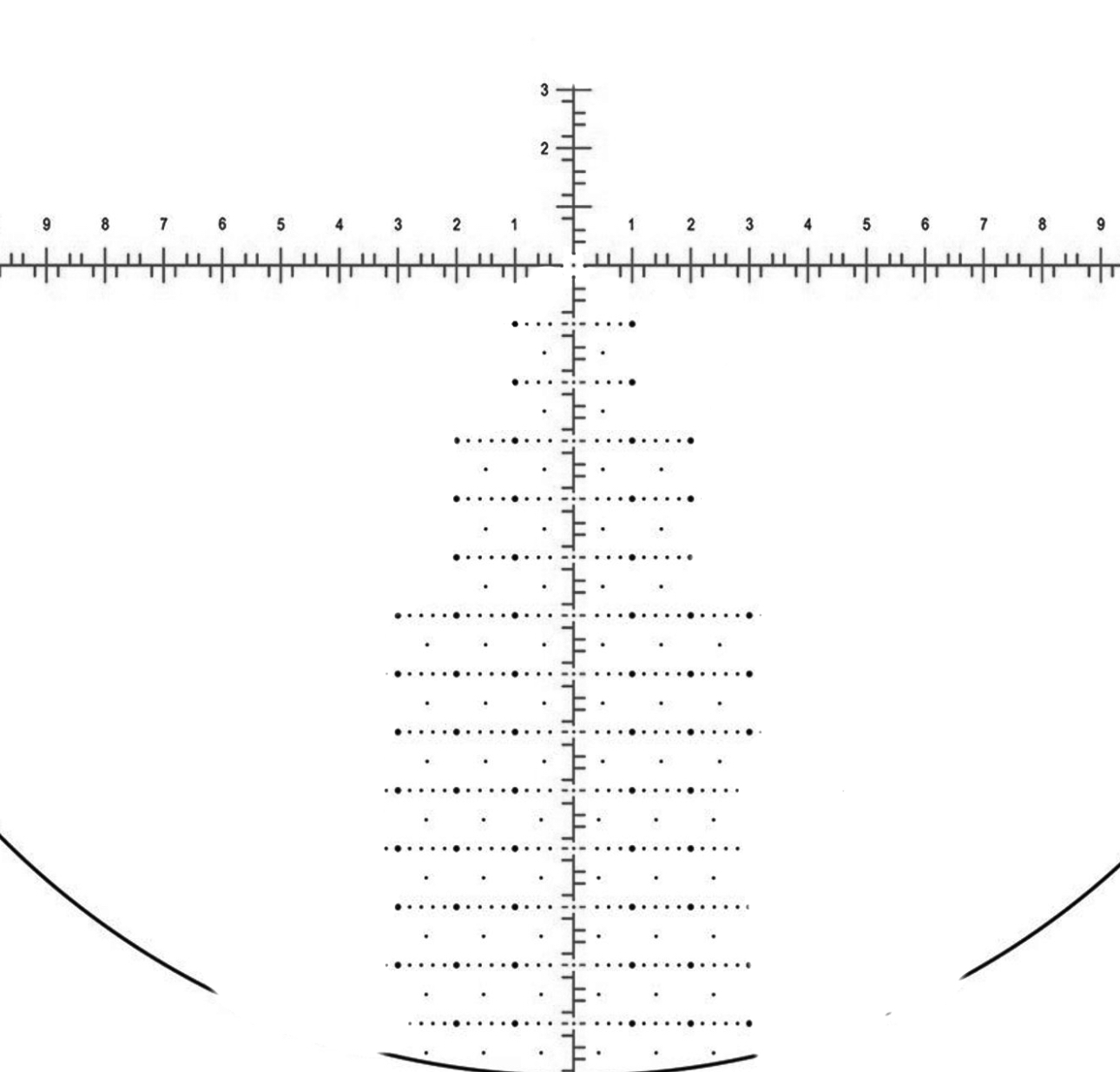

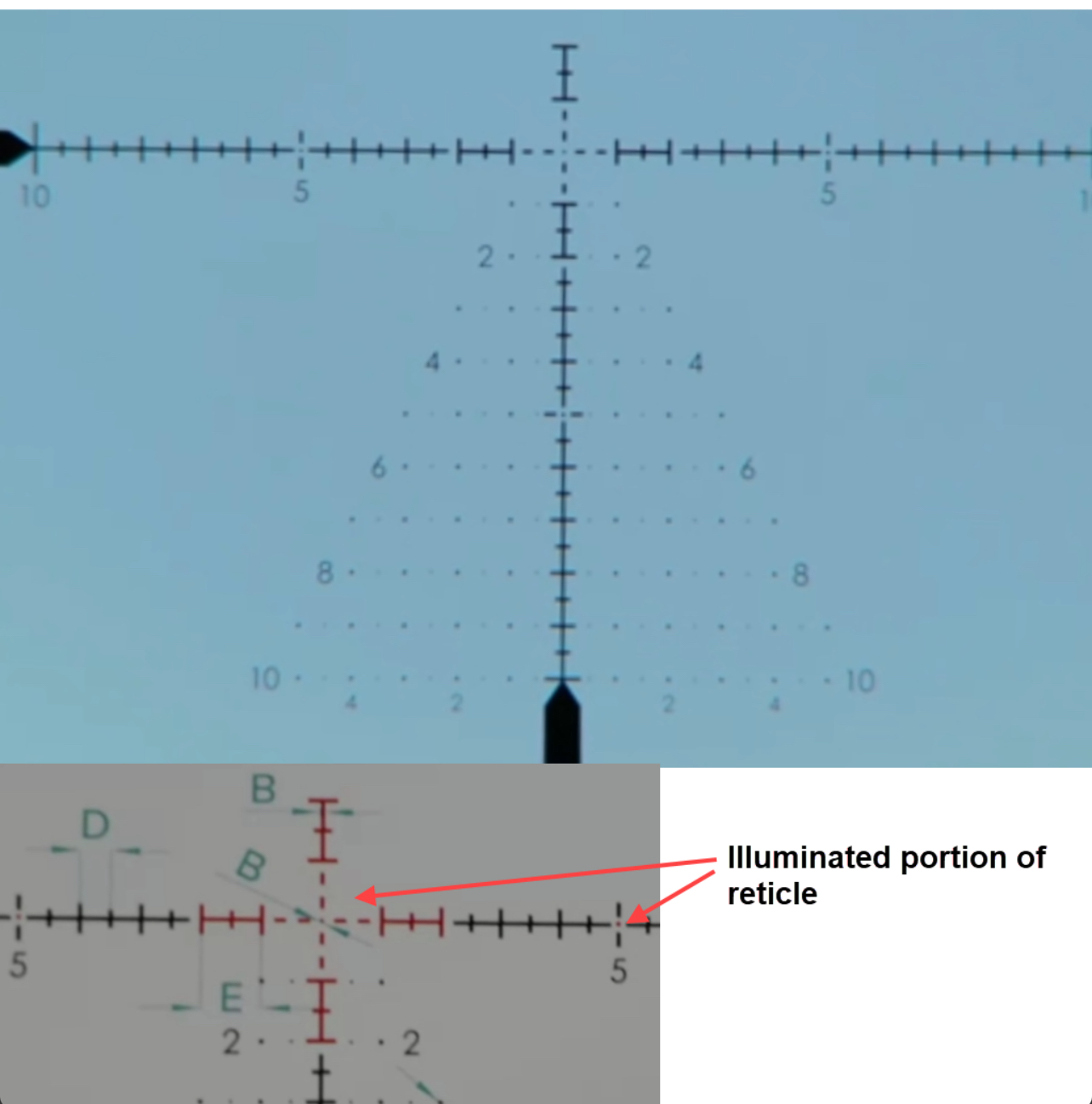

Agree with everything. However, one of my biggest complaints 3 or 4 mil above the center, is they are too thick and obscure the target area. Can we go 1 mil above in the same thickness, and then a thinner, finer mil 2-4?
Something like this, but finer above center.
Stole this pic from another thread lol

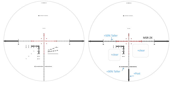

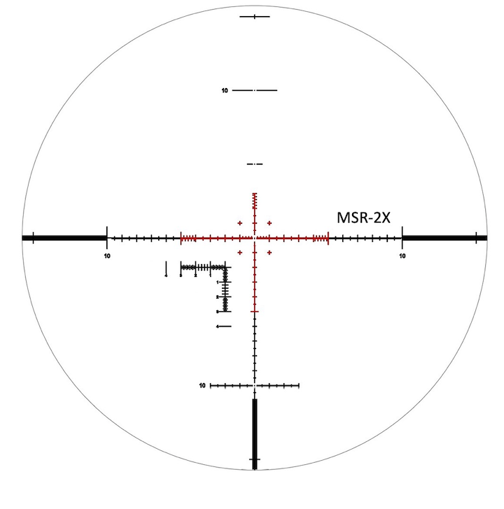

For the 3-18 crossover reticle, which by design should be used in the lower mag ranges, MSR2 style (no tree but keep the ranging features) and bring a bolder line thickness, say 0.15 mil thick, from the 10 mil inwards to about 3 mils from center. Continue the 0.2 hashes from center out to the 3 mark, keeping the 0.5 mil hashes in place, then go to 0.5 hash marks only out to 10 mils left and right. Also, no need to use 0.1 hashes on the horizontal line if you keep the ranging feature in a bottom quadrant. And use actual daylight bright illumination (with both green and red options) for the 1 mil center-only as it currently is in the MSR2 so that at 3x it can be used like a red dot sight.
  • Love
Reactions: Tikkaguy
What about something similar to the George Gardner/bushnell G3, but with a floating dot, .2 windage on the main stadia, .2 thickness? For 3-18, circle of death. Or something similar that doesn’t infringe on anyone’s “design”.

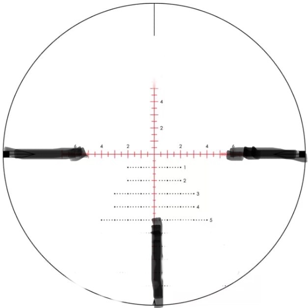

For a crossover I like half mil tree like the Vortex EBR2D. I’ve had a 3-15 PST2 for several years and it’s pretty usable down to about 6x for sub tensions. Taking off a little windage and elevation to thicken up the outer edges for the horizontals and lower vertical would make it work duplexish to 3x.
Done quick on my phone so not fancy…
The EBR 2c in the 3-15 was a really nicely sized reticle, I believe the 2d is the same thickness.
I'd do basically what you've said, thick outer bars that come into the 5mil mark, but make them proper thick, 1mil like on the G2H reticle.
Then make the main stadia .06mil thick, and include a centre dot (I actually prefer centre cross), with illumination for the first 2mils only.
Probably would like a tree the same as the EBR-7C reticle, keep if fine so it disappears at low magnification but once you dial up to around 8x is becomes useful.
This would be my preferred reticle for something aimed at bolt gun hunting/competition use, but for run and gun/AR world stuff, guys probably want more of a tree that you can use at lower magnification.
I try to never hold in a tree more than about 4mil over but AR guys often seem to like the full 10mils of tree, as you need it with short barrel 223s at distance.
The thickness comes down to the design. Not the amount of mils. It can stay the same as the rest of the reticle and it’s not in the way at all.
