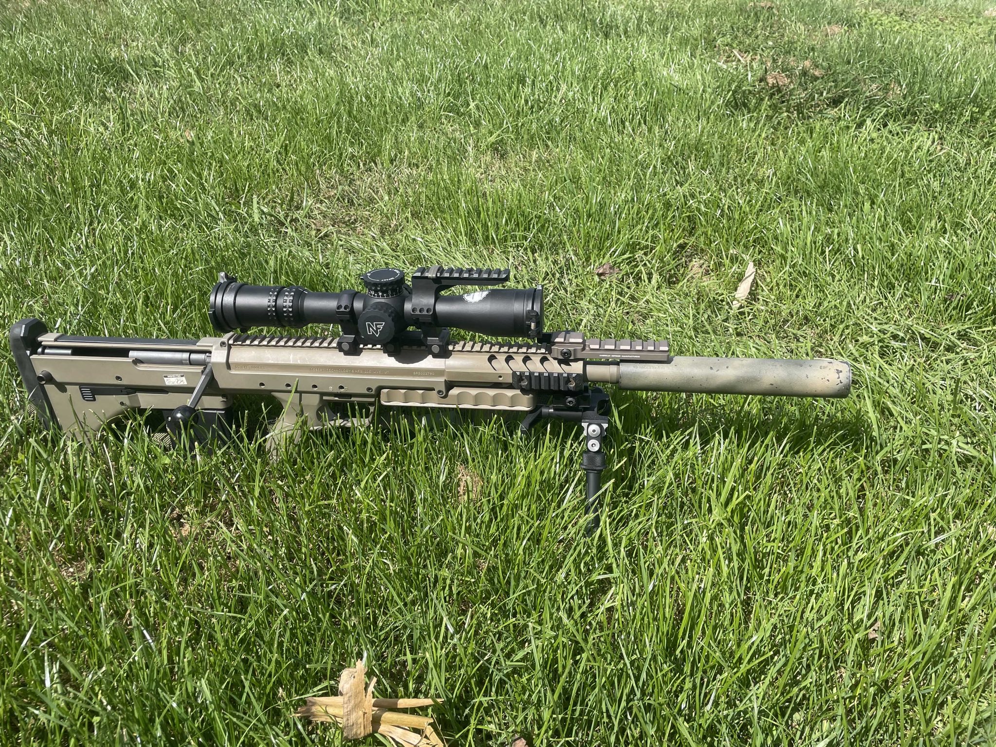

The Magnus is a hell of a can. Wish it was around before I bought an Ultra 9 and 338 Ultra. It may look funky on a light, small, skinny barrel rifle tho. Definitely going to want a carbon fiber sendero just for looks with a can that fat
Reactions: Huskydriver
6.5 ultra 9 on 22 creedmoor is unbelievably quiet. I have not tried my Magnus on 22 creed but the 6.5 ultra 9 on 22 creed seems to be quieter than my Magnus on 6.5 creed

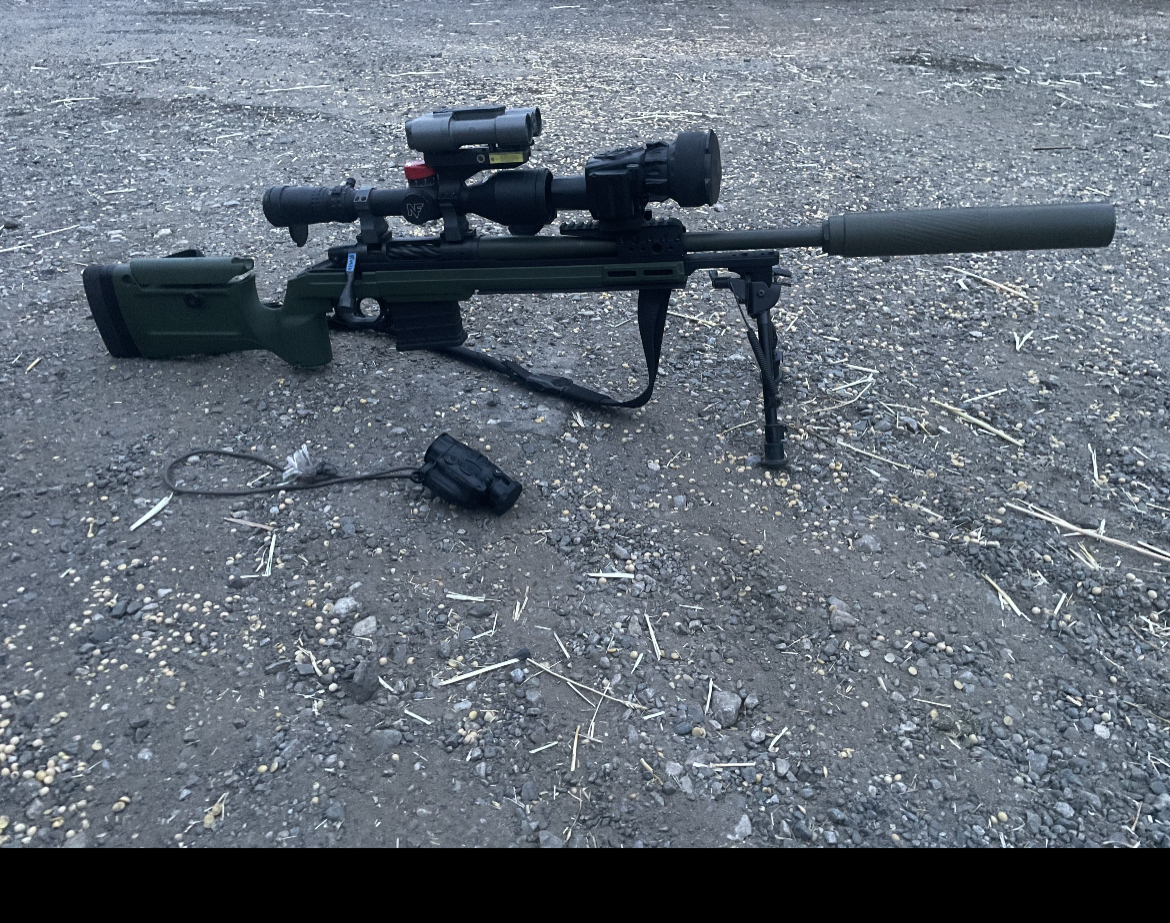

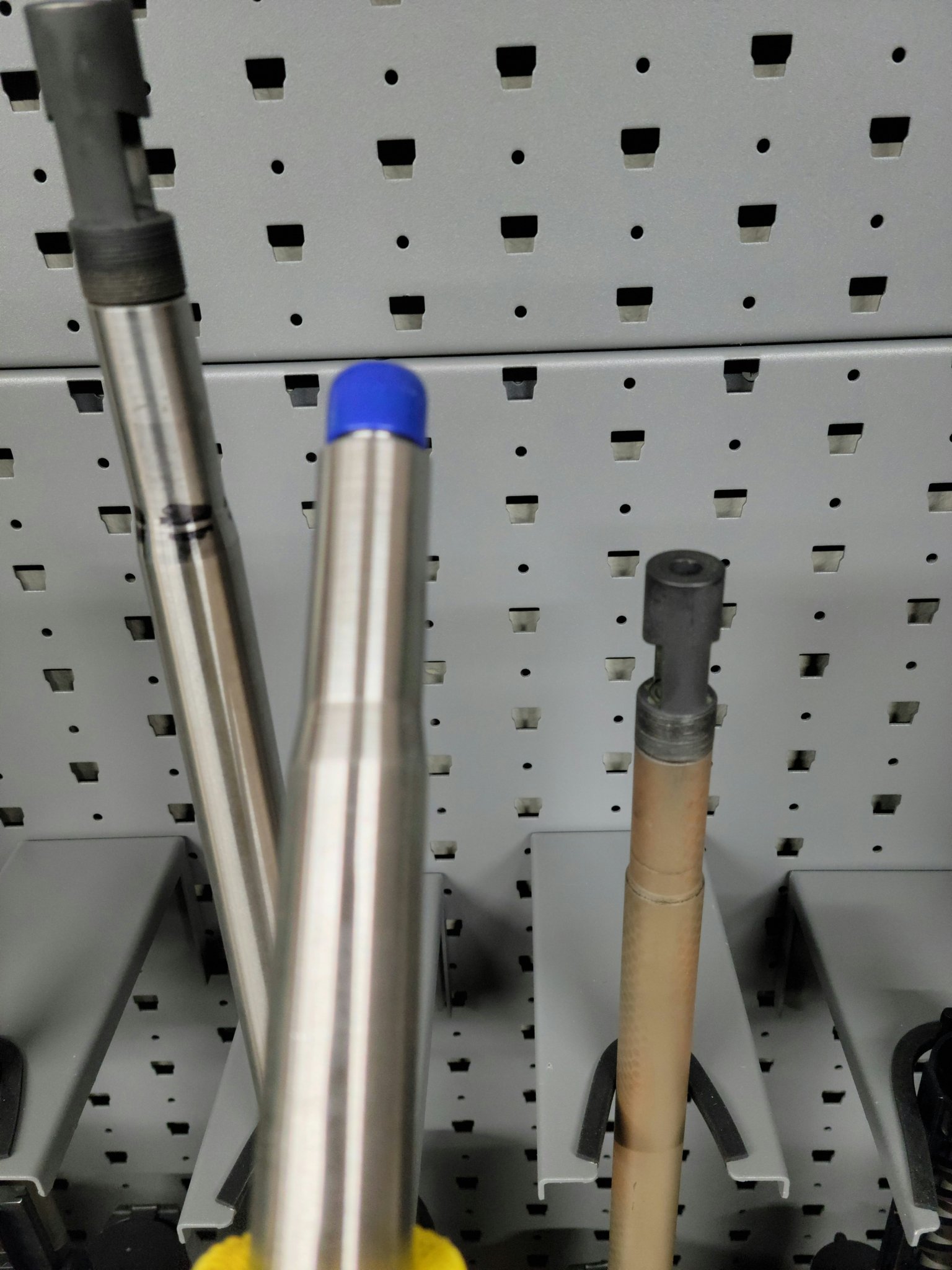

The 223 barrel is a Bartlein SS M24 at 18” and the x47 barrel is an M24-ish Bartlein brown carbon fiber at 20”, so a 1.8” diameter can should balance out nicely.
