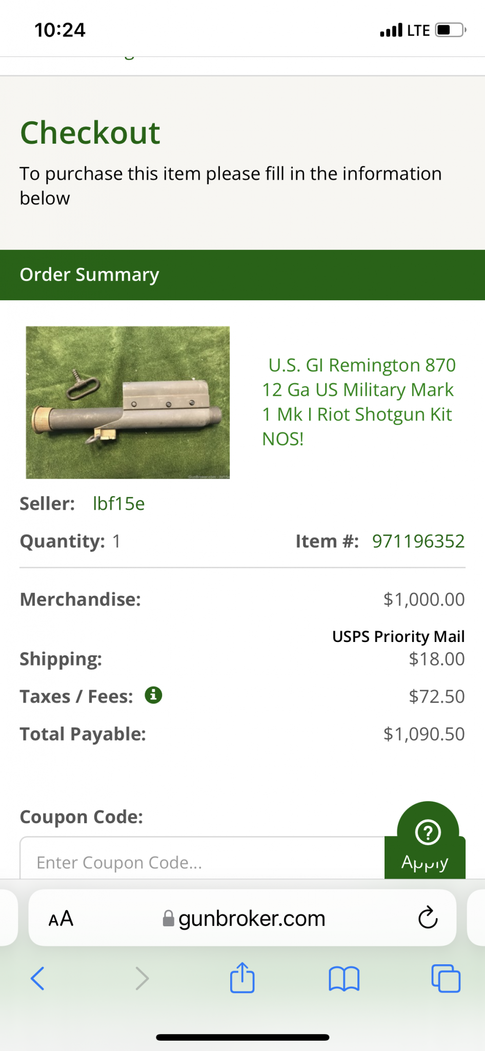

I said fuck it and increased my bid to a reeediculous amount at the last minute.
I just knew someone was going to pay more.
I have unicorns in my soul.
Reactions: lash

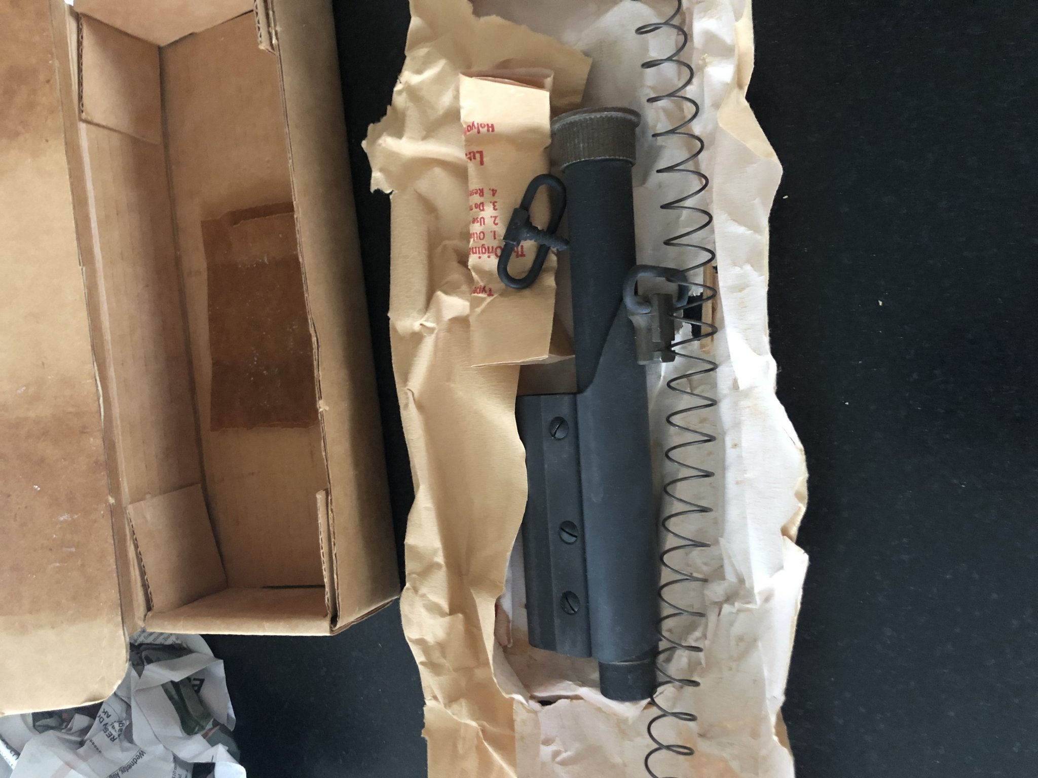

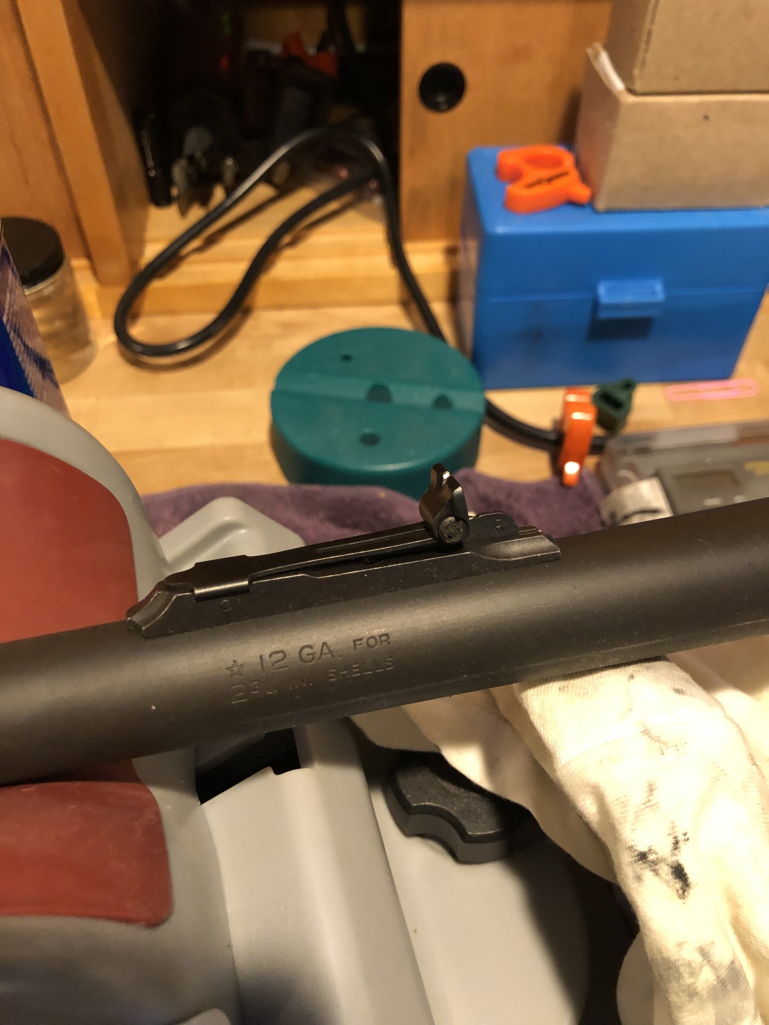

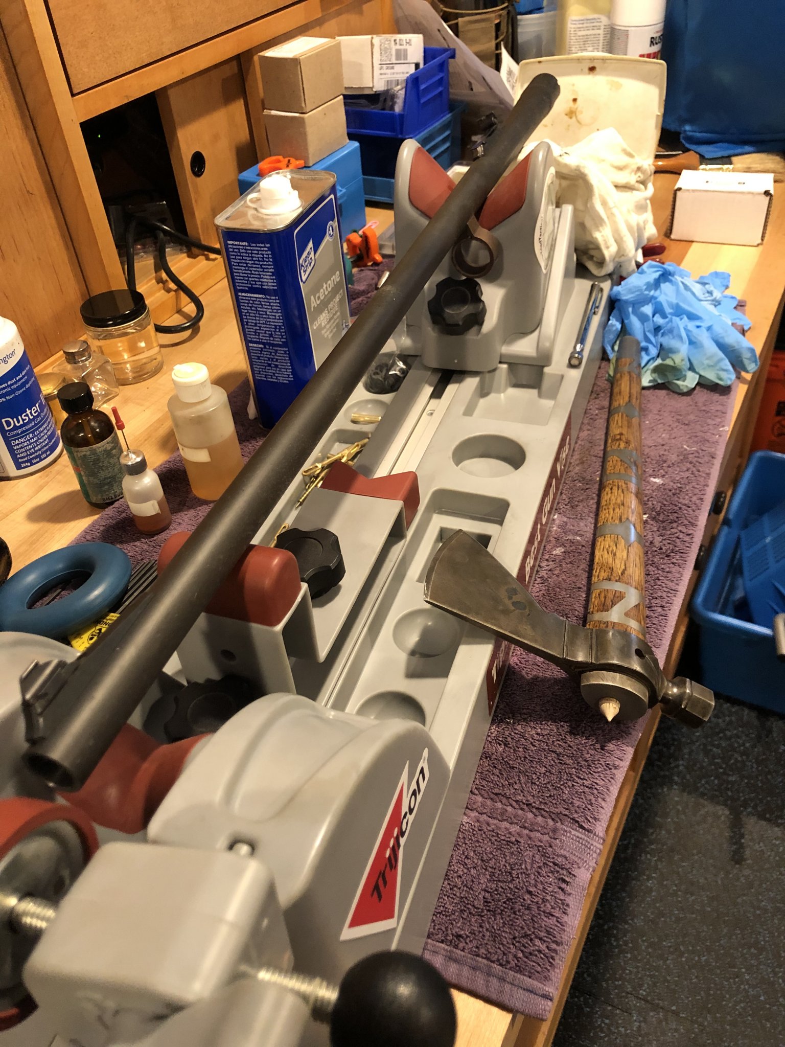

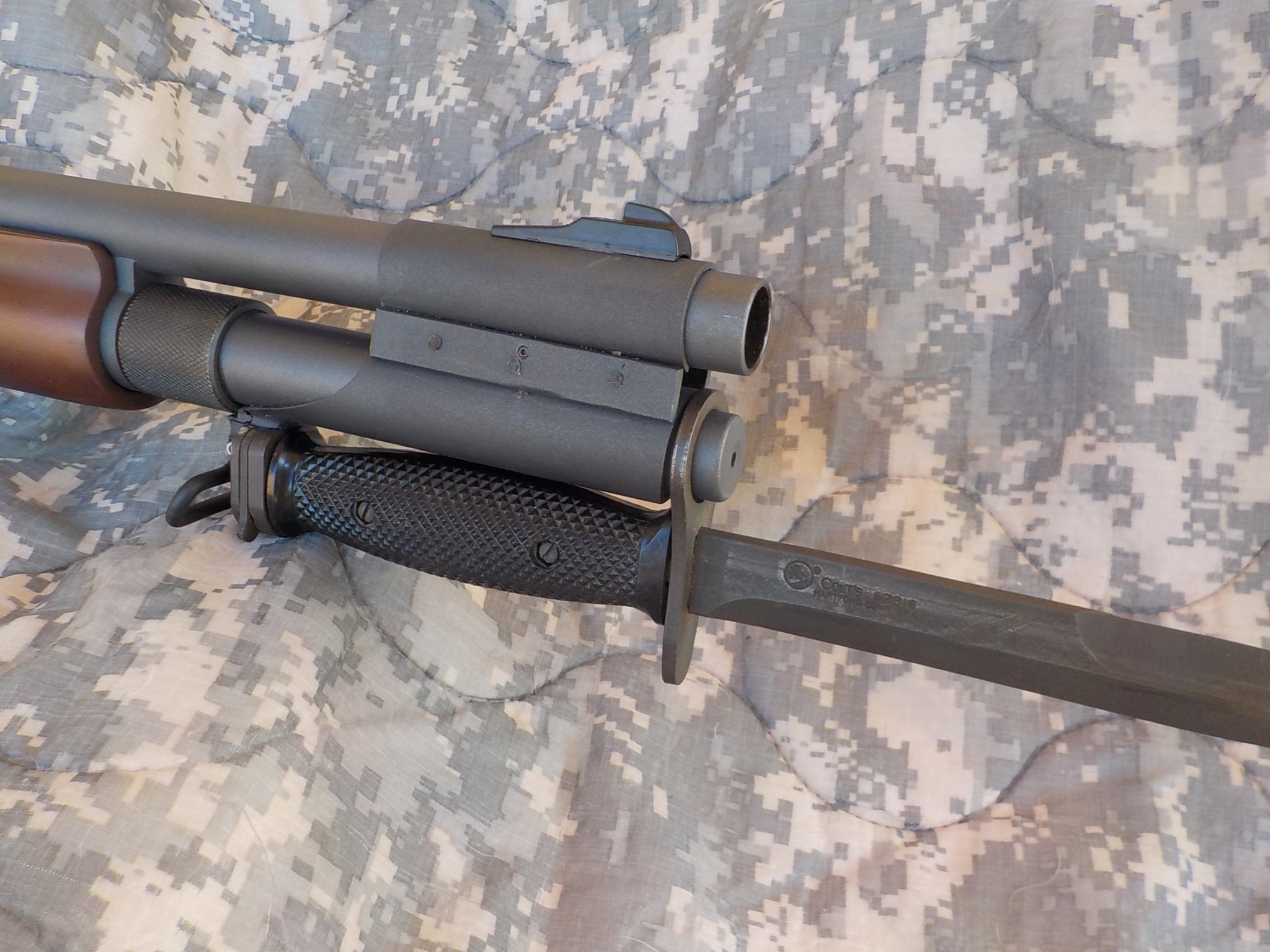

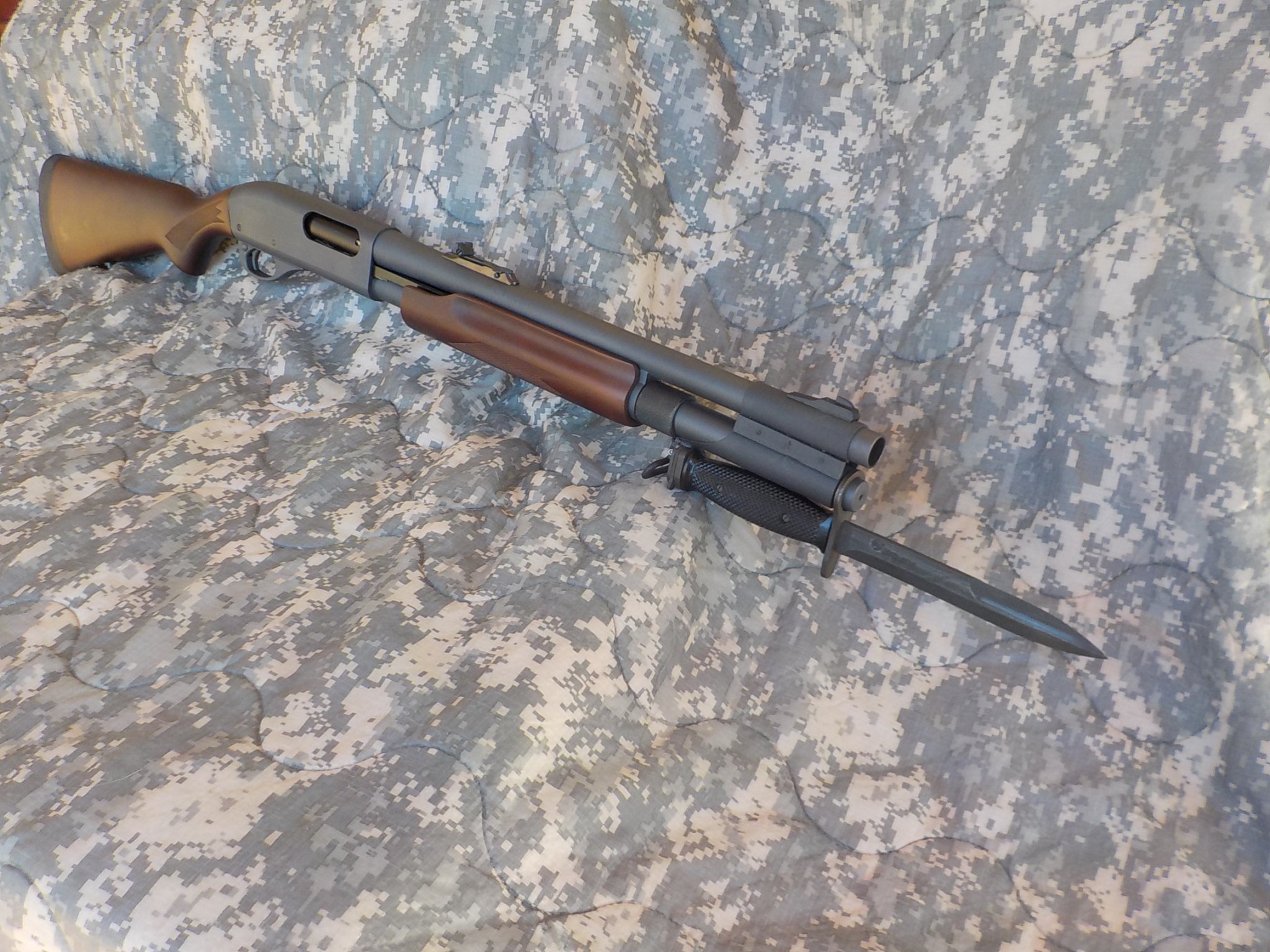

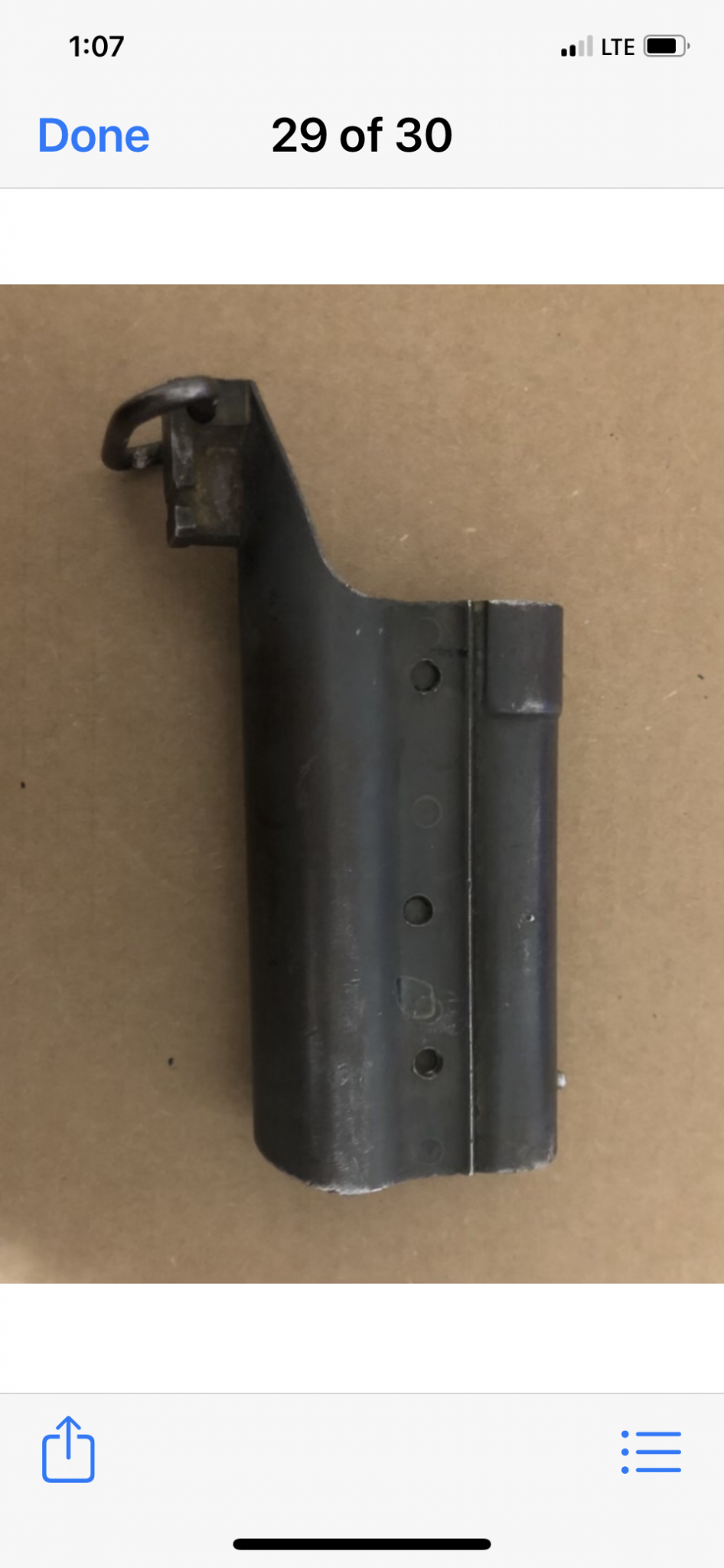

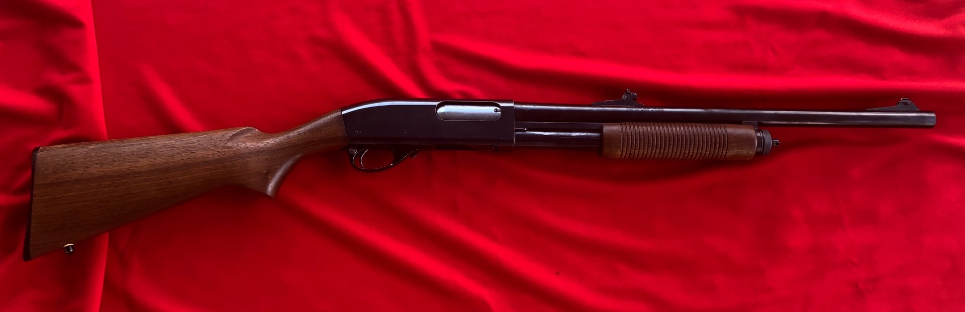

Now I have to get in touch with Steve at GunBlack in New York and hope he has good access to gunsmithing skills which I am confident they do.
He will be getting this 31 “ barrel….
Intent will be….
1. Unscrew front sight from barrel
2. Remove “bead sight” on bayonet adapter
3. Drill/tap bayonet adapter for rifle sight
4. Cut barrel to USMC Mk I length
5. Re park barrel
Hope he can keep the adapter it’s NIB finish. Should be able to.
31 inch barrel is a full choke, will probably be open when cut.
Fly in the ointment will be if barrel diameter is too big for adapter when cut.
From you fine people I need to know…
1. Some datum point and measurement to locate the blade sight on the adapter. Guessing from front edge of adapter to front of sight would be good.
2. Some datum point to locate exact line to cut barrel. If some good person wanted to remove their Mk I barrel and take a picture of a datum reference to measure from to the finished muzzle length the picture will be worth 1000 words.
@m1marty I need your knowledge.
Reactions: Average guy
In an amazing coincidence of dates last year this exact day I bid $1500 on a bubba shotgun that had a legit adapter solely intending to use that adapter and get whatever scrap value I could for the unwanted shotty.
I would have shit had I won because $1500 would have hurt. It was a grudge bid I tossed in with a minute left on the auction and about a few more auto bids immediately followed. I pretty much just wanted to be a dick and drive the price up.
I think that $300 dollar shotty sold for $2000 because of the adapter.
I actually think $1k was a deal unless I am unaware of a stockpile of these that has been found.
And I think you are correct that there would be a market for your clone.

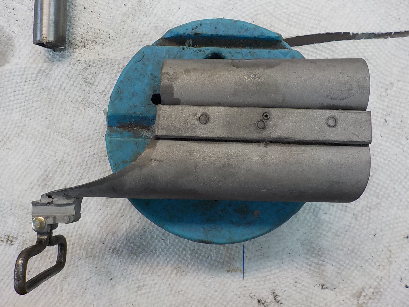

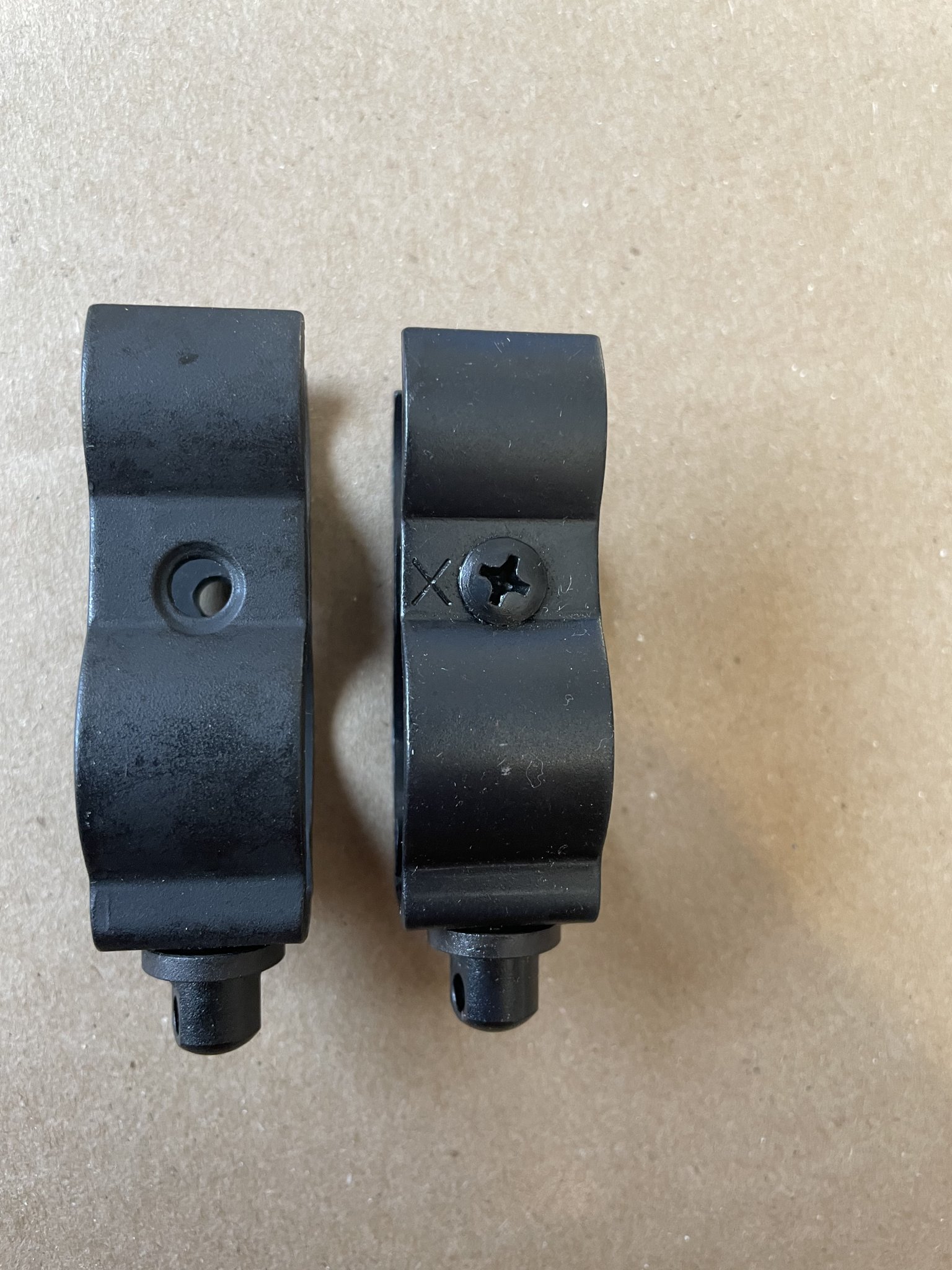

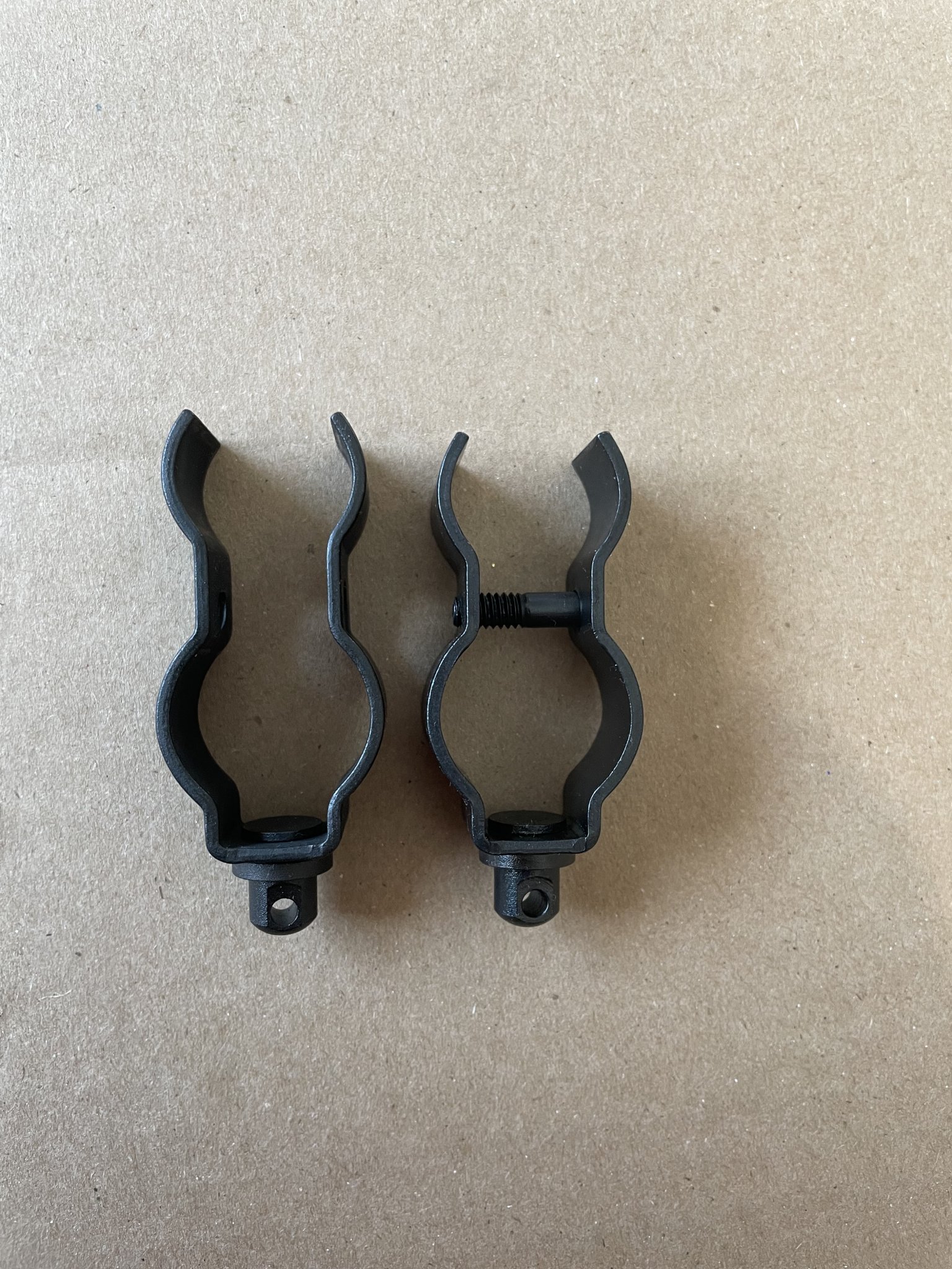

here’s another version with the recess for a heat shield that wasn’t adopted. In regards to not fitting over the barrel, the one pictured is/was particularly tight. I think you’d want to use a lathe to get the OD down, modify the replaceable part.
This other info pointed out to me is the difference in factory mag swivels early vs late? The ones marked with an “x” vs not. The distances between the factory mag extension and barrel are different.
Pretty sure my current mag extension support is marked "X".
The receiver should be early 70's if that determines anything with barrel/magazine separation.
Need to get some measurements to determine barrel length from some datum point I can use to mark it as it sits now.
Also need some measurements to locate the front sight on the bayonet adapter.

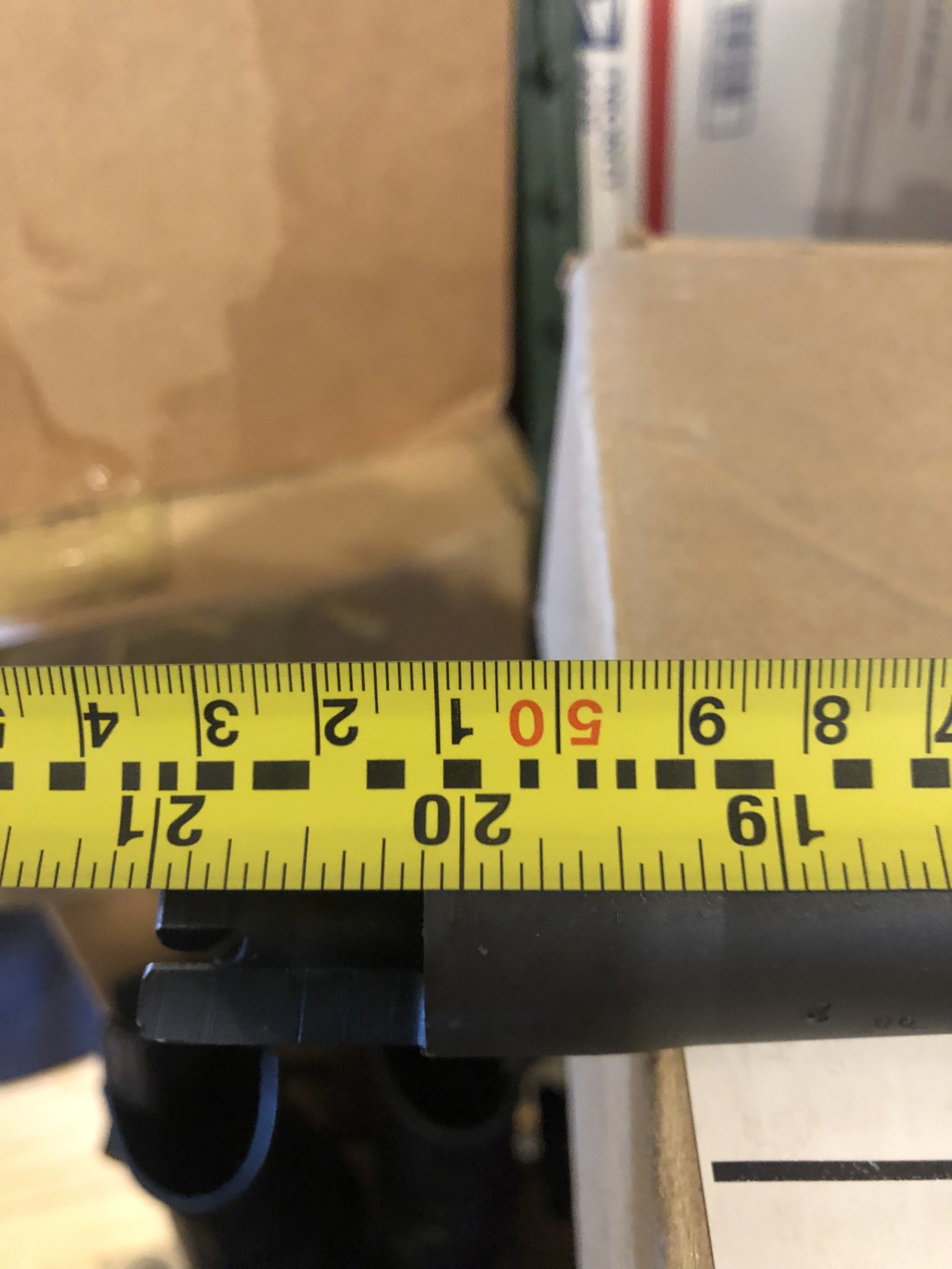

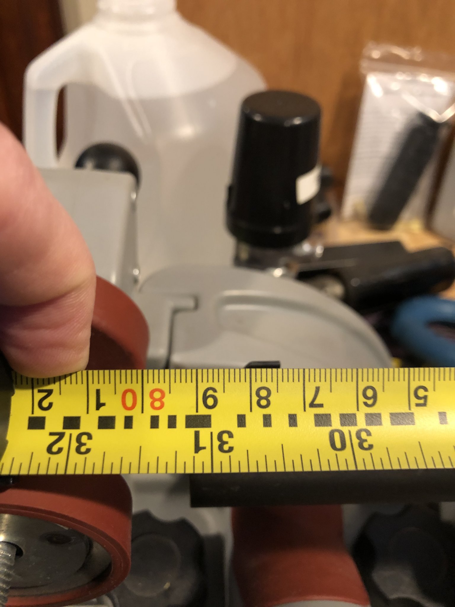

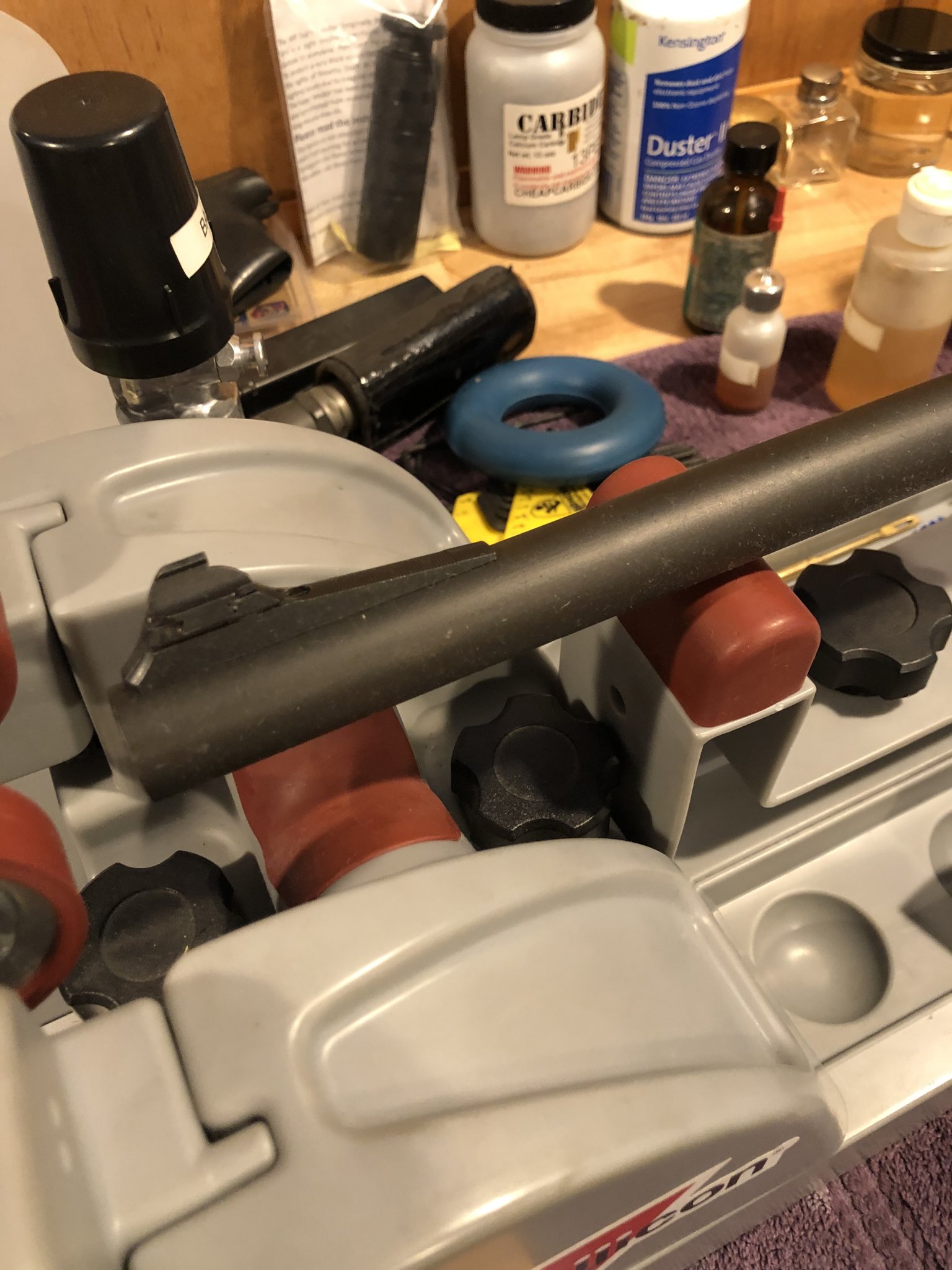

Trying to figure barrel length to have my MKI barrel cut at
I measured the existing barrel and from muzzle to breech end minus the tail is 20-1/8. Seems legit for what I think is a 20” police barrel, smooth bore with rifle sights.
If I measure out my long barrel I need to cut at 21 inches this is the look..
Seems about right.
Anyone have any means for me to get this perfect please advise.
I think when I send the barrel out to get cut I may also get a screw in choke system installed. I’d like to run a Modified choke in it. Won’t be legit but nothings legit anyway. Might as well be functional.

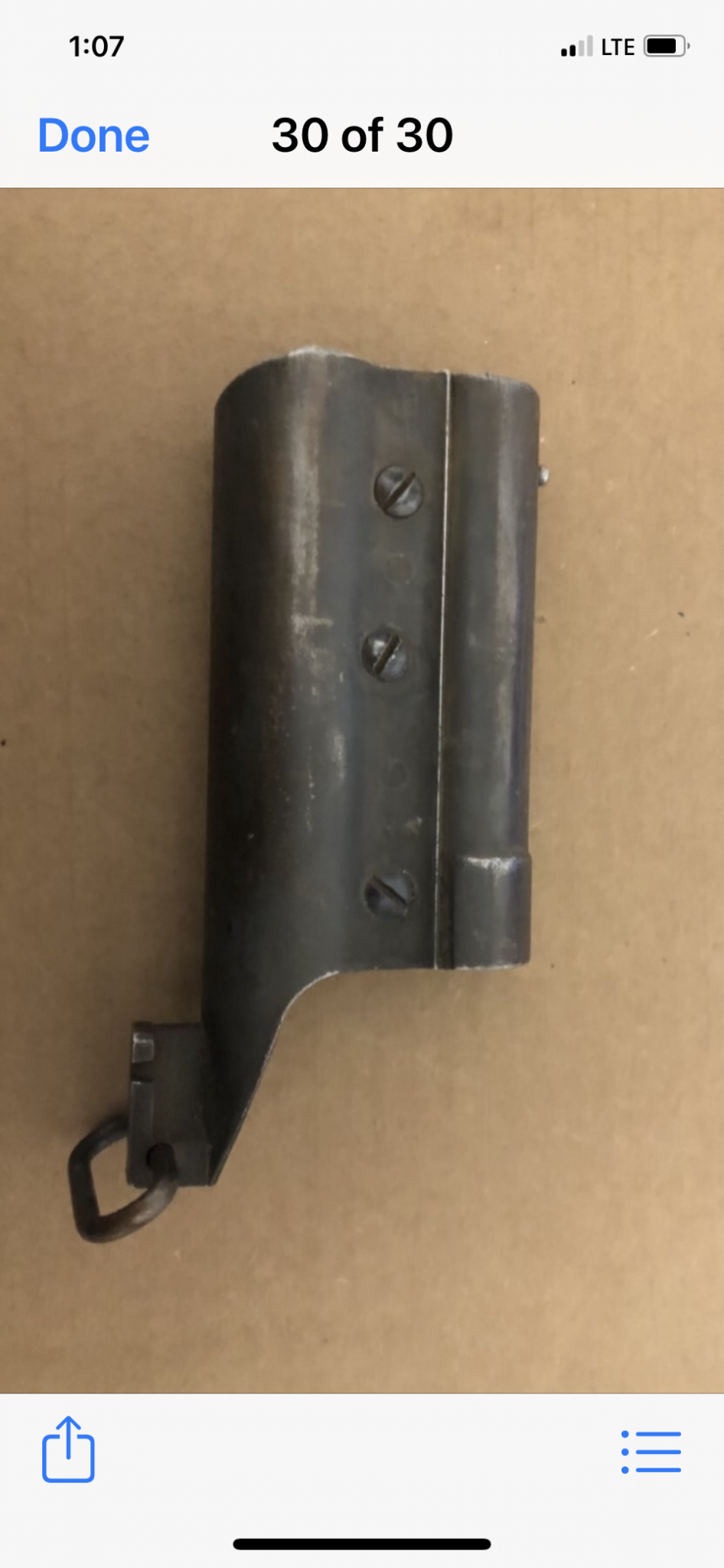

Anyone that has an adapter with a rifle sight I need to know how far back from the edge of the adapter it sits and I need to know if the sight base has been trimmed so as not to have the sight sit too high on the adapter for the rear to mate with.
