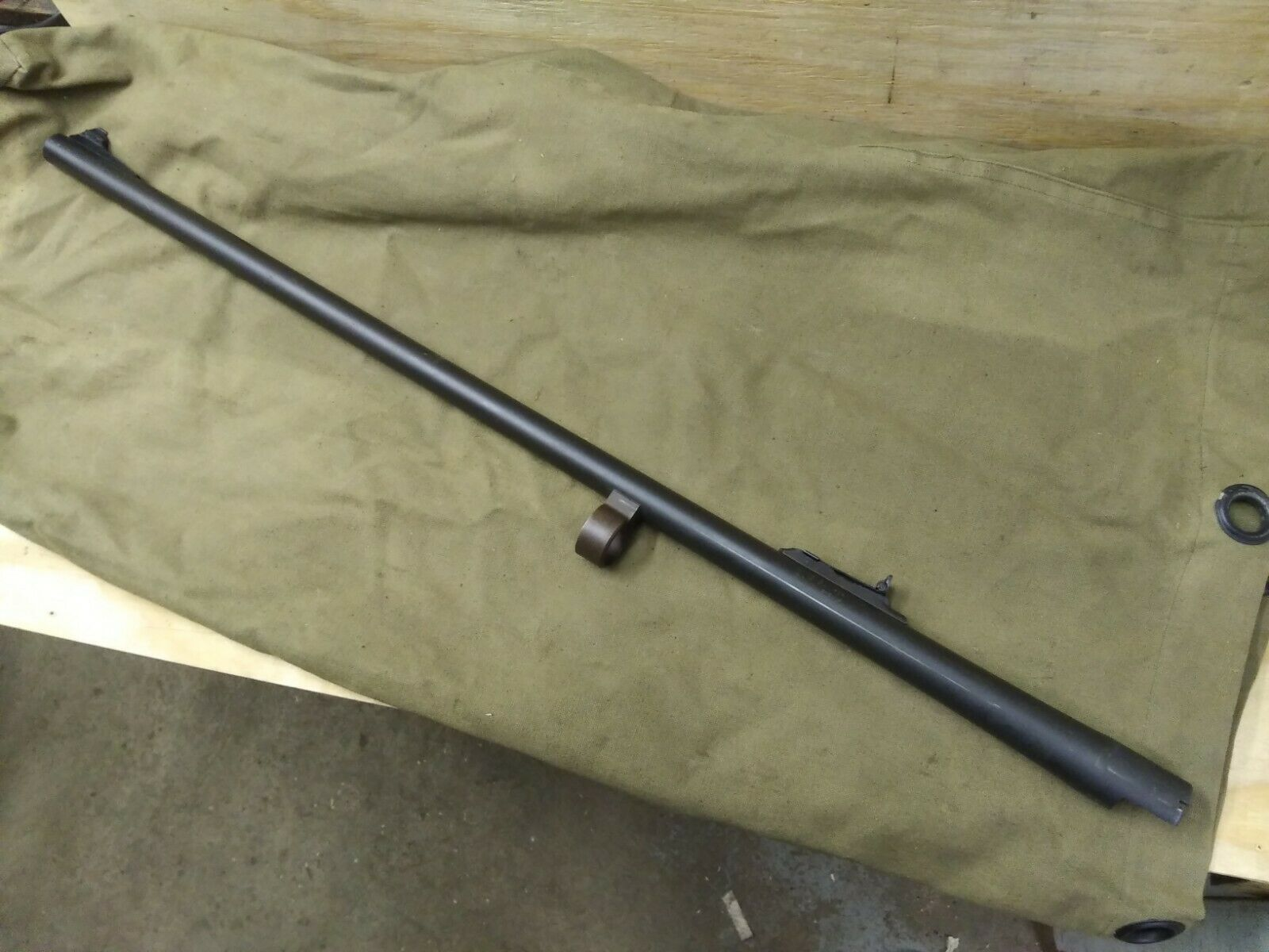

Pictures on page 2 are of that gun.
My current barrel is too short to be an accurate clone but I'll likely not find an adapter any time soon either.
Thinking to get it built as is, maybe look for an old Wingmaster bird barrel, hack the appropriate length of material off to make the correct length and in the future if I come across an adapter.....build it over with the new barrel and a rear sight soldered on.

My barrel arrived today.
I couldnt have ever expected to get such a perfect specimen for this build.
Heavy wall steel, perfect sights, already parkerized....looks like its a mil gun take off.

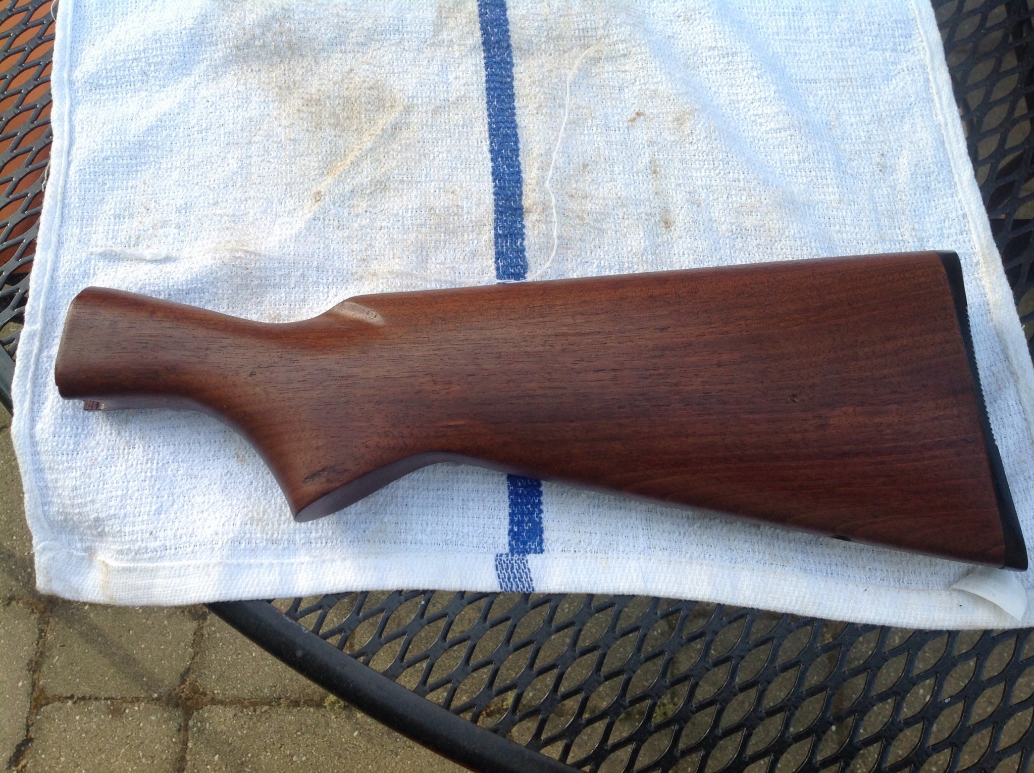

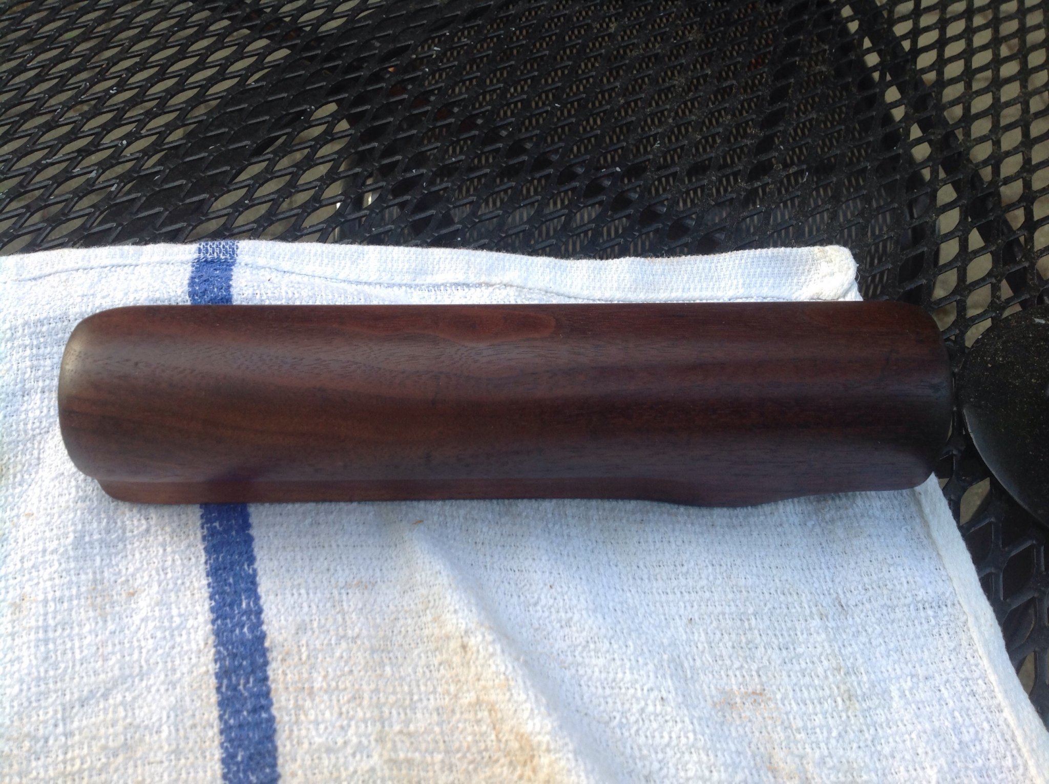

and my wood.........Its coming out fantastic. Spending alot of time in the sun. Sunshine makes linseed oil "da bomb".

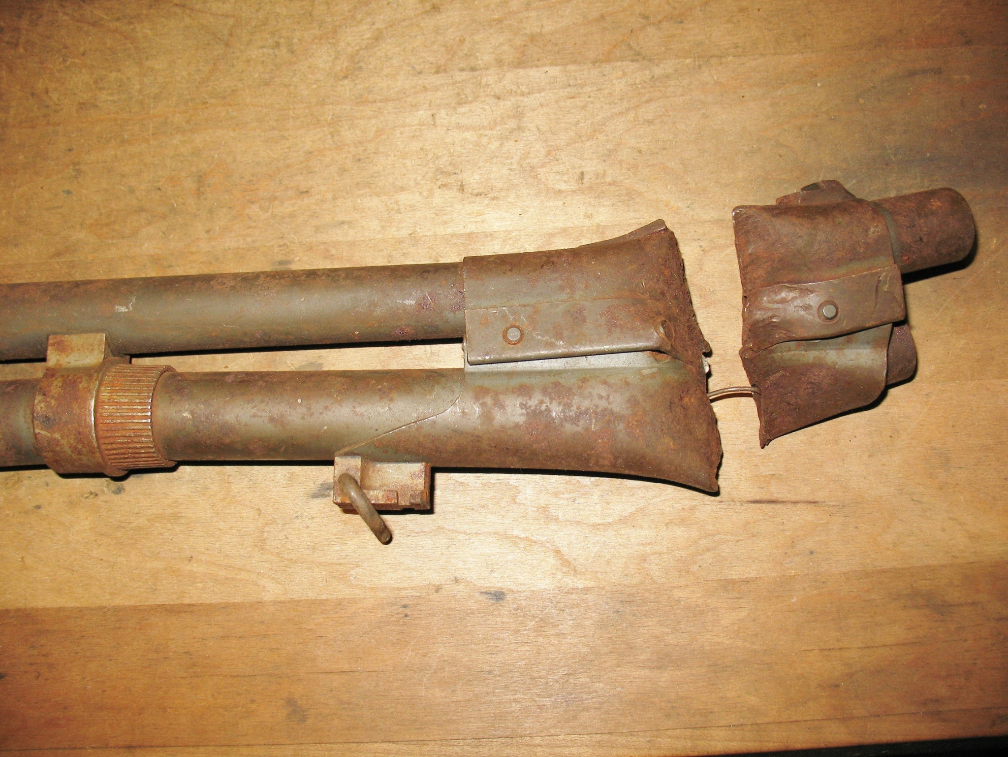

One interesting thing shown in pics of the M870 Mk 1 from the 1980-90s - is that not only were the rear sights often removed, but the front sight blade has often been drifted out too, so the only sight on those USMC M870 was the remaining front pedestal and I guess what is left of the rear sight pedestal that lacks the sight leaf. Just an observation that Canfield makes about this particular shotgun.
Good luck finding the bayonet adapter...but you are closer than you think:
Who...buys a 30" slug barrel?
Anyway its got a correct Mk I rear sight...
...and I think the correct front sight too. If you could find the later bayonet adopter with just the brass bead, you could remove the bead and likely use the front sight you got on that 30" barrel - as it could be brazed to the bayonet adopter and give you the same aesthetics at the old Mark 1 bayonet lug. Just my 2cts.
