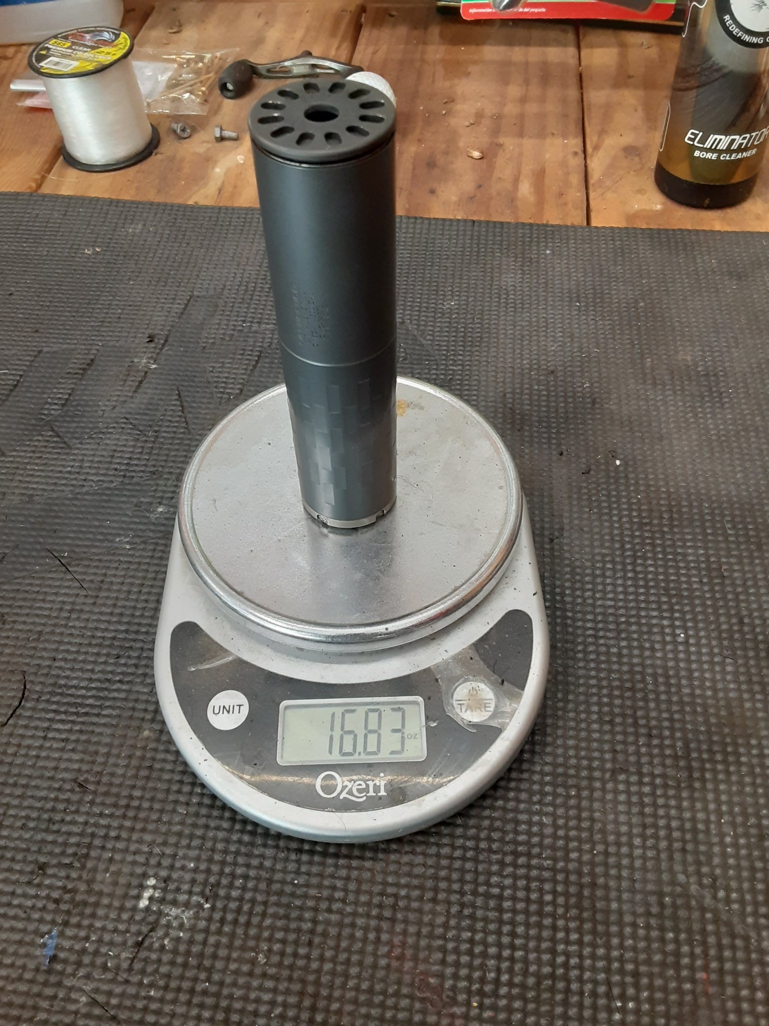

YHM TI Phantom 30 cal 17.74oz Listed 15oz
YHM 5.56 SS QD 23.13oz listed 20oz
I am sure I have scraped 3 or 4 ounces over carbon out of the the blast chambers. I wasn't expecting my silicone suppressor cover to weigh almost 6oz. I wont be carrying that hunting anymore. LOL
YHM 5.56 SS QD 23.34oz listed 20oz

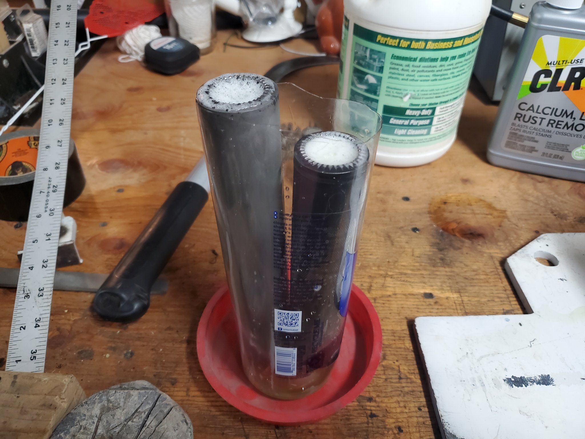

True, but my dumbass has this 9” suppressor, so I just plugged one end and stood it up in a tall bottle. Too cheap to waste the 25-30 oz of CLR, heh, heh.

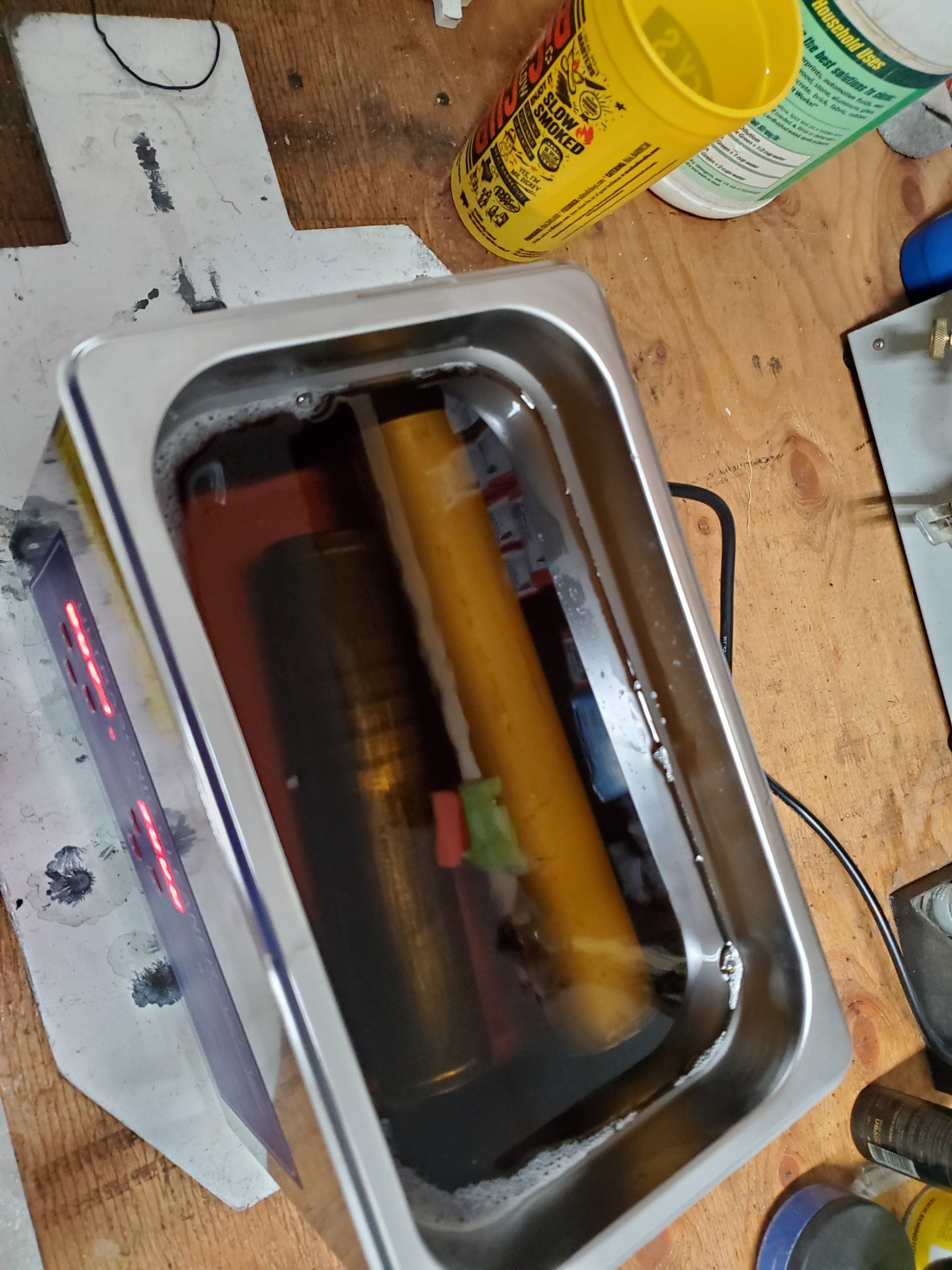

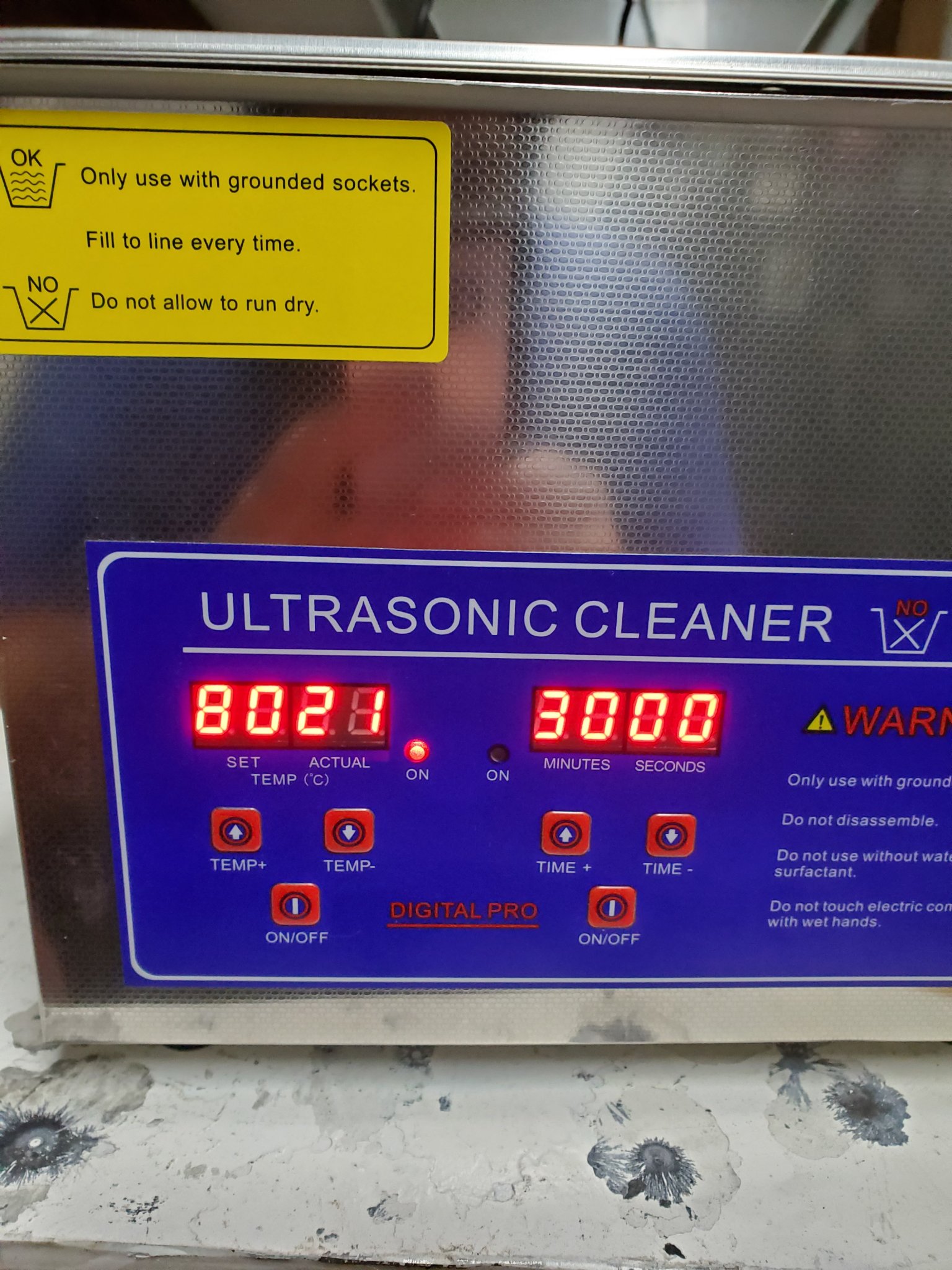

My simple green is so old it's turned to simple brown. 🤣 I filled the tank with 50/50 mix and put the suppressors in to soak while the tank heated up. Then I logged in. So I took them back out blew them out with air some. Cut open a tall smart water bottle. Plugged the ends with foam ear plugs and filled them with CLR. My tank has gone from 21C to 40C in about 20 minutes. Target 80C about what you cook a turkey to. I wonder if I can fashion an ar-15 gas tube to the garden hose for a 90 degree rinse. I recon I got gorilla tape. So definitely can. 🤣🤣🤣
I wish I had one of those water ballon fillers around. I bet it would be easy to fashion a gas tube to one of them. I might have to run by the store tomorrow after work.
My current plan is CLR soak for an hour. US clean for 30 minutes. Rinse, blow out, weigh, put in the freezer and go to bed. Start over tomorrow after work when I have a little more time before bed. I wonder if the CLR is still doing anything when its stopped bubbling?

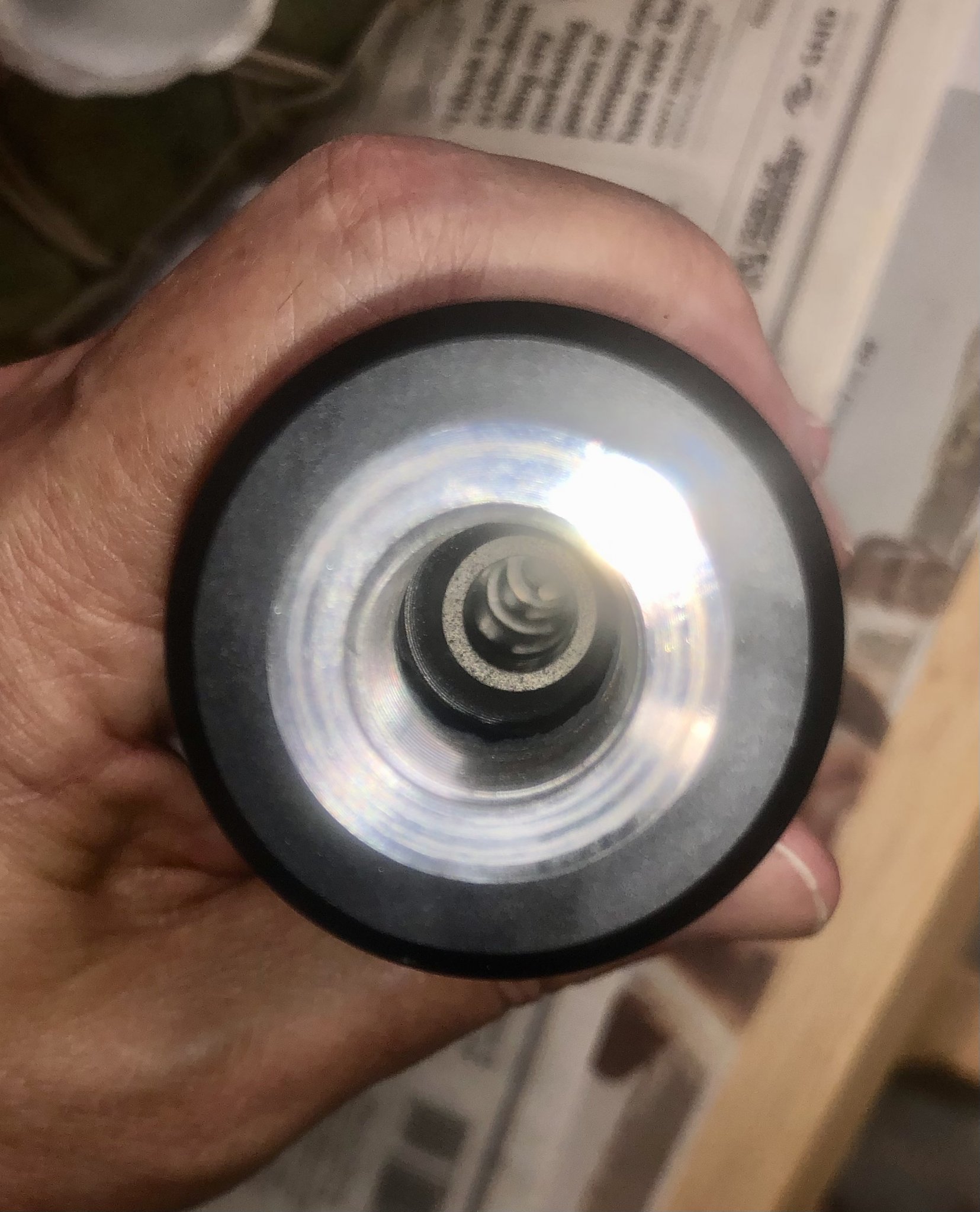

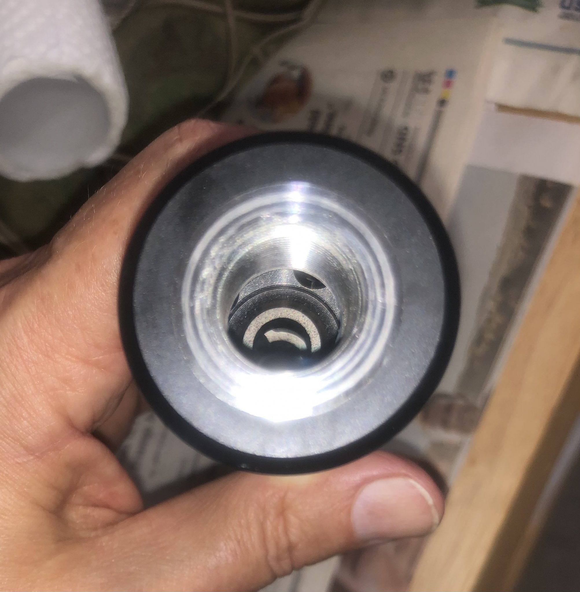

The 1 hour CLR soak is done. It was still bubbling so I saved the CLR in a jar. I rinsed it with hot water in the sink. I could see some carbon rinse out, and the first baffles and blast chambers are noticeably cleaner looking. I blew them out with compressed air for a while until I didn't see any more moister seeping out either way. The TI can weighted 17.74, the SS was 23.20. So no real weight change yet. I assume the carbon has probably absorbed some liquid and weighs more now. I just dropped them in the USC for a 30 minute cycle.
I wonder if the carbon absorbs water then the water cracks it when it freezes. I wonder if a good dawn dish soap and hot water soak, then dry and freeze would do as much good as anything.

The simple green mix in my USC looks nasty and black now. I started a second 30 minute cycle. I am torn if I should.
1. Let it soak in the simple green all night.
2. Refill with the saved the CLR overnight.
3. Put in the freezer over night.

I knocked a bunch more out of both with new cleaning liquids and running them one at a time in the drip tray. Instead of dropping them both in the bottom of the tank. My USC sounds a lot diffrent and agitates the water a lot more with one in the drip tray instead of them both sitting on the bottom.
Looking at it from either end they look perfectly clean but they are still dropping some big nuggets out of the middle.
Weighing them and doing it at one ounce seems like a good approach. Taking out one ounce didn't take very long.

Yeah. If your cans are resting against the metal US tank you are defiantely killing the vibe (HA!). Metal on metal jacks with the transducers efficency.
The TI was weighing 15.37-15.31 last night. I CLR soaked them overnight. I could see the carbon in the CLR in the SS can. The CLR in the TI can was clear. I USC'd them for for about an hour and half with with about another hour of just hot soaking. The TI was showing 15.34-15.30. The SS dropped about a half ounce 21. I can still hear big chunks rattling in it. I am CLR soaking the TI with it just to see if it looses some weight. Again. I think about 15.3 is going to be baseline clean for it.
I managed to get them both in the drip tray.
