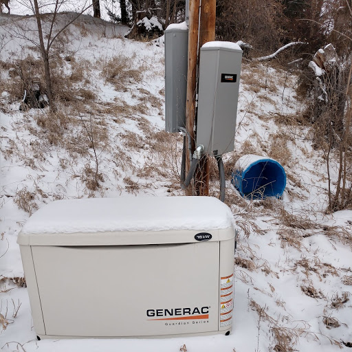

Maybe 20 yards away and down the hill the house sits on
It is right next to the REA (rural electric ) meter
Then branches out from there to house, well, other buildings and corrals

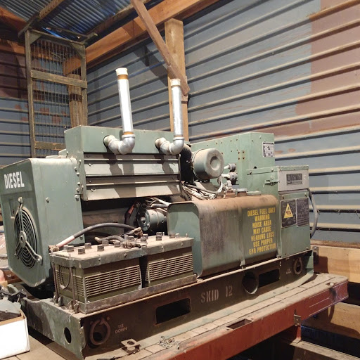

I've been around a lot of generators. Yes, I can read a manual and know how to store them. You still have to deal with fouled carbs, constant refueling, and frequent oil changes. We're talking about generators for an emergency, not a holiday vacation. You need something that can be put into operation immediately. If your car runs, the inverter will power your essential devices just by running an extension cord. Also, it's self propelled and you don't need to wheel it around.
Probably well before your time sir!
But what I used before I got my Generac
Loud is an understatement😳
