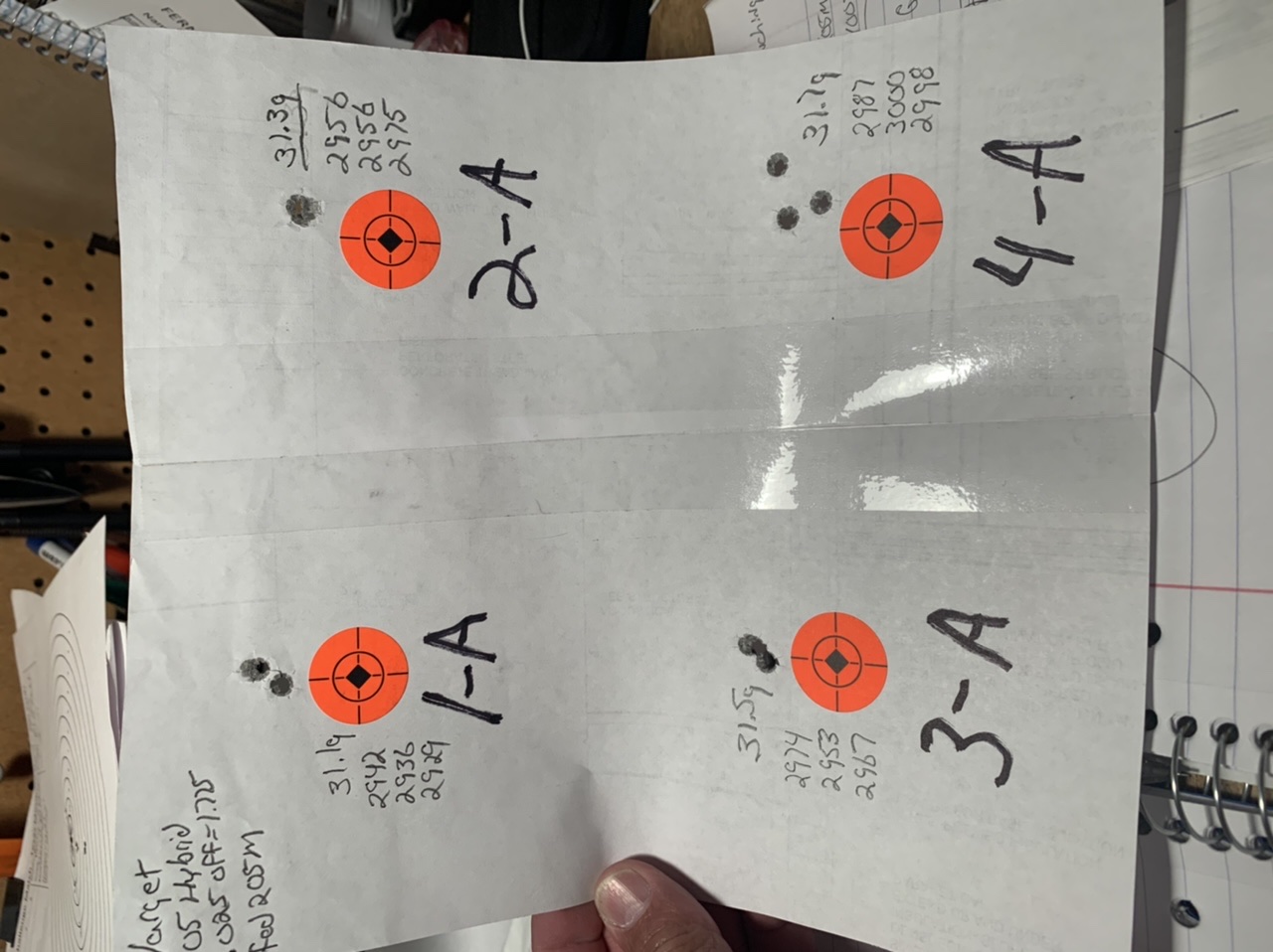

Not trying to hijack this post. But when looking for the best nodes, what criteria do you use to discriminate the best node out of the possibilities?
This is what I’m looking for when I do my initial load development....
I want to see 3 tight groups over a .6g difference in charge weight...this is an exceptional barrel but I’m looking for 1/2” or so that the POI remains the same or real close I then chose center load and shoot it at 600yds and tune with seating if needed.
