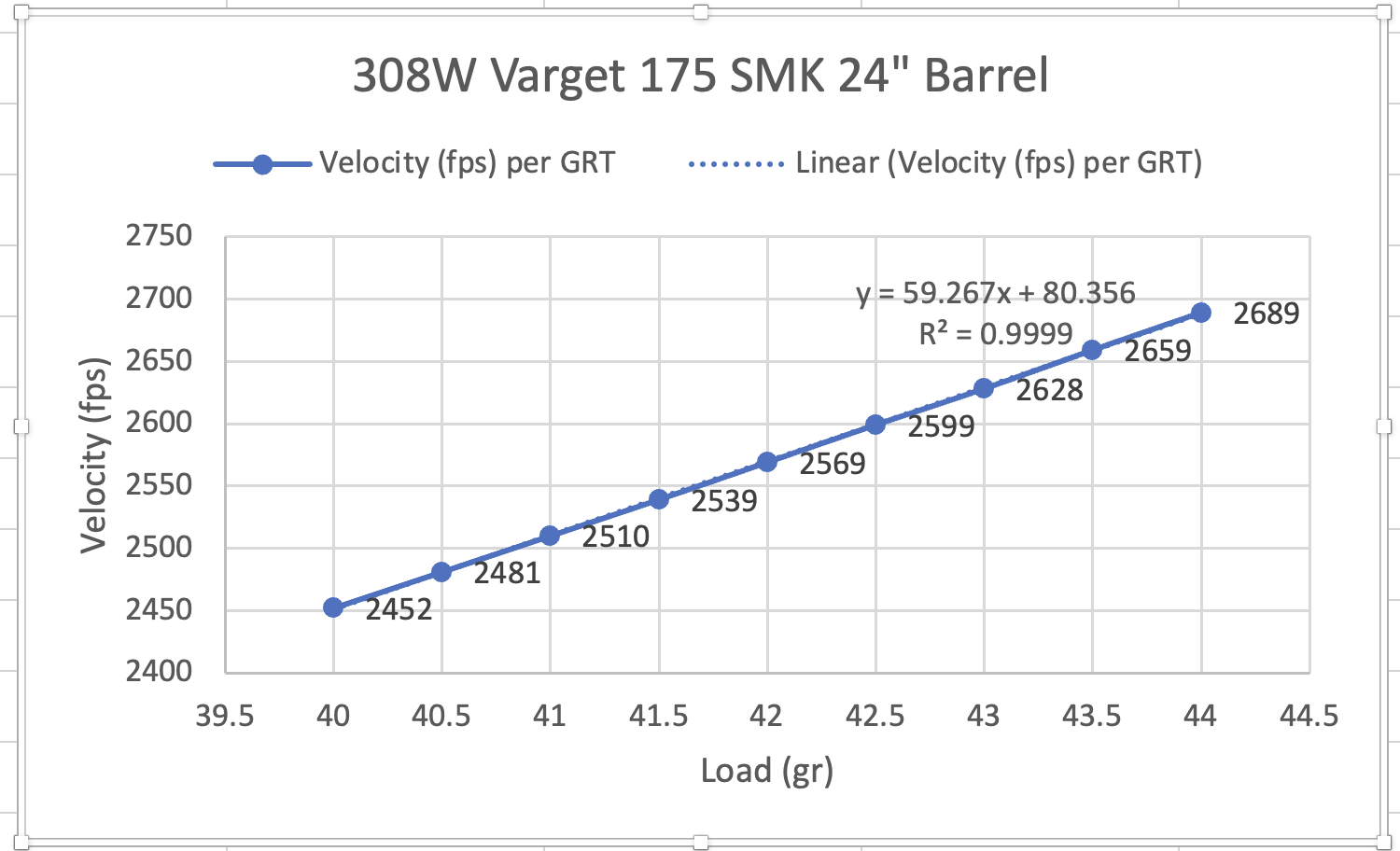

The velocity I quoted (9 fps) for 4350 is from Gordon's Reloading Tool (GRT). A program similar to Quickload (QL) and benchmarked against QL. For the 175 SMK and Varget the same 9 fps applies. If you are trying to measure the difference in velocity for a 0.1gr increase in powder charge you are going to have an issue with separating the effects of powder weight as opposed to other variations in neck tension, powder orientation, primer effects, bullet variations, measurement uncertainty.
As for linearity it is true that velocity versus powder charge is not linear but in the normal loading range of cartridge compatible powders it is very close to linear. The plot is for 308W and Varget from GRT for a 3 gr range. GRT (and QL) simulate the the powder effects only holding all the other variables constant. If you look at the lower velocity increments you see the effects of decreased filled ratio and lower pressure along with lower burnout have on the charges.
As for testing, to properly test for changes in powder charge, to be correct only the powder charge would be changed but unfortunately when we try to do this we are actually changing everything. The case, bullet, neck friction, case volume, barrel condition, powder (geometry) powder position, primer, seating depth, chamber temperature, instrument uncertainty, etc. We can minimize these effects but we can never exactly duplicate one shot to the next. It is all of these factors that contribute to the standard deviation and extreme spread of a given load.

0.1gr Varget is roughly equivalent to 6 fps. You decide if that is acceptable for your application.

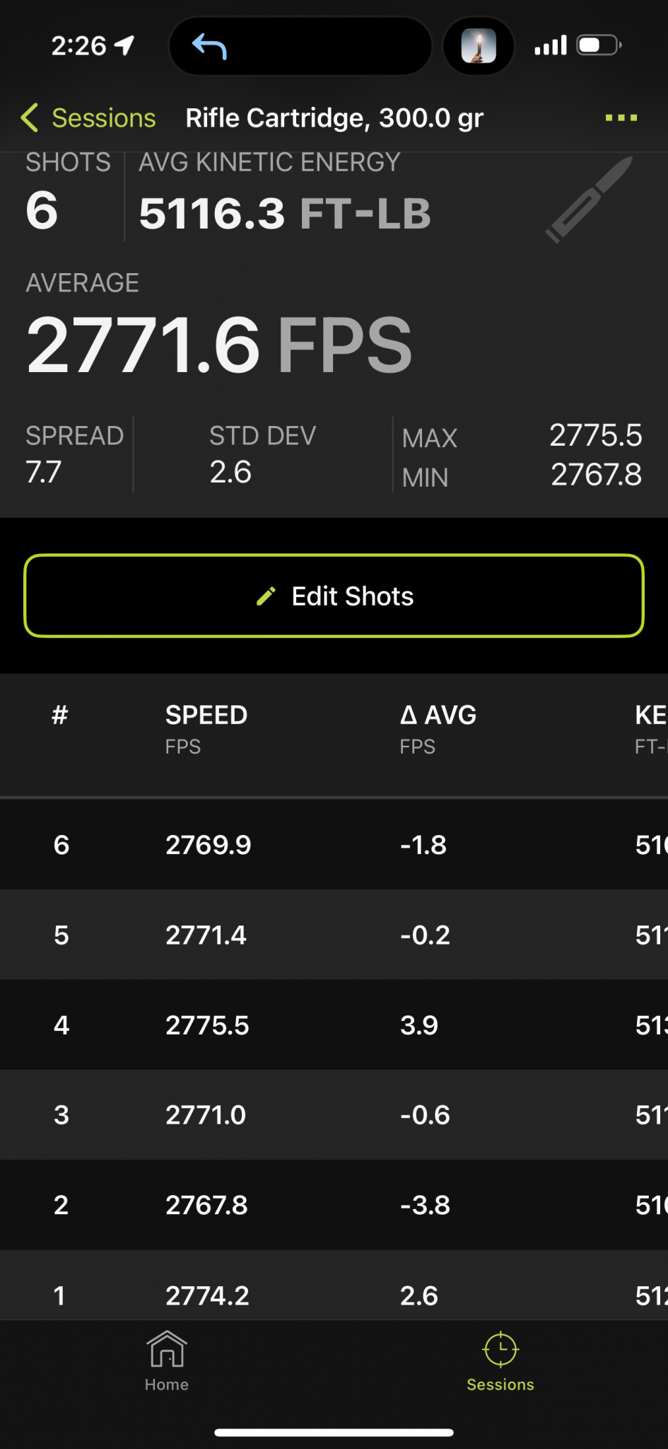

After using the A&D for the first time I achieved this for my ES/SD
Recipe
300 gr Berger .338 OTM
91 gr retumbo
Lapua brass
Cci 250
Base to ogive of 3.055 inch
That’s a single digit spread.

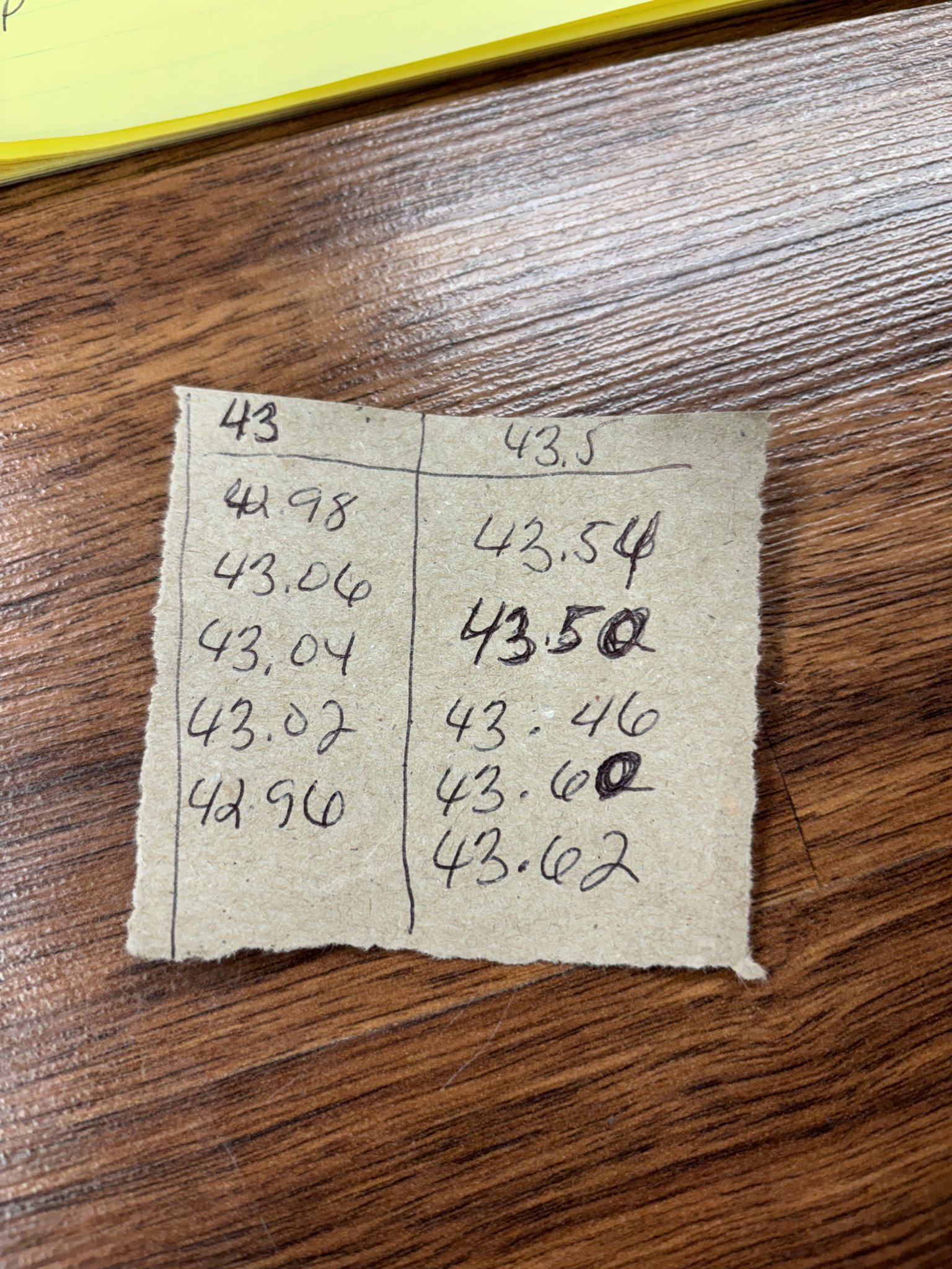

I just got a 120, last week
Here is a pic (if you can read my chicken scratch)
The left side is 43gr and the right side is 43.5, using my CM to drop the powder. Then using the 120 to check the weights.
This is closer to what I found also.
