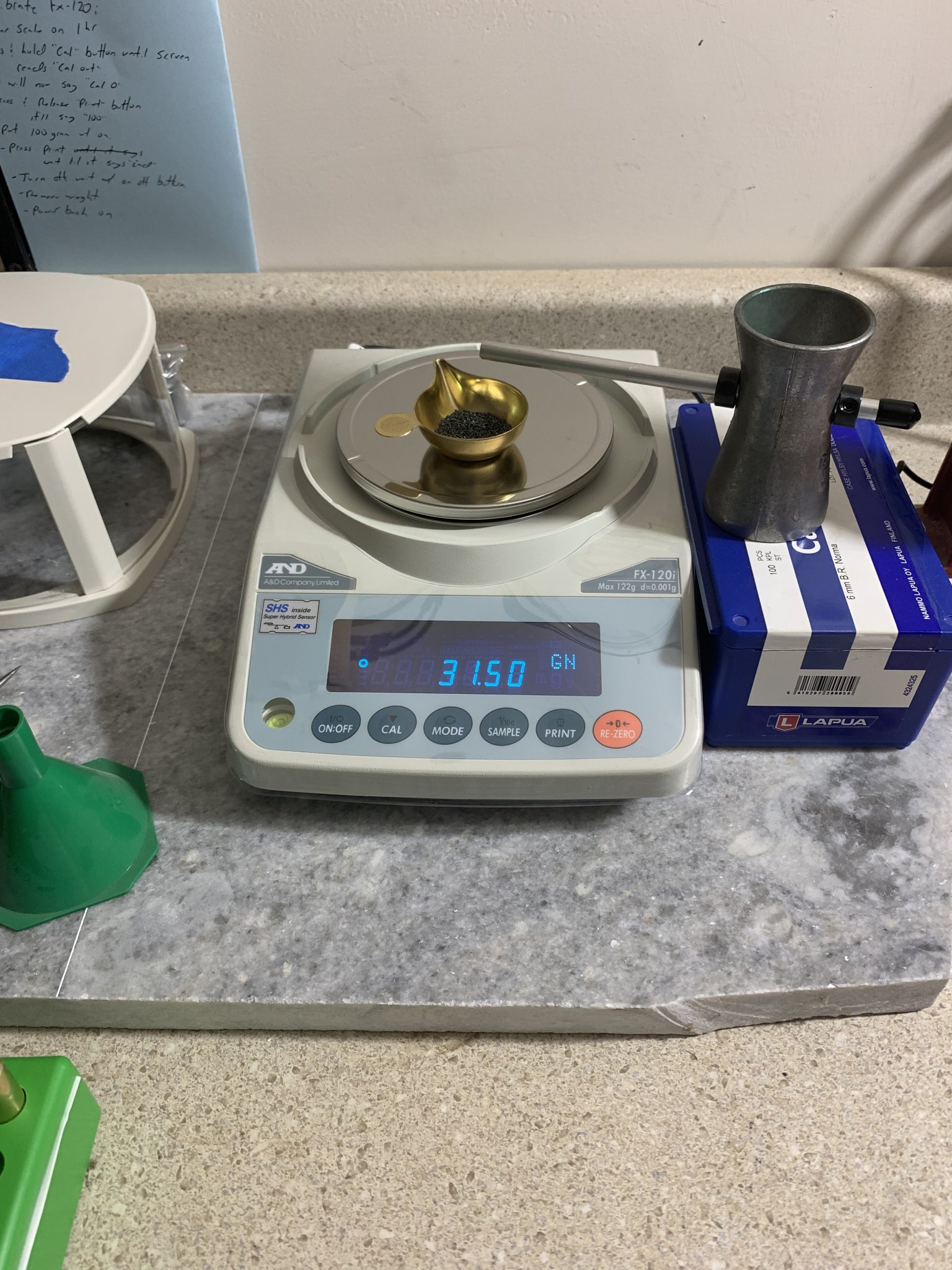

For the longest I have used a Gempro 200. They have been out of production for some time, however, they do come up for sale on occasion. I did buy the FX120 a little over a year ago and it is a game changer. If the Gempro is warmed up and calibrated it has never been more than .01 gr. Off from the FX. And both can drift slightly over time.
