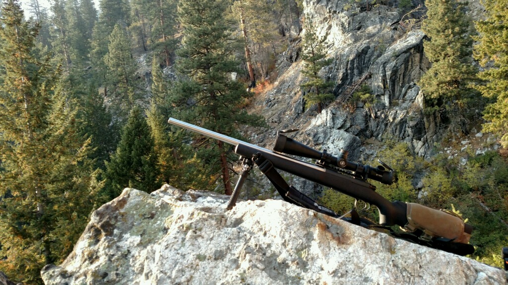

I had a reamer made for my 7mm-300WSM, but I decided it wasn’t worth fighting to fit a longer ojive. I wanted a BDL internal mag (for smooth bottom) hunting rifle.
I decided on the Berger 168g classic hunter. Fits in all standard short action stuff easily, recoils less than the 175/180’s, kills deer and elk effectively, and the ballistics carry 1k lb/ft out to 1k yards.
