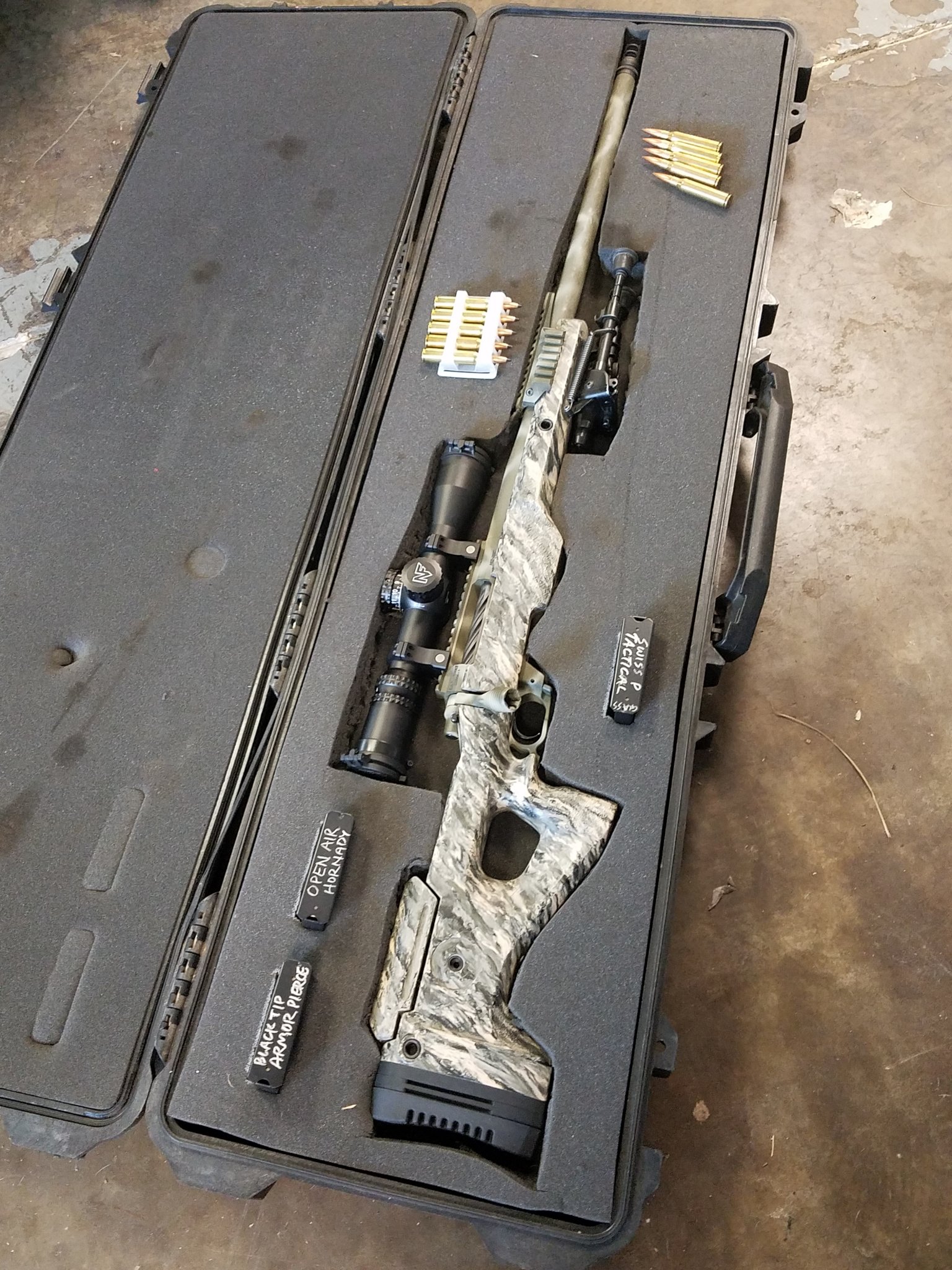

I assure you that a properly spec'd and built Defiance can run exceptionally well on a true working "tactical gun" .
This is one of 3 LongSwords built three years ago for an agency. It is laying in my shop floor due to me having them rotate in for a bottom metal upgrade. You can't tell from the pic but this rifle has already been dragged all over the place and used hard. Cycling the action is as slick as any I have ever built.
Barreled action is CeraKote Elite. Bolt body, cocking piece, firing pin and extractor are all finished with DLC (I.H.I. IonBond in NC).
I will put a properly spec'd Lapua Mag Defiance paired with the new KMW Long action bottom hardware against anything else being custom built.
