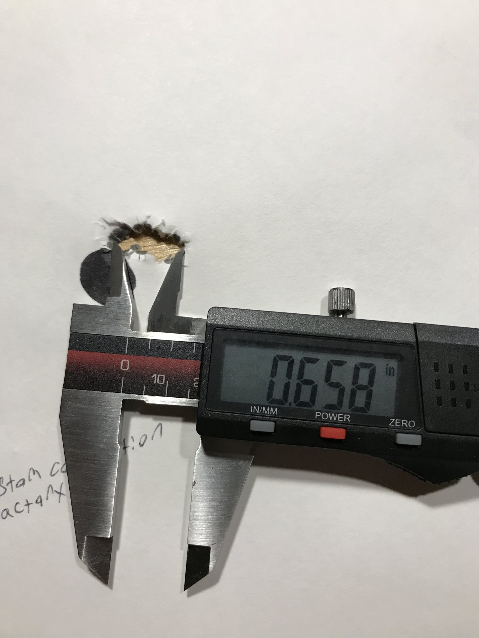

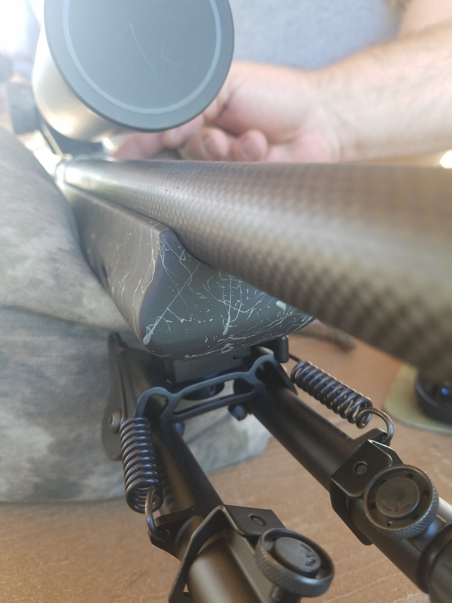

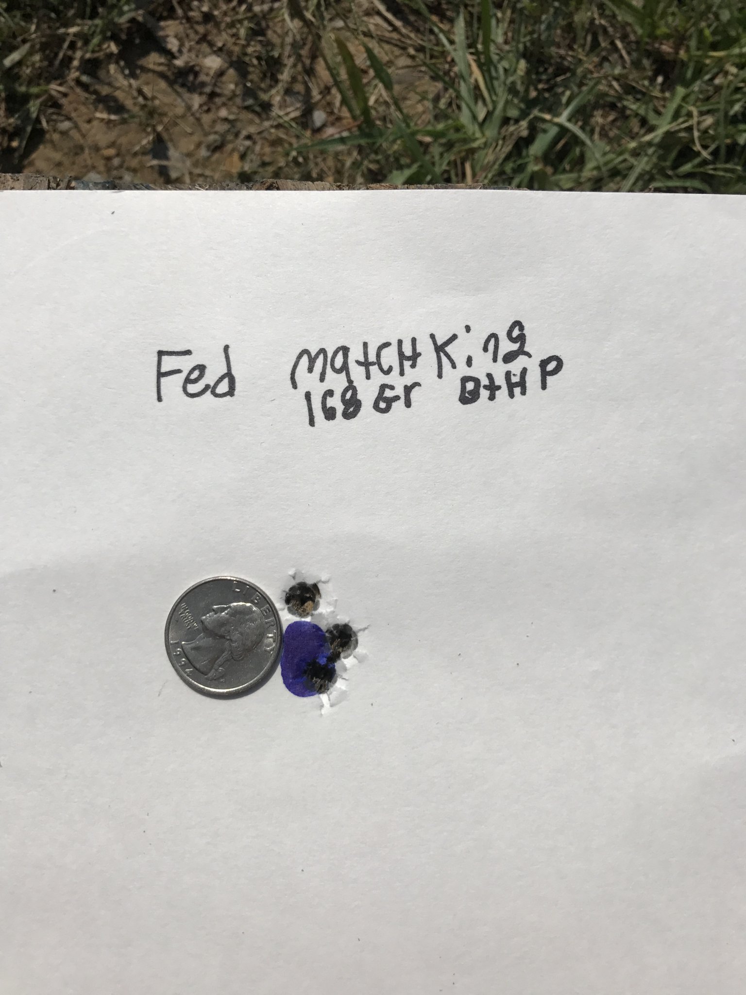

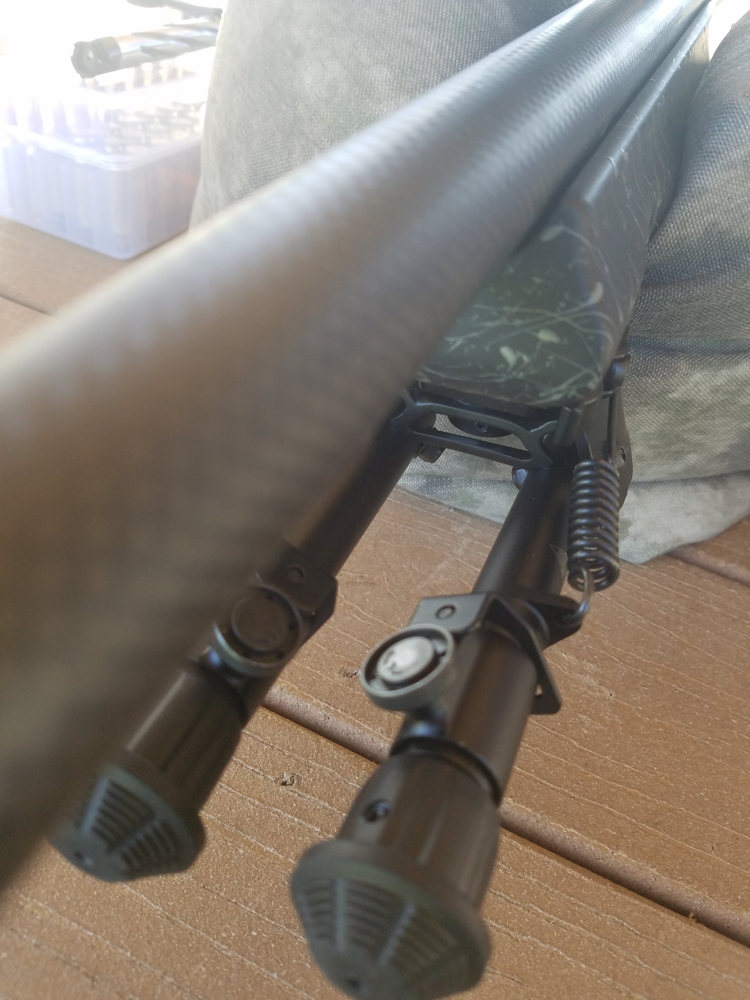

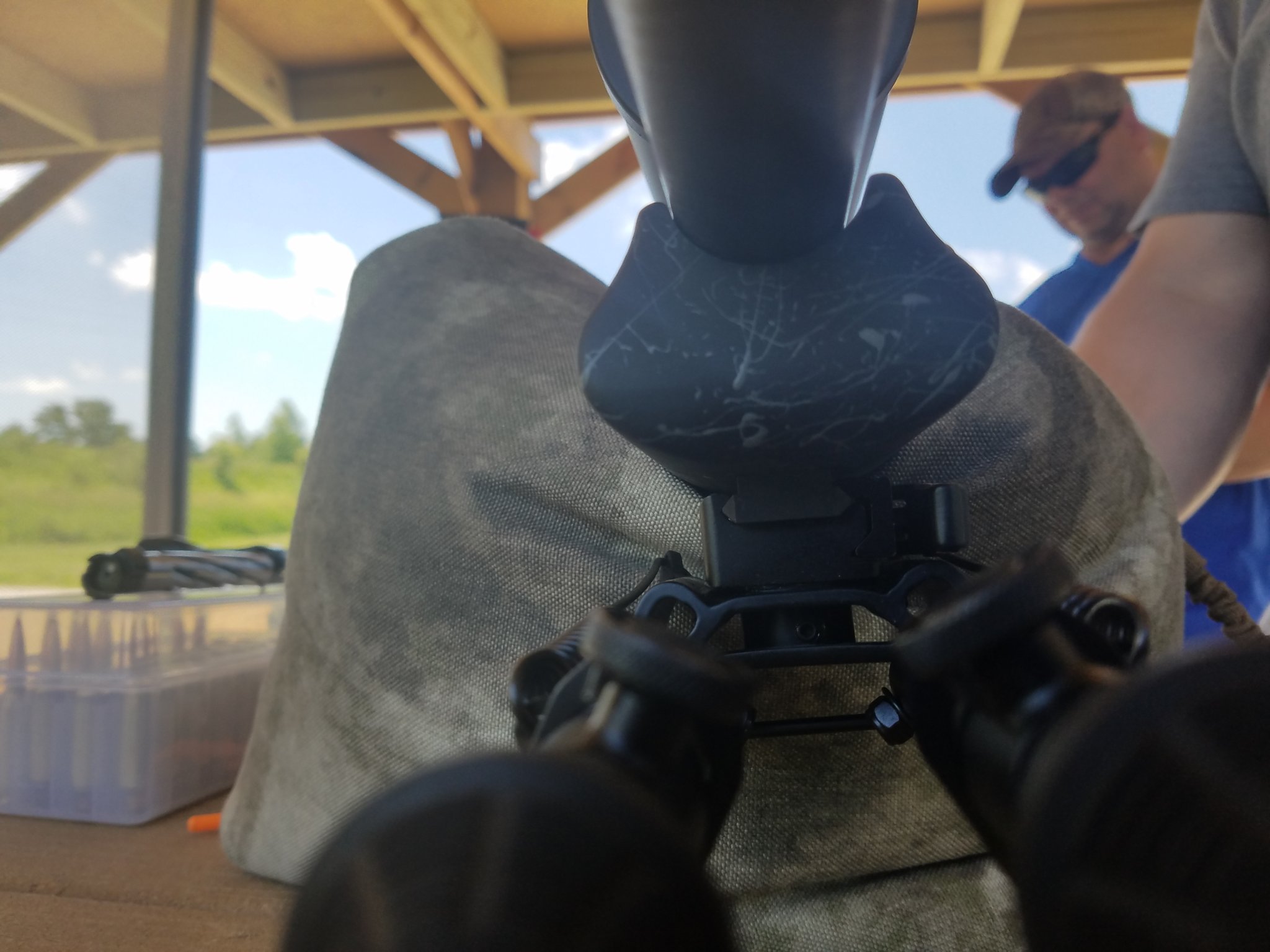

Hey there everyone, I just want to give everyone a heads up warning about a manufacturer that claims to produce high end rifles. Christensen Arms. I purchased a CA BA Tactical in 6.5 Creedmoor 26" Carbon fiber barrel. This is a $2,700 Rifle, not to mention i put a Vortex Razor HD Gen II 4.5-27X56. So here I am with over $5K into this package for distance shooting, and I get to the range to sight her in. I'm already 30 rounds in, and unable to keep a zero. This gun is shooting 1.5 inches to the left, then out of no where it's shooting an inch to the right. I'm sitting there feeling like an idiot, I'm a competative PRS shooter. I then let my two buddies try it who were with me at the range. My one friend is a PRS shooter who trained with the Navy Seals, and he even said the gun sucked. He was still shooting inches off the target. We let the barrel cool down, then shot 3 rounds and they were near perfect. But the next 5 rounds we shot were 2 inches off. Keep in mind this is at 100 yards. My other friend who has been competing for years noticed that it was the barrel making contact with the stock. And not just a little contact, the barrell was touching the entire left side of the stock when you look down the bore. We can't even fit a dollar bill through the chanel. We take off the action and barrel and notice a complete crap bedding job. It looked like some amature bedded this thing. There was significantly more bedding material on one side of the rifle. The action litteraly sat crooked in the stock. I'm at the range and I call Christensen Arms. I wish I had this conversation recorded. The guy basically said, "well you can send the gun in at your expense, and we can grind out the stock." Ok, No! The gun needs to be bedded right, any gunsmith can do it, but the guy at CA said it would void my warranty. I asked how long it would take for them to fix this issue. Im assuming a week or so. "Nope, it will take about 2 month's." Now I'm pissed, this guy then went on and basically said, "Sorry. I can't help you." "Since you removed the barrel you voided the warranty." Are you kidding me?! I spend thousands on a gun that is supposed to be gods gift of shooting, and my 20 year old Weatherby 270 shoots better groups!!!! I've been sharing this story at all my matches with professional competative shooters to get the word out, so that no one makes the mistake of buying a CA. I now learned that their quality control sucks, their customer service is even worse. And the most unfortunate part, is that they don't stand behind their products at all. I am a very unsatisfied customer, and they didn't offer anything like a partial refund, or exchange. I'm telling all of you. Just get a Tikka, they will stand behind their products, and they definatly produce a better rifle. I will continue to post my story on forums and word of mouth. If you read this, please tell your friends. No one deserved to get screwed out of thousands of dollars. I really hope CA can correct this or offer me a refund, it's just sad to see a company with such a cool story have this happen. I hope someday they can produce a nice rifle.
CA, if you see this and want to help me out, if be very greatful. Email me at Awvaltierra@gmail.com. and anyone who wants pics of the gun to see the issue, email me, and I'll send them over.

    and you can see the barrel rubbing. come on now

    Yes there's a pictured of the barrel contacting the stock. That proves nothing other than that the barrel may be contacting the stock. Lots of rifles with pressure points shoot bugholes, and lots of floated rifles shoot like shit if something else is amiss.

    Damn, you didn't notice the barrel wasn't free floated when you went to pick it up? You should of sent it back right then. I just have one question? Why did you pick this manufacturer in the first place? It had to be based on something righteous and hopeful.
