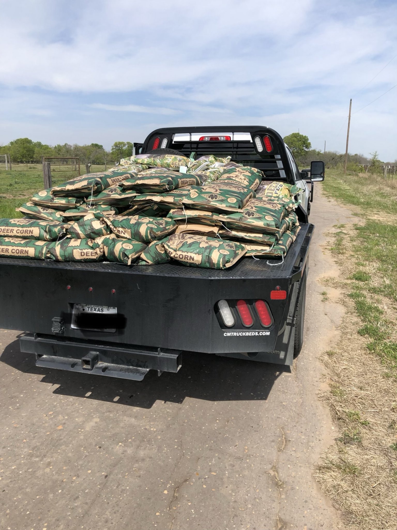

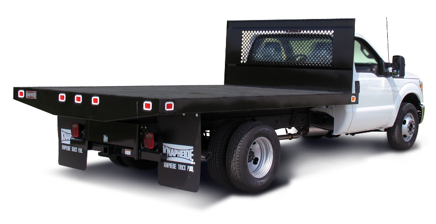

In my experience, if you want a WORK truck the best all round choice is a cab and chassis then install a flatbed with or w/o a dump, like the one in the photo below. I had a Chevy with a 454 but if I did it again Id go diesel. Remember, now you have to add Uric acid to the diesel...maybe not in trucks. I ran a stone masonry business for years and a pick up is a waste. With an 8' stake bed you can carry a lot more, load and unload more easily, and the weight makes it ride better. Fuck the studded tires, get a set of single chains. You can roll the inside wheel onto a log or rock and easily put the chains on the outside wheel and that will get you through a lot more than studded tires. Believe me, BTDT. I used to tow people up to the local ski resorts and get $40 per haul...made $440 one night.

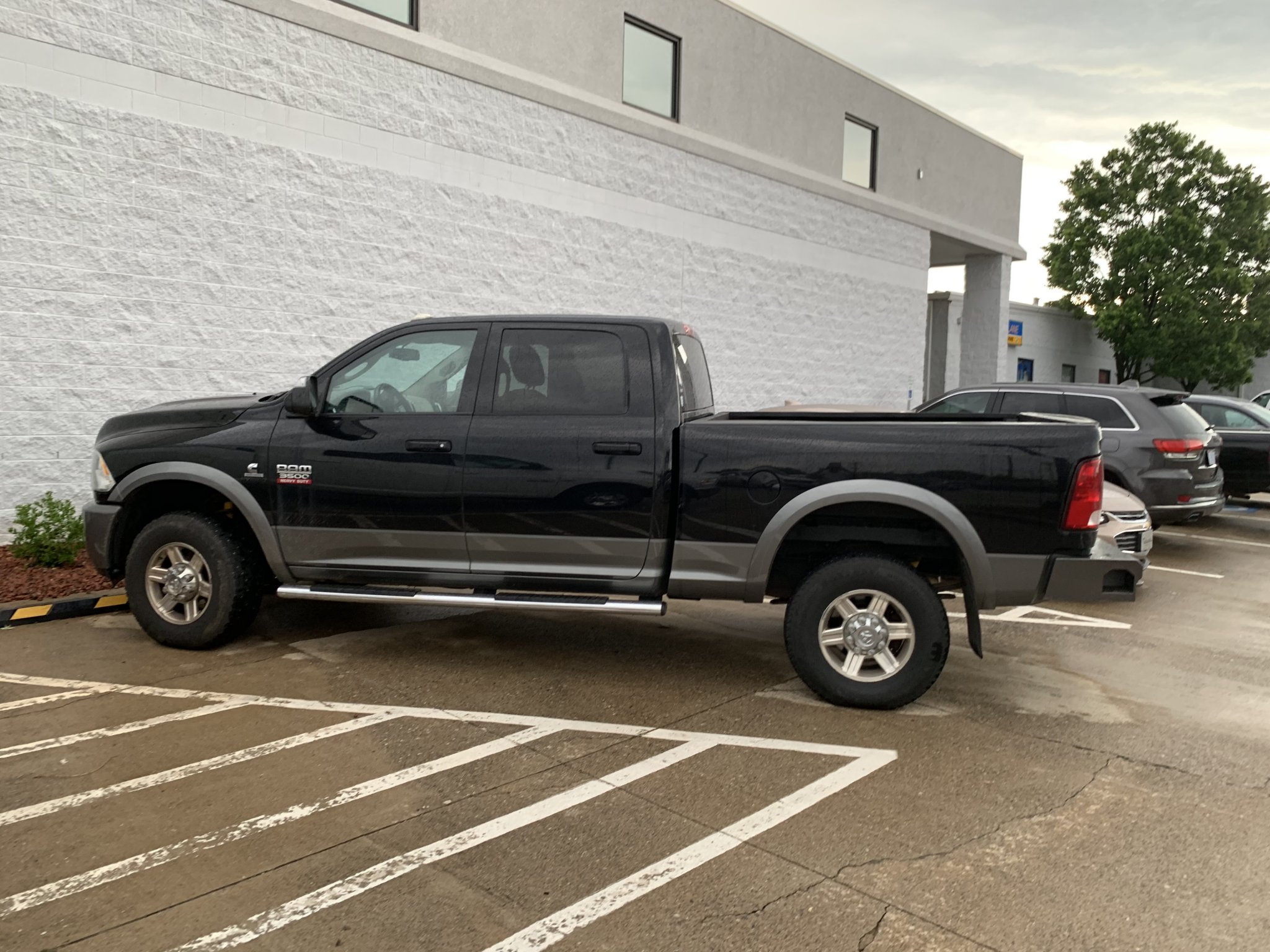

Well, ended up just getting the same truck I got last time...
Didn’t get the long box.
But got a Lariat as I spend enough time in it that I just wanted a higher trim level. So far, nothing much more than my last one with 300 more foot pounds! The torque is incredible on these things!

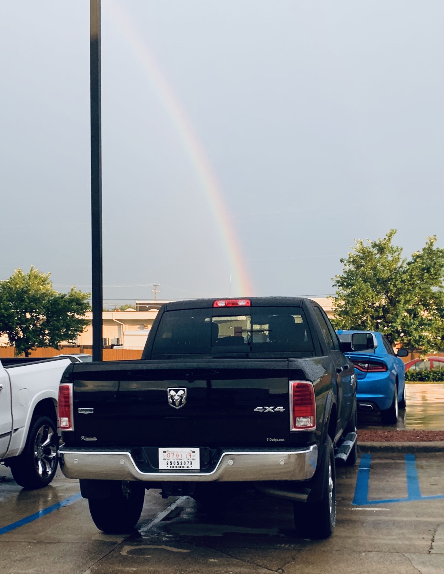

But as I went out to get in new truck, I was greeted by this.
So new truck is either blessed by Leprechauns, or gay as hell...

PS: bye old truck!
